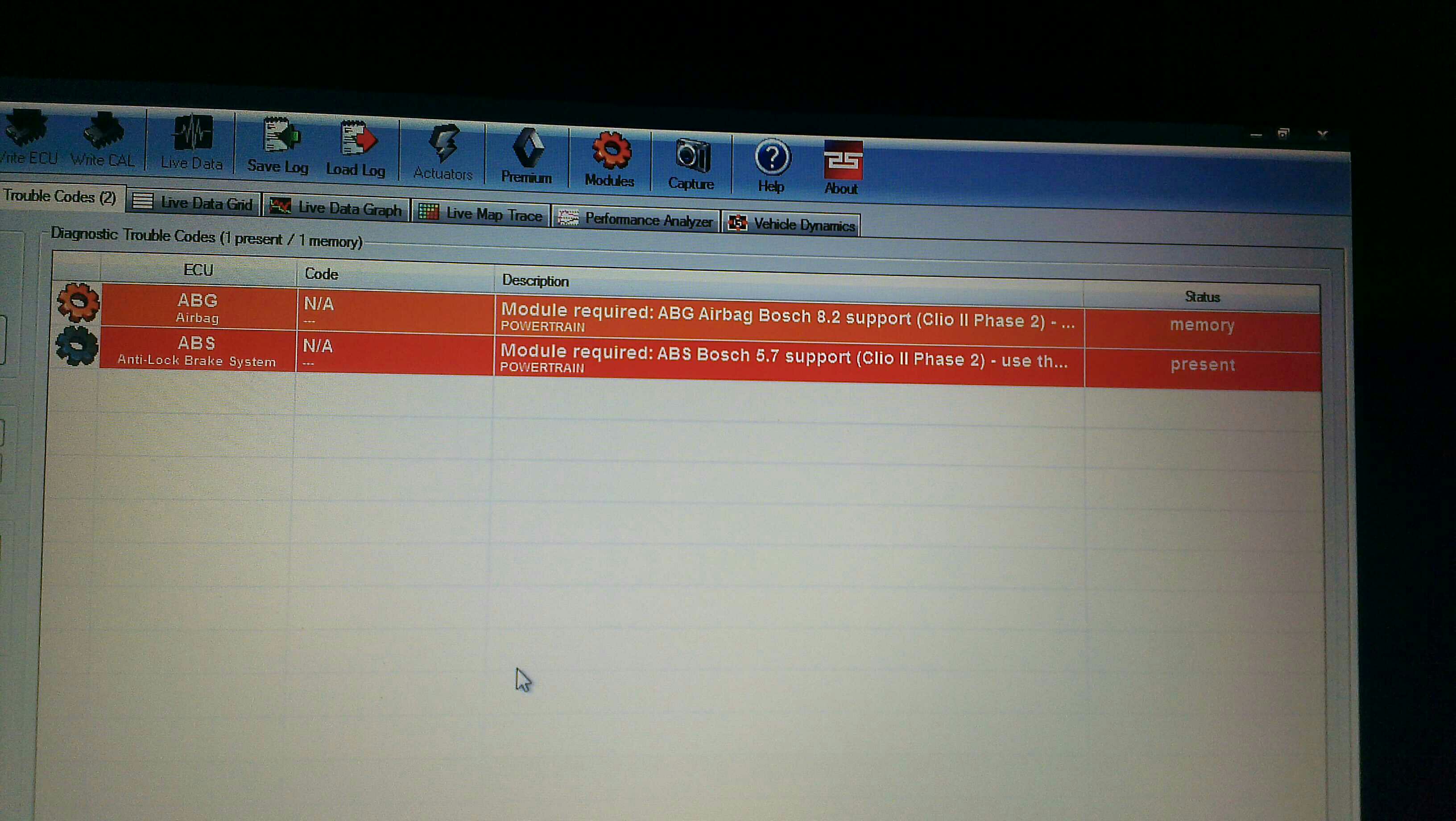

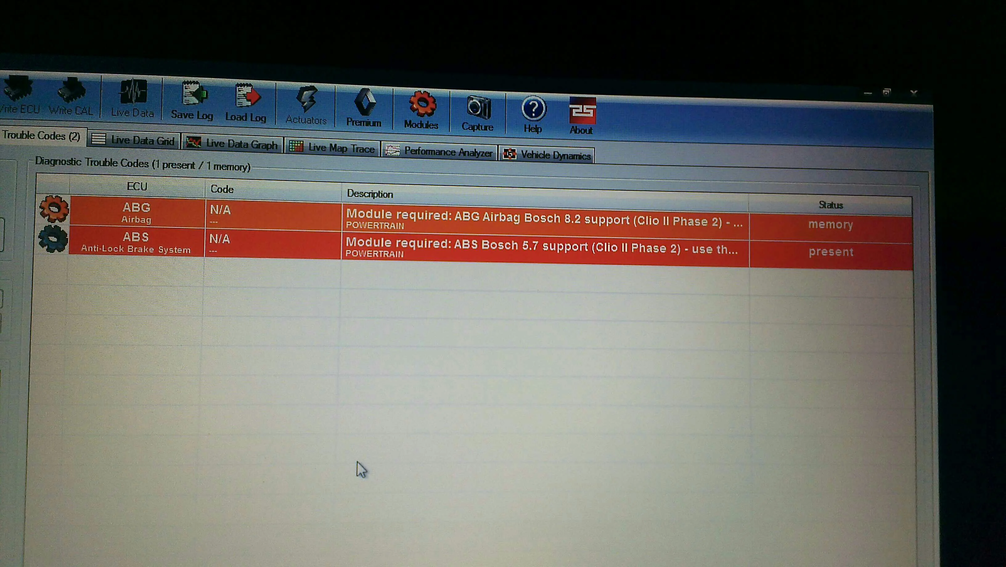

Currently in process of reading the ecu and cal for my Ron 98 remap and after doing so I'm getting this fault that I didn't have before ? Just about to update new ecu software can I go continue ? Or do I need to clear this fault with a module first ? uploadfromtaptalk1399668121553.webp
I disconnected and then started the car then reconnected and it went from current (red) to present (orange). All went smoothly job done. Very happy :-D cheers Nathan.
