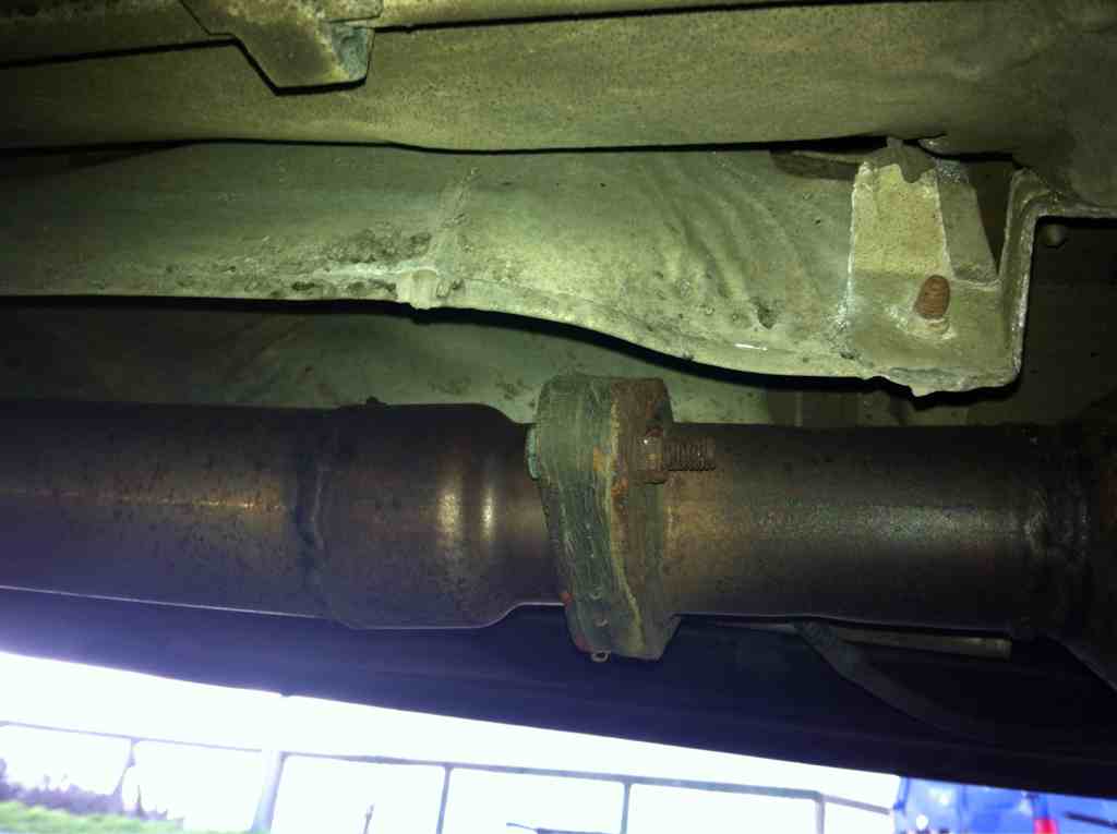

Once off, if anyone local wants a straight through mid section, it's yours for nothing. Has been adapted to prevent the usual RS192 leak (see below) and will therefore require your cat / de cat pipe adapting too.
