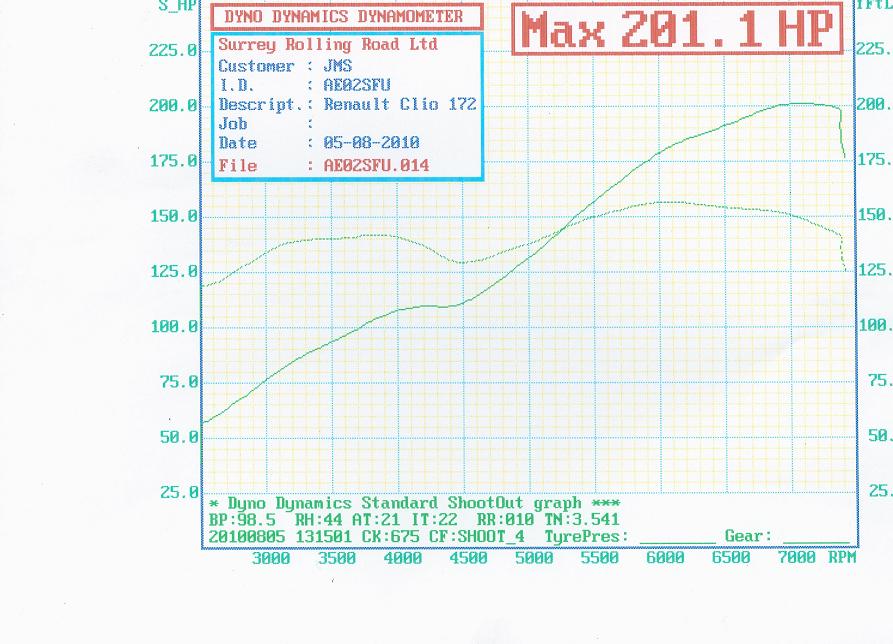

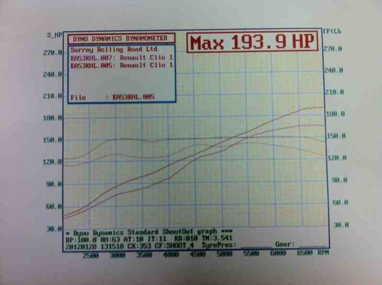

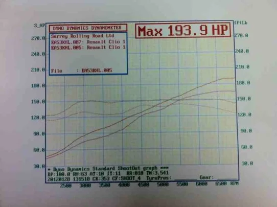

The standard camshafts work best with the Rs2, We're currently in the trailing process with RIKUS Automotives semi group N tool which has broken the 200bhp rs2 with standard camshafts, hopefully we'll be able to confirm this in the coming weeks :)

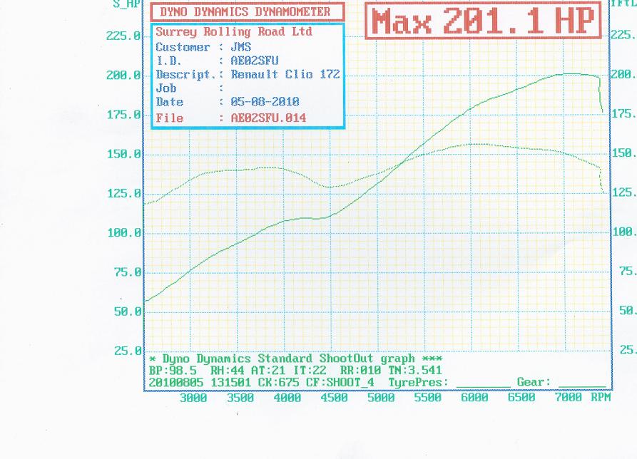

So, you think looking at that graph and the powerband it produces is a result of poor cam timing? what planet are you on, it makes the correct torque up top there is clearly nothing wrong with the timing. Not to mention it was agreed between JMS and 519 the timing was fine after they checked it multiple times anyway.
And its mapped poorly because Henk did it? The same Henk that has one of the best reputations for engine calibration on our little renaults just about anywhere??
You fail at deffending the RS2

TBH my personal opinion is that James from Stone automotive (aka JMS previously) was massively over critical of the results he had on that engine when he says that the cams "dont work" with the RS2.
Sure a totally flat curve like the ones he is used to on the RS2 is very desirable, but actually many other people are perfectly happy with the "twin peaks" type output you tend to get on hotter cams on a lot of engines with similar induction setups.
So where he calls it a failure because there is a hole in the torque at 4500 I dont think its quite that clear cut, I look at that graph and think that 3-4K where I sit in normal driving looks great, and 5-7.5K where I use a car on track looks great too, the hole at 4500 although obviously not what you would ever choose is actually in a place that wouldnt bother me particuarly as its not a bit of the rev range im at a lot in all honestly anyway, and even there its still only 130lbft that it drops to, its not like its down at 90 or something.
Next time the belt needs doing on ours (just been done so not for a while TBH!) I will almost certainly fit cams at the same time as I am doing it, and if the results i get resemble that graph, I'll be quite happy.
Its 200bhp, perfectly driveable, perfect cold starts, and all on a standard engine, to me thats good results, the dip at 4.5K is a slightly issue, but it doesnt render it something I wouldnt want just over that.
