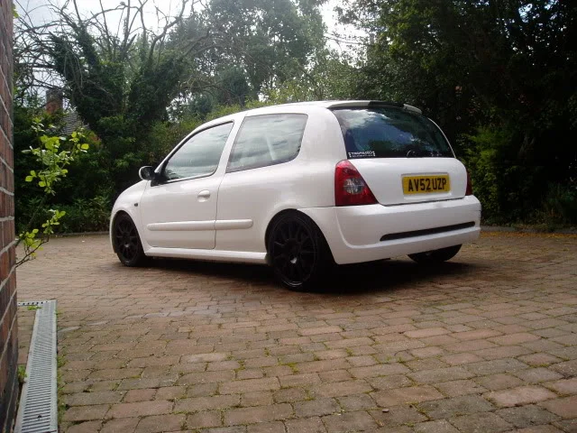

Some of you may know me but i used to own this
Was my first RS and was great.
I always wanted a RB 182 but it never really happened.

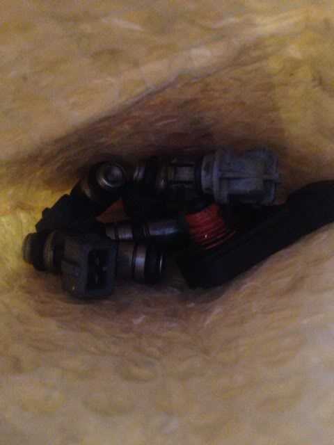

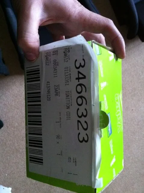

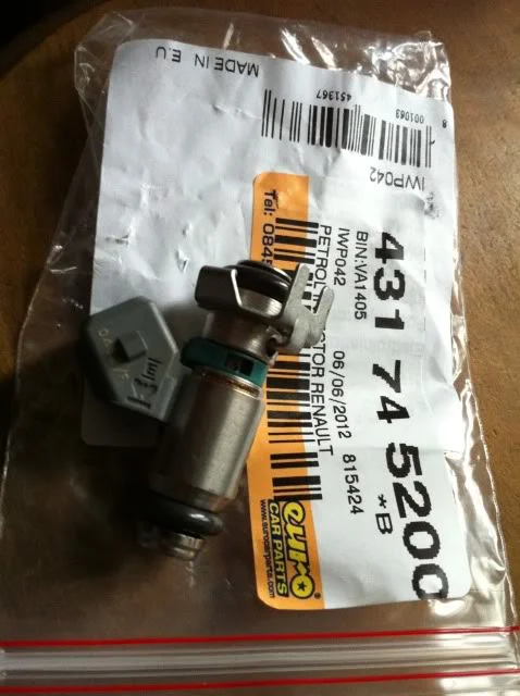

On the test drive, it decided to all of a sudden hesitate and ecu light started flashing away.
I quickly found out it was a misfire on cyc 3.
I still went ahead and purchased the car anyway!
So here it is;
Sorry for the s**te car pics-
So new bits to get it running correctly;
  • Valeo coilpack
  • Ngk R platinum plugs
  • New HT leads
  • One new injector
and its now running :)

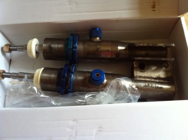

Fitted my rear gazgold coilovers. Fronts have been sent to gaz for a refurb!

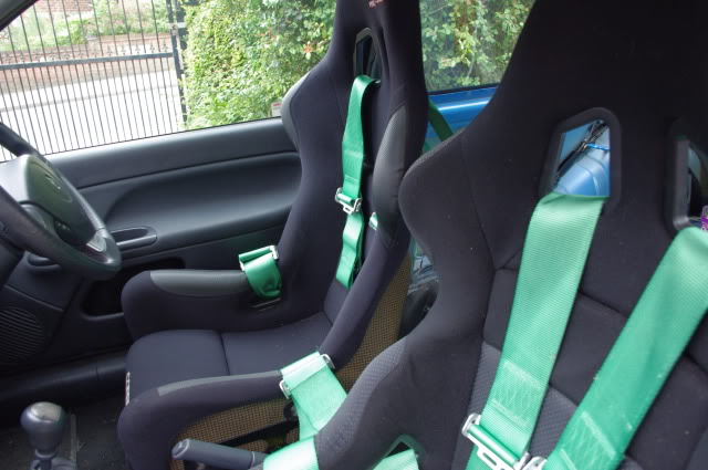

seats are in!

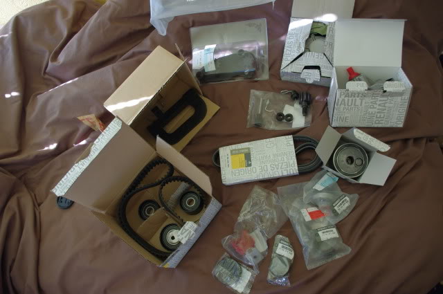

Service bits & cambelt tools bought too!- thanks to West renault for the quick delivery!
  • Cambelt kit
  • Aux kit
  • End caps
  • Dephaser pulley
  • Cam pulley seal kit and bolts
  • New crank pulley bolt
  • New middle exhaust mount
  • Oil filter
  • Cambelt tools from renault-Genuine

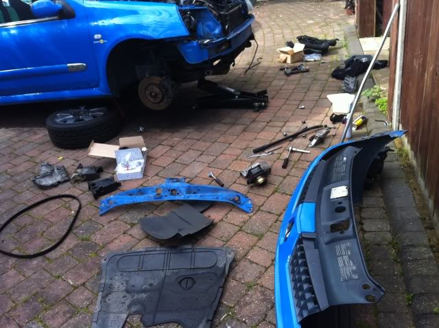

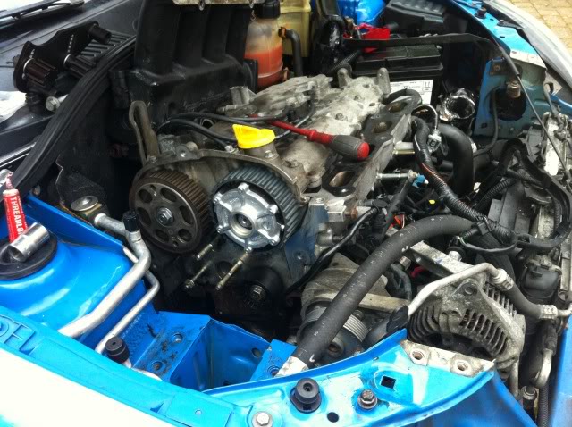

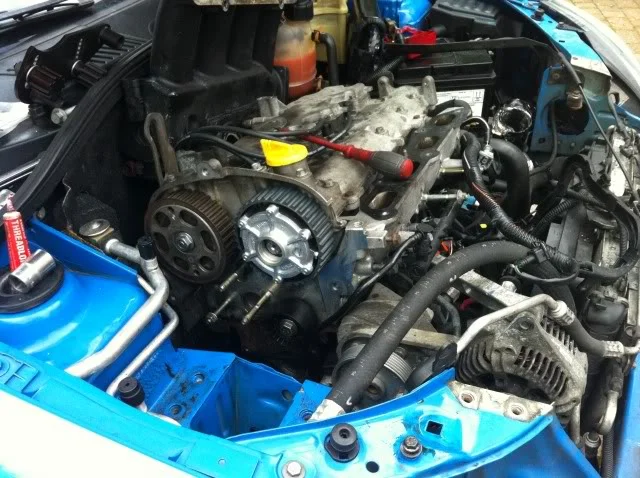

Update:
Mid job........

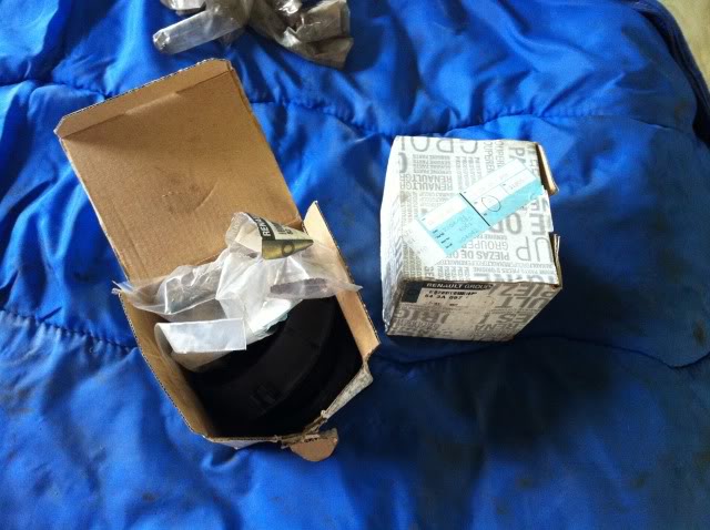

New dephaser
Gaz gold with new dampers

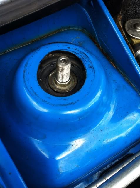

New top mounts( updated version)
Kept knocking like mad!
So had to revert this
Have fitted the new rs192 and custom decat

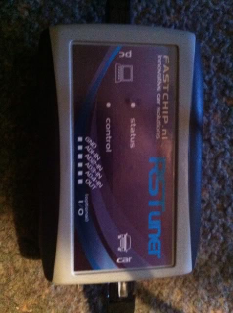

Finished, the belt change wasnt that bad! Now ive finished though ha
The rstuner was very easy to use and upload.

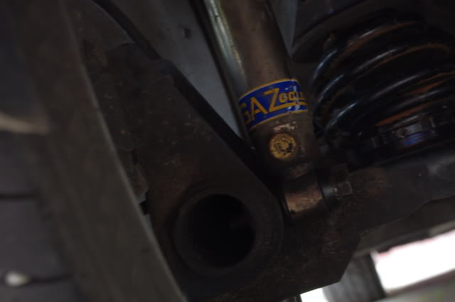

Had my alignment finally done. Now running -1 degree camber! feels awesome.
Need to play around with damping setting, as earlier when going around a corner, it seem to bounce abit?

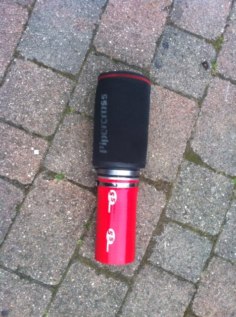

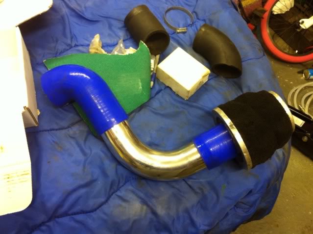

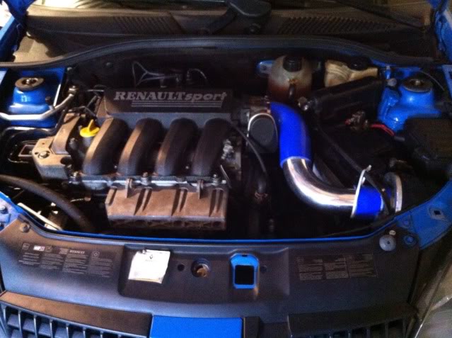

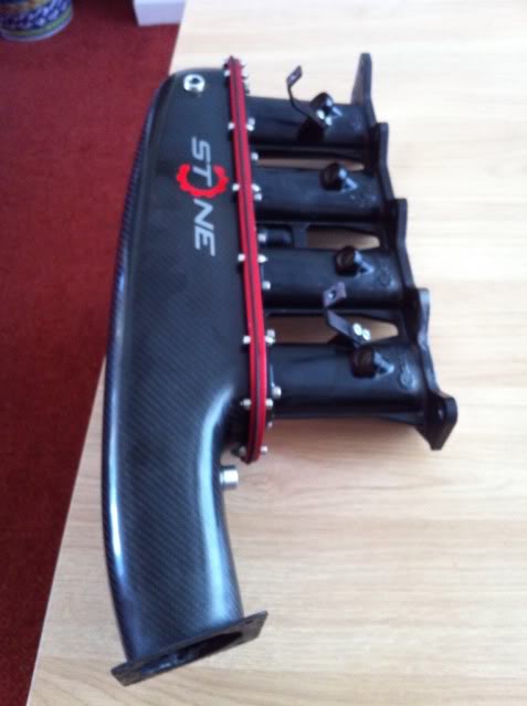

Also fitted new induction setup
Rep ktec with a old pipercross foam filter which came with a old engine i had
Pic
fitted

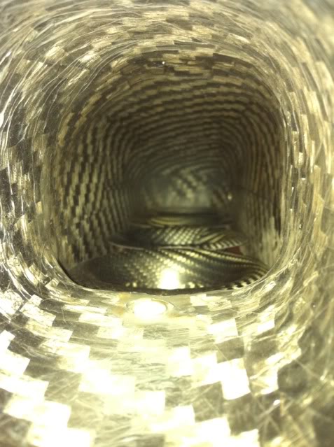

Carbon Trumpets are porn!
So the above must mean
waaaalaaaaa

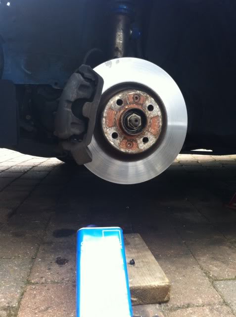

Bled the brakes with Superblue brake fluid- OMG its actually blue, a neighbour cared to tell me:rasp:
Bled all 4 points with the eazibleed kit, wasnt that bad, had a leak at first but sorted it in the end.
Im still get some pedal travel though??

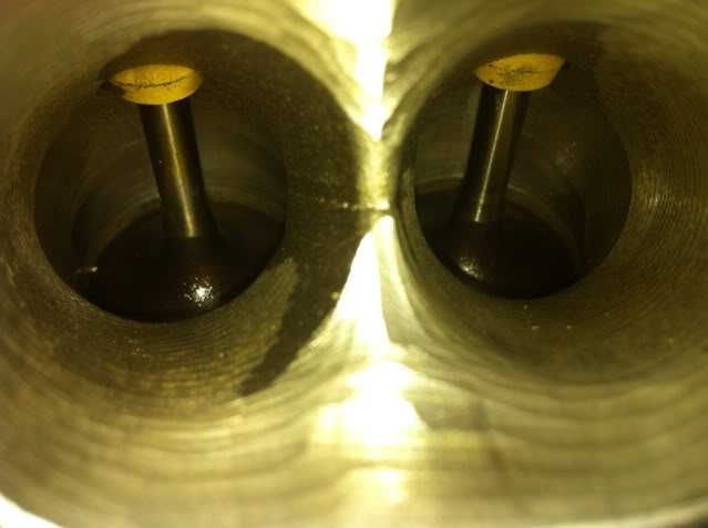

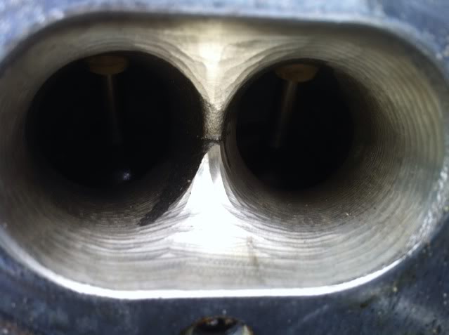

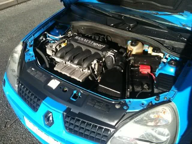

Fitted the RS2 too, took longer than i expected. Some very awkward bolts!

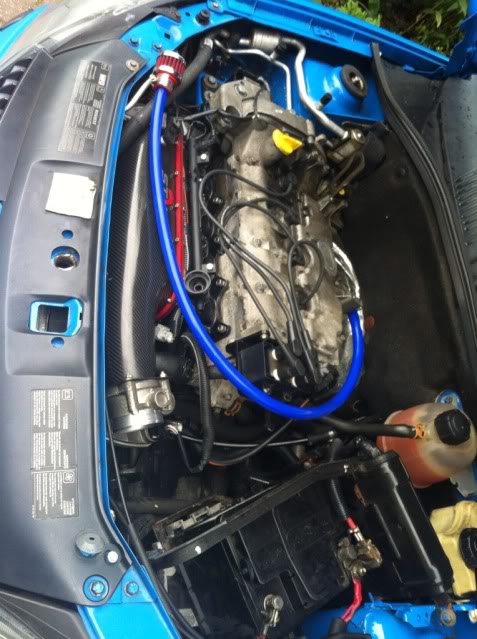

Found out it was a ported head( ph1)????
Nearly finished
Will be running this filter setup
I havent got solid engine mounts at the moment- i wont be driving the car so no need till i find some second hand.
;) Anyone? ha

PS form over function in the engine pictures ;)

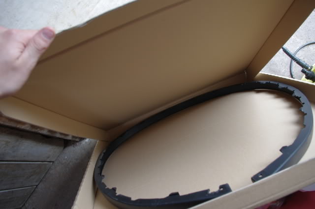

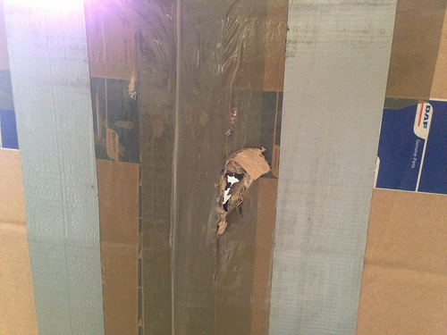

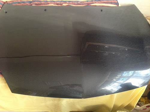

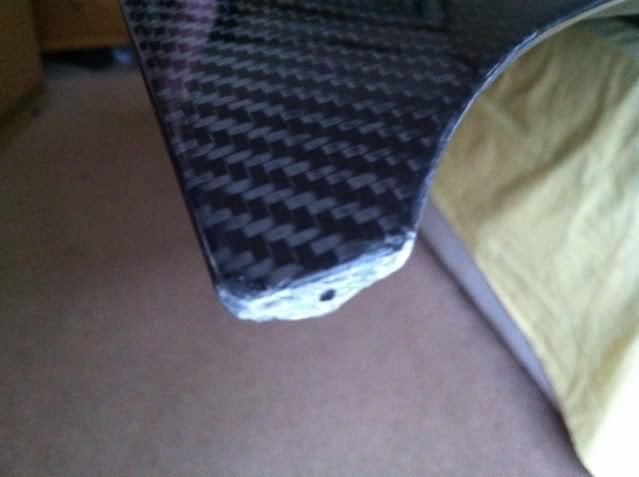

Recently bought a carbon bonnet, but it ended up arriving with broken upper edges and few other little marks. :(
Looks like the edges had pierced the box and ended up dragging on the floor :( So im waiting for this to get sorted via paypal currently.
Happened on both sides of the box :(
Anyway.
Bonnet overall

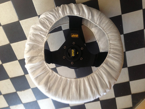

New steering wheel

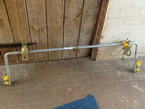

Whiteline Arb

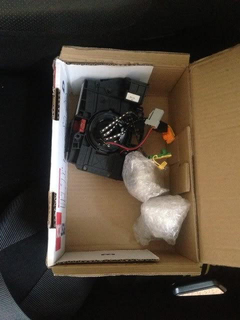

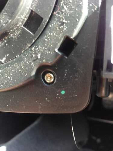

Also broke the airbag wiring too :( s**t
What tool do i need to remove this???

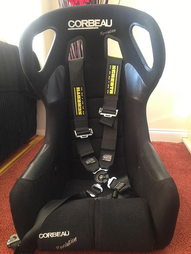

New throne ! and harness
Will be selling my corbeau pro series with carbon kevla backing.
