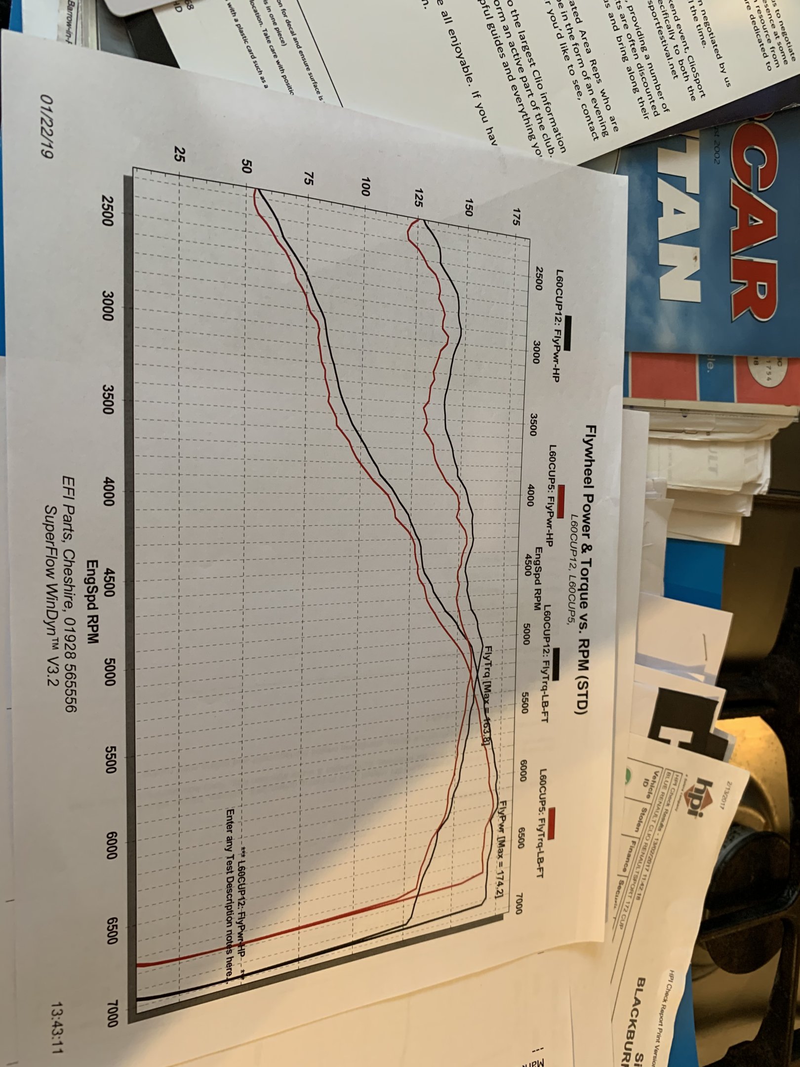

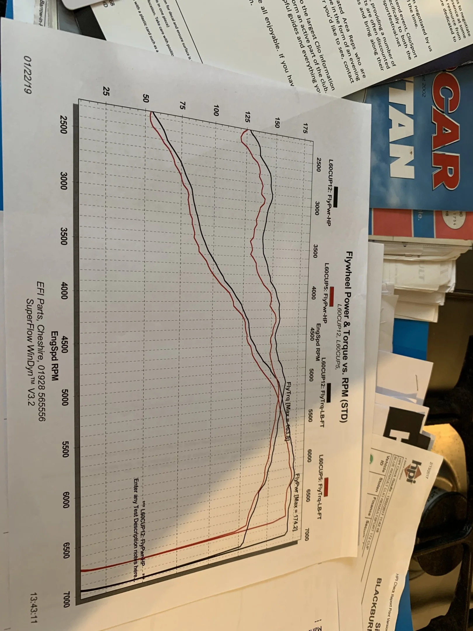

Hi mate I had my standard Clio 172 Cup mapped at EfI parts made 174.9bhp and I am currently working through some light modifications and will get the car back to Chris for map adjustments. Although no massive power gains to be had from these engines certainly improved drive and throttle response and cold starts ect.

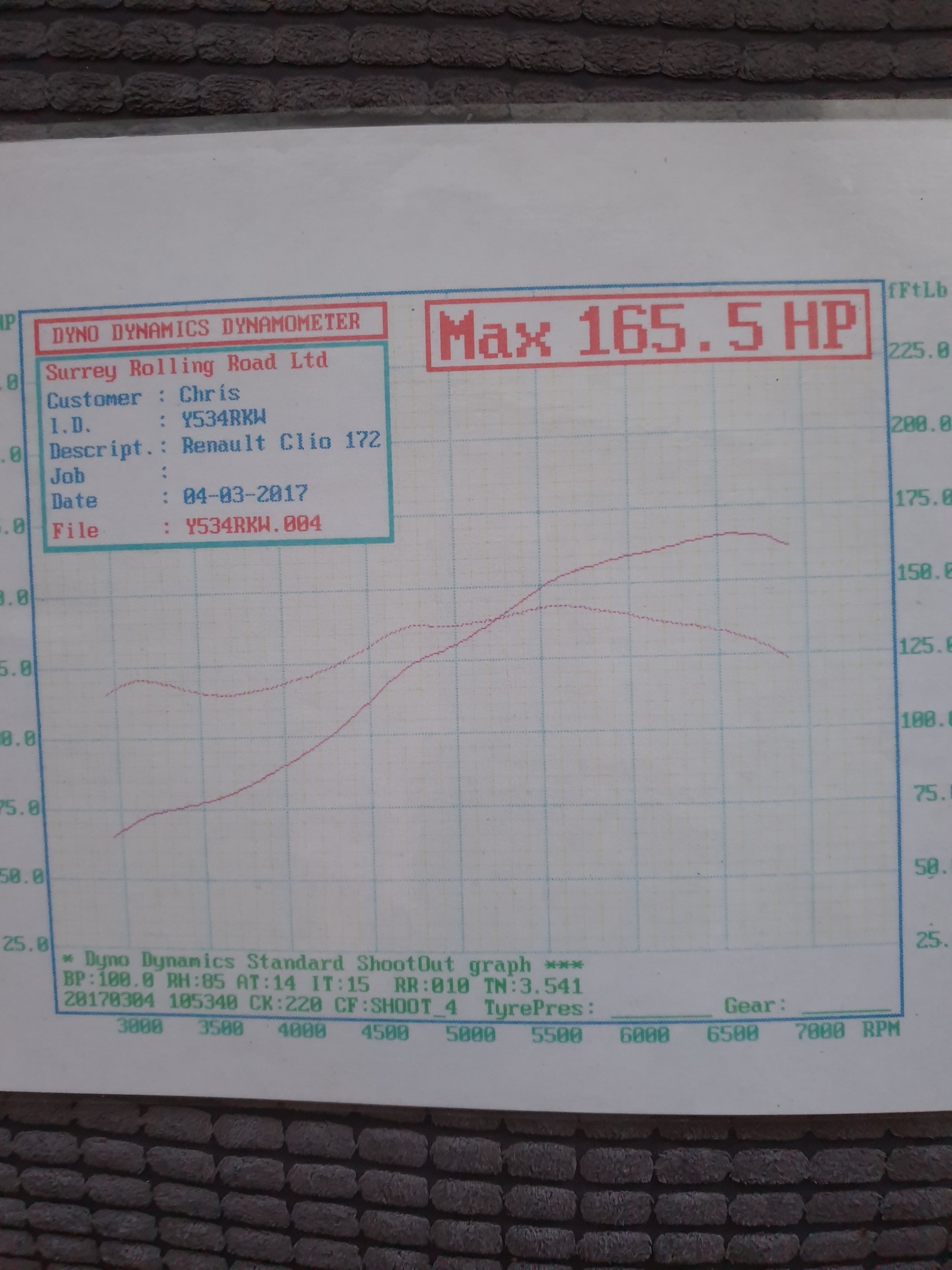

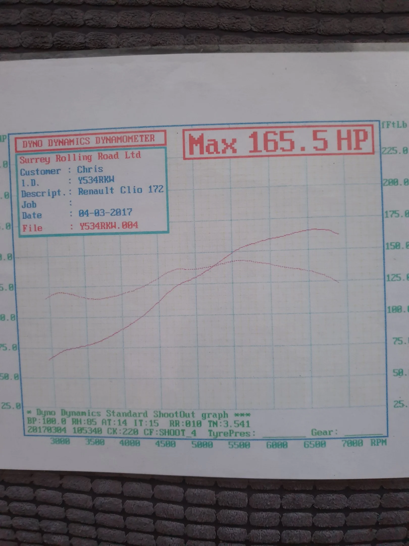

My throttle body was playing up for months- least that got fixed. But enlarged throttle body and matched inlets cant be a step in wrong direction. I will find out on next dyno run. 165bhp on a run with no mods.
Dont think will go to trouble of swapping out exhaust manifolds n stuff- straight to remap by looks.

Mine did 175 with no mods ? guess each car is different I guess and how strong engine is
Depends which Dyno you use- think some of them are quite "encouraging"
Mine was 165bhp 2 years ago, and not expecting much more before a remap, but just driving better will be great
To be honest, it goes pretty good now, maybe just being greedy. Just a few flat spots at top of rev range
and for all I can tell, it may already have a map on it

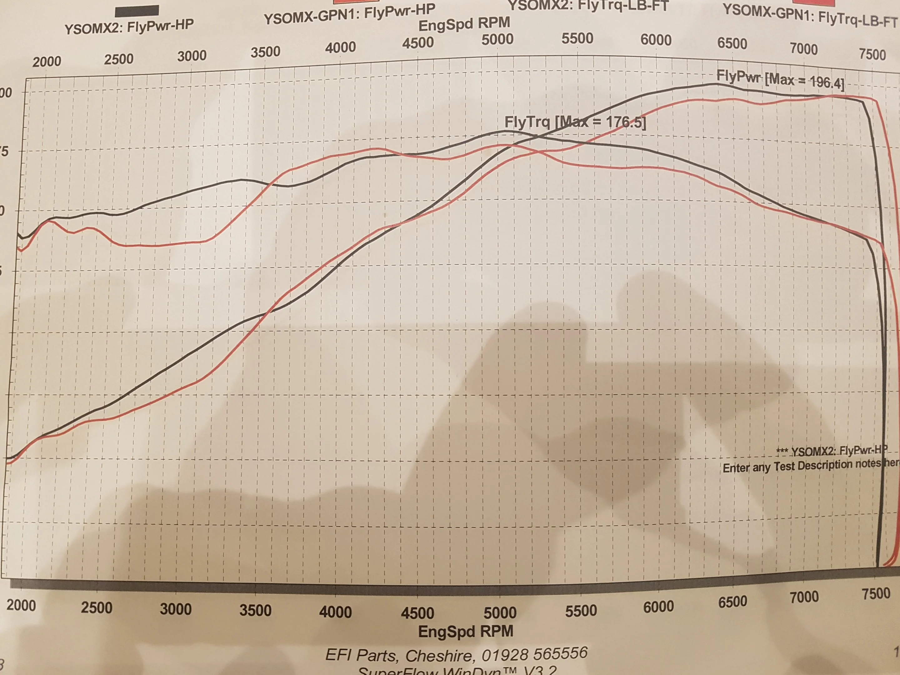

Ive seen a few posts on here which suggests the gains of a 182 manifold and sports cat (Apparently the 182 standard cat is a 200 cell cat) are diddly squat
Seems any performance mod on here gets equal measures of positive and negative comments- best just try what suits I think
proof of the pudding ? red with 172 exhaust manifold, black with 182 manifold.
