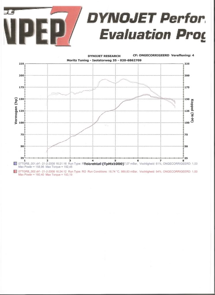

It was very hot outside around 36C but still gave a shot.
Awesome low-down torque even with the C&B cams.

As I said it was very hot so i did not want to push it so hard. Will post up some more later.
Alper ; this one was done at almost half your 34c temperature ; 18c !
-Group N Fastchip map
-K-tec Stealth with sportcat
-ITG panelfilter
-weight removal (back seats , buckets)
Shows that hot temp is no good for performance hey ?
Still somehow i think mine is over-exaturated a bit ; they might have used the weight of a normal 172FF in the calculation, therefore showing a better performance on paper ??
161 at the wheels is quite high for just exhaust and map i'm thinking
After mine there was a Honda S2000 on the rollers and that gave an accurate reading so the rollers must have been good. Forgot to ask what carweight they used on mine :(
is there truely an accurate way to calculate the power at the fly from the power at the wheels?
Alper, have you noticed my torque level at 2500 rpm ?
With your graph compared to mine i'm in doubt of getting the C&B's. the car is already so fast.. Seems to me there's no/little difference. Although there is the temperature difference we have to keep in mind..
I MUST give Henk a call and see if he has time to do some research, a new map in the meanwhile as my curve is not so nice in comparison to yours :eek: (without being gay here)
See what he has to say about my graph.
fil_b :" is something soft like 22. something percent
but each car if diff" Today 07:45
Phil; front wheel drive is supposed to be around 12 to 15%. 22 is rear wheel drive
is it??
went for 22 before using 22% and seem pritty close
will check results and ask
161 ATW just by remap and decat seems to be a little optimistic to me.
For an F4R, I am not expecting huge power gains with basic breathing mods.

You know what it's like; it's never enough ;) i want the car at it's best and with the cambelt service coming up i was thinking why not !? ; and go for these nice cams like you got in yours. However when i compare my RR graph to some i see on the net , i'm in doubt i'll ever go any faster than how it's running now
:banghead: decisions decisions decisions
If you are happy with your current config why bothering for more, forget about it :)
Please shoot some videos so that we can see how fast really it is.
also keep in mind (i should too:eek: ) that mine is a cup with more weightsaving being done so this may make it "feel" faster
