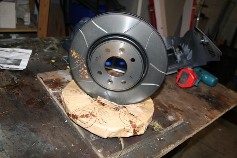

With regards to the discs, when fitted in the way that Ben has, they will give a much greater bite but will eat pads.
It makes a huge differnce fitting them this way especially for track days. certainly not advised for normal road use.

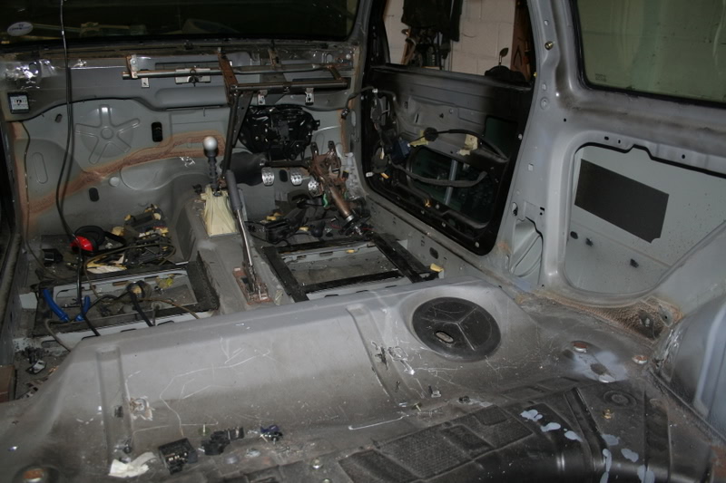

the tar is piss to get out heatgun and some scrapers to get most off then i used tar remover to get it cleaner then white spirits to properly clean the area.
i used a chisle and hammer at first and made a right mess behind my passenger seat.

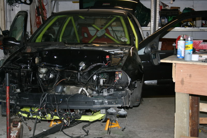

hi.

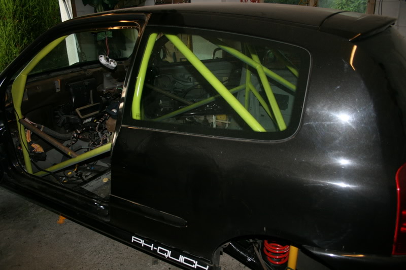

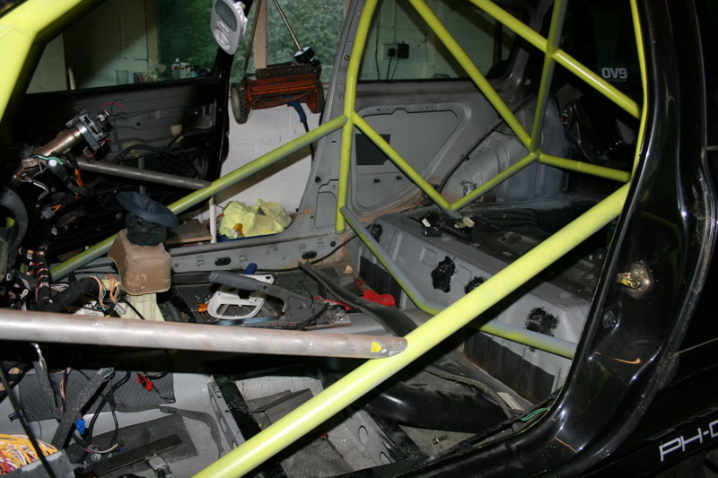

Just a few pics of half the cage, this is not fitted just placed in as the green on there is only the base coat. it has since been given 5 coats of top coat and 3 coats of 2k laqur,
i then had to mark up all the weld points to the floor pan and rear archs, as i am spraying the interior white so dant want to cover these patchs in paint or i will make a rite mess grinding it all down again!
its looks sexy and there is soooo many bars to still fit,

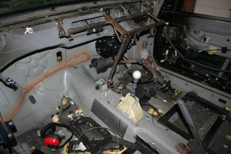

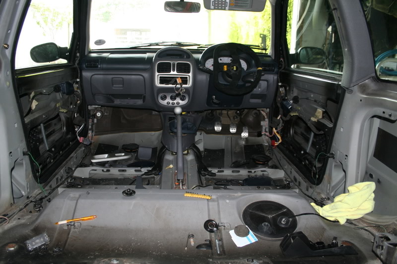

it was really hard to get in never mind remove, at this point now i have fully removed all the dash and even the dash support frame.
i now have to weld all the brace and support plates into the car to mount the cage to. also i have to cut through the bulkhead

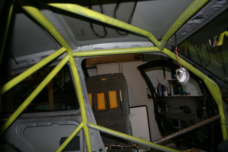

i am half way though custom fabricating my new dash..... iw ill upload pictures tomorow of this.... the cage is atcually welded through the bulkhead and even welds to the back of the suspension struts... CRAZY!
heres a few pics
Still need to remove this s**t off the roof mind!
one looking at the rear
and a quick one from the front!

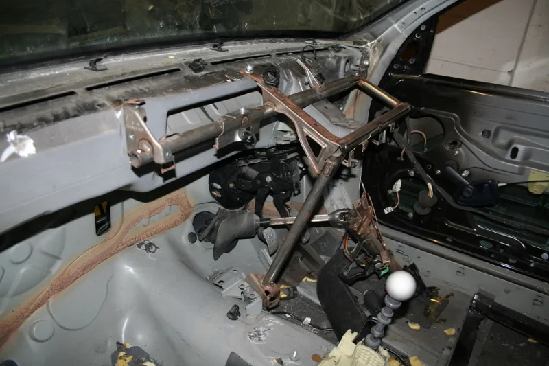

i am making a custom fabricated dash for the car so heres what i have done so far. first of all i had to remove the dash from the car.
old dash in
there are lots of stupid screws to get at but after a hour or so the dash was fully out. Leaving behine the loom, heater controlls, heater matrix and loom.

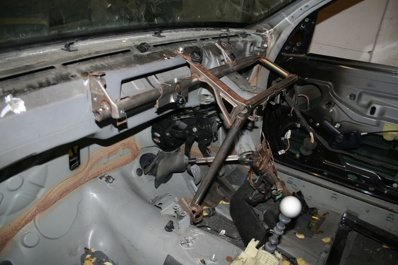

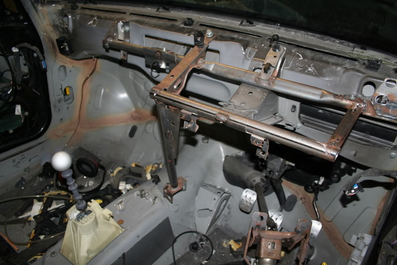

here is a pic of the dash removed, loom and heaters still in etc. also at this point you can see why the rail fouls the cage
The main reason for the custom dash is that the cage is soo big that it fouls the dash and the steel frame behind it. so i had to make each end of the dash accomidate for the cage.

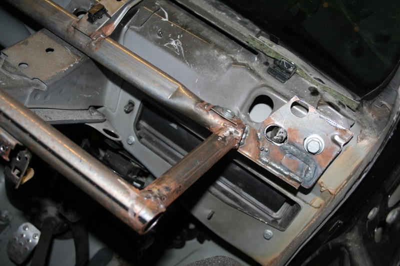

As my dash will be a custom shape the metal framework behind needed to be shorter, so took the grinder and basically just chopped that end off just after the bracket, i left the bracket on to give support to the frame and also later i would make a fixing point for the new dash.
Then on the passenger side of the frame there is a bracket which
a. Looks awfull and would be visible with the new dash.
b. Had a bar off it again fouling the cage.
so then i wiped out mr grinder and clamped up the dash rail, i cut about 19cm off both tubes and removed the bracket. then i welded one of the cut tubes between the two original tubes giving good support.
next up was to custom fabricat the brack to hold the dash rail in place, so with the off cuts of steel and the old brack i ran a flat peice of 2 mm steel to off the new rail then modified the old bracket to fit onto the original mount. then welded this to the 2mm steel and cut it down to suit.
next bolted it all up and tested the strengh of it....... MINT!

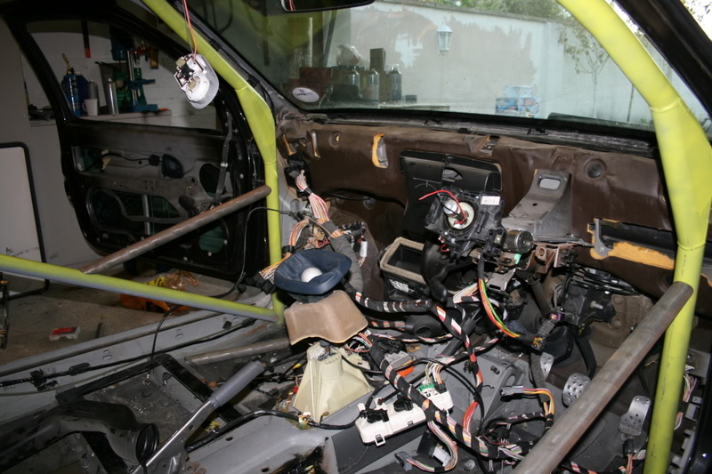

here is some pics of the custom rail and all the heater, loom removed.
here is a picture of the modified picture of the rail on the drivers side.

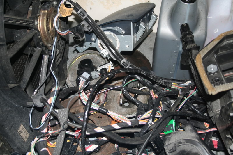

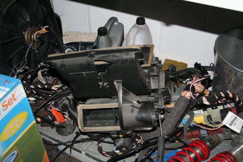

here is a picture of the MASSIVE loom i had to remove :(
and a pic of the heater matrix
to remove the heater do the following
remove the scuttle pannel and remoce two bolts from there, remove the linlet and outlet plumbing and a few bolts inside the car, then it shoudl just come out....pissing water all over your welder :(

then i remove about 25kgs of the heatproof bulkehead lining! its soo heavy also like a leather lining on it!
very good wieght save.
here is some pics
