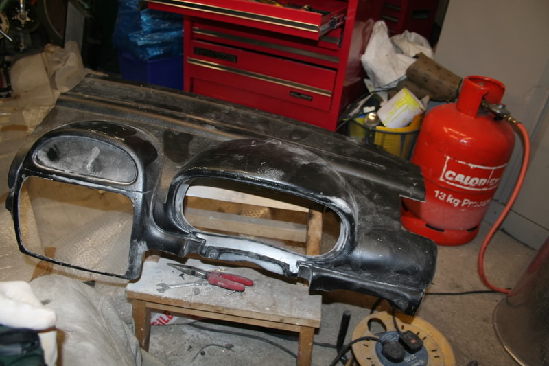

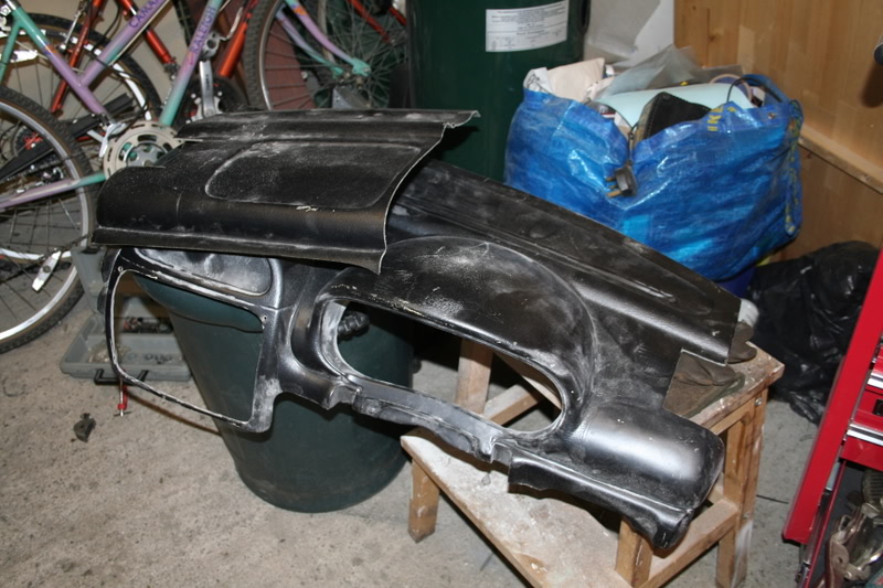

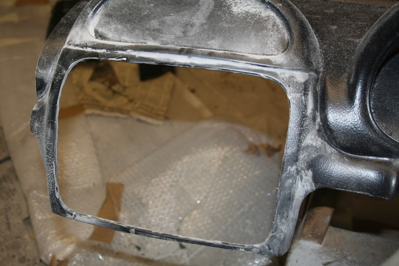

So first of all I started on the radio and vent cut-out, I had already taken the main chunk out with the cutting blade, but to finish it off I had to use the grinding stone...which took forever. Once the rest of it had gone, used the hand file to remove and lumps, sharp edges etc.

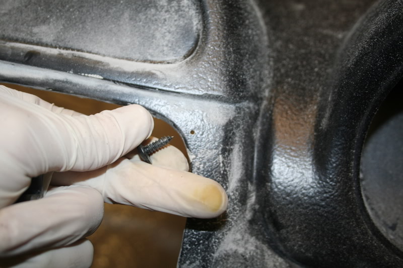

To secure the vent/radio plate to the dash I was originally going to just screw it together, but I wana keep the dash as slick as possible, so did a search on good bonding agent and chose tiger seal (well they ran out of tiger seal, but this stuff is basically the same..you can hang off it in about 20mins LOL, to hold the surround while the bond goes off I’m going to screw it in place. Then once dried I will remove the screws and fill and flat the holes. :D so I used a wide head self tapper, and predrilled both the dash and insert ready.
Quick snap of the bonding ( I bought three, as I’m going to be bonding the rear glass in with it too :D )

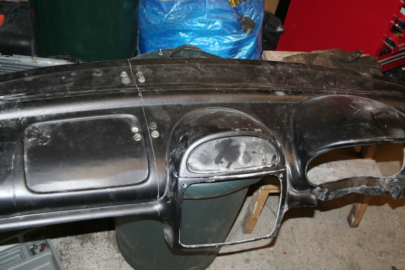

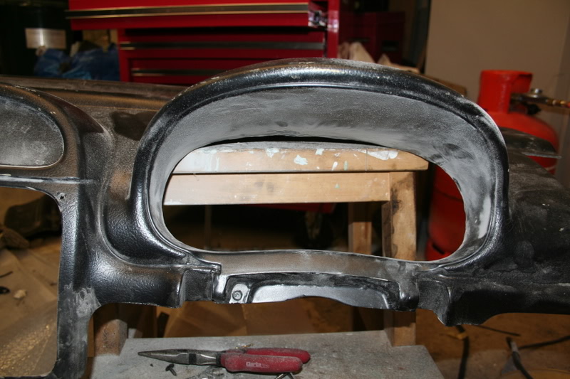

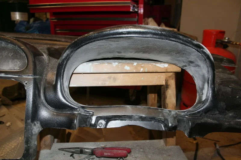

With the vent whole sorted I moved onto the clocks, this wasn’t going to be fun. Due to the shape of the dash I couldn’t get the dremmel into the right place (only the bottom cut could be reached) So it was a case of cut what you can then grind the rest down with the stone, after a good two hours of sanding etc I finished off with the hand file. :D :D
One from above showing both holes cut out and ready to go :D

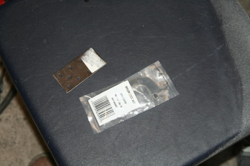

I decided to use steel plates and nylock nuts..so popped to B&Q to pick them up.

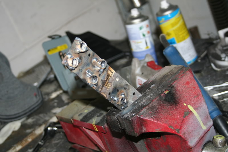

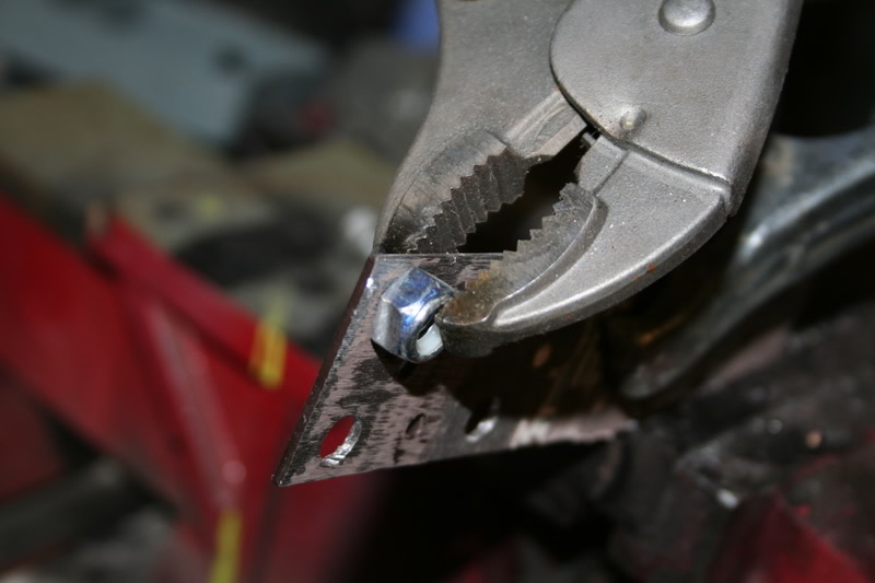

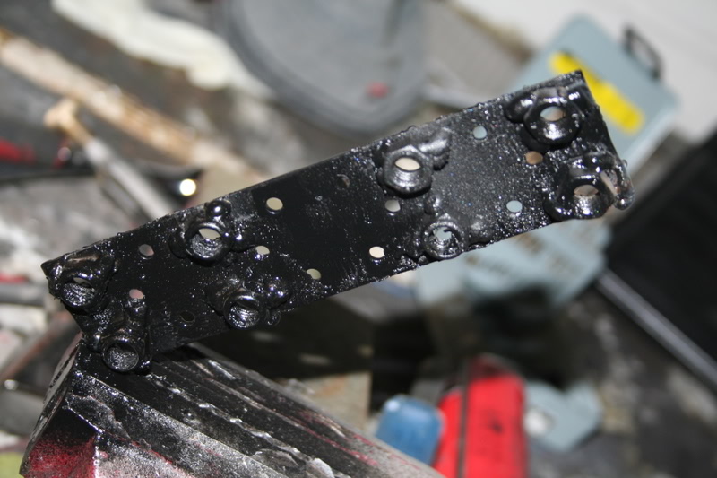

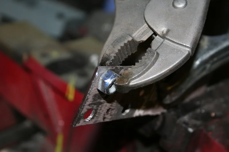

As the both pieces of the dash will have to be assembled whilst it is fitted behind the bars, getting under to hold the nuts in place would be ...fun, id have to get a spanner in there to hold the nylock nut. (if I use normal bolts with the vibrations there’s a good chance after a while the dash will come loose! ) So I decided to tack the nuts to the plate, so one side could be pre-bolted up and then this would hold the bolts in the right place when I fit the second piece.

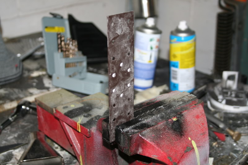

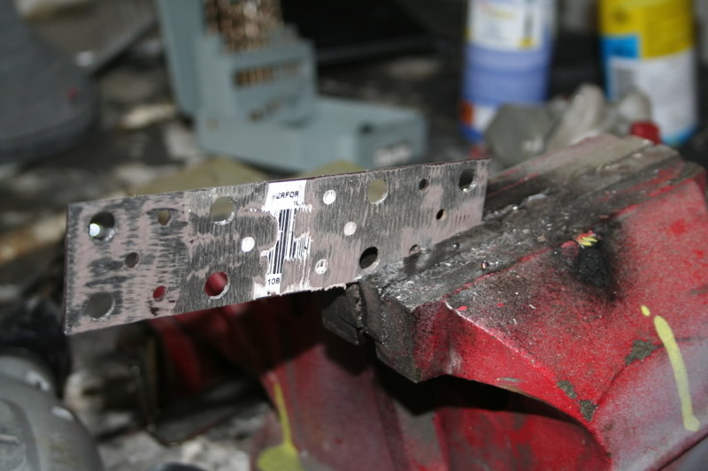

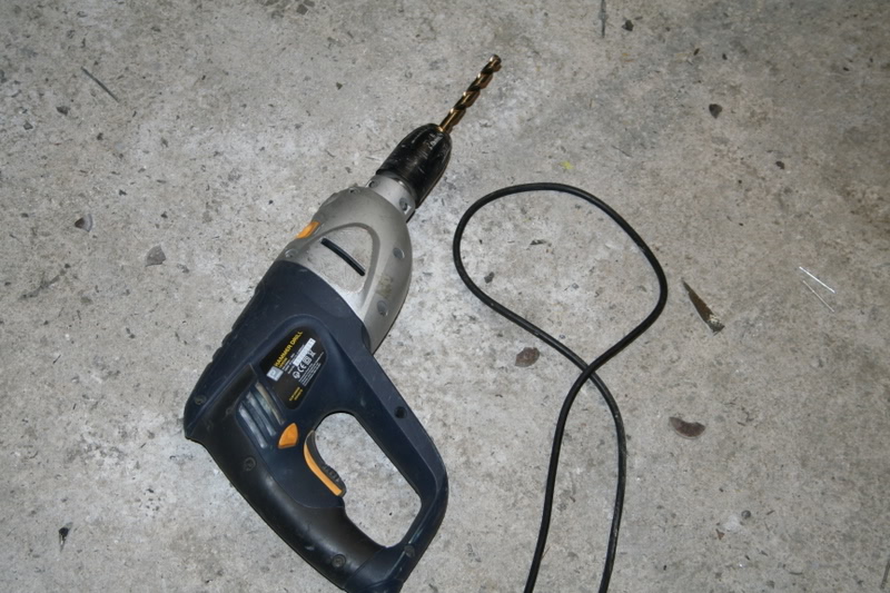

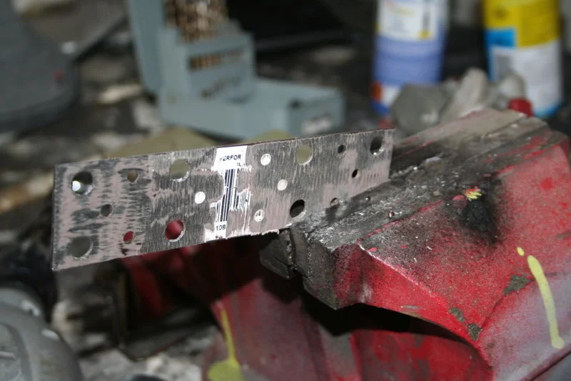

The holes on the steel plate were m4 and the nylocks were m8, so I popped the plate in the vice, then using the power drill and the new co-bolt bits I had bought...I bored the holes to 9mm (a little extra just in case)
I then grinded off all the paint ready to weld the nuts to the steel.

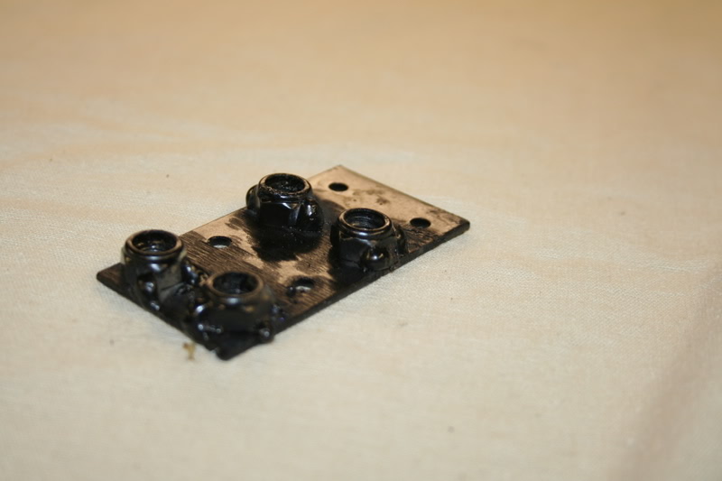

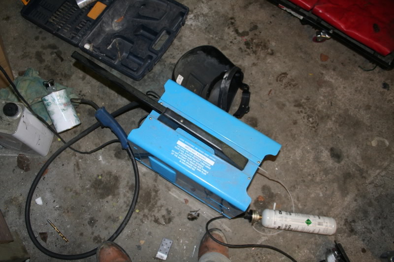

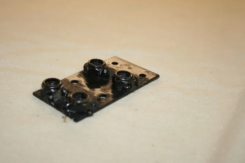

Then carefully one by one I lined up the nut in the centre of the hole, secured it with some grips, double checked the hole.. then welded them in place one by one. I kept the heat down so not to melt the nylock inserts....too much ;)
Half way through the first plate..

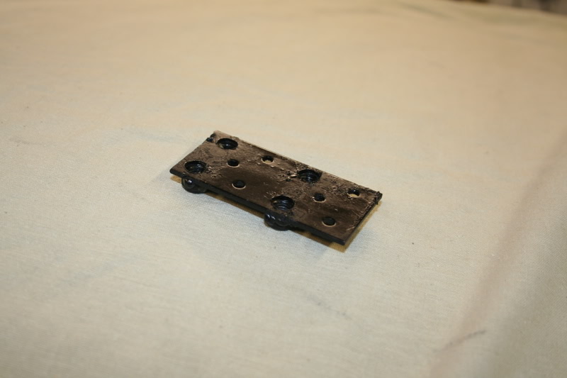

First plate done, gave it two coats of black hammerite to stop it rusting and also if it was ever to be seen through the gap, I wanted it to be black.
I then did the same on a second plate, then chopped the plates in half. Giving my 4 brackets. Turns out I only need 3.. ahh well.

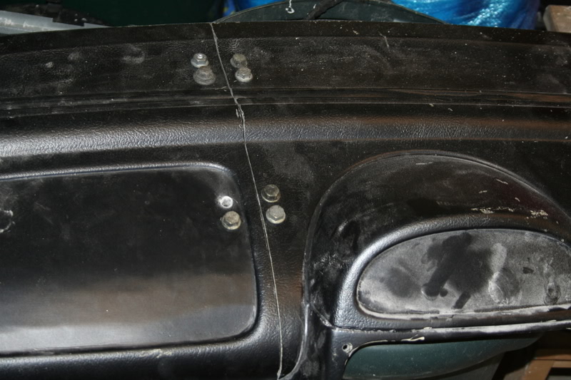

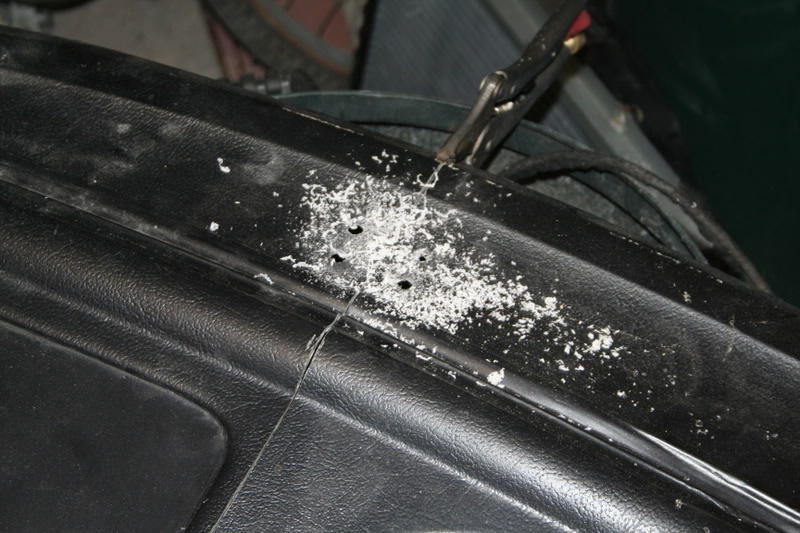

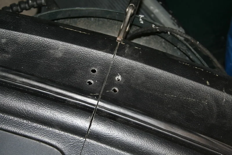

Then I lined the first plate up over dash, using the cordless drill with 4 mm bit, I pre-drilled the centre of each nut, then removed the plate and bored the hole to 9mm (giving a bit of adjustment)
Copied the process on the second mounting point, just one to go now but I ran out of time. Obviously the bolts used their won’t be the final ones, I have ordered some flat head allen key bolts which I am having anodised in black.
But even with the two mounts its very strong and hold the dash in the perfect place :D

welding nylocks? were you dropped on your head as a child?
meh, it worked. they didnt melt! like i said i turned the power down! you big gay!
from now on.. your not allowed to comment on my welding skills/unskills
