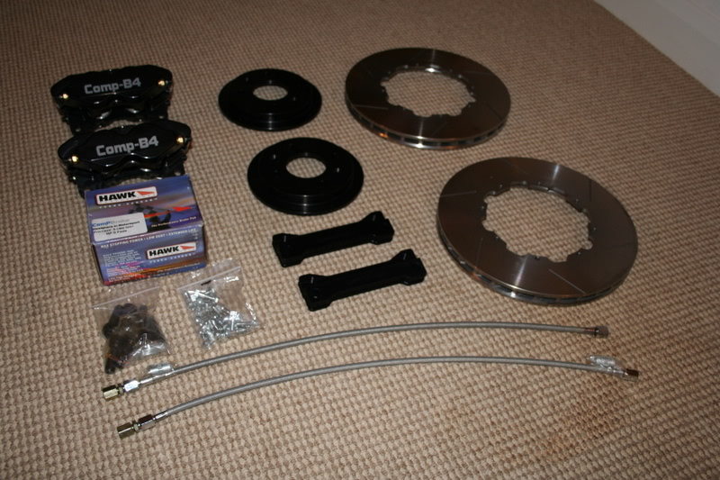

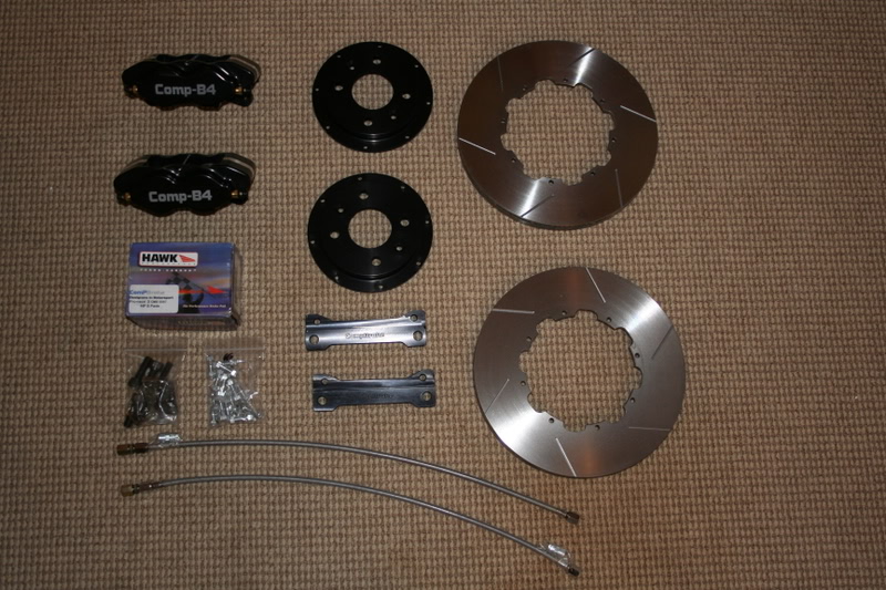

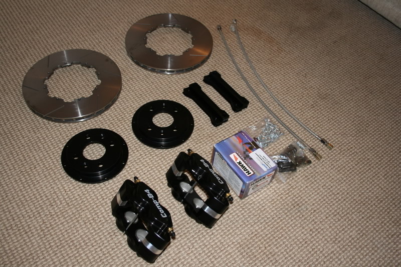

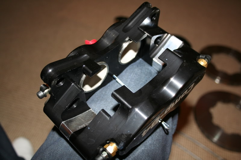

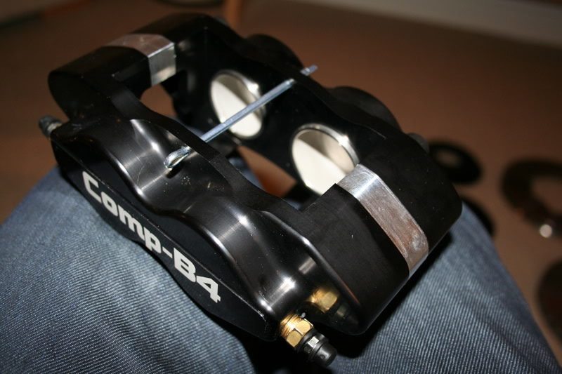

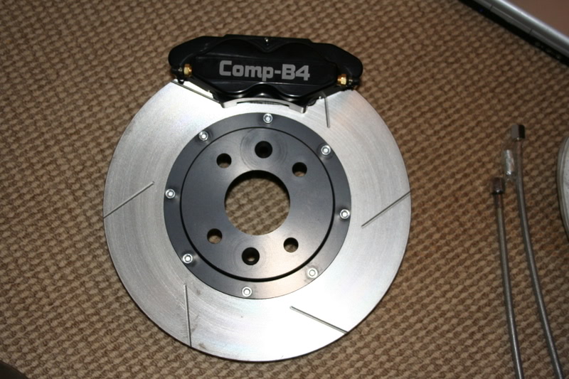

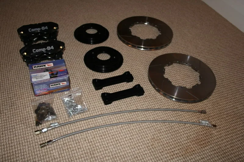

after a few calls, i met up with Steve Fenn from comPBrake. He had a the below kit for sale with
CompBrake Pro Race 3 caliper
CNC alloy brackets
All fixing bolts
295mm x 24mm Power vain rotors
CNC alloy Bells
stainless lines
HAWK fast road pads
ATE superblue racing fluid
picked the kit up ;)

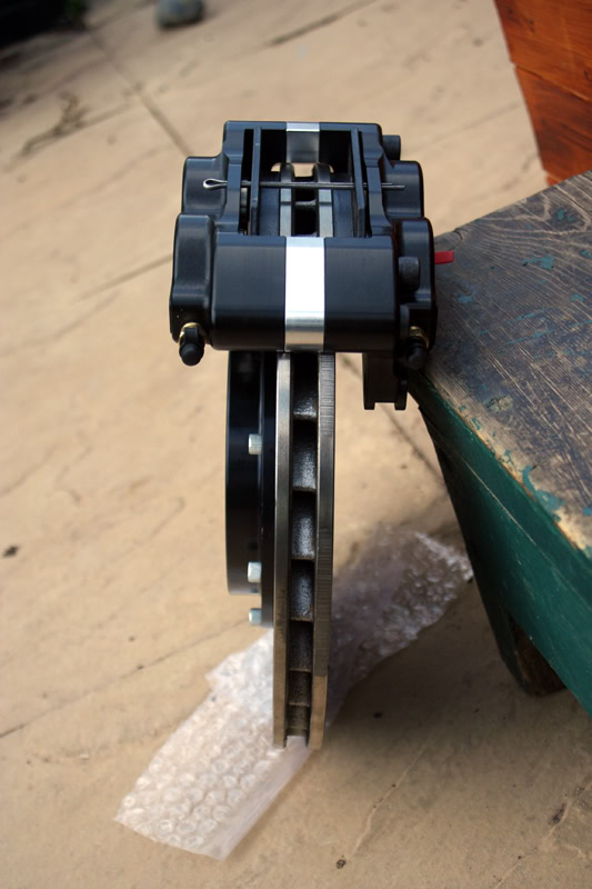

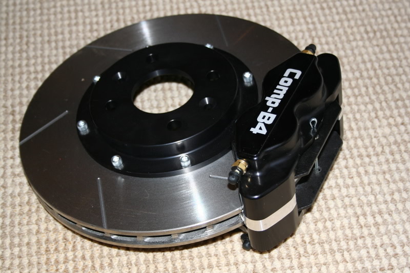

lovely kit but why would this be better than the wilwoods?
granted the discs arent lined up with the pads but thats easily sorted with some slightly bigger discs
there is a larger pad surface area, the calliper is much bigger and less likley to twist on track / hard abuse. the calliper is made of higher grade alloy.
the total piston size is 28% more than the willwoods, but still meets the same size as the MC
there are twice as many pads out there, the midilite calliper is limited IMO
for the same money you get a better calliper, better pads, two piece disks with alloy bells, proper brackets, 15mm bigger disks etc

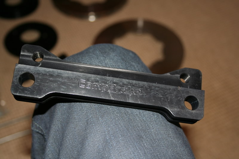

i can see your point, but they should of never over hanged in the first place. i had new brackets made for £80 and they brought the pad 1.5mm in of the disk.
(my old pads had a ridge and bits of the ridge would crack off taking parts of the rest of the pad with it!
the only plus i can see over the willwoods is the pad retaining clip is a much better design than the B4 split pin.
but i sorted that with a 20p m6 cap bolt LOL
Didnt realise the pistons are larger, what pads are you going to use?
would you sell the brackets? I was going to get new discs made for the rotors I have but dont know where to get them from.
