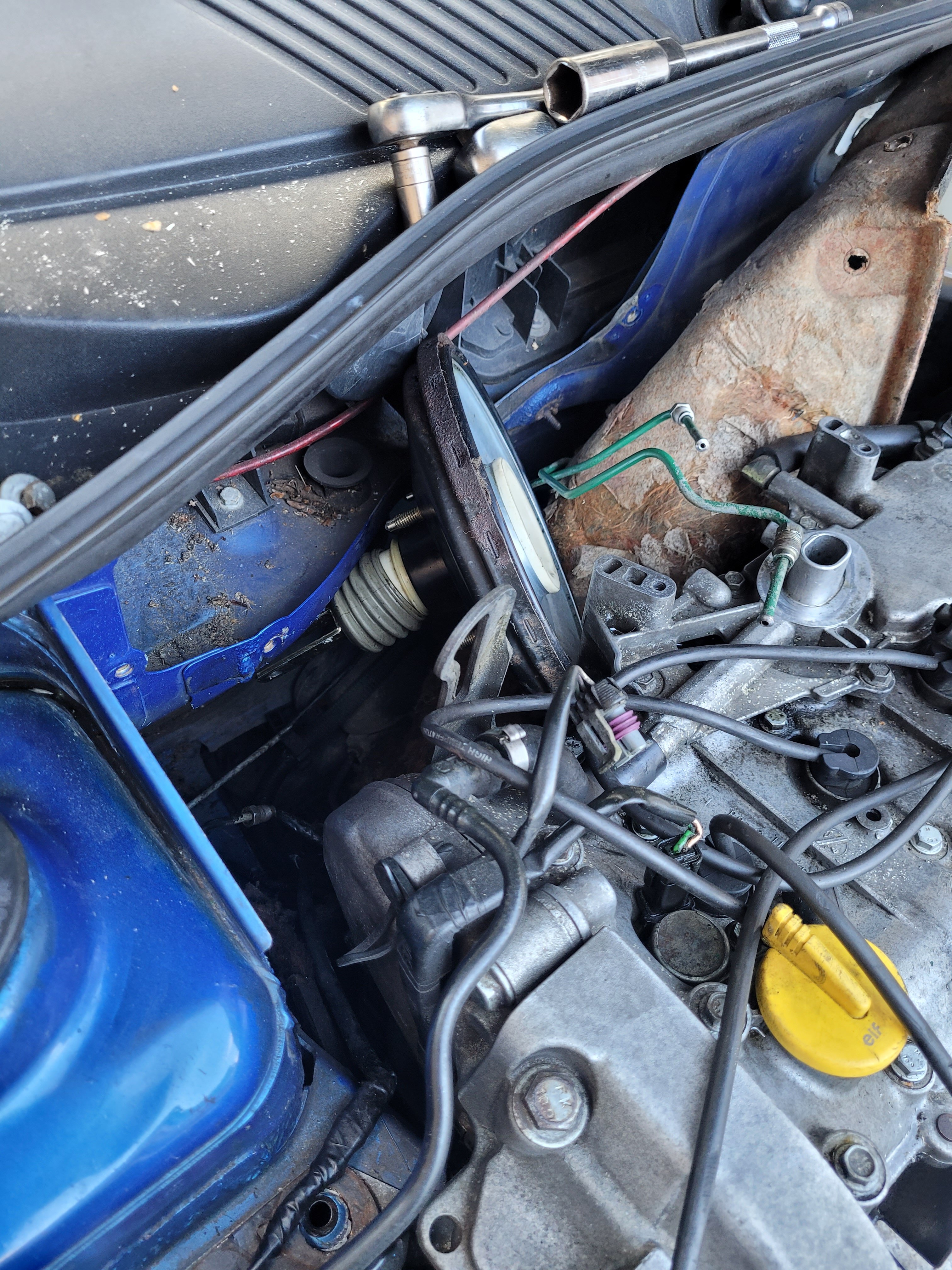

Went to clean behind my arch liners whilst the car was in the air and discovered my master cylinder looking a bit sorry for itself.
Is this a major cause for concern? I’ve just ordered some BH deox gel in hope that it will treat this and turn it back into some sort of metal. But I was wondering if there is anything else I can put on it before I lather it in hammerite.
It’s in a proper shitty place so it’s impossible to see the other side of it too.

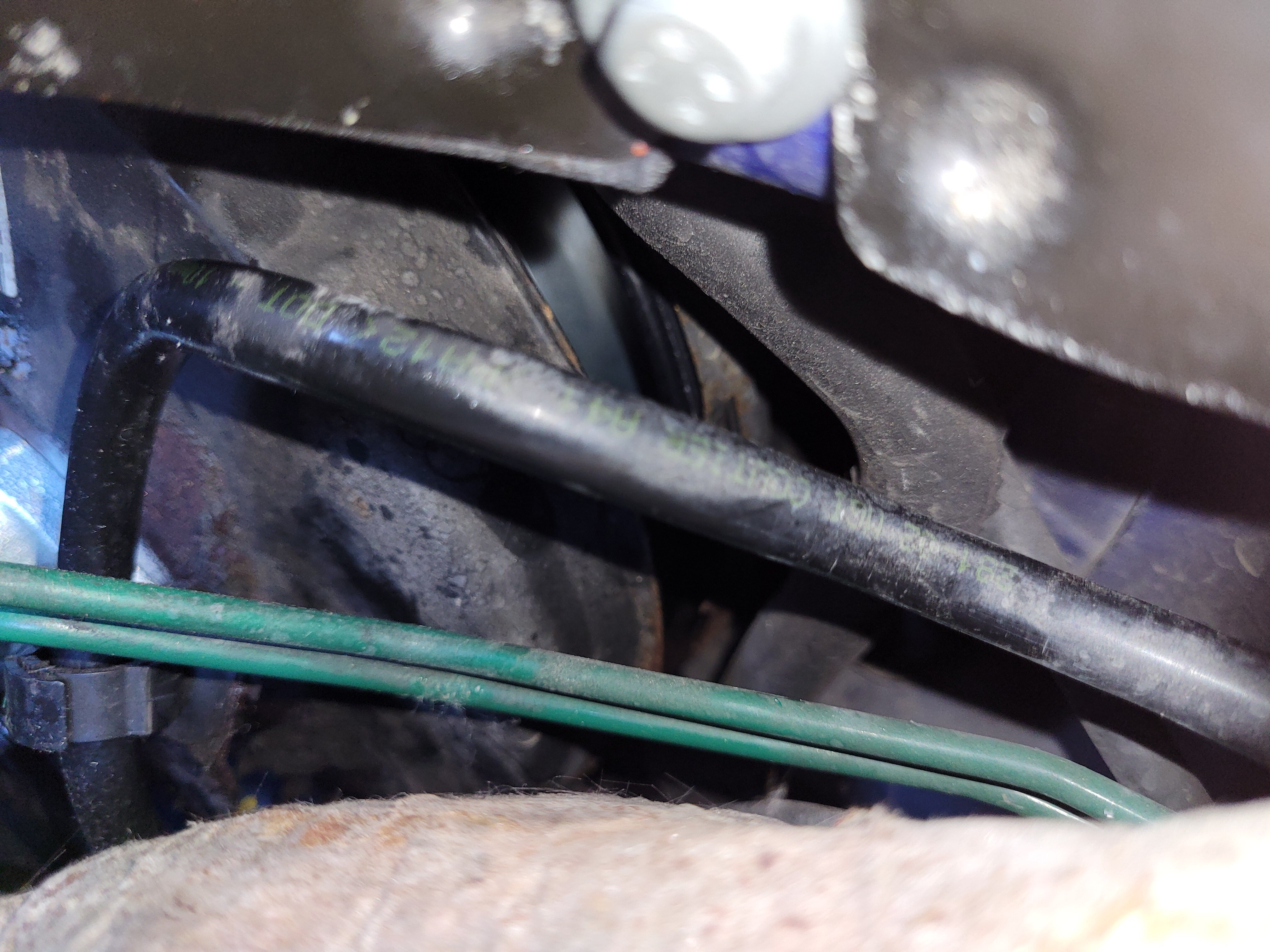

I can show you what the other side will look like and just like the master cylinder, the servo is another thing that I found impossible to find

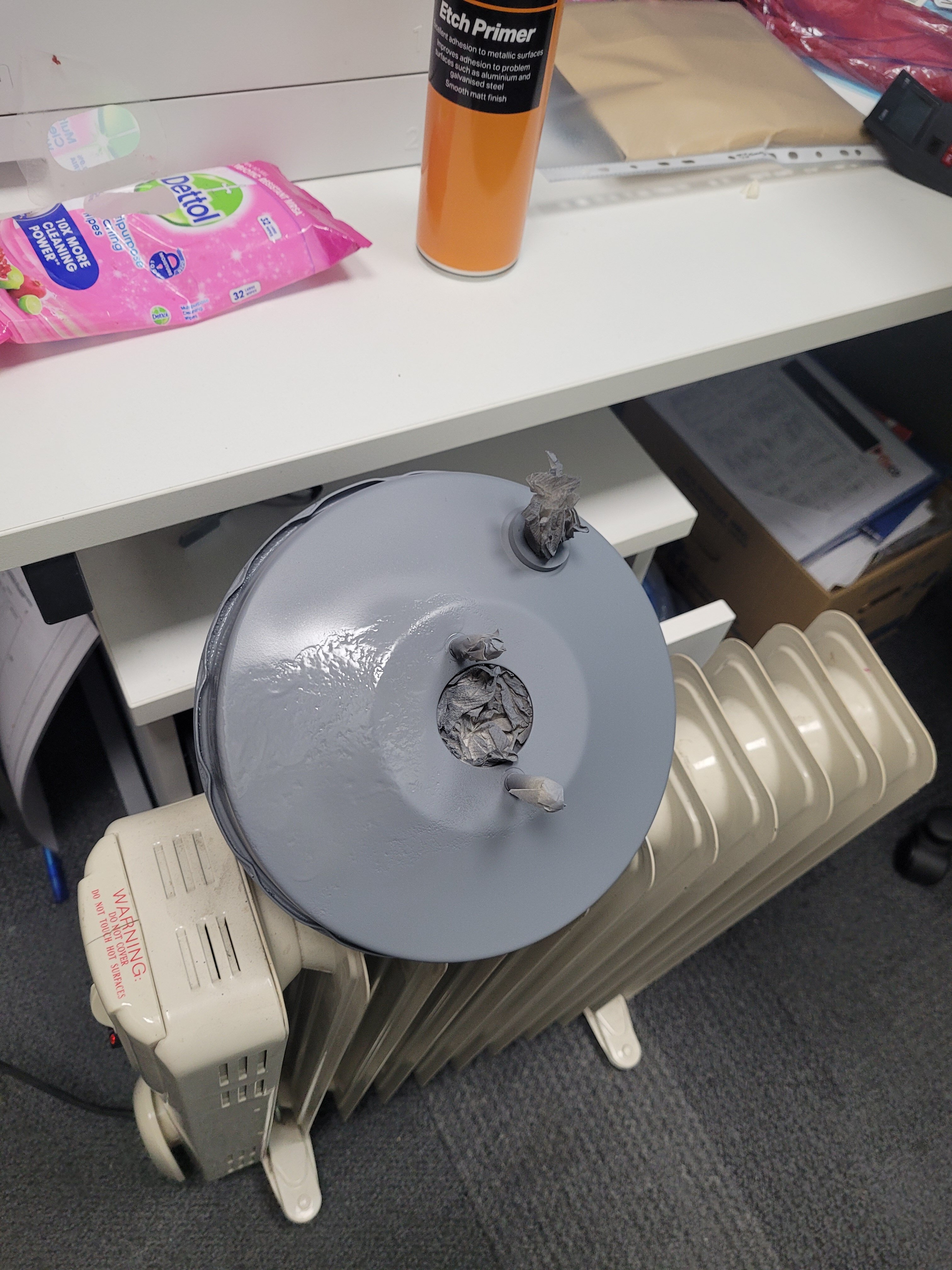

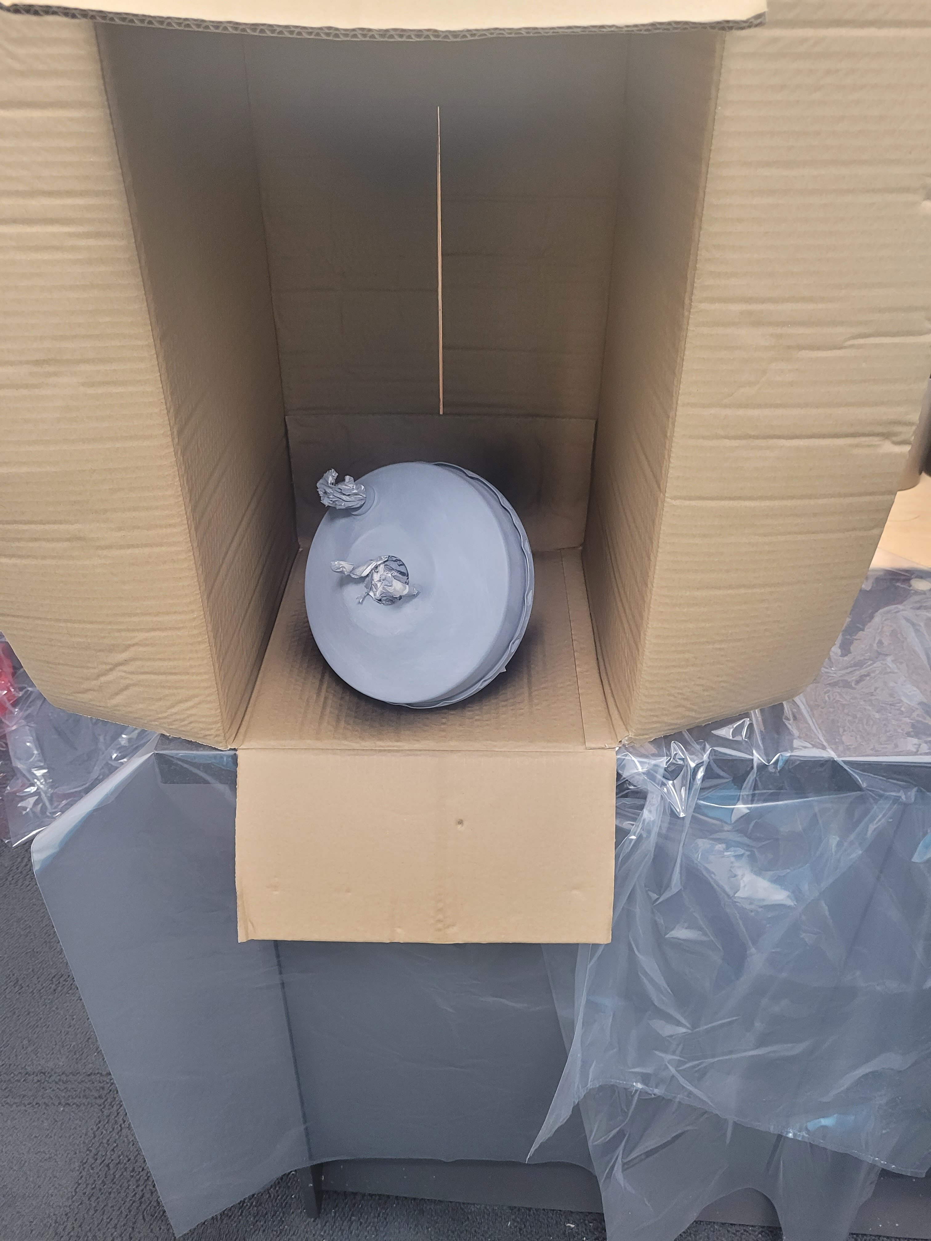

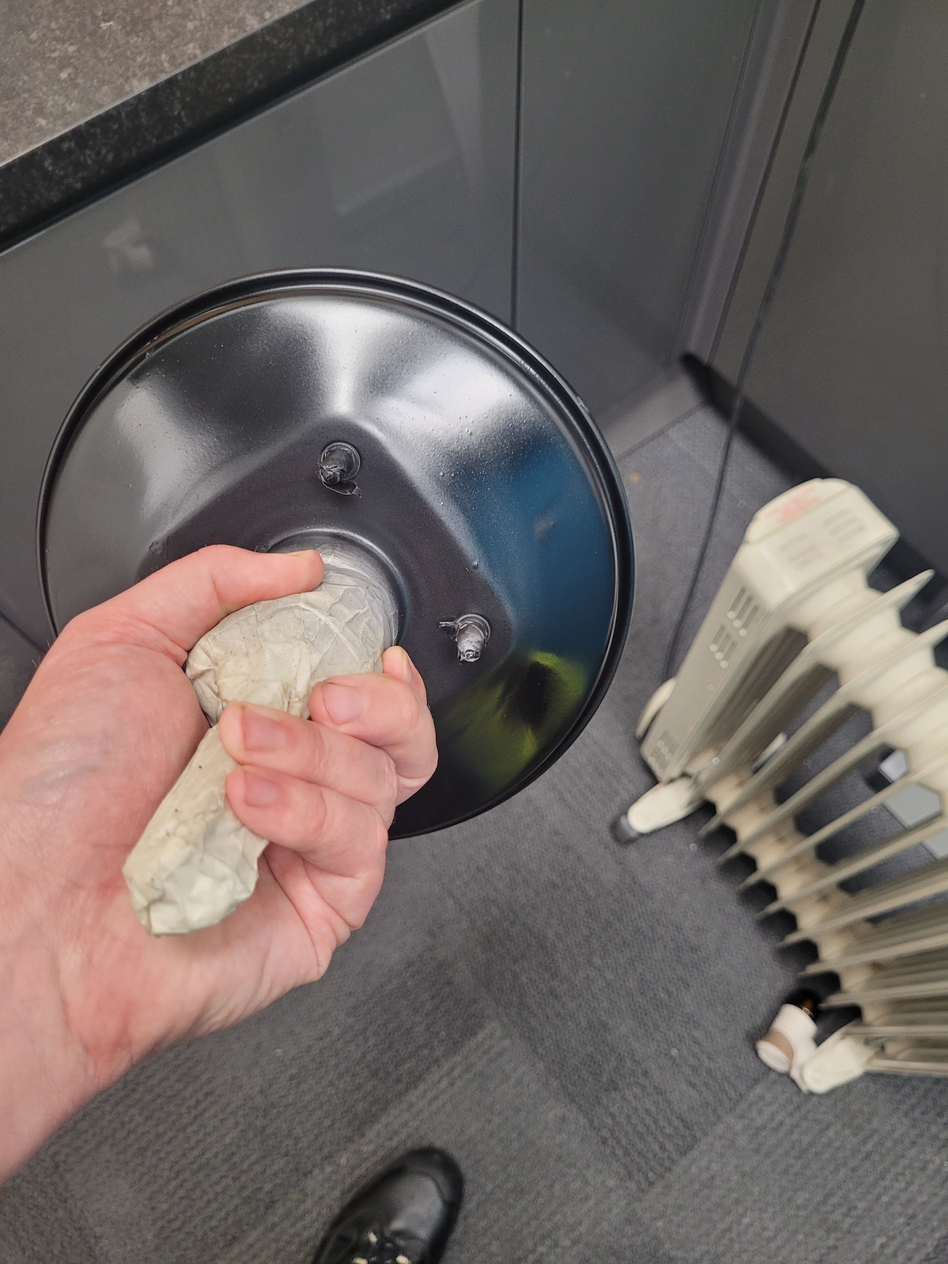

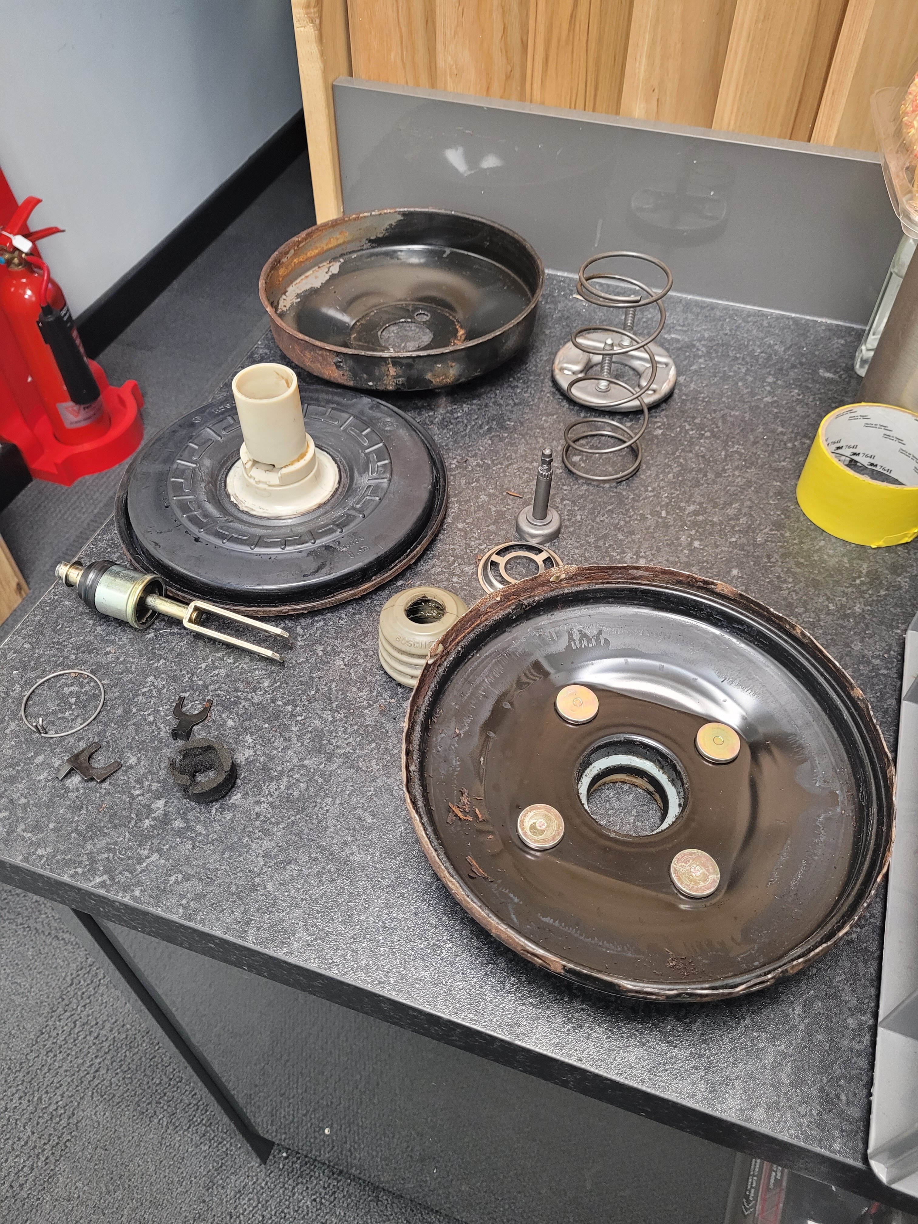

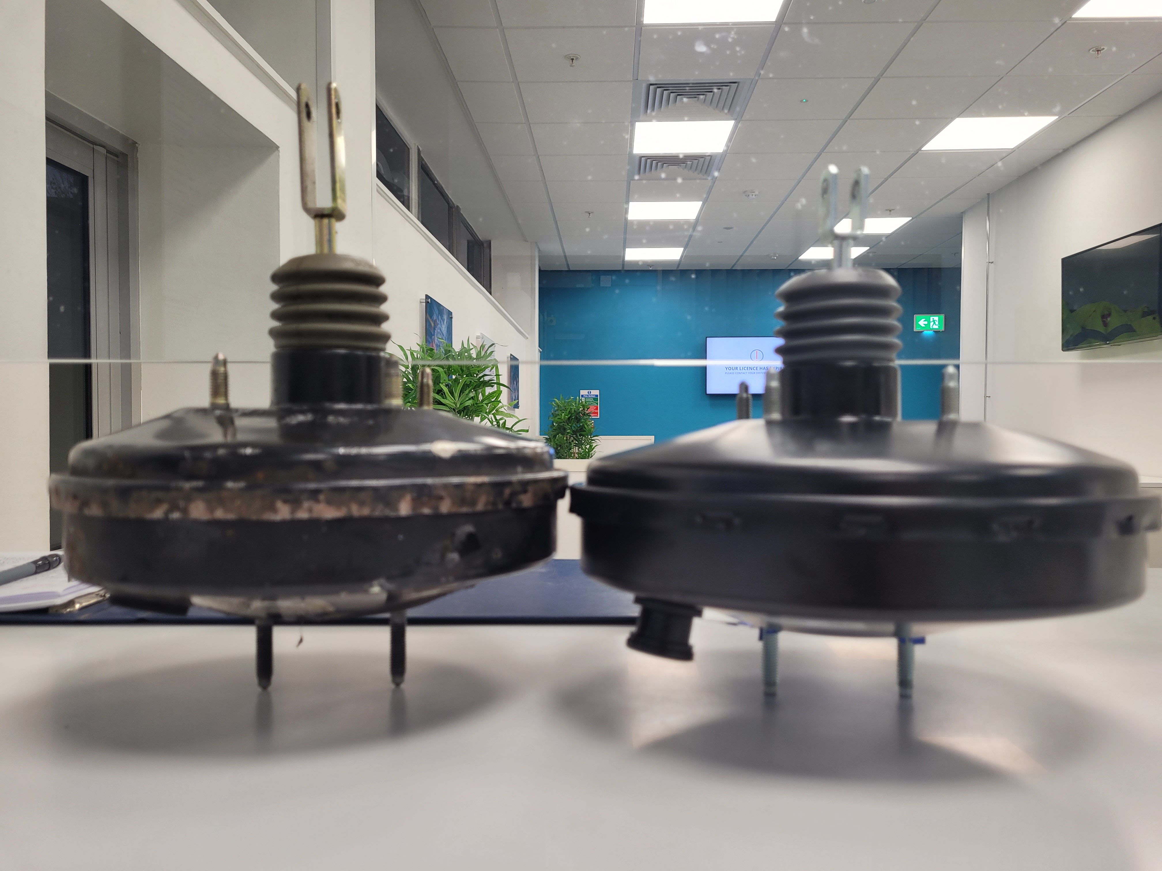

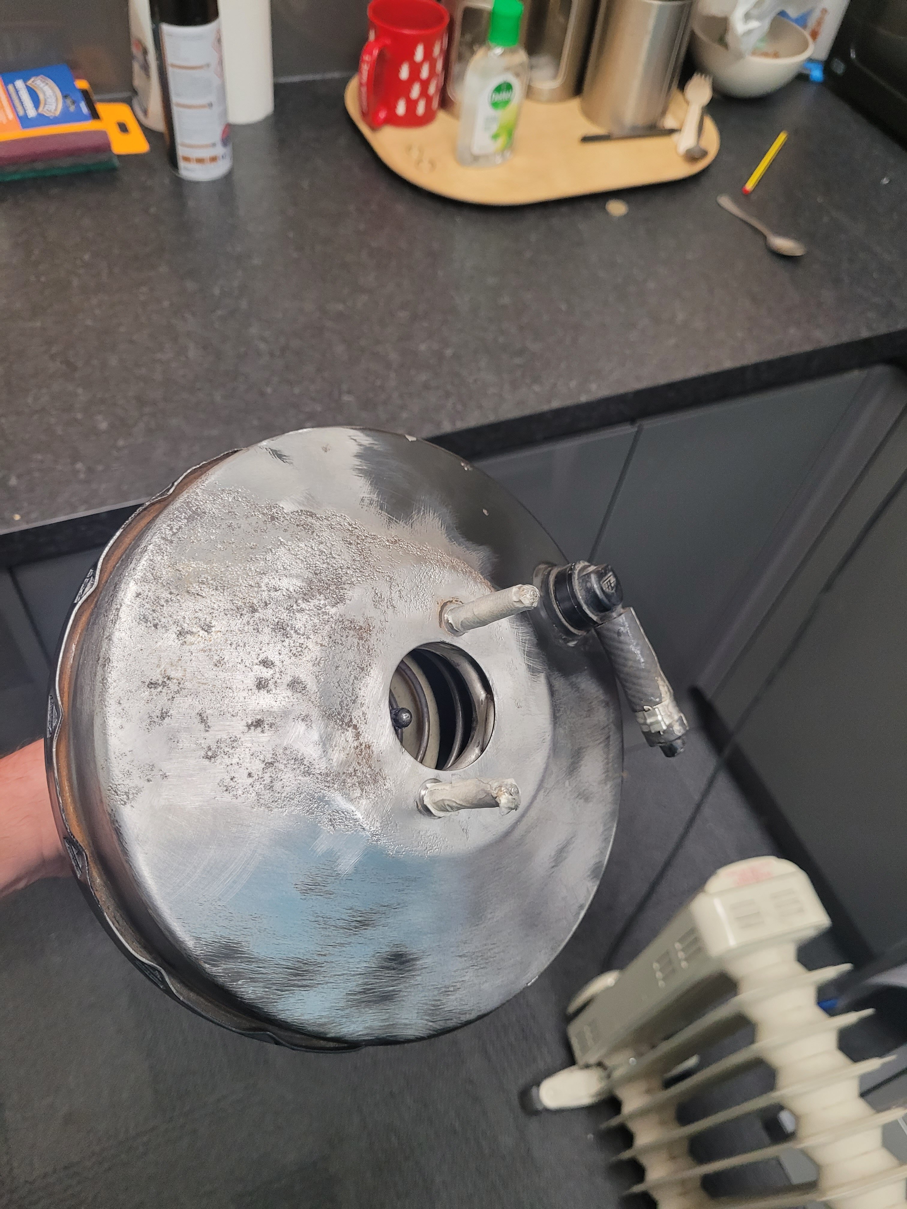

Here's a selection of pics from when I had to piss around with the same problem
I couldn't find a new one at all and the new parts I could find weren't the same
When I finished repainting it I filled the lip around the bottom with silicone sealant to try & stop anything like spilt brake fluid or crap from the road being able to sit inside it and rot it again

Interesting seeing the inside of one. I hated that it had this play before it would move the piston.
