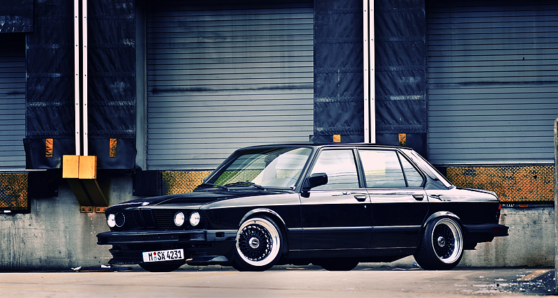

Of course, the first thing I did was put the type A's I had at the time on it.
January 5, 2008
By this point I had sorted out the kinks and cleaned the car up. Mandatory euro plate was put on and nicer pictures were taken.

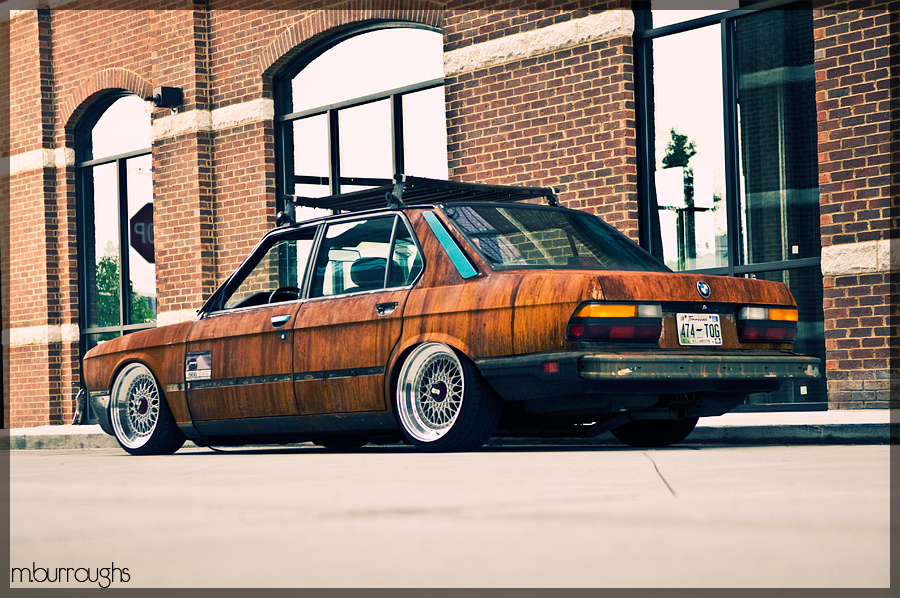

I had finally concocted what I thought was the ultimate rusting solution. I gave it a whirl, and the results I could not have been more happy with.

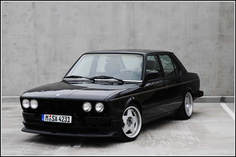

I wanted to run a colored valence since I really liked the way this mk1 pulled it off:
So I tried this:
I wanted something more maroon, as it came out a bit too purple... so I did the next best thing and went for olive drab.
So I had the rusty hood game on lock down. I hadn't shown the car to anyone yet though.

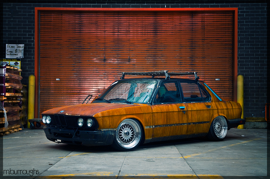

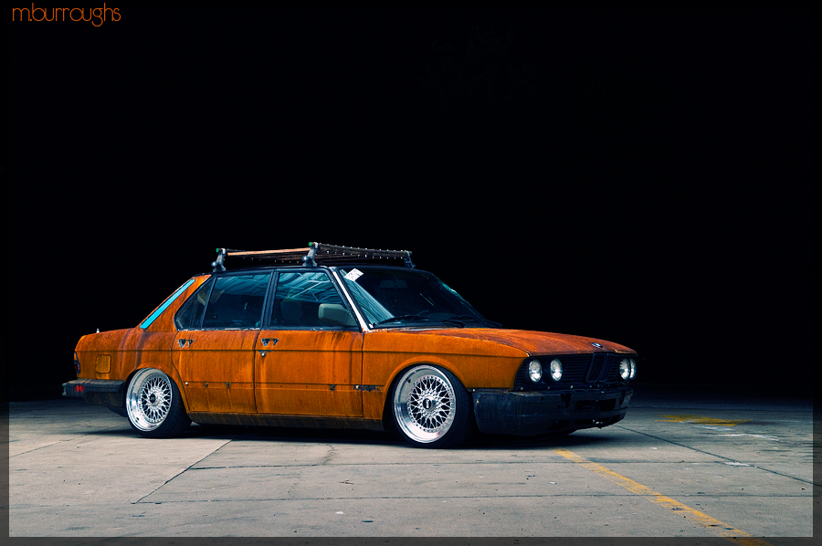

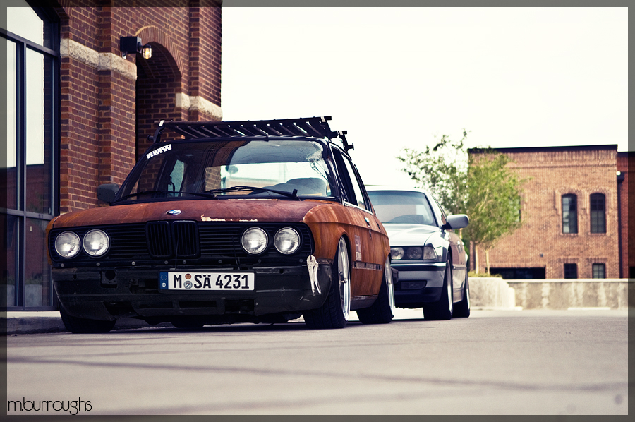

Next on the "How to make a VW" list was a roof rack.
I started by buying Austin's Yakima roof rack.
I bought two oak dowels for the cross bars and several planks of poplar for the slats, and stained them with a "cherry" stain of some sort... I forget what it was.

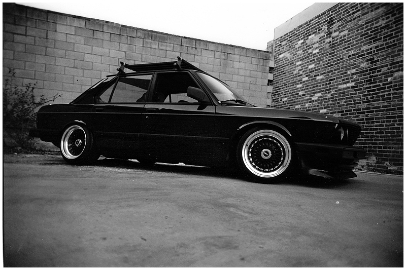

I shot some photos of the car for a class project on Ilford Film. The teacher thought it was weak.
And some others:

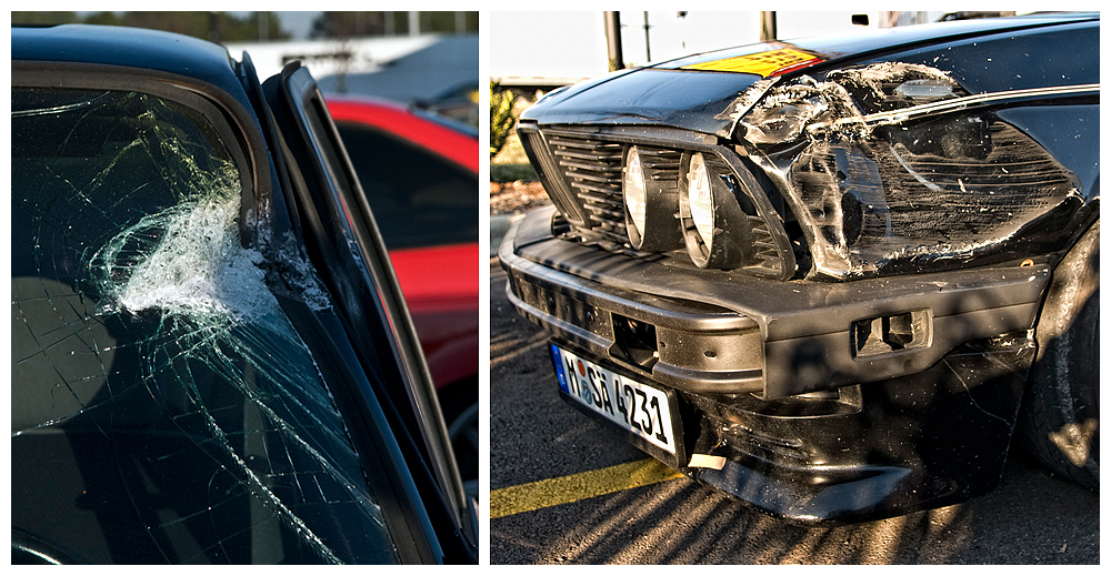

January 30, 2009 was a bitter-sweet day. It was the day my magazine feature landed.
It was also the day I let a friend borrow my car, and they slammed it into the side of a semi-truck.
I got a large insurance check for it, put it in the back of the driveway, and forgot about it. I stripped it of the suspension and goodies for my replacement 6-er...

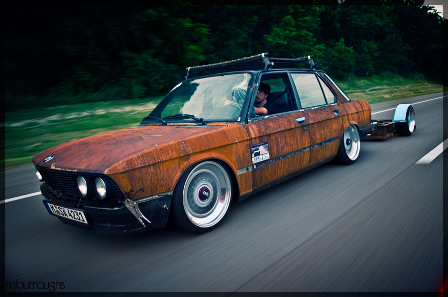

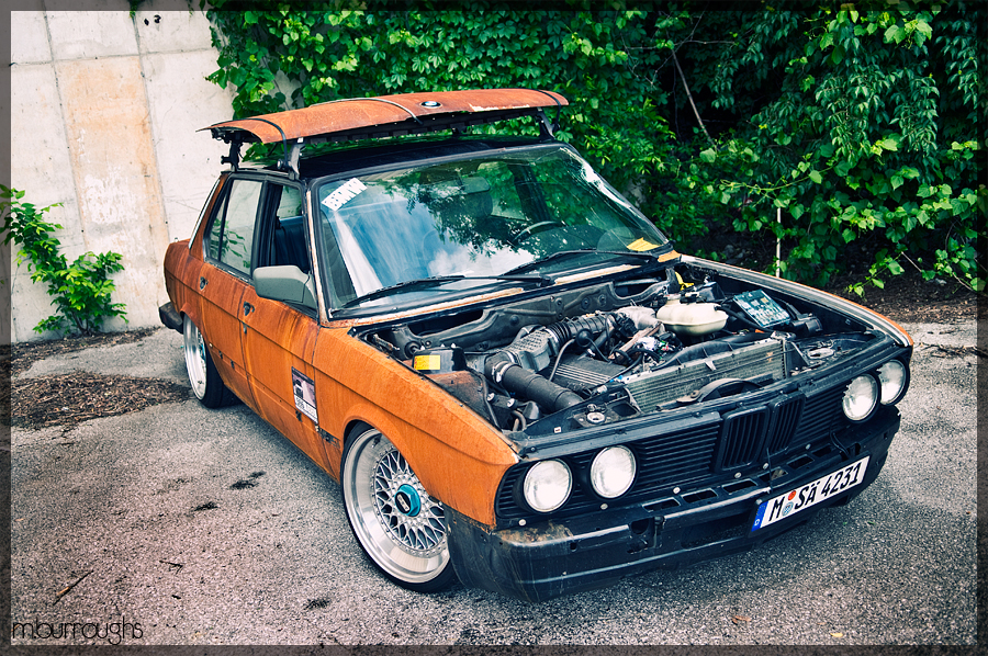

When I had rusted the hood, I wanted to rust the whole car, but couldn't murder my car like that. After all, it's like a delayed lethal injection.
Well, there I was... I had an E28 that had put money in my pocket and was either going to go to the junk yard, or I could give it one last hurrah....
I'm sure you already know what I did.
April 27, 2009

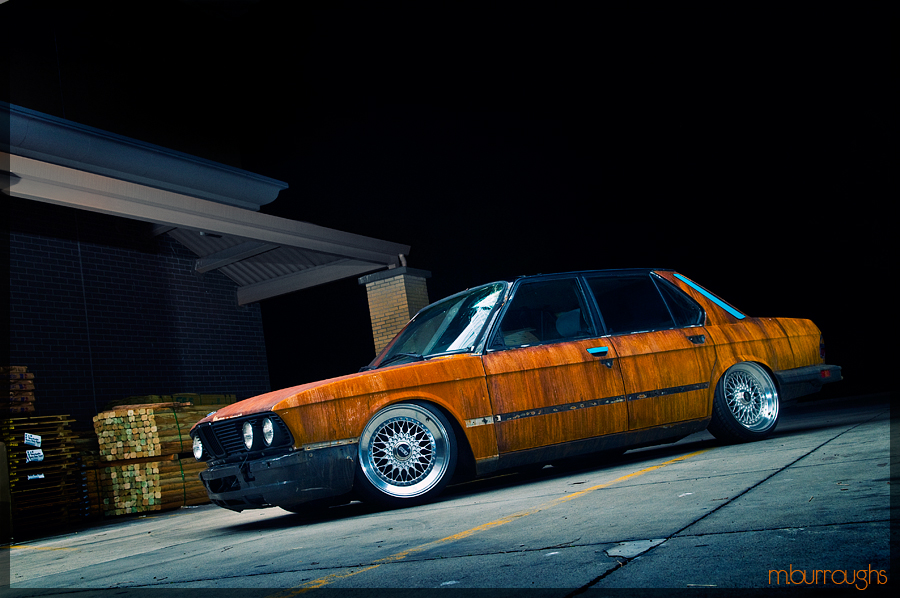

It took 3 days and a LOT of paint removal pads... but I got 'er done.

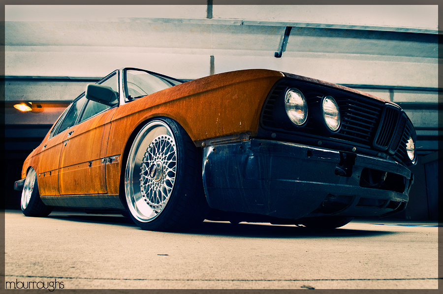

I whipped out the same concoction I used to rust the hood, and gave the car a dousing... unfortunately, it didn't work as well.
I went back to the drawing board, figured out an even better solution, and within 4 hours, I had a rusty E28.

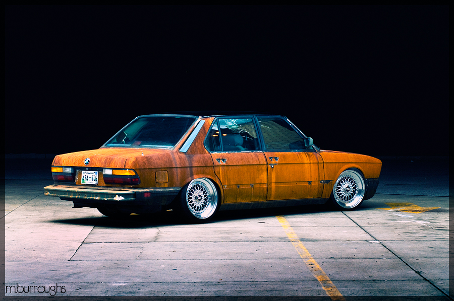

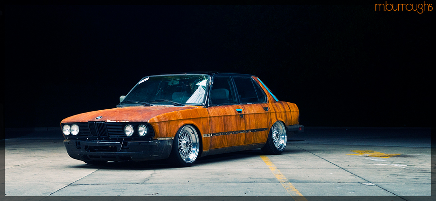

Rusty was born.
I hit the car again with the solution and really got the rust to darken down a bit, to what everyone saw. I also yanked the RSs from the 6, and lastly, I chopped those springs to hell.

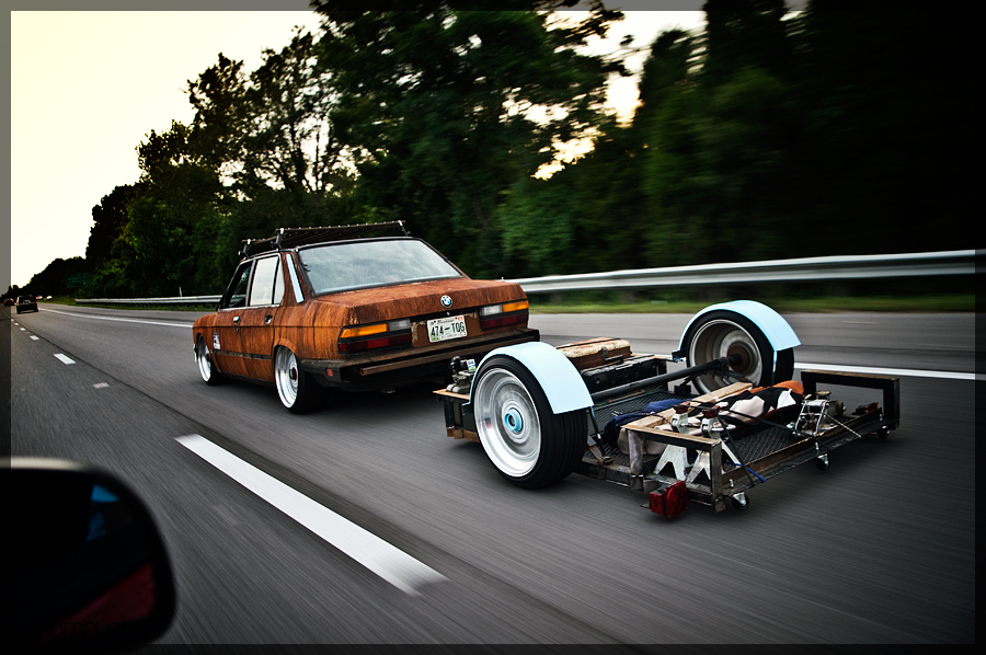

I've got build pics of the trailer somewhere but I can't find them.

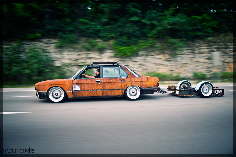

What we did was cut the rails off of the perimeter of the trailer, removed the axle, and flipped the trailer.
We welded the railings back on upside-down, and mounted the axle to the top (previously the bottom) of the leaf springs.
Result?
Dumped trailer.
Up next? California!

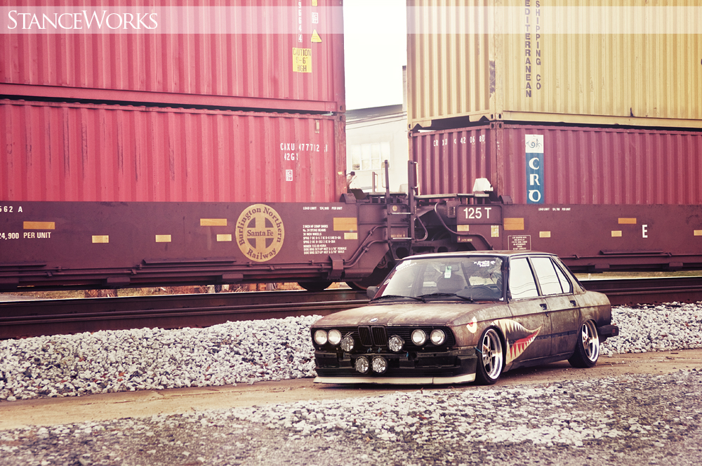

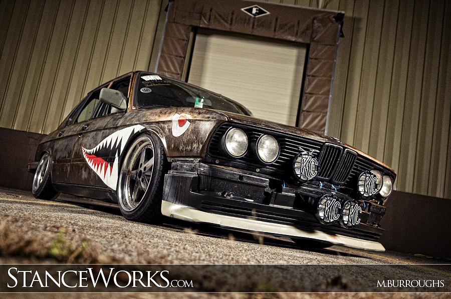

Meanwhile, while I was in TX, magazine feature number two hit shelves in S3 Mag.
November 16, 2009

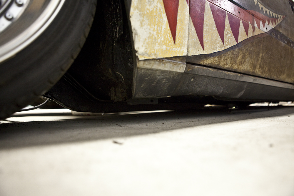

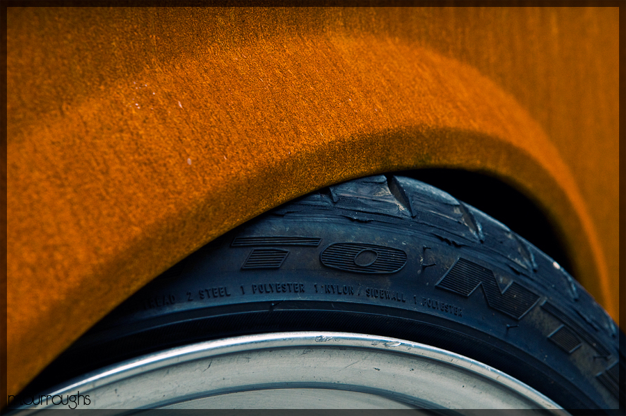

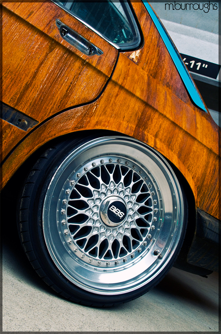

I had started to grow tired of the orange rust, so I switched it up a bit.
Webb and I sanded the car partially down. Enough to knock the top layer of rust off, but not quite all of it. We followed that with a glaze of Naval Jelly over the entire car. We wiped it all off, then coated the car in fresh motor oil.
Add some P40 mustang graphics, hand painted by yours truly (and my momma!) and keep the 17s on and you have the 2nd iteration of Rusty.
I didn't do a whole lot to the car for a while. Here are a few other pics after the oil dried.
And my favorite photo of the car to date.

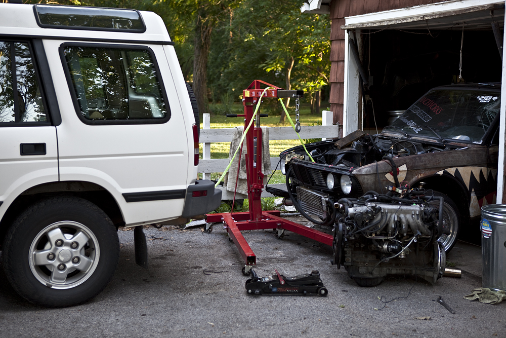

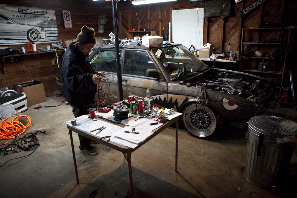

We decided to pull the motor and begin stripping it. It had lived a good, long life.
The final photos:
Engine, wheels, suspension out:
The beast, 500,000+ miles.
But of course Rusty could never die. You should have known that.
Parts began to arrive.
First, I bought a euro front end. Austin's to be exact. Austin's beast lives on....

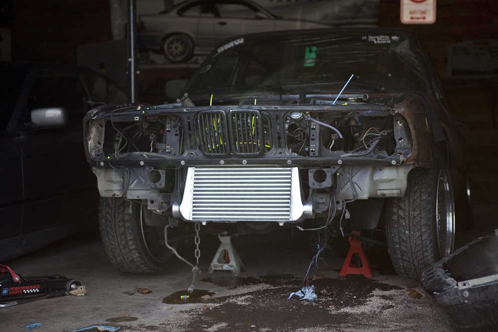

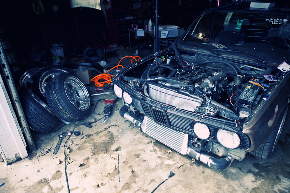

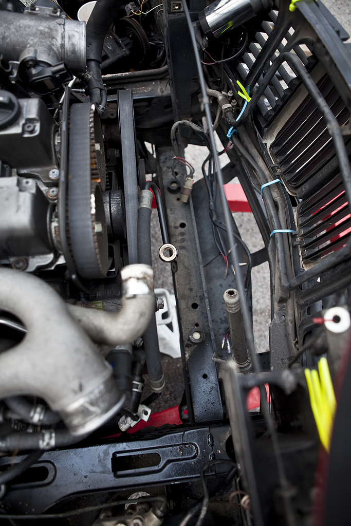

Next was suspending the engine to make engine mounts.
Not much room...
Jerry of course helped me order every damn thing I needed.

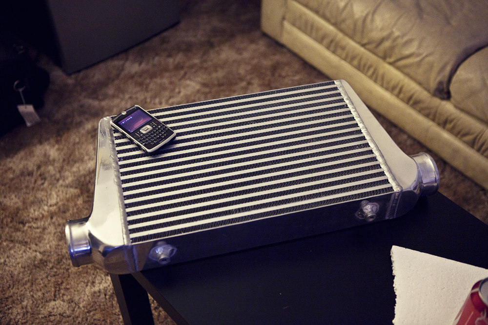

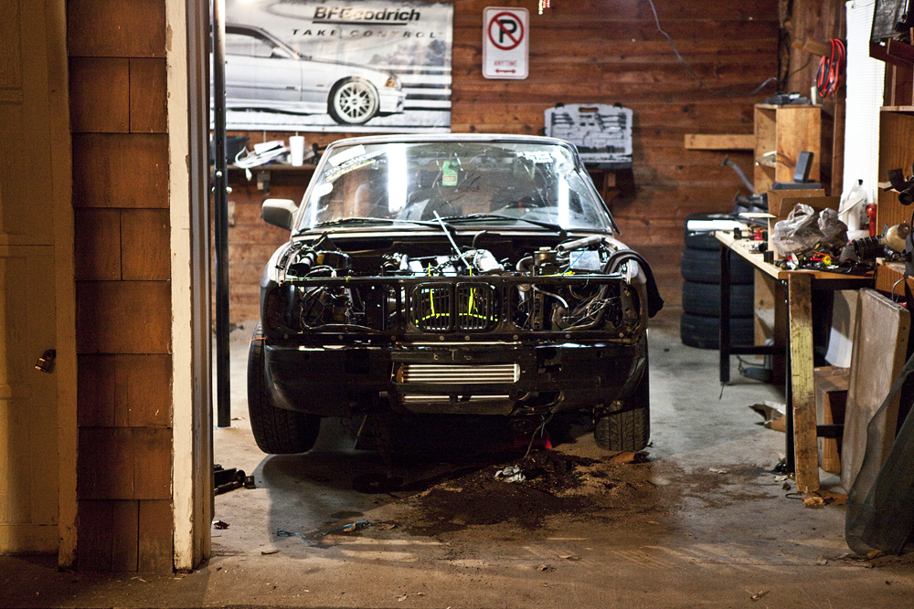

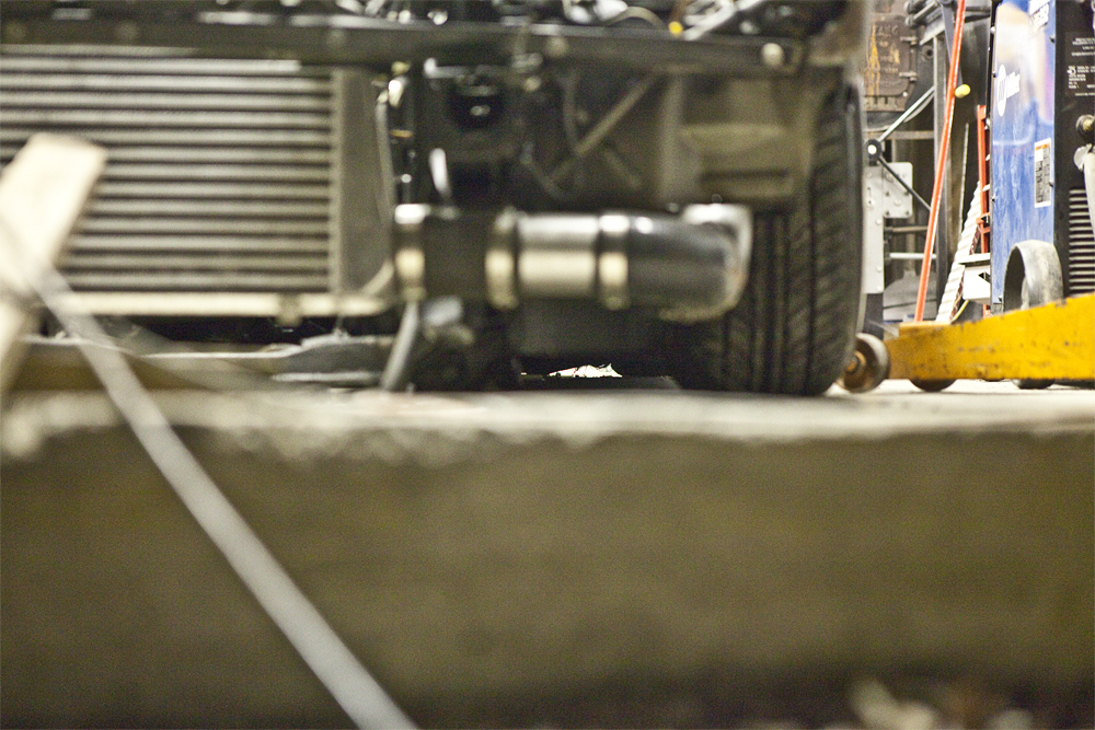

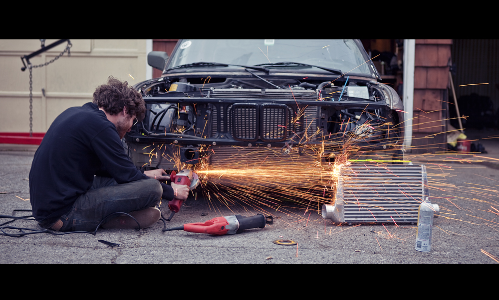

IC showed up:
Test hanging:
Those towhooks gotta go....
And so they did!

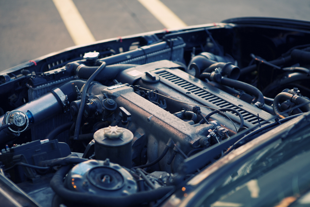

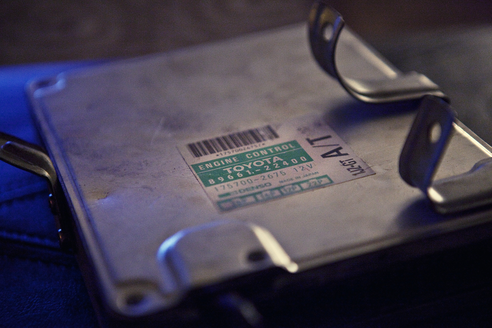

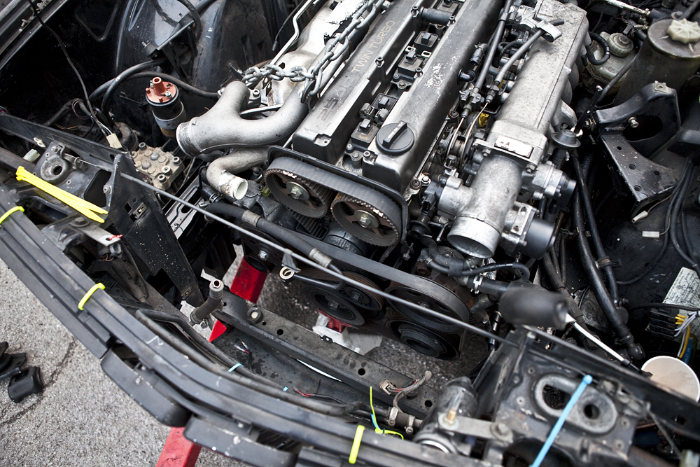

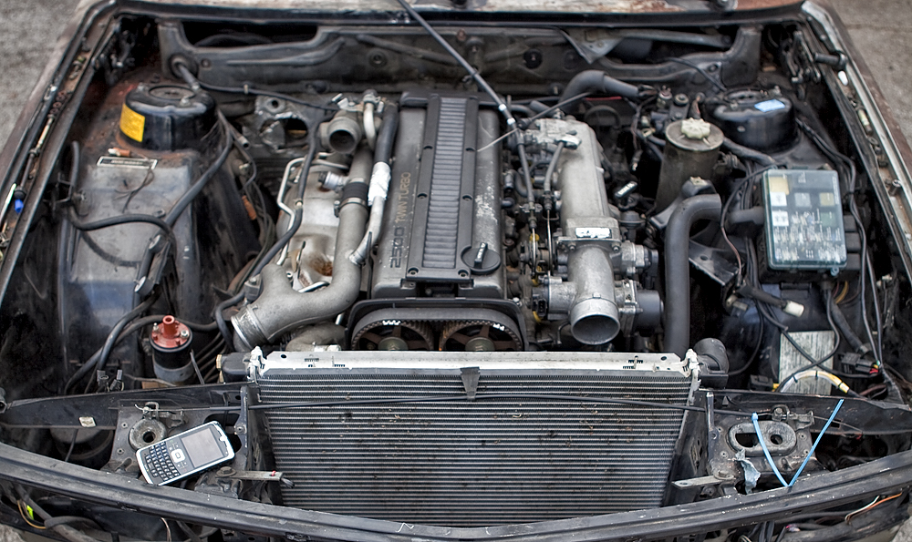

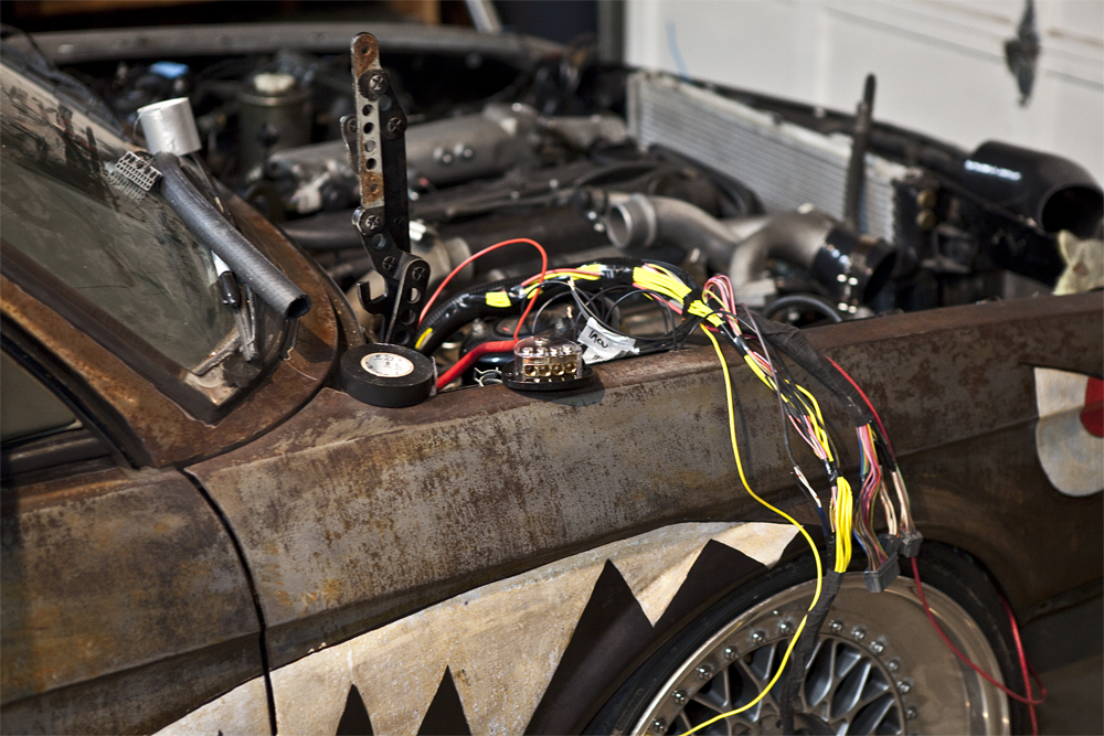

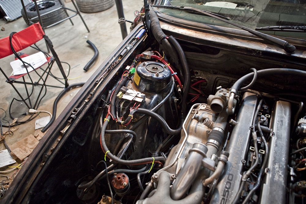

Motor mounts done, engine in...
Jerry went beast-mode on the wiring. s**t never woulda happened without him.
The man, the myth, the god.

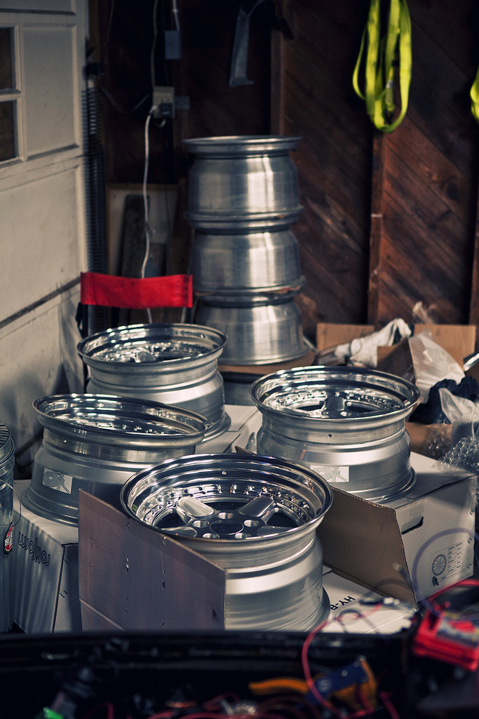

Oh hey, look what showed up thanks to Rotiform..
Test fit...
So I got tires mounted, and ish slowly came together.

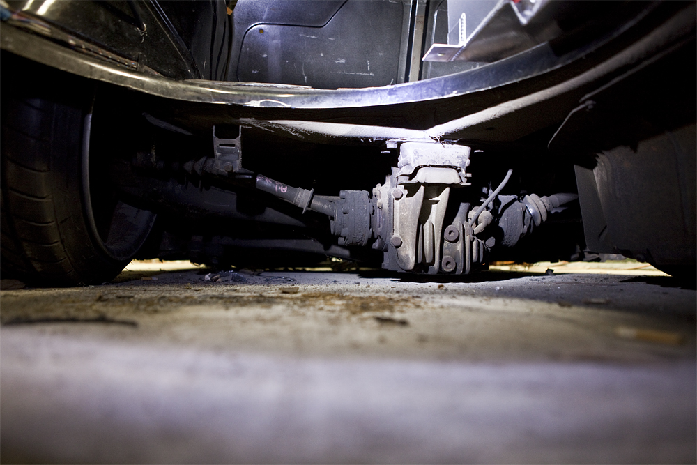

Once we got it driving, during a test drive, the driveshaft U-joint in the back exploded. The driveshaft wrecked everything, and shot about 12 feet in the air after tearing a 14" hole in the floor of the car and killing everything else down there.

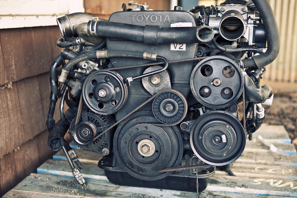

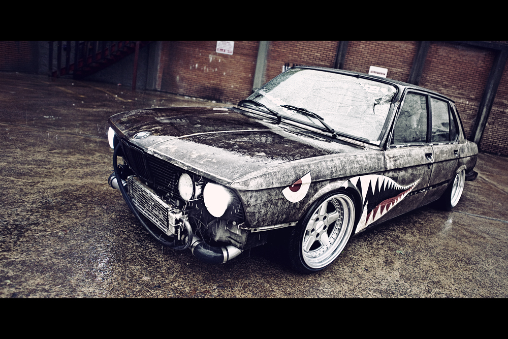

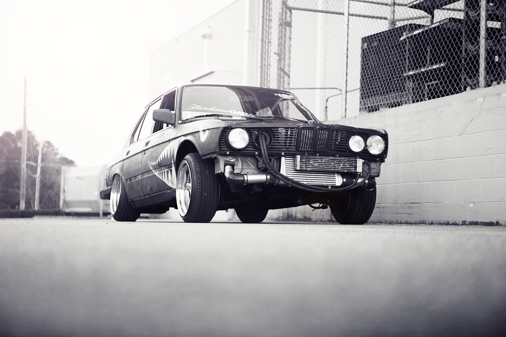

Rusty rises from the dead, 1JZ powered and on air ride. It didn't sit much lower, but of course, that was to come...
The car drove wonderfully from Nashville to Atlanta... all thanks to Jerry once again.
So I rocked it.... for a while.
Two more of my favorite pics of the car.

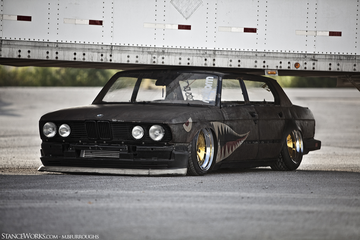

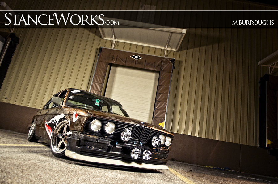

Louise saw the car again, and loved it, so feature number 3 arrived.
And one last photo, which was supposed to be the mag shoot.

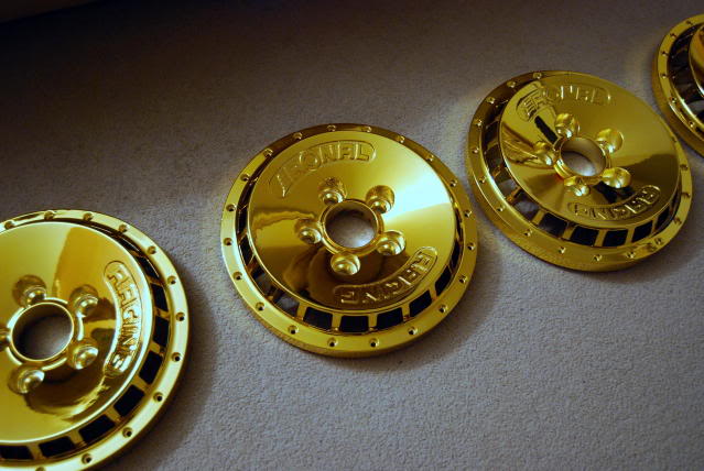

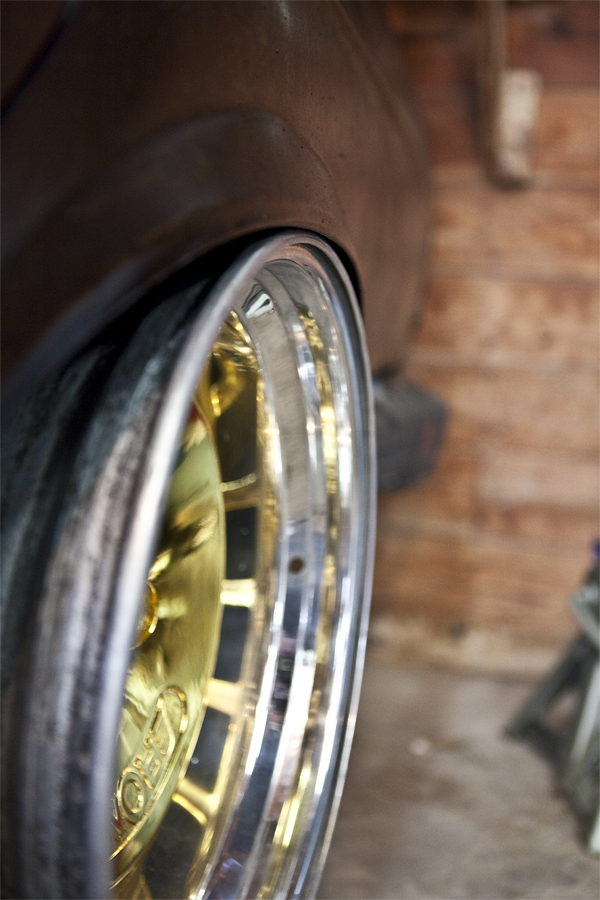

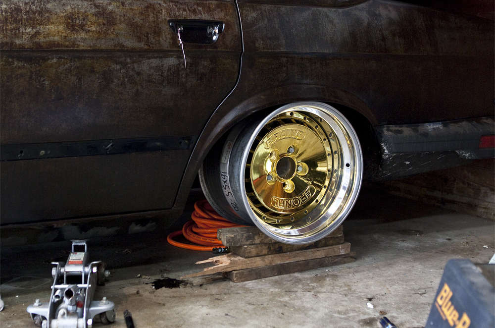

While Rusty sits with no engine and trans, I get a call from brian at Rotiform telling me he got a set of 5x120 Ronal centers in, but he thought I was the only one who could rock 'em. I asked why, and he sent me this photo...
Challenge accepted.
It was serious motivation to bring Rusty back... but just gold wheels wasn't going to work.
Something big needed to be done.

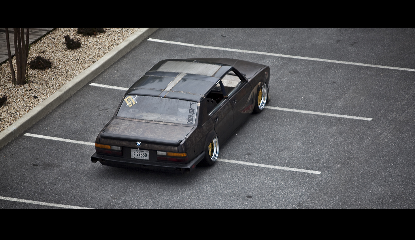

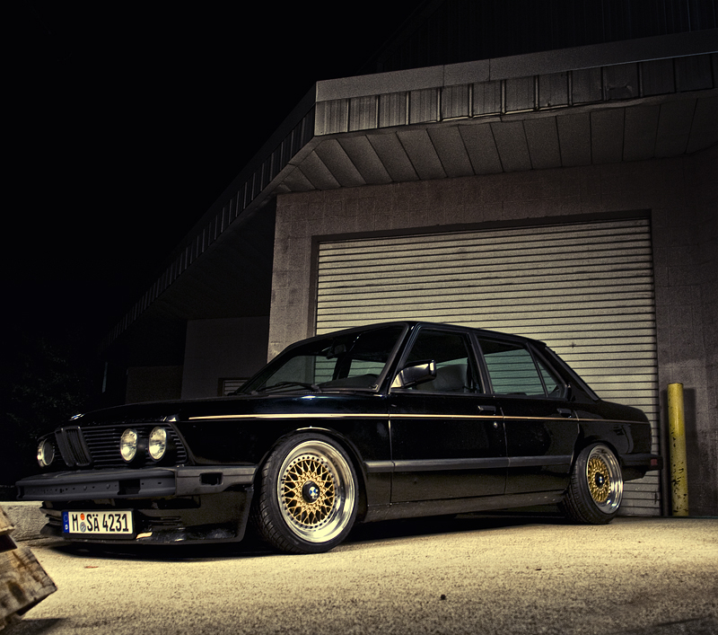

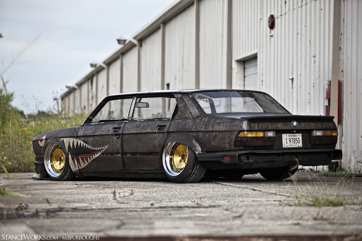

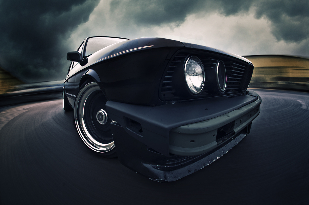

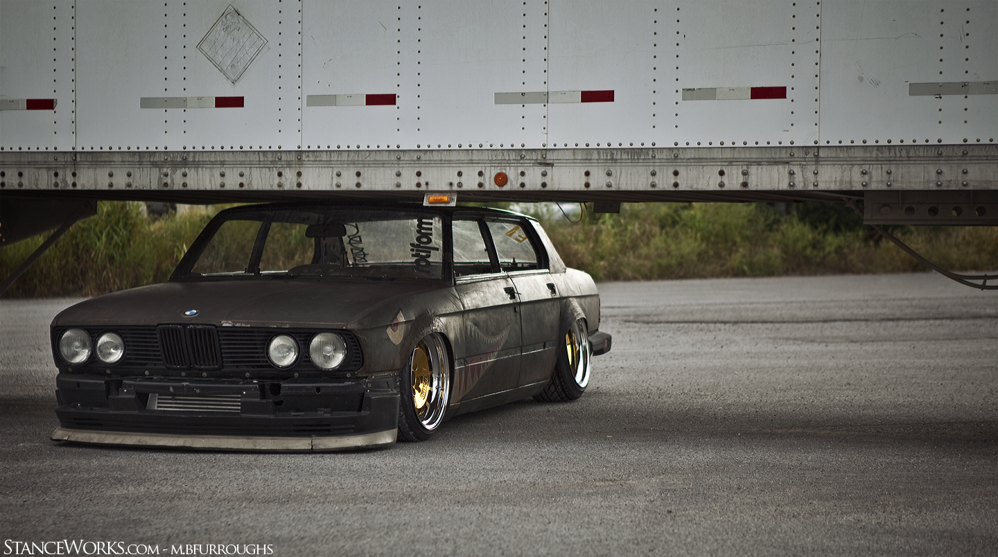

I decided to blacken the body with the diesel oil.
Black and gold, what better combo, right? Well, something was still lacking, but I didn't know what yet...
Brian sent me the ronals set up as 16s, which was the original plan. I mounted 'em up.
If I were static, it would have been perfect.. but aired out, they wouldn't tuck as it was. They'd hit right there, and the car would sit too high for my liking...

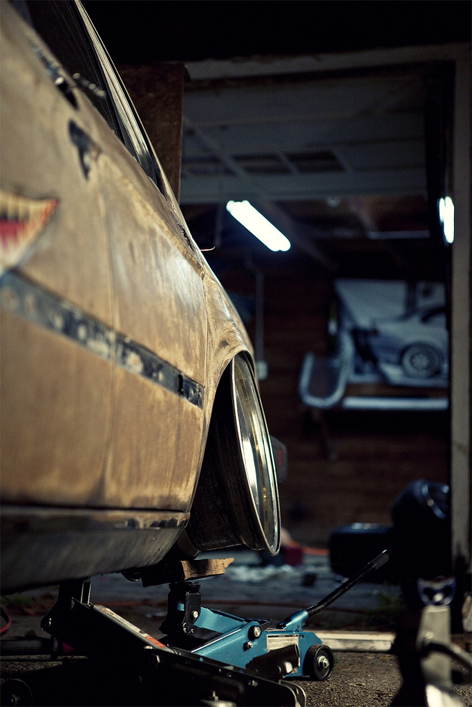

So Cory and I took to the fenders....
If you've ever rolled E28 fenders, you know our pain. Well, you don't, but you think you do.
August 16, 2010
2 nights of rolling got the rear to where we thought would work... but they were 16s. By this point, I knew I wanted to stay with 17s... so we tested with the ACS and some super spacers...
It was sick... but the car still didn't squat down like it should. Realistically, we had a loooong way to go.

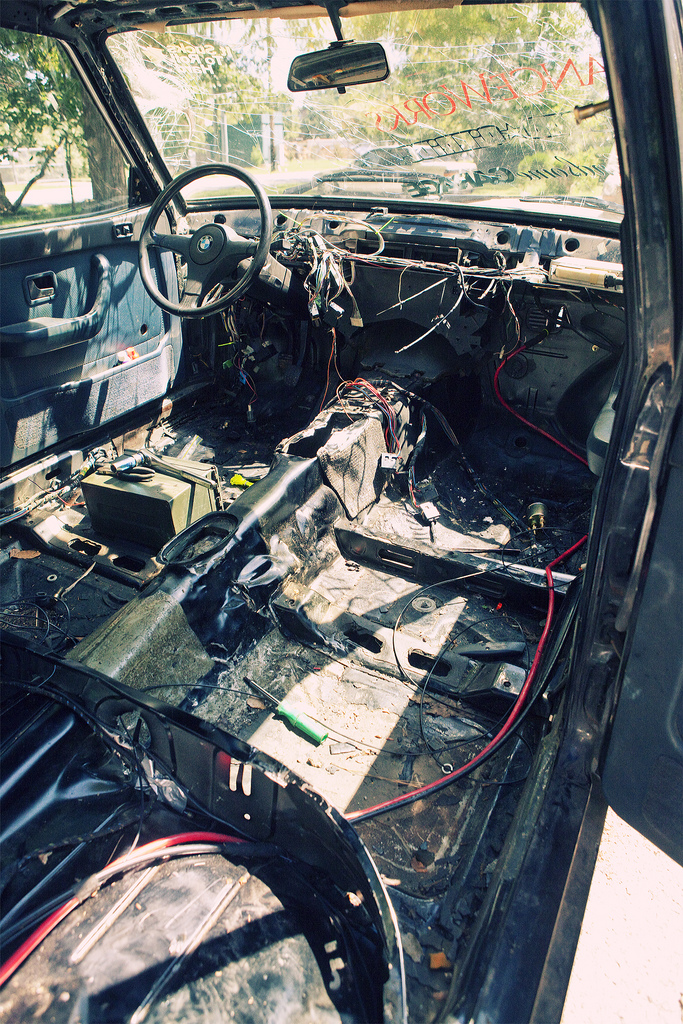

I decided to strip the interior completely. I was tired of the nasty blue garbage that was in there.

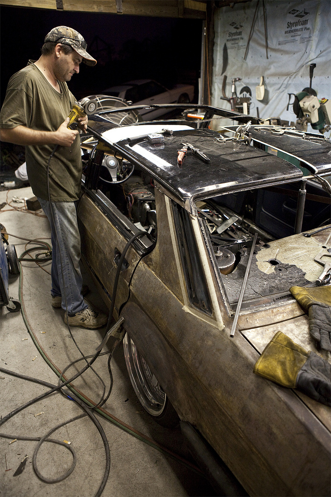

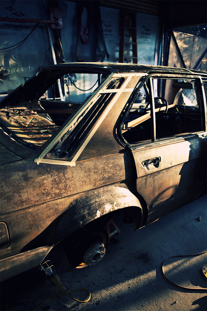

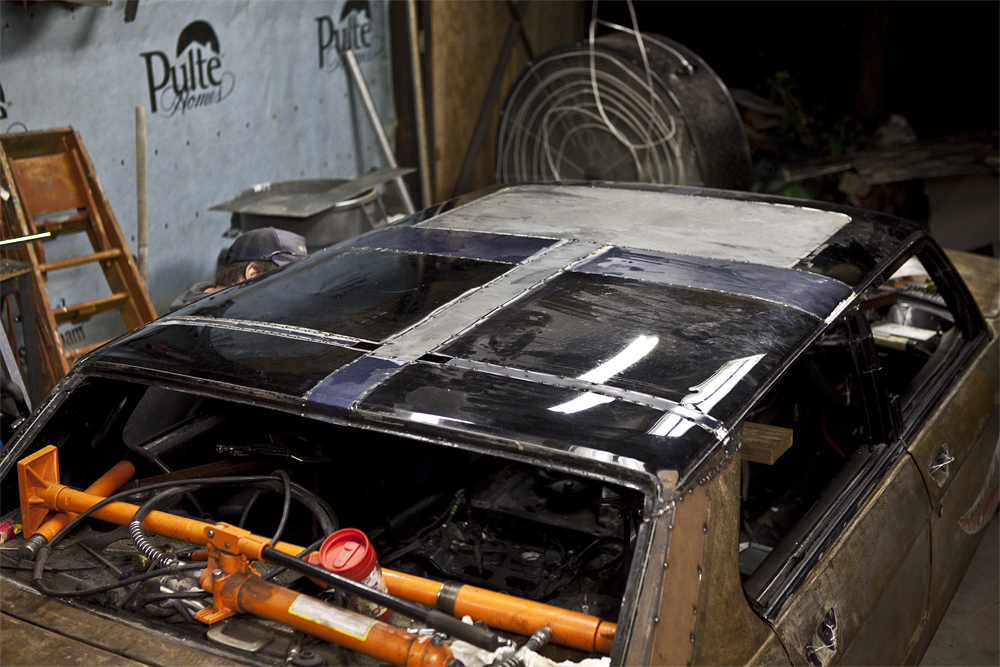

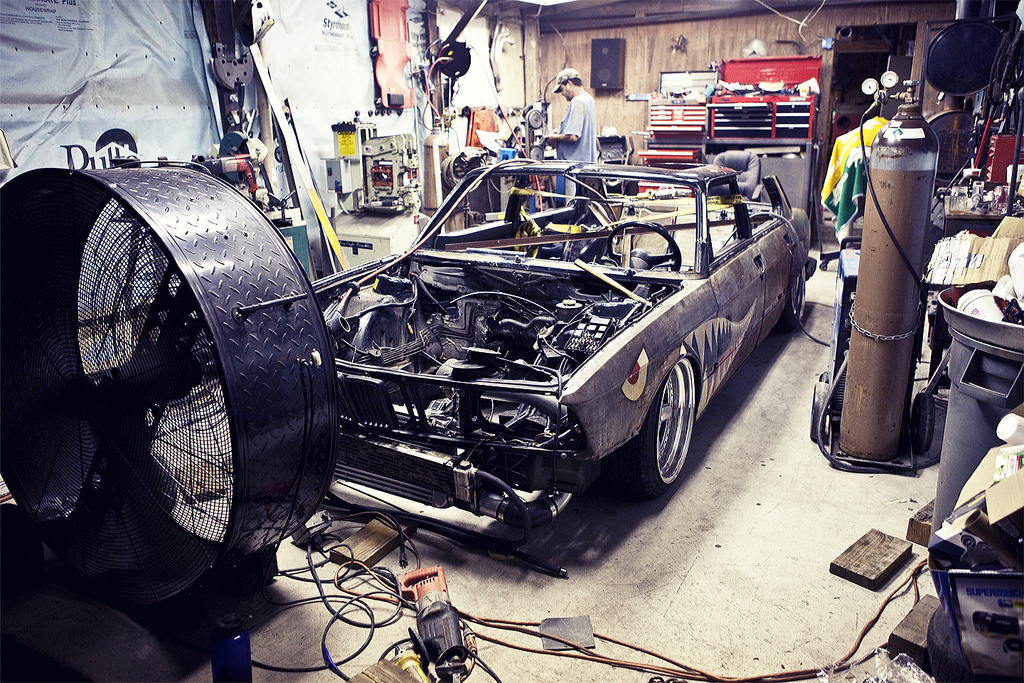

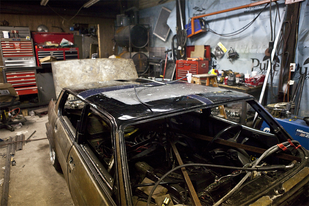

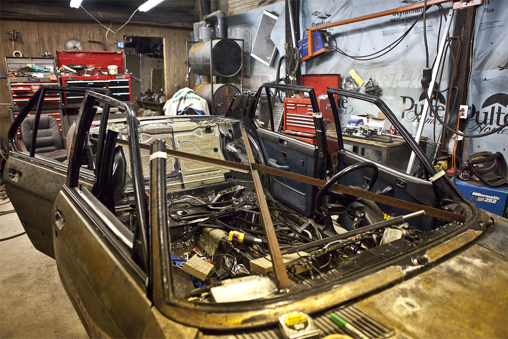

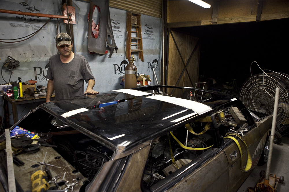

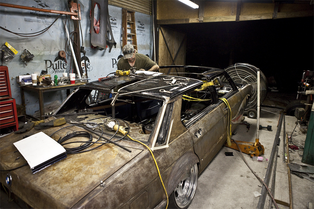

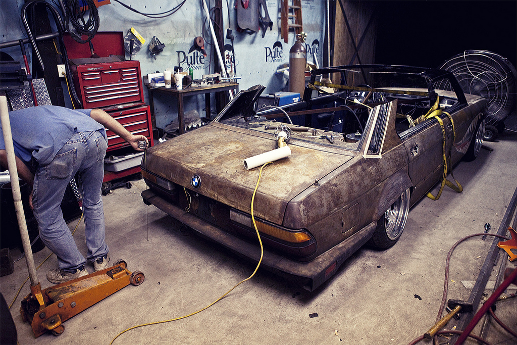

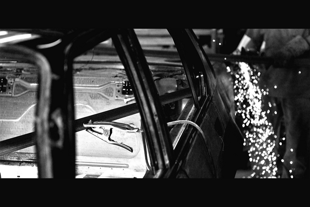

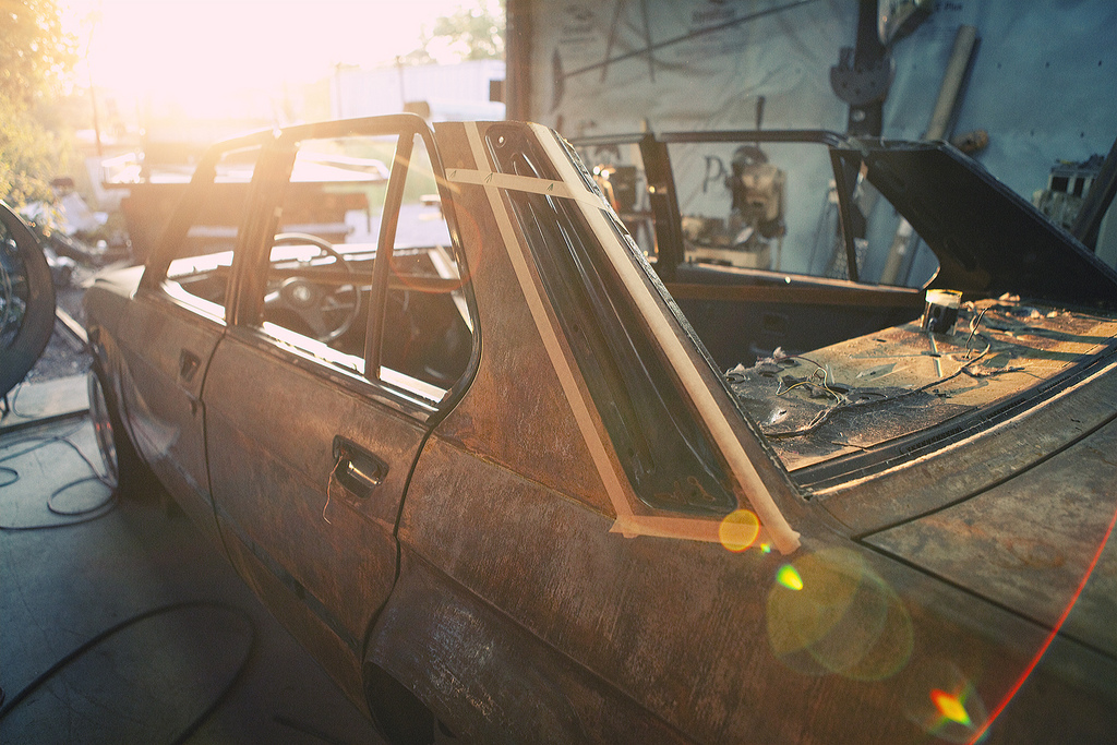

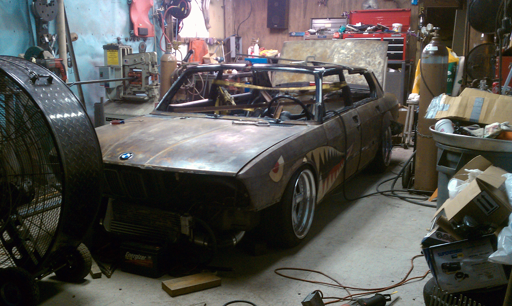

We had talked about chopping the top on rusty an entire year earlier. I had done countless photoshops of it, and had talked about it at length.
I realized that it was time.

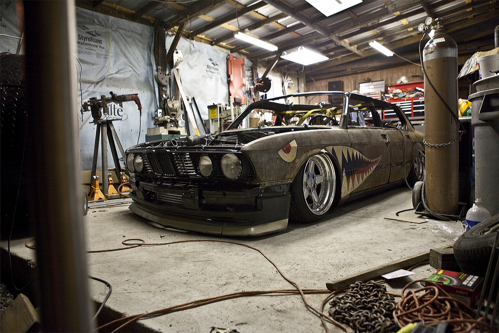

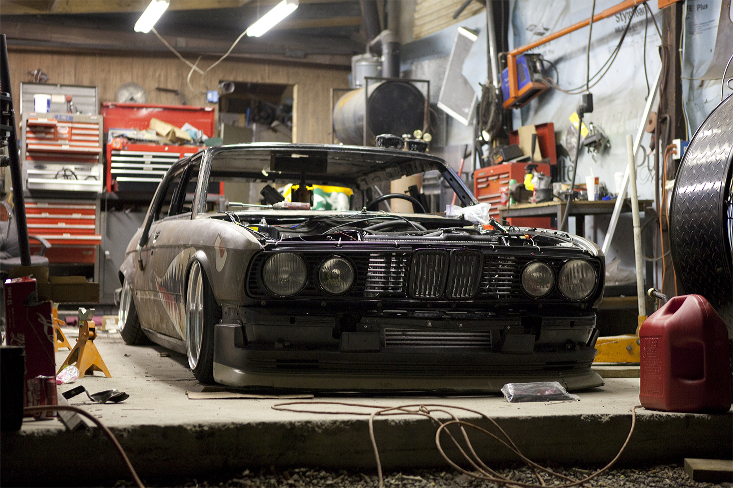

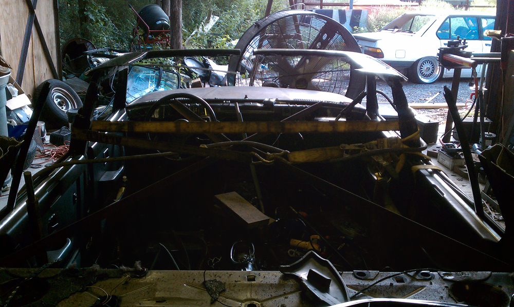

I called up my friend Chuck Yoder, and we made plans. Bigger fenders, chopped top, the whole 9 yards...

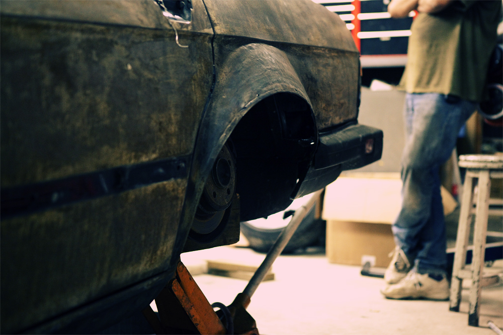

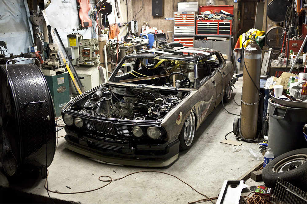

So we took Rusty to his new temporary home in chuck's garage and got to work.

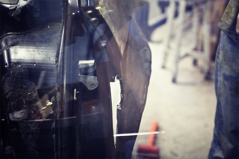

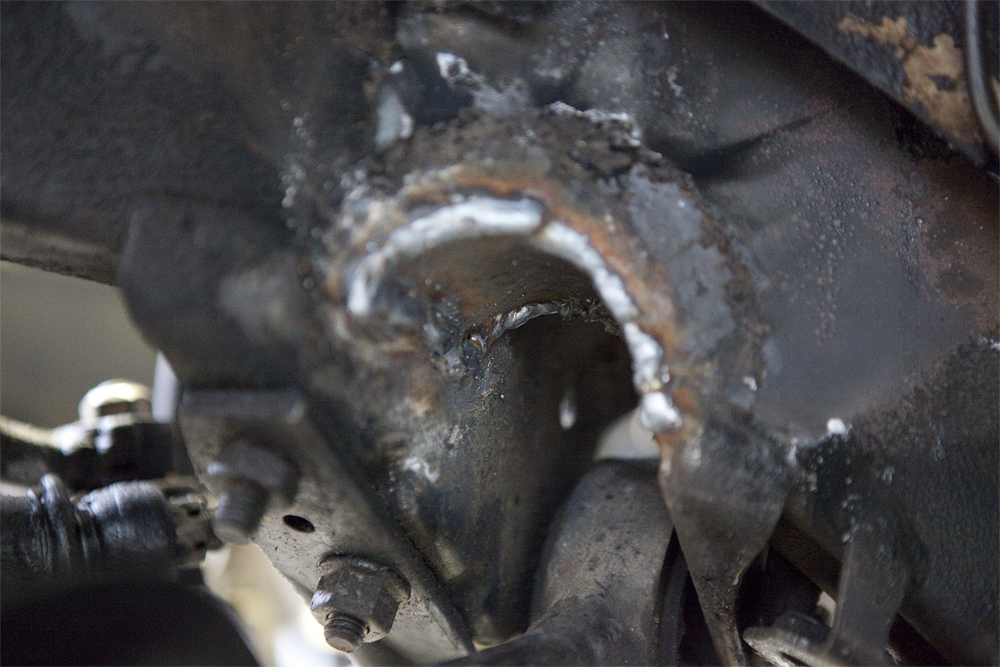

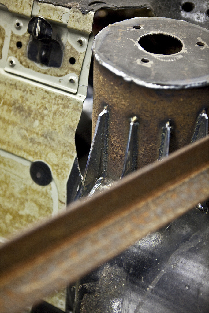

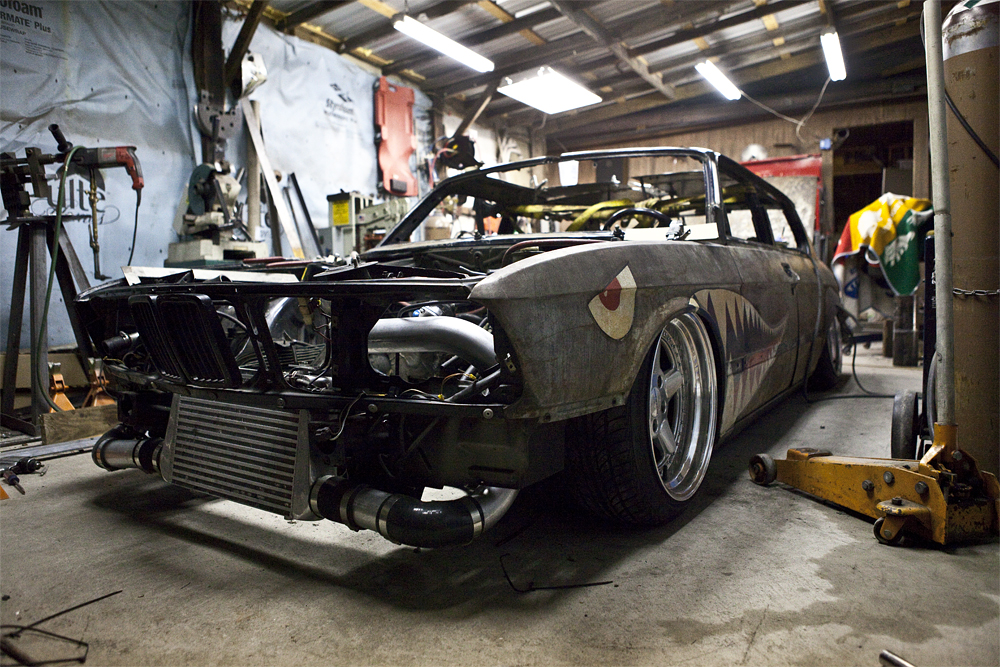

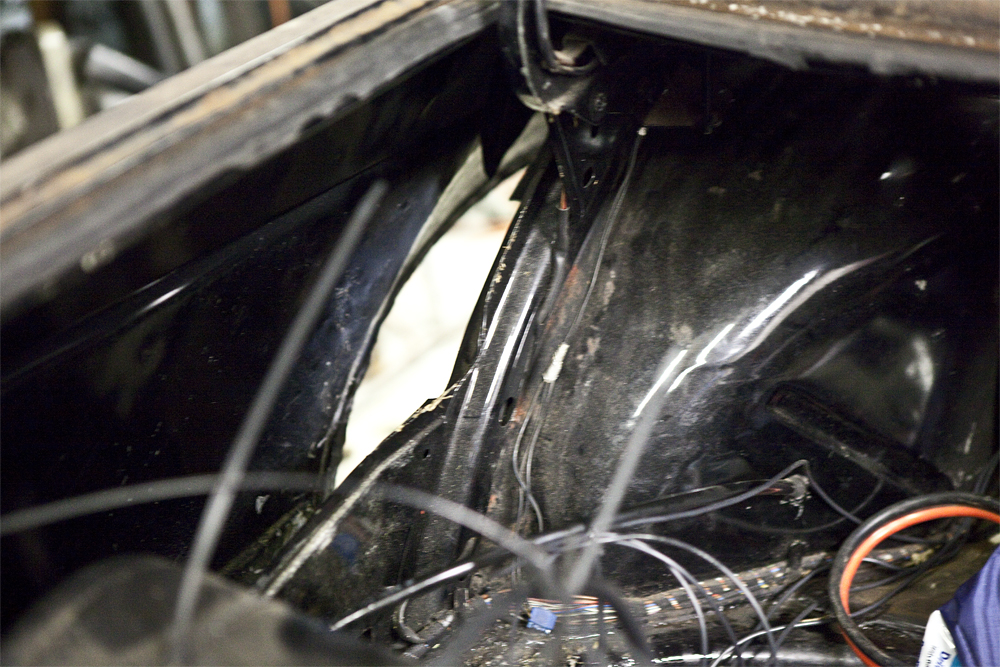

We decided to tackle the fenders first.

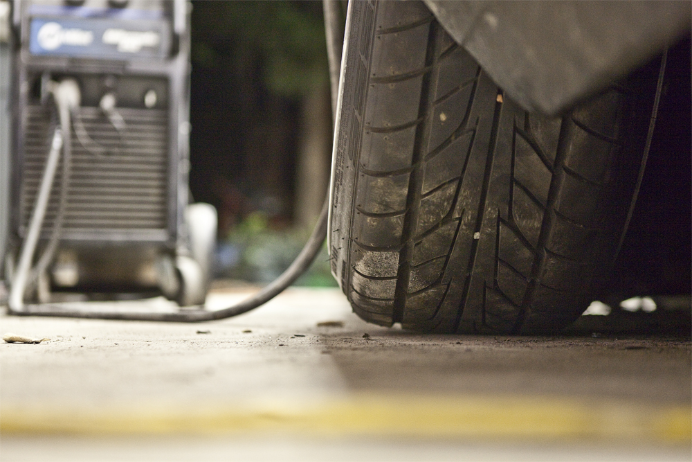

The inner fenders had to be removed entirely for clearance.
We had to cut into the door frames for the tire to have a spot to go. Believe it or not, this made a HUGE difference.

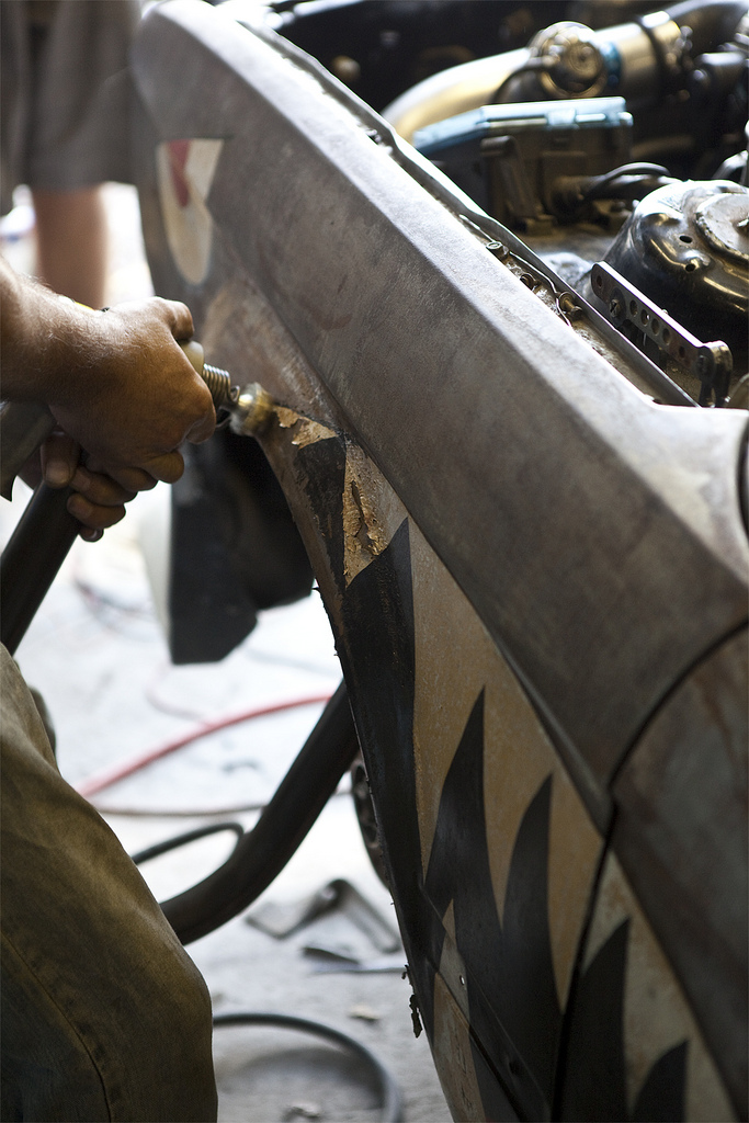

Chuck did the fenders with a ball peen hammer. That's it.

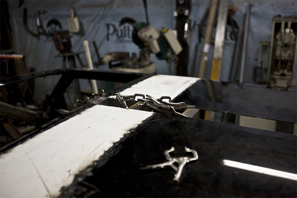

So what next? Well, I guess its time to cut off the roof.

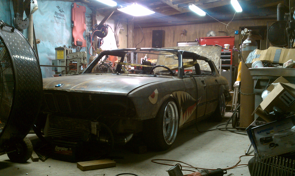

Bracing for the chassis, since it will flex when the roof is cut off.
Making measurements, tape lines..
Cut number one... no turning back...
That looks like a roof...

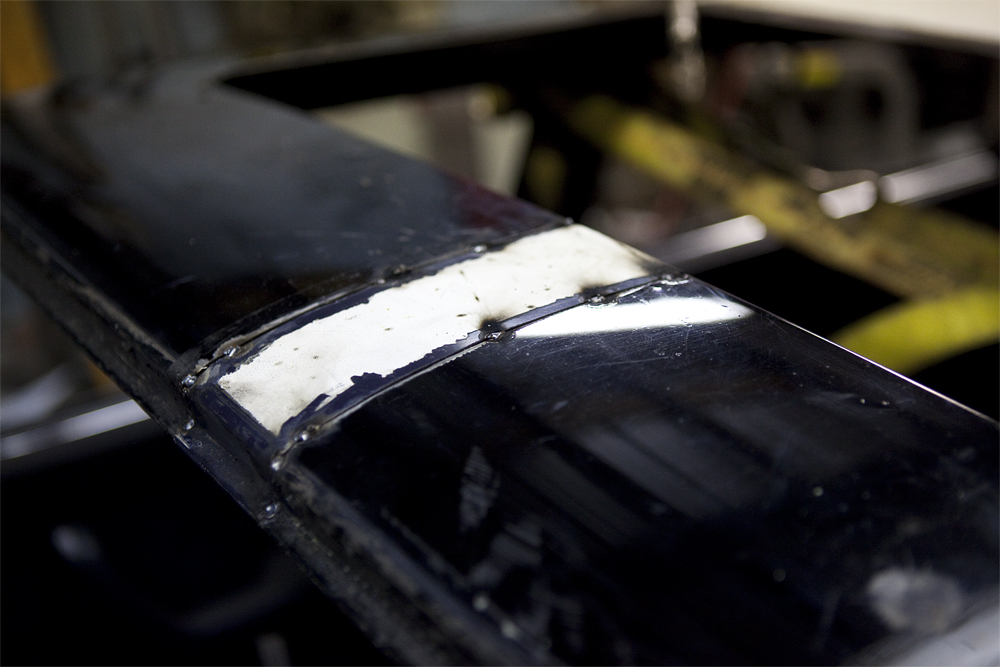

We initially chopped 3" out of the top... and put the roof back into position. We decided it needed more chop, as the look wasn't changed enough from original.
Next set of cuts partway done!

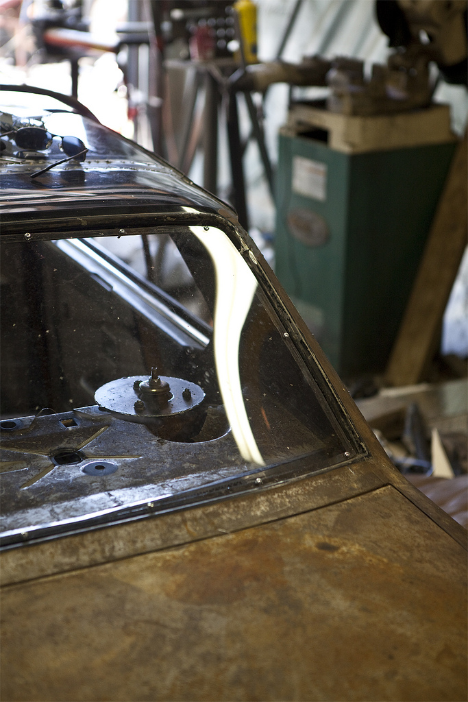

A total of 5" chopped out of the pillars. Front halves in place.. rear not so much.
We decided not to angle the pillars more, so we had to cut the roof into four equal pieces. One for each corner. Then we had to patch everything in between.

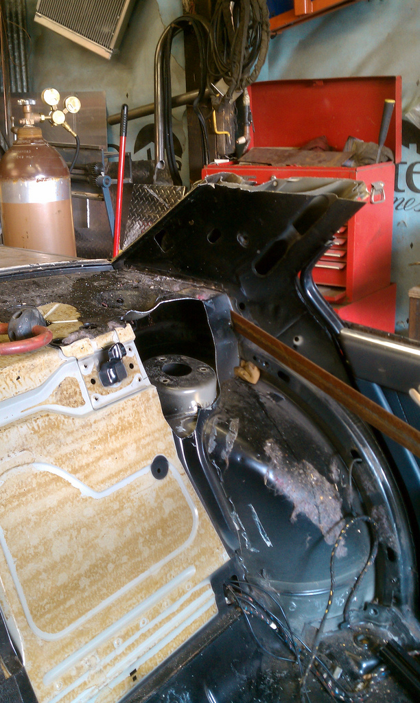

Now, before the rear pieces of the roof could go on, we needed to redo the rear strut towers. I wanted to drop the car enough to set it on the ground.. shortening the rear struts wasn't so much an option, so we modified the car.
Completed with the rear end aired out...

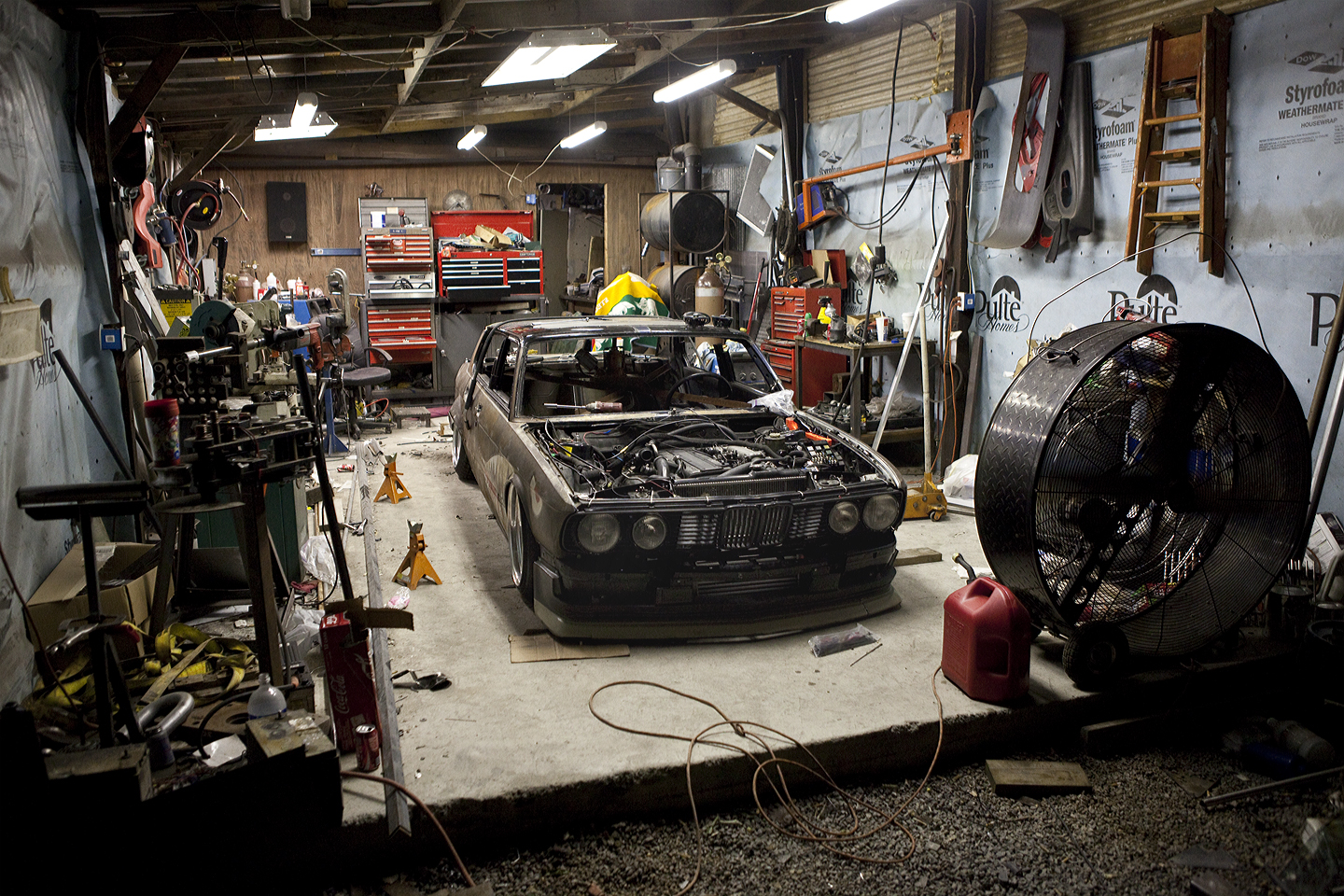

We've still been working every night. The car sits low....
But not low enough...
September 10, 2010

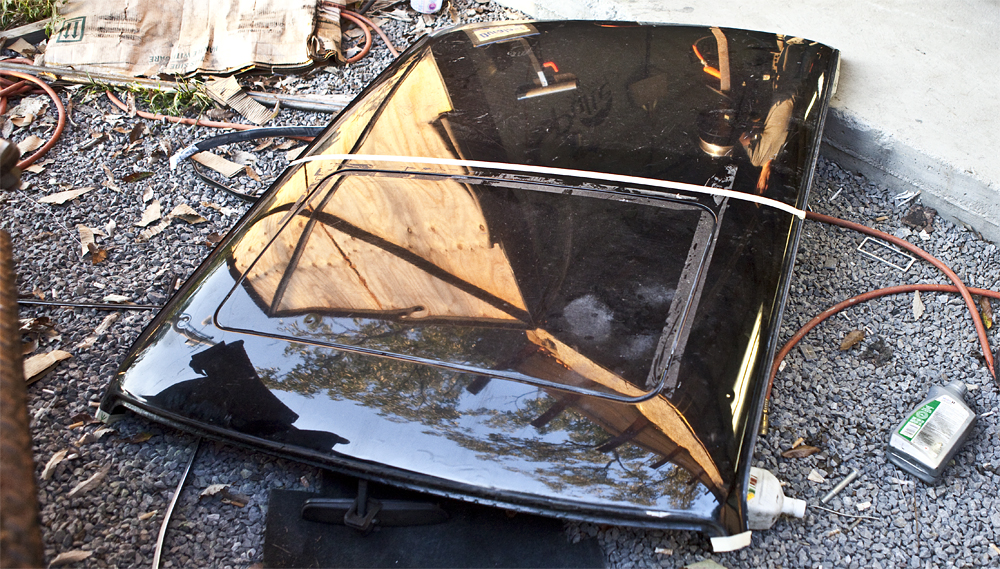

Roof is coming together. Ratty donates the center sections...
Over the next few days, the car slowly comes together..

Well, A) we shorten the front struts and inch.
And notch the frame rails.. in 3 spots on each side (only one shown)
And cut out the tops of the fender supports...
It's comin' down.. but it needs a little more.

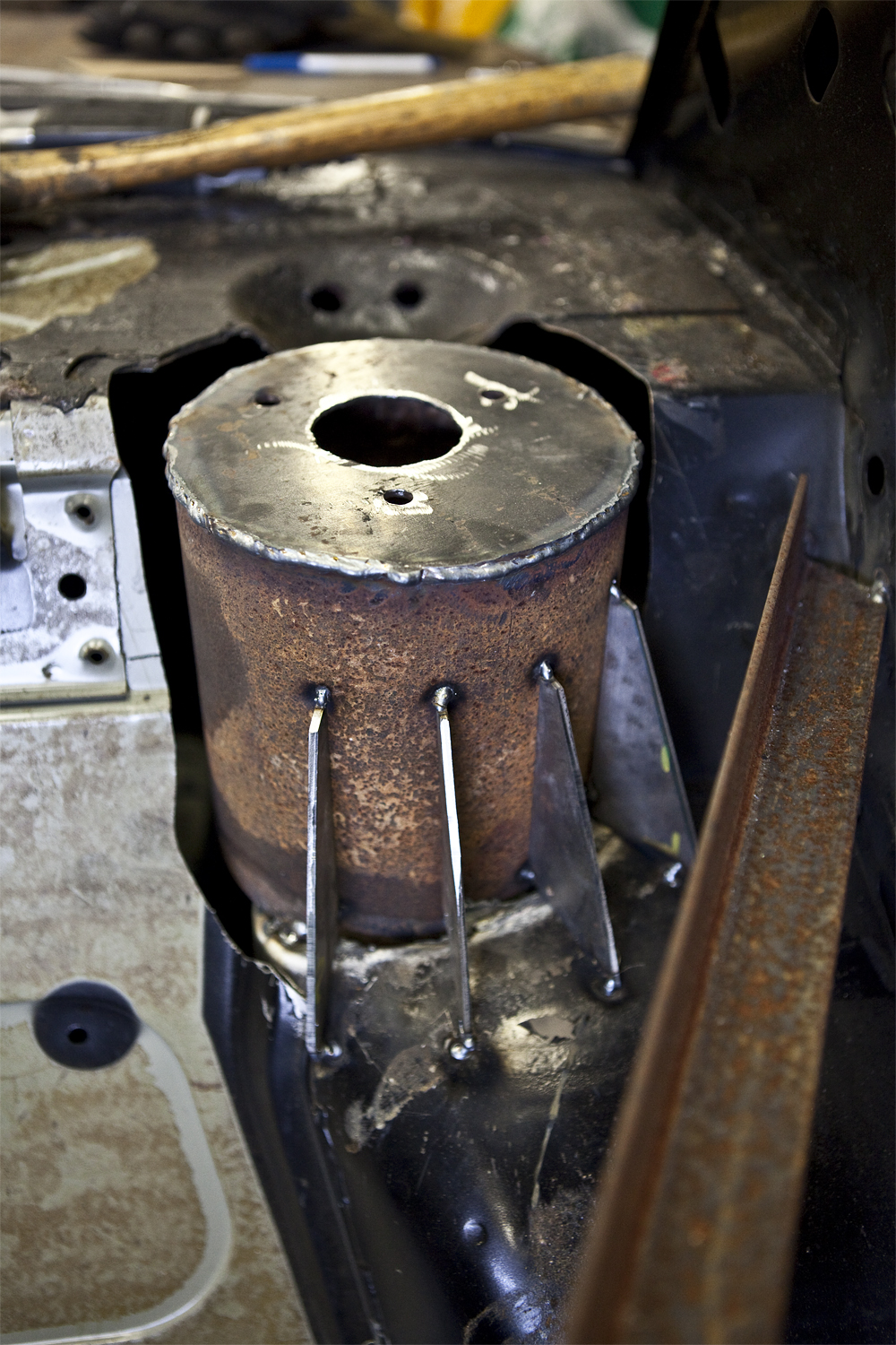

So we made our own strut hat/mounts.. I need to find pictures.

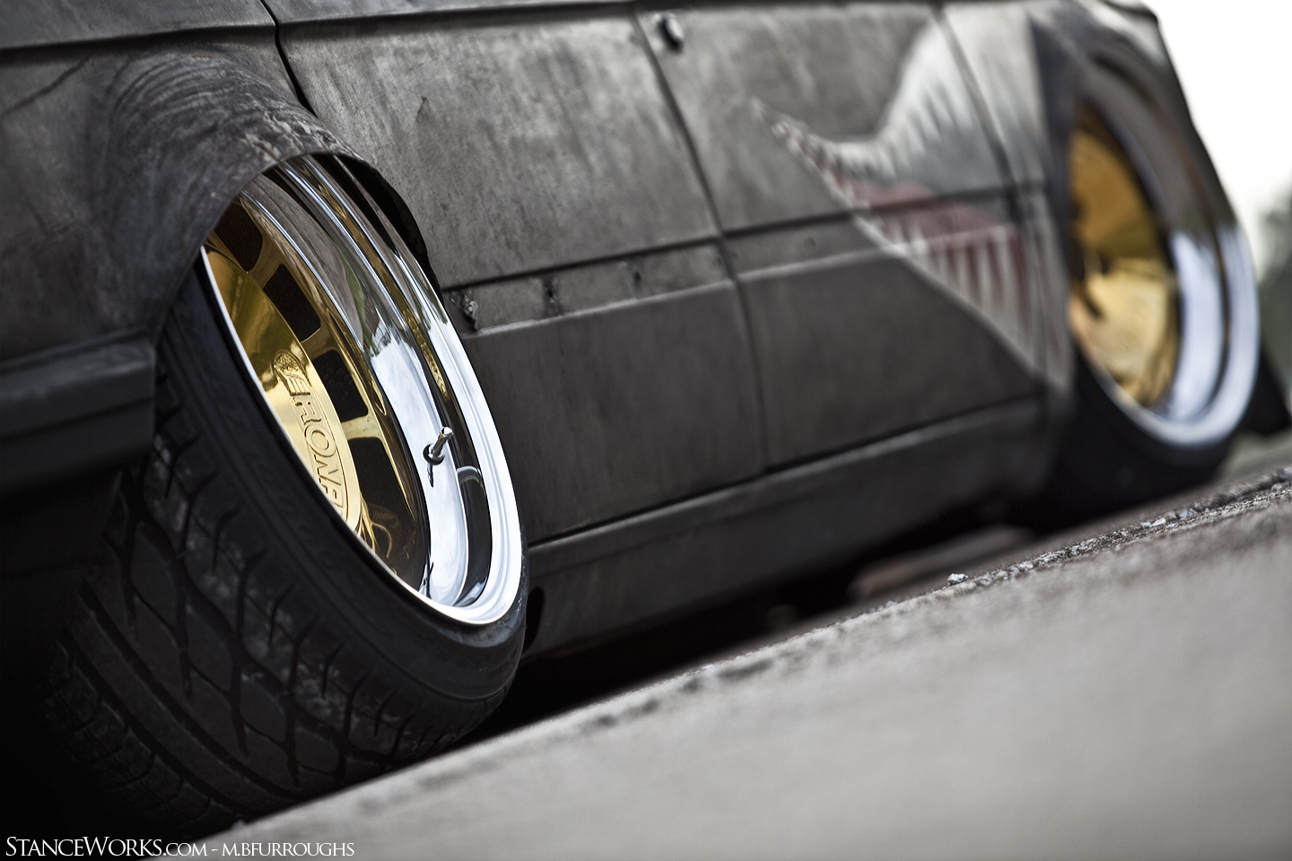

Floorpan resting on the ground...
-10* of camber

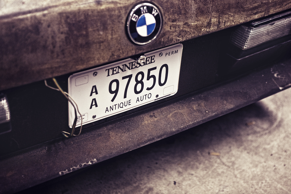

Rusty gets antique tags!

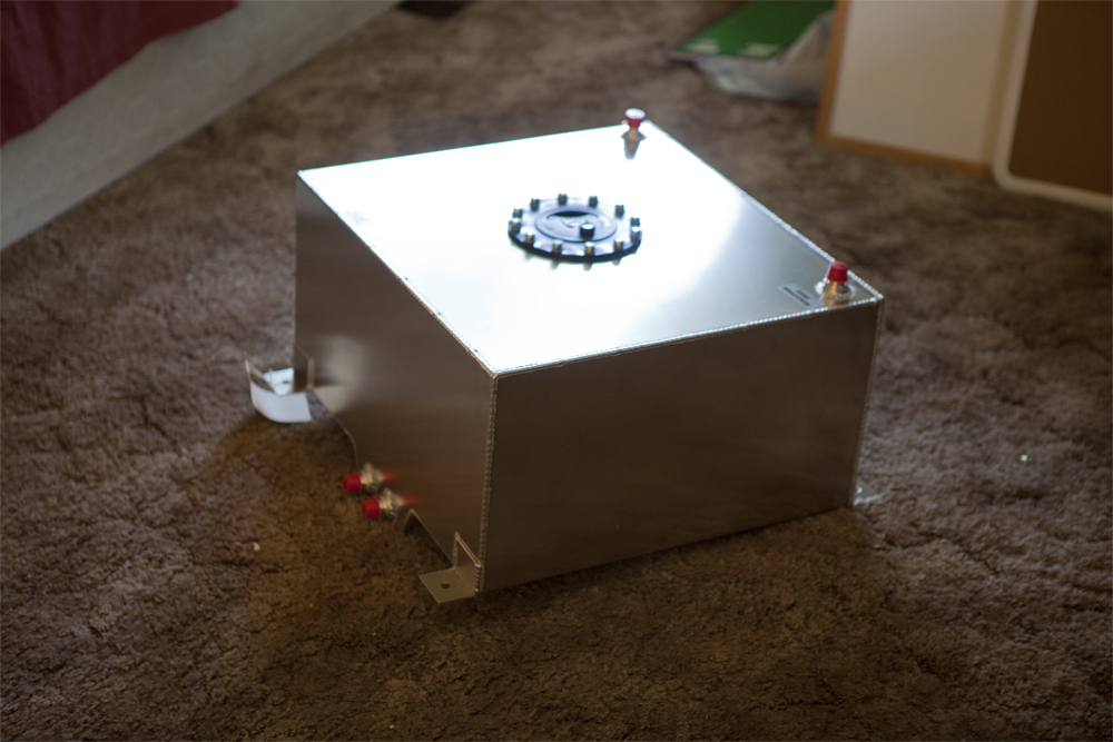

Also, this showed up:

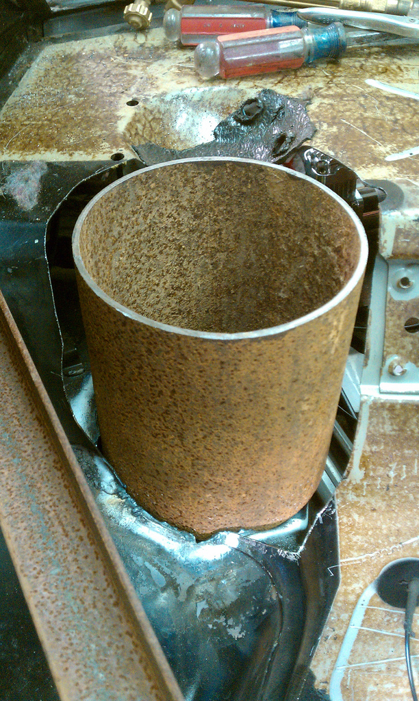

I had to remove the gas tank and spare tire well, as they were hitting the ground.
Not even aired all the way out... the diff hovers above the ground. Look at the angle of the axles...
Oh.. and brian sent me this pic... my completed 17s, the only set in the world.

Roof nears completion

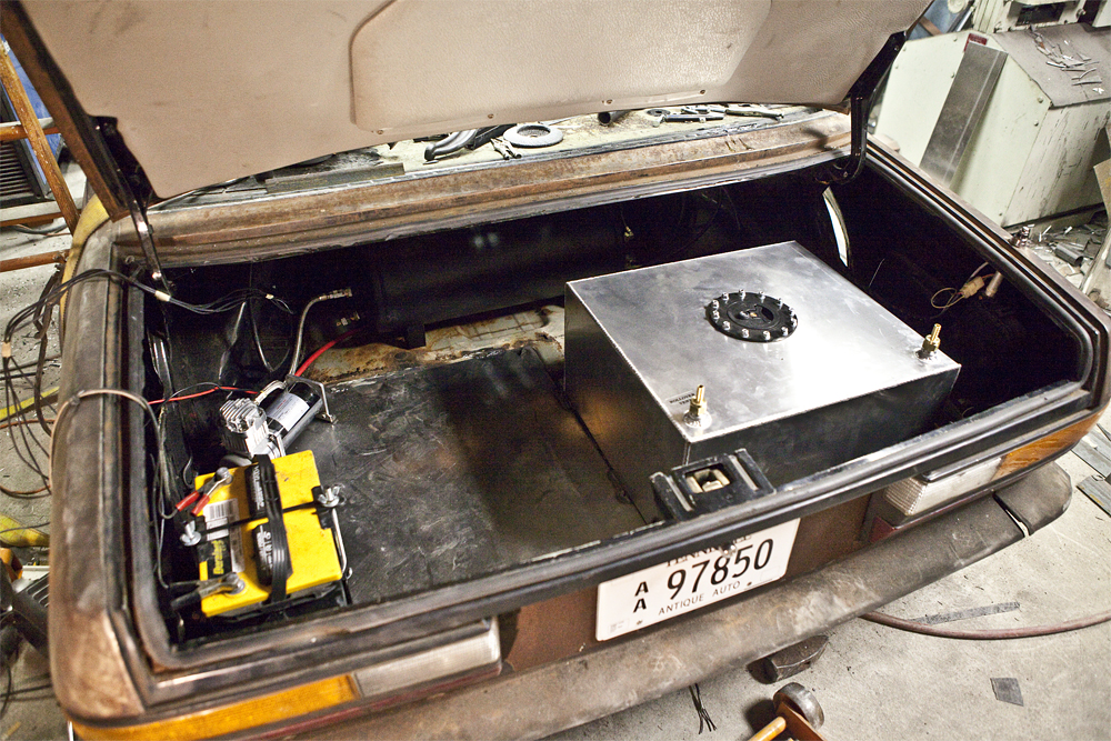

Trunk is done:
As a whole:

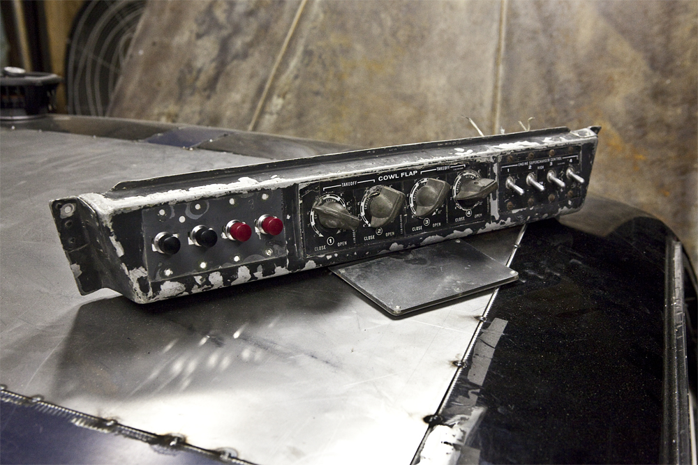

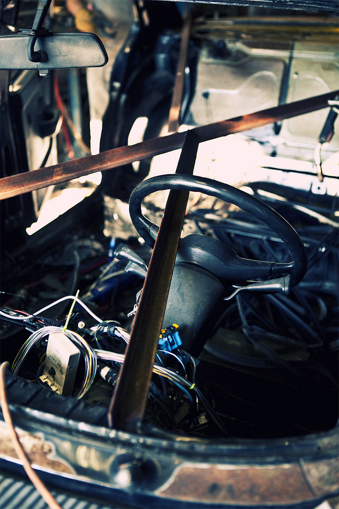

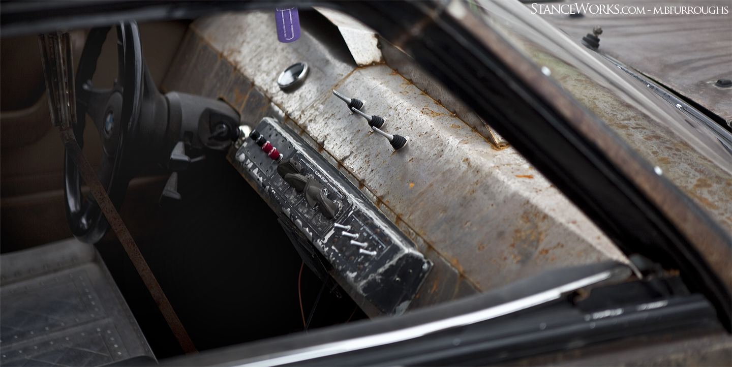

Got my gauge panel for the interior done:
September 24, 2010
The night we're supposed to be leaving for H20... The entire engine power wiring harness melts.
Debate:
I stayed up all night to make a new harness from scratch.
It fires up, we dance, we rush to finish.
Windows in:
Demolish front fenders:
Load 'er up and head to H2O!

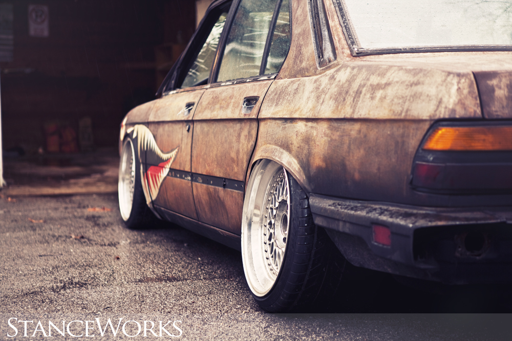

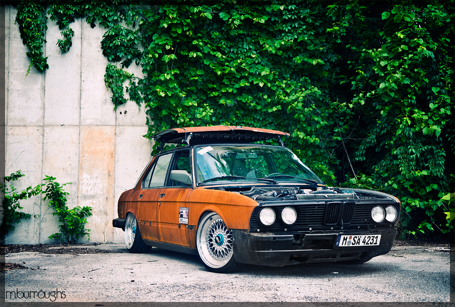

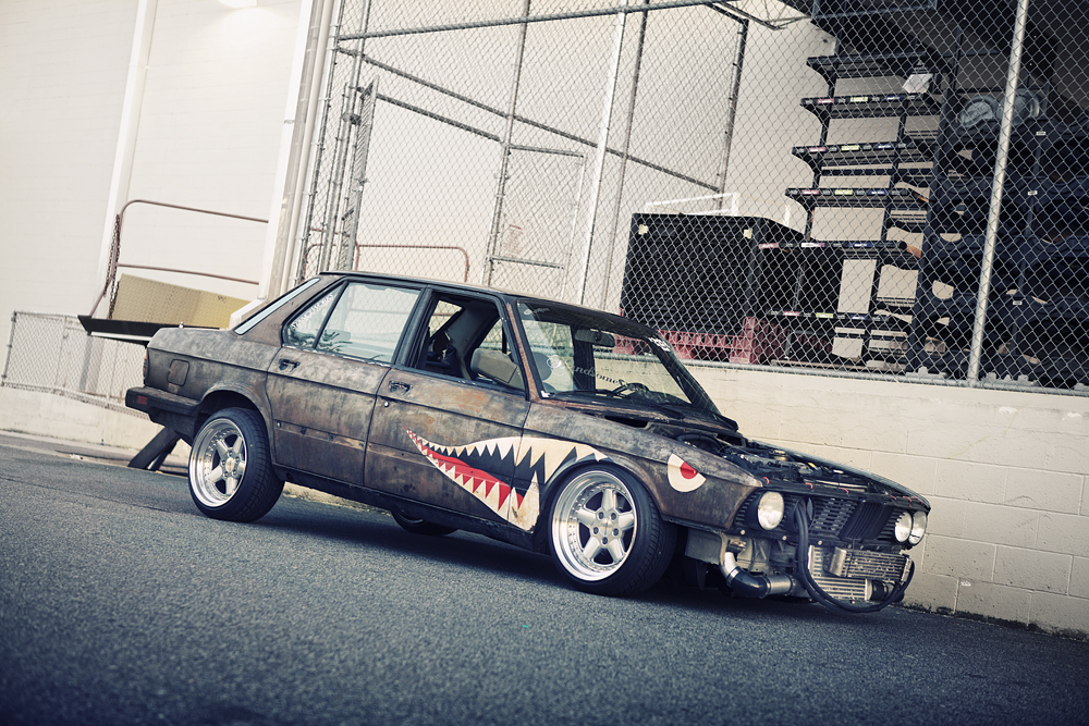

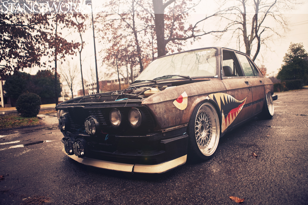

Rusty is revealed once again, this time with a 5" chopped top, 4" more drop, new, one-off gold-plated 17" ronal racing splits, a diesel-rubbed body, and a fresh new interior.
