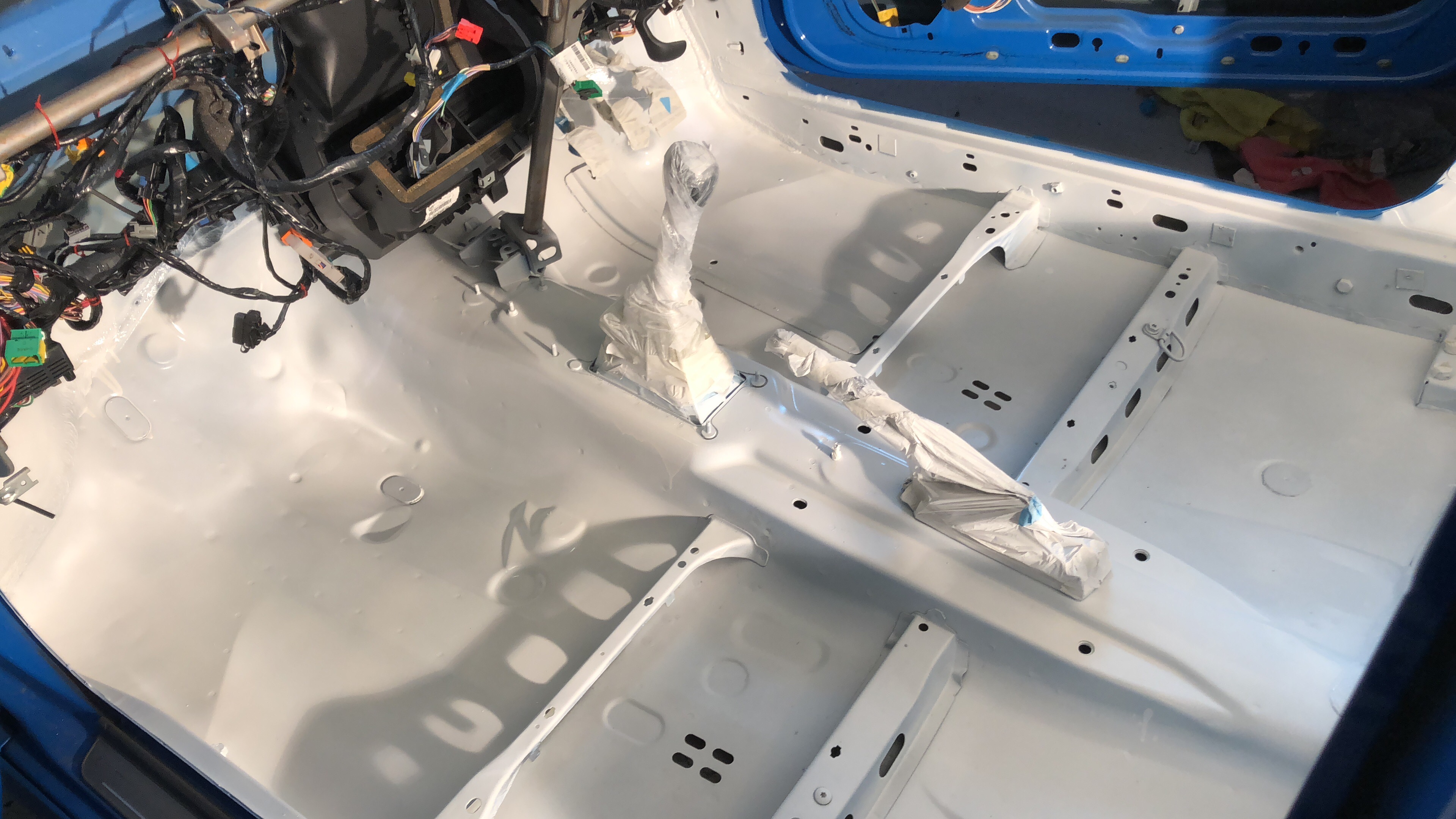

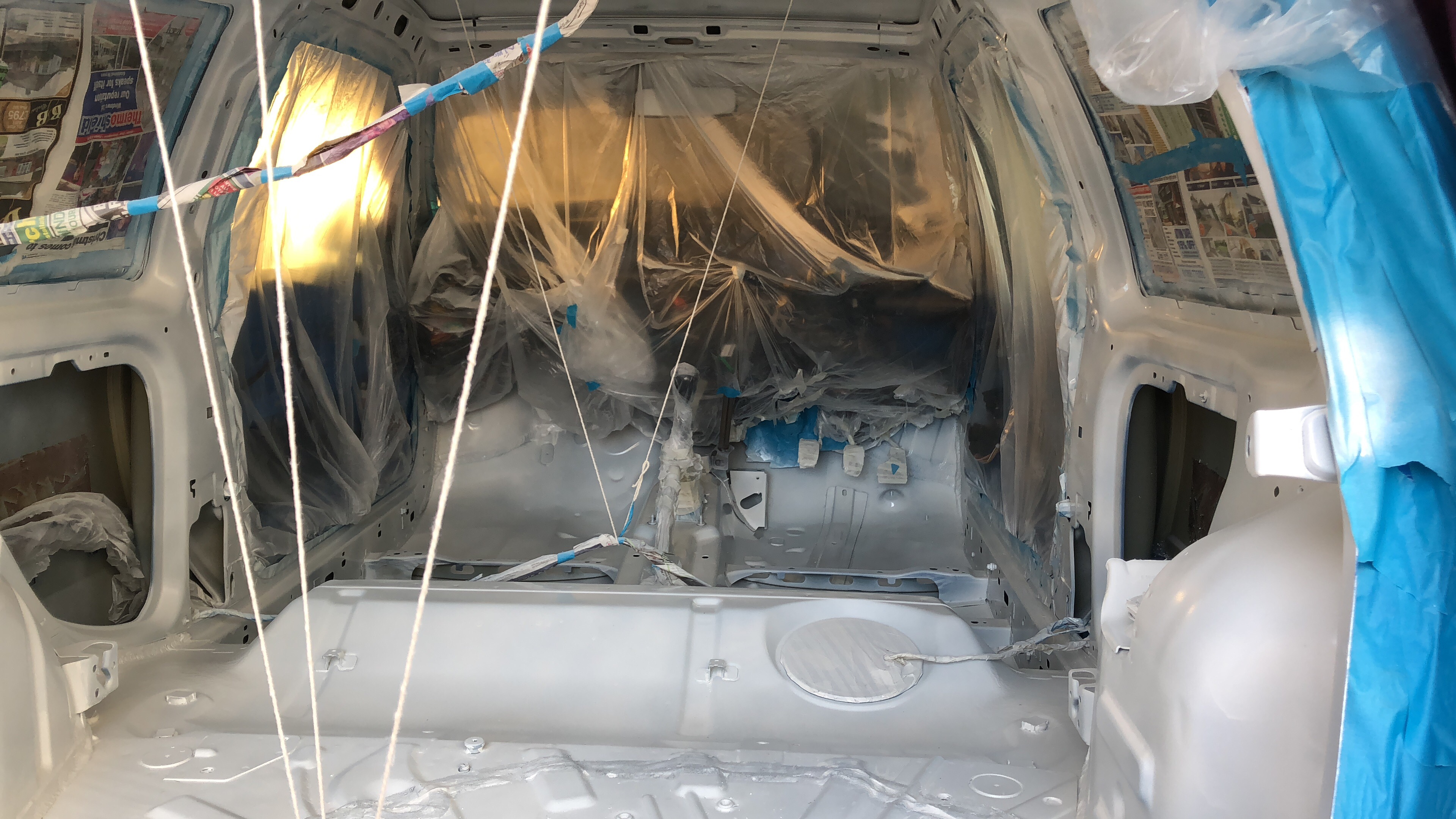

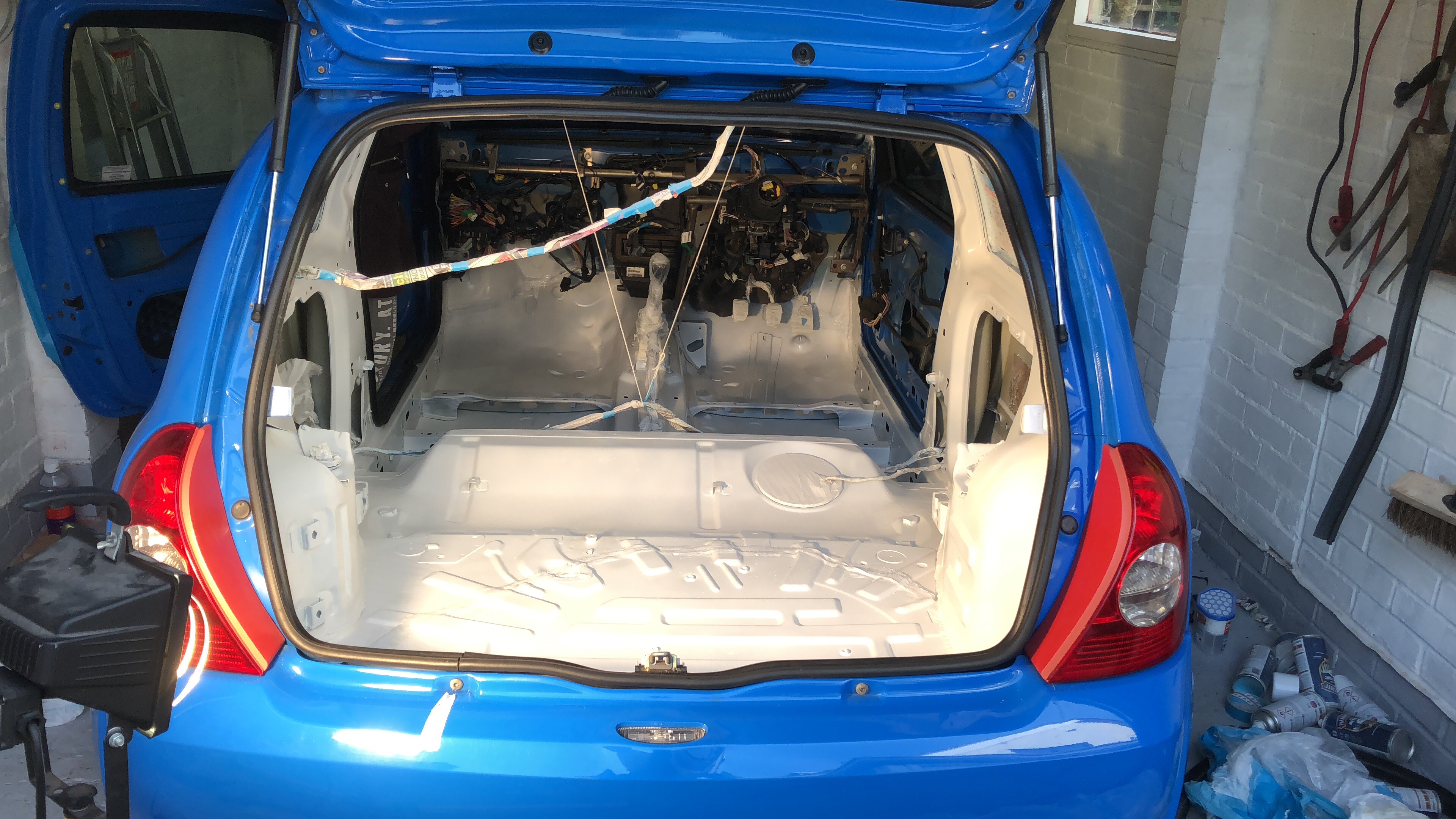

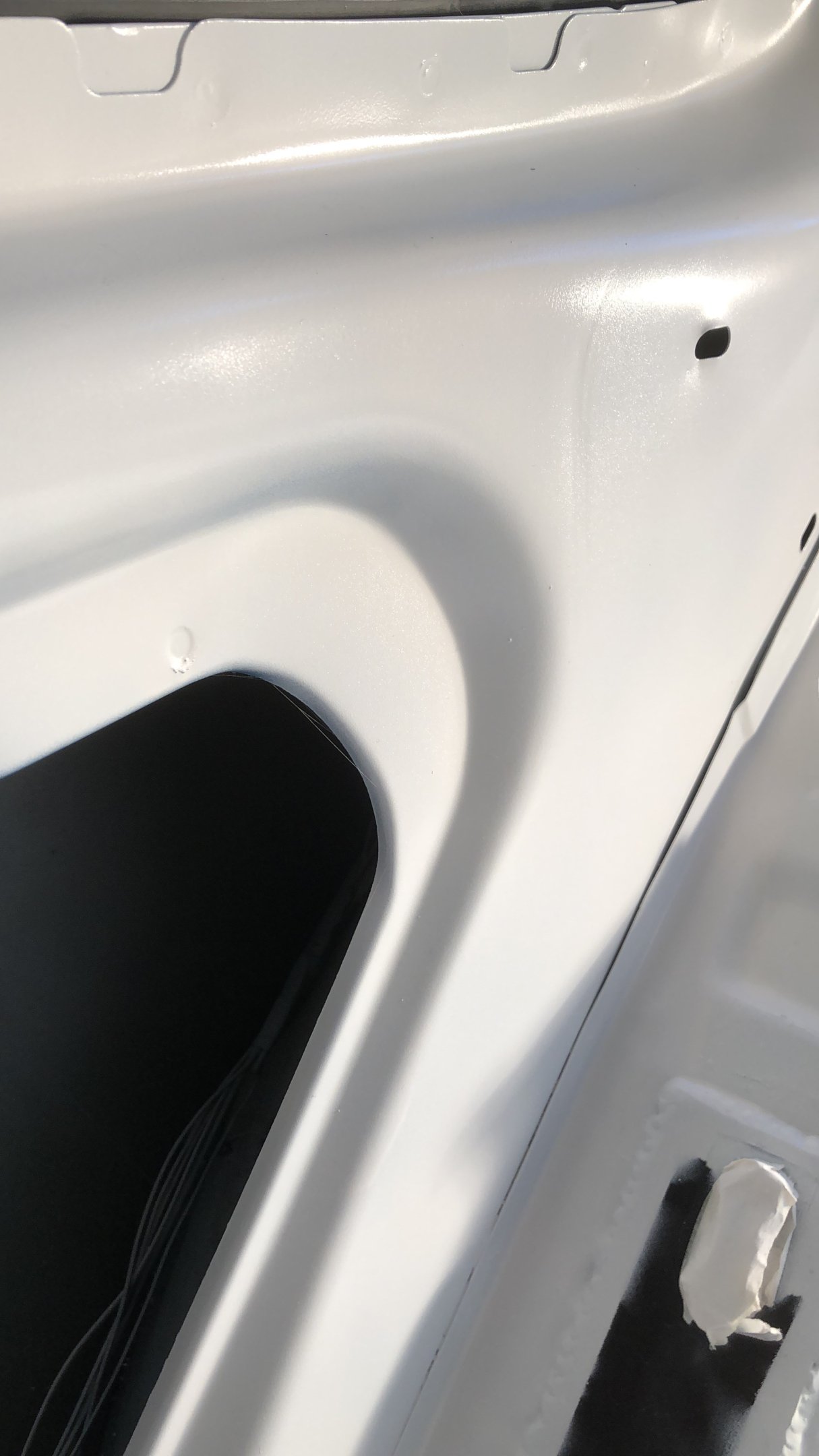

Hammerite smooth white. I managed to get through around 10 tins and if I'm honest, the roof could have used an extra tin or two but it's not cheap stuff, and a horrid job to do (I'm sure I've reduced my lifespan by quite a few years!!)

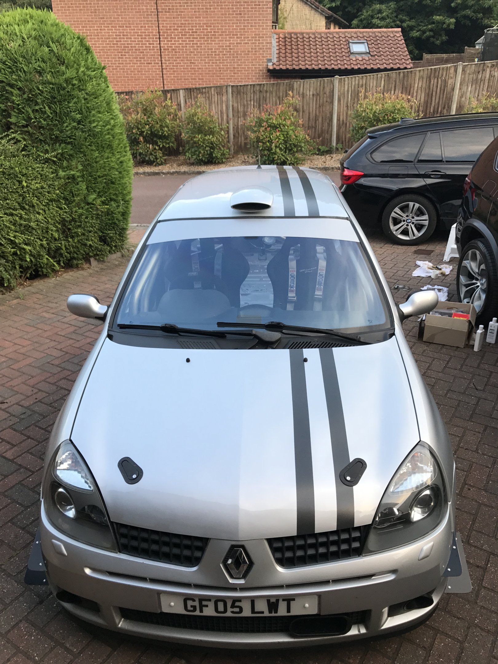

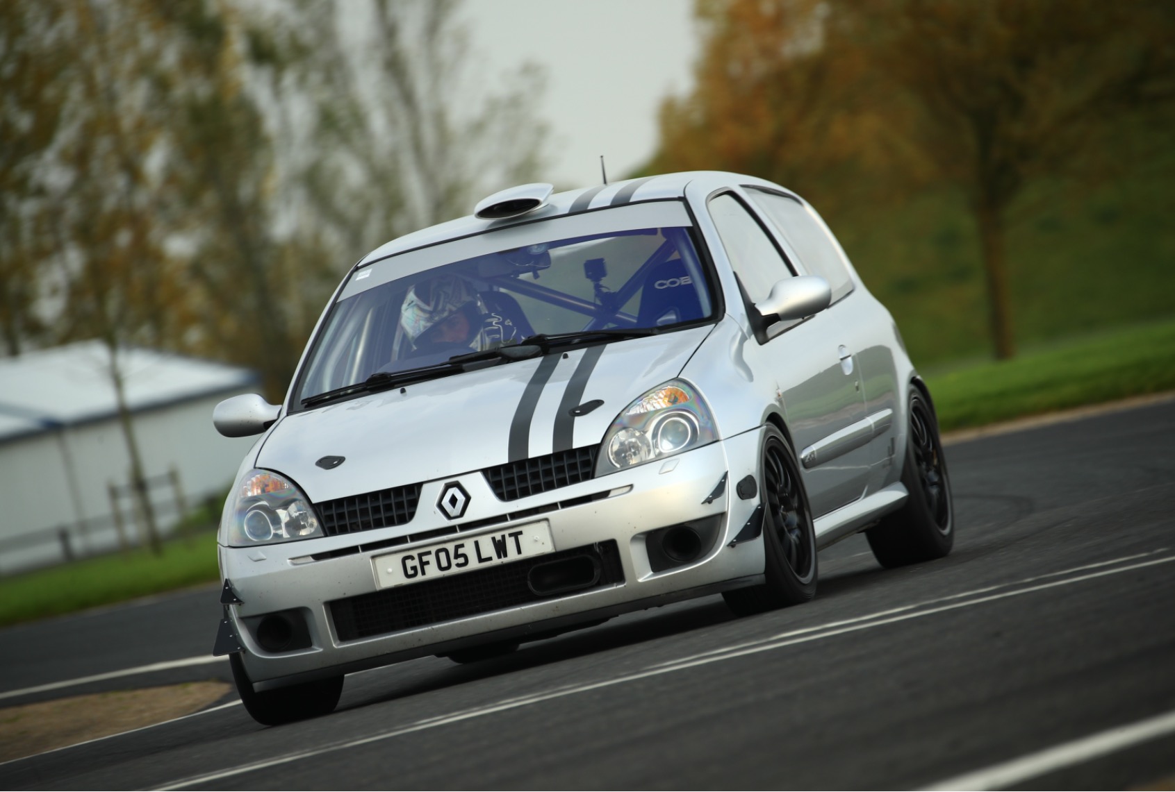

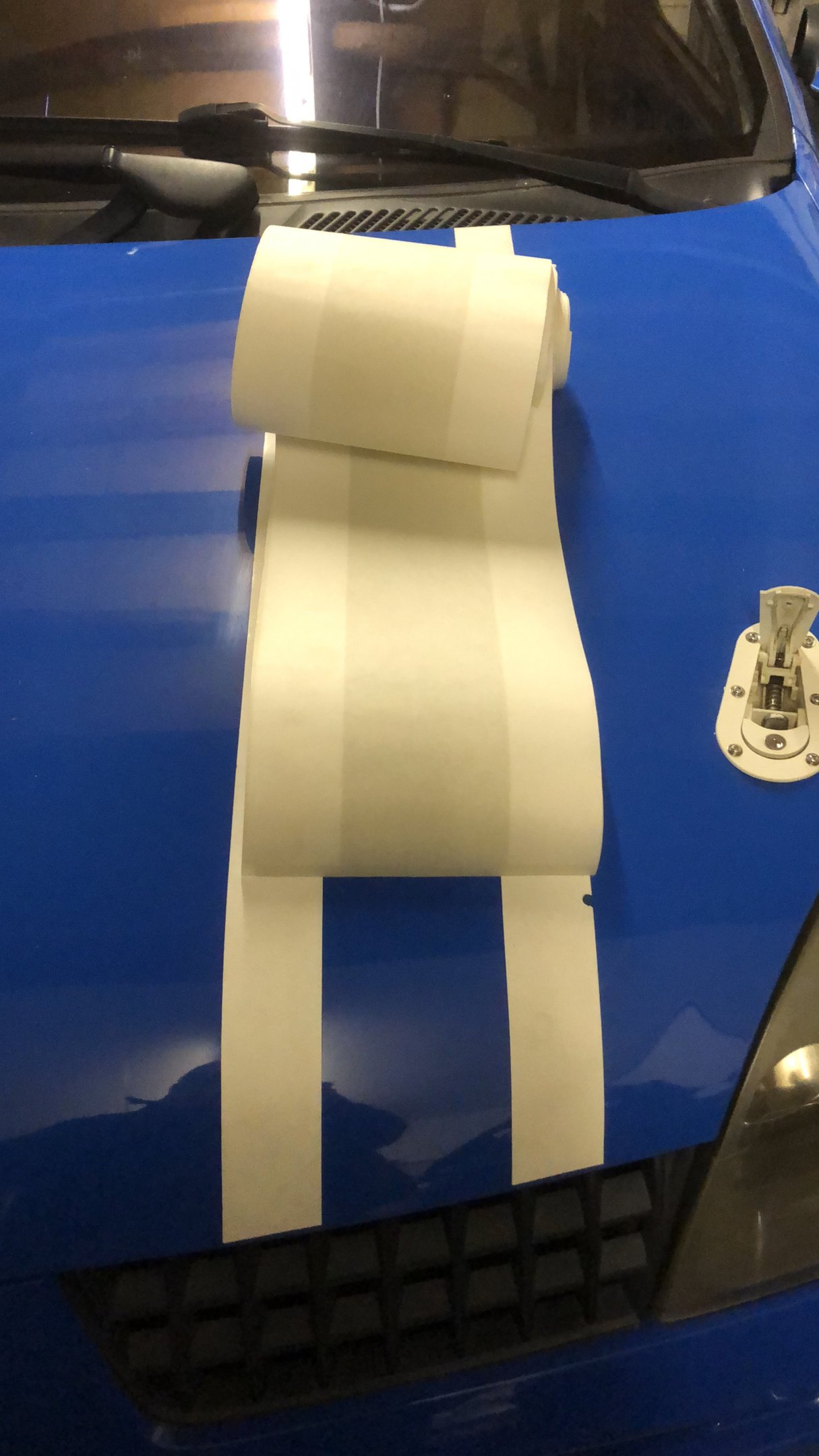

Decisions decisions....
I love stripes on RB’s.
But I have a roof scoop for this and think the stripes will look odd with that.
Hmmmm....
Hmmmm....
Can I ask a silly question? Why the f**k are you fitting a roof scoop??
You turn a fairly nice looking, sellable, car, in something that only 0.1% of the population would ever consider buying.. not to mention making it look daft as f**k..
Bye for now
I know they serve a purpose , but I have to agree with this. If it's not too late, please don't go cutting a massive hole into the roof of your really nice little car!
R29TJR
  2005 RB 182 Cup
+ 3.
Ry can do as he pleases, however I have to agree, I think cutting the roof is crazy. It doesn't get that hot in a Clio during tack time, especially in the UK!
Clio_fool
+ 3.
Awaits pic of hole in roof... [emoji23][emoji23]
  Golf 7.5R & Clio 200
Pretty much because I want a roof scoop. This car will never be sold, it will either be smashed in to oblivion or broken for parts whenever I'm done with it, so sale-ability doesn't come in to it at all. I quite like the look and I also perspire like a motherfucker on track days, its seriously verging on embarrassing #tubby so it will serve a real purpose for me.
+ 3.
You were considerably skinnier than me last time we met haha It gets extremely warm in a fully stripped clio, even with the windows cracked open :(
Rob
Fair play, I just think it looks terrible, but I'll keep schtum.
Great work otherwise

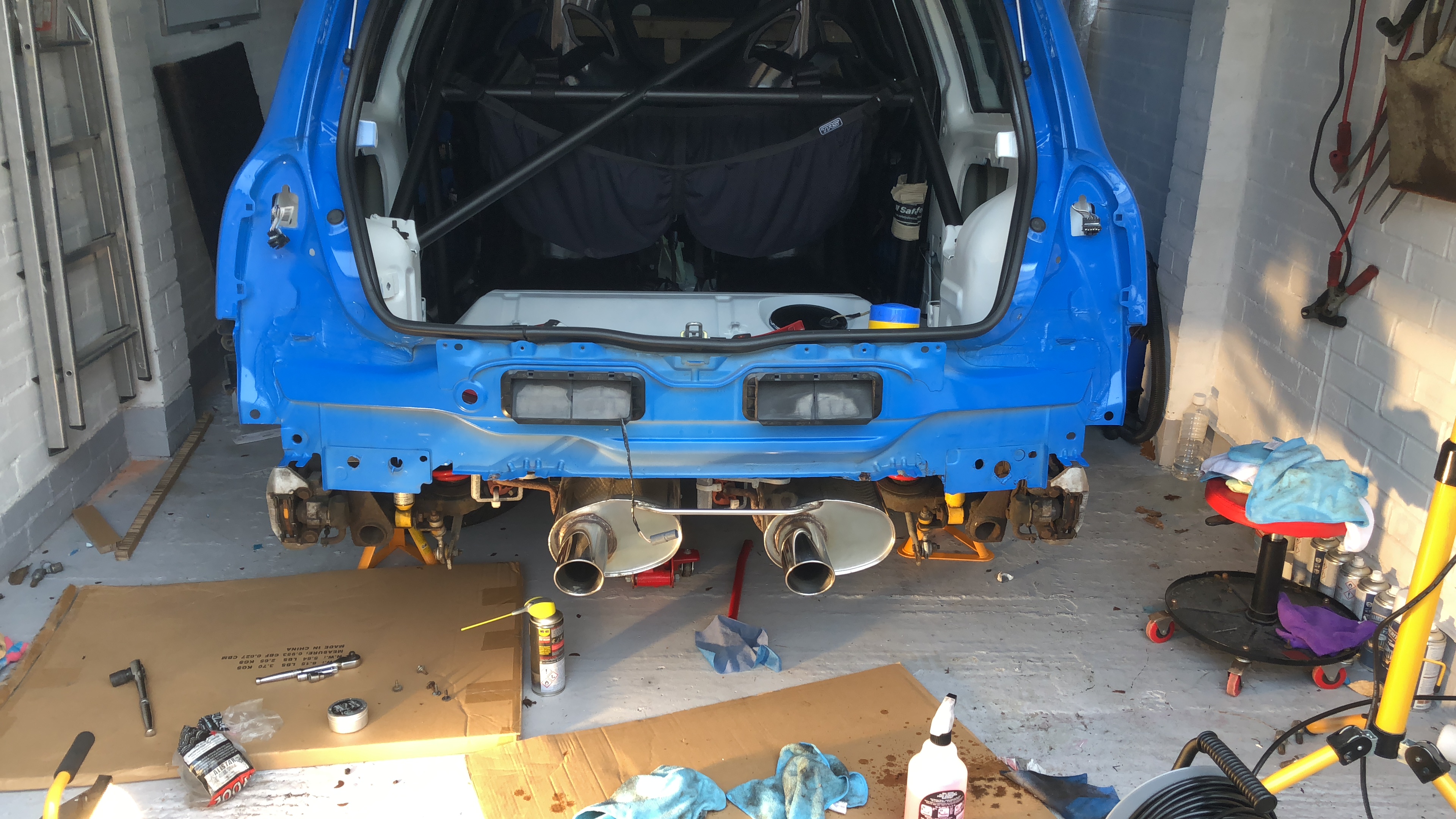

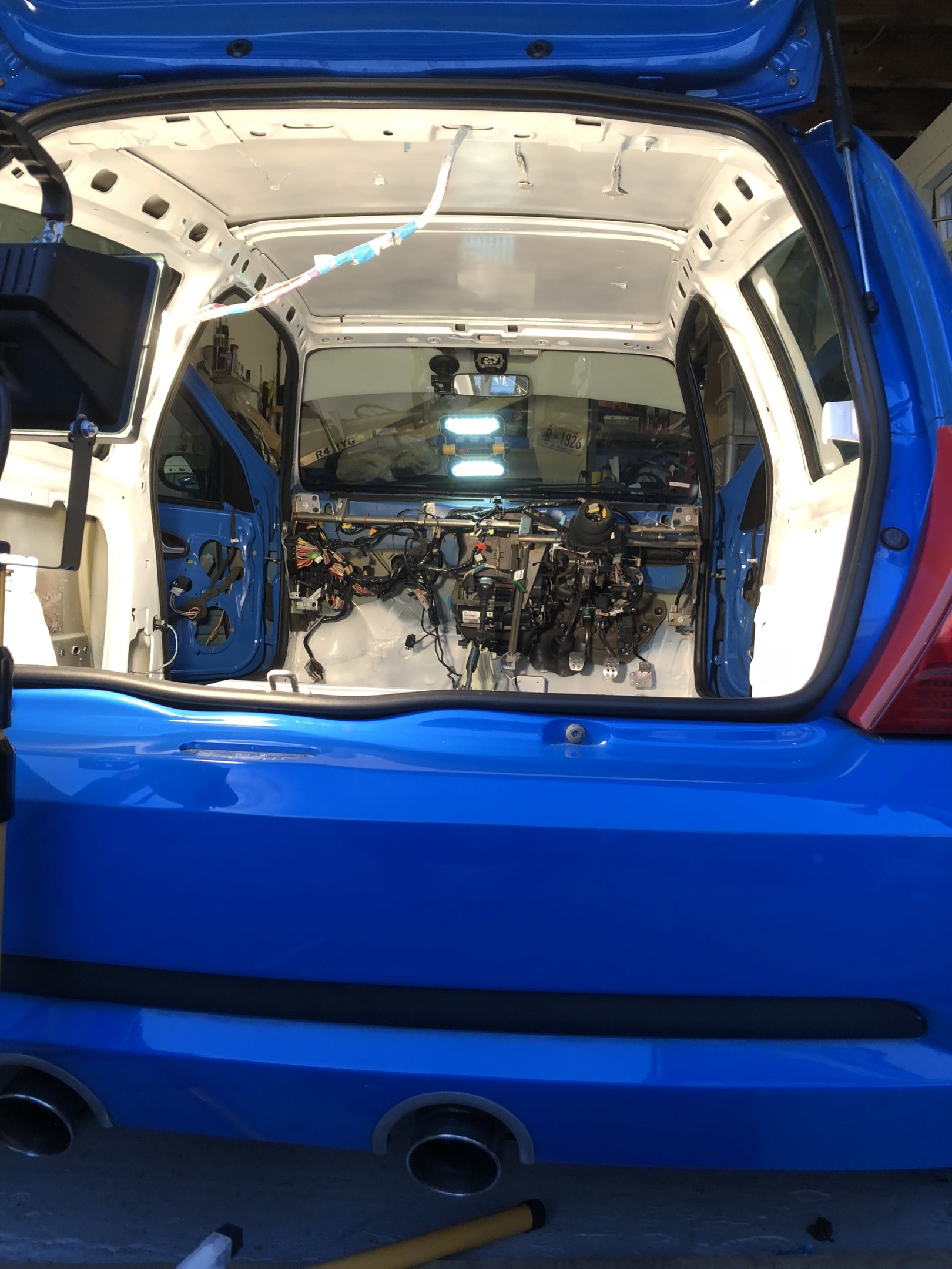

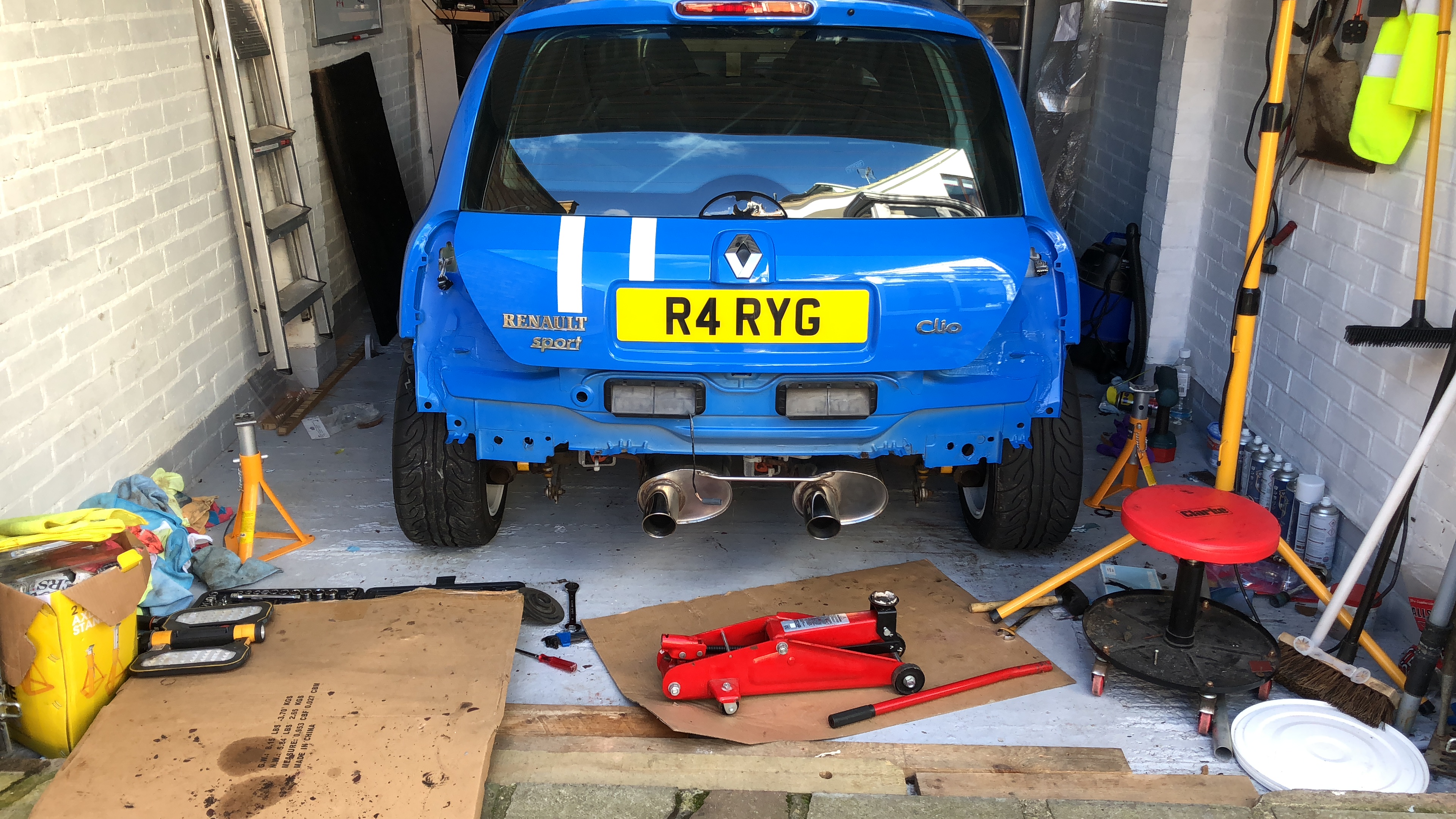

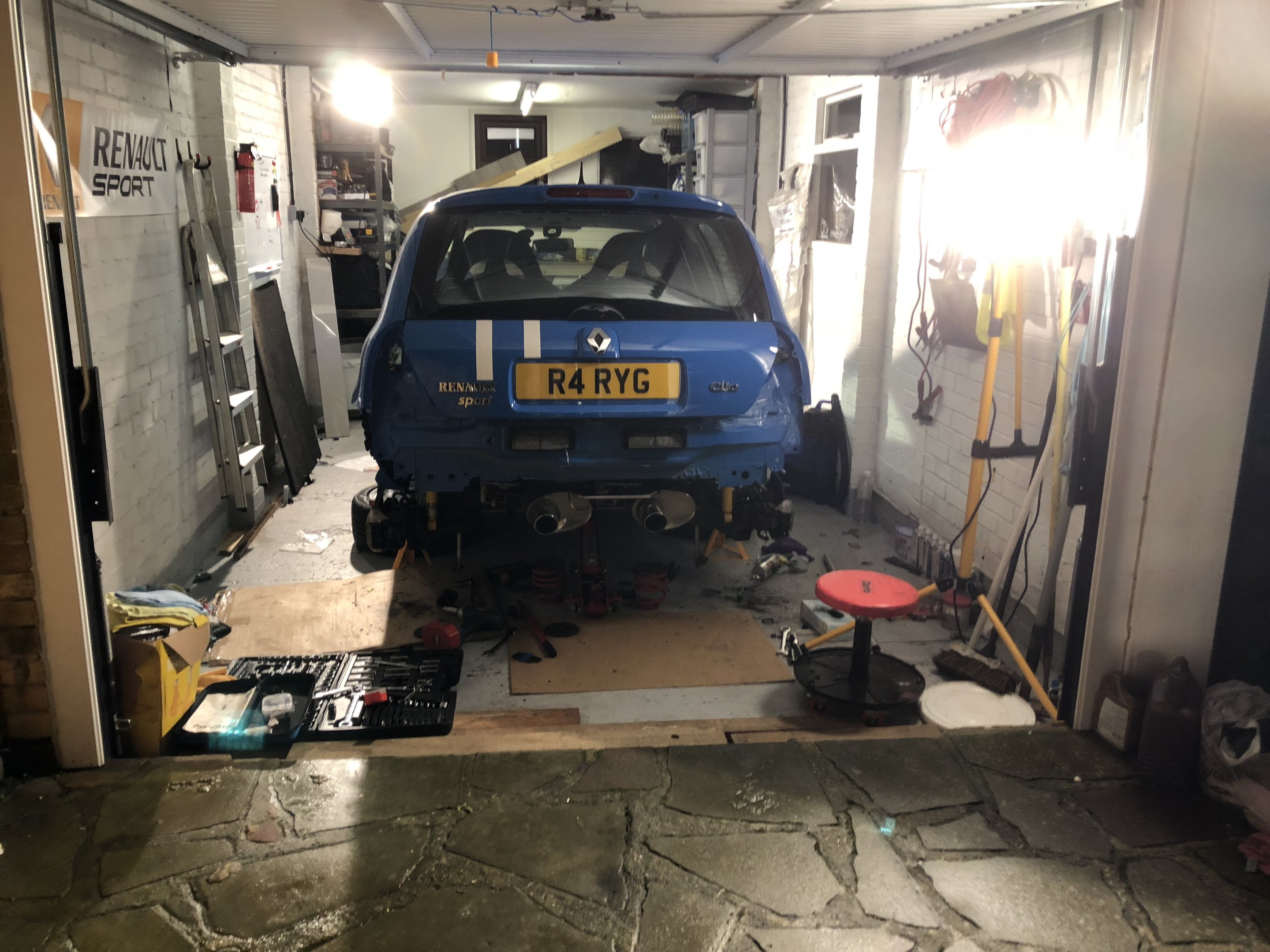

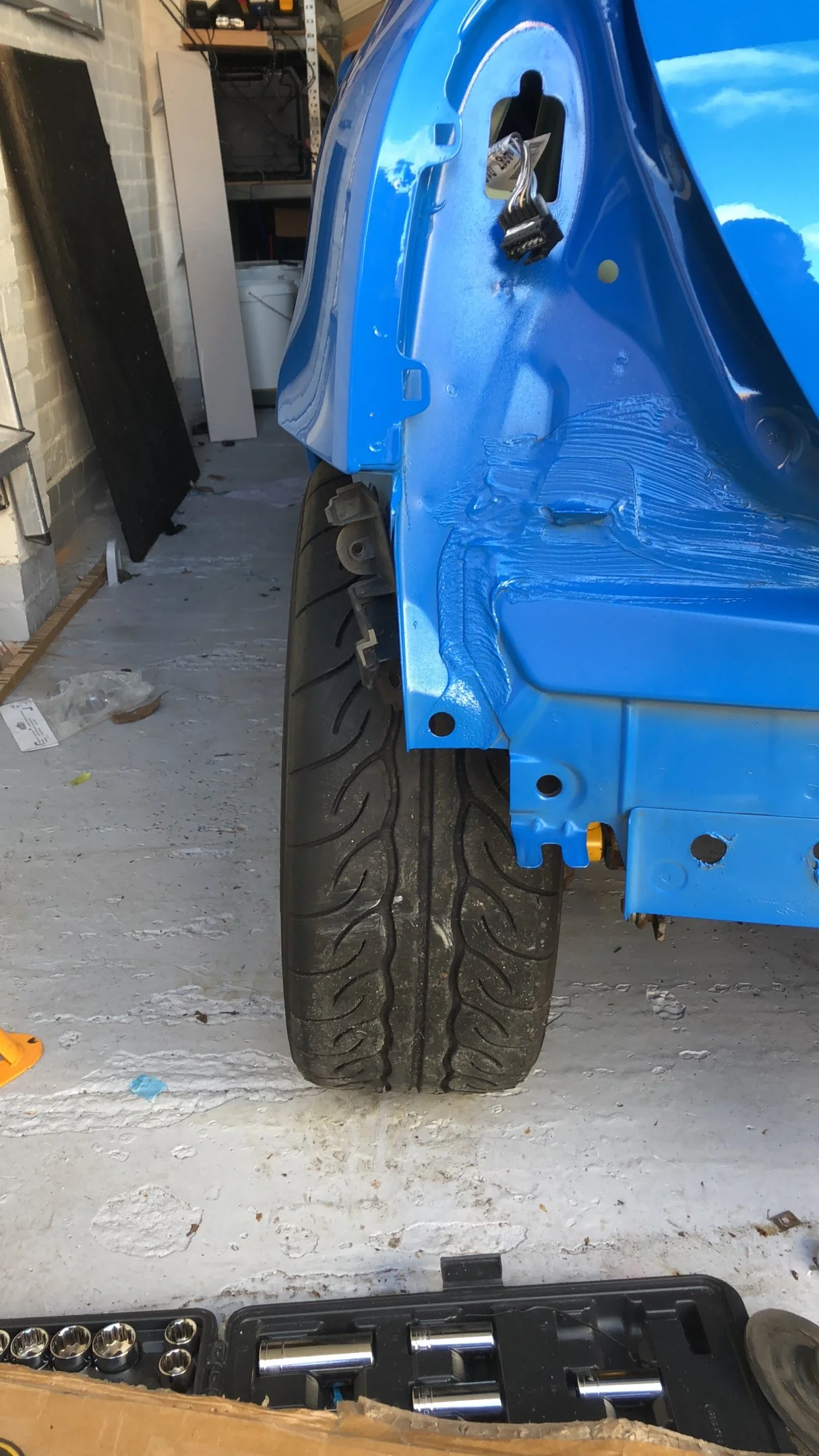

God that’s clean. What is it all off for?

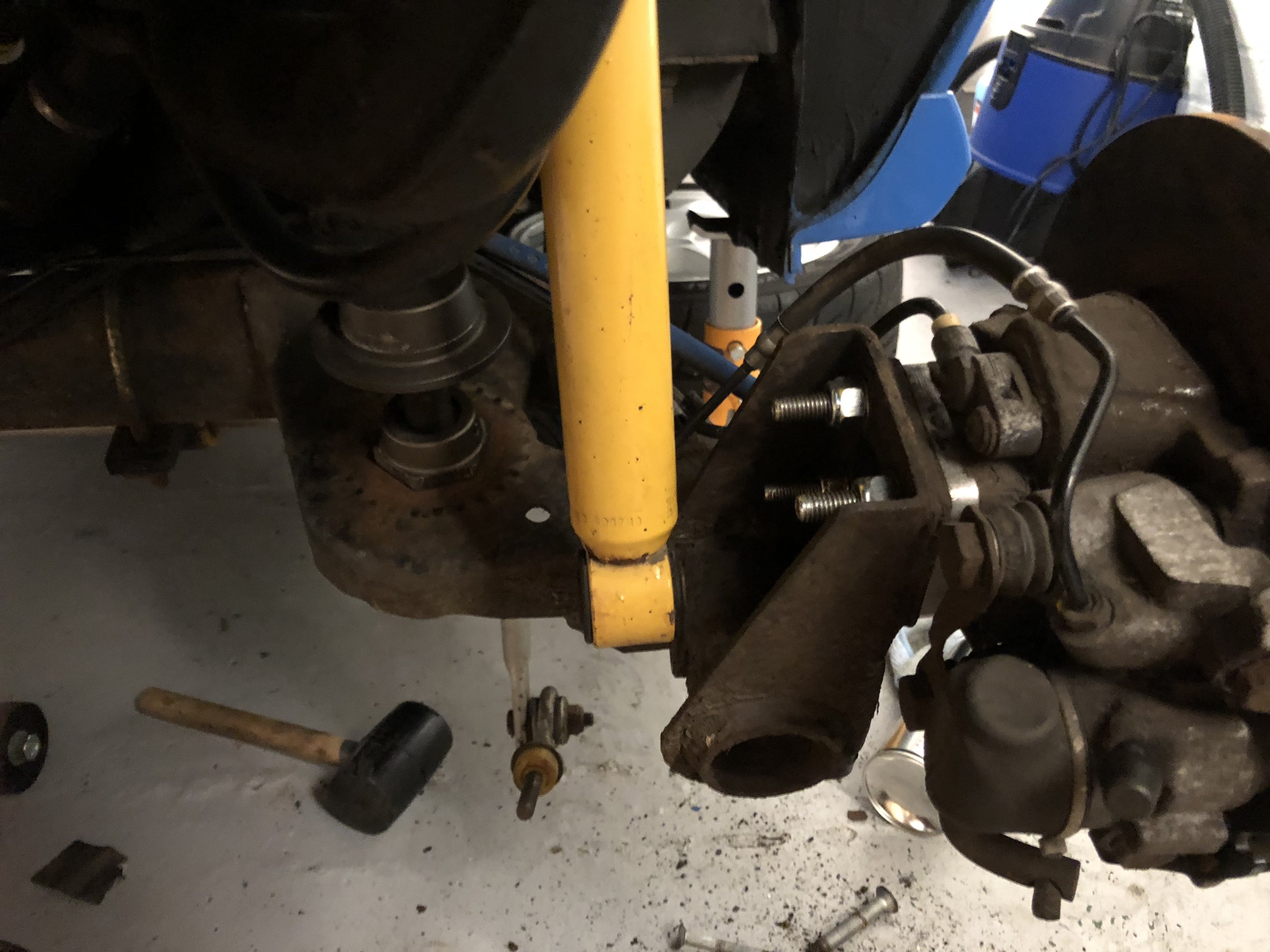

I was planning on re-fitting my rear spring adjusters but one has seized solid so I abandoned that (need some heat).
Whilst up in the air I thought I’d have a crack at removing the rear bumper as I’ve never done it before. Remarkably easy!
Whilst off gave it a quick clean. I’ll cover it in Tough coat before I re-assemble too.
Looks good mate.
How many bolts hold the rear bumper on?
6 in total. Two you can see above the bumper when you open the boot. One either side under the rear arches, and two in the middle roughly one each above the exhaust pipes.
One of mine was buggered though so I chopped it off. Will chuck a new bolt and nut on it instead.
