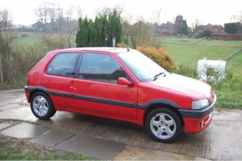

For quite a few months, I'd been keeping my eyes peeled for something I could buy, which looks completeley standard, and a bit of a POS, with a view to dropping in a decent engine, bigger/uprated brakes, and some decent suspension.
Whilst perusing the 106OC, someone in Farnham posted up a for sale thread.

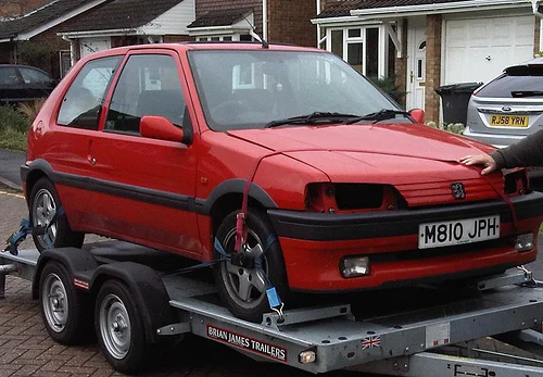

I liked the look of it, he said it was completely standard, bar an OMP steering wheel, CD Player, 421 manifold, and 2" Pugsport exhaust. The current engine had suffered a suspected head-gasket failure, which he had tried to fix, and cocked it up, somewhat. He said that all the parts were still with the car, which I was glad about. He wanted £300 for it. Perfect. So, I arranged with him to come and have a look at the weekend.
As I turned up, introduced myself, I was more than shocked, when he started walking around he car, pointing out faults, and tiny little things that without him saying, I probably wouldn't have noticed! The guy looked more awkward than I've ever seen at the thought of selling a car. I offered him £175, with a deposit and said I'd pick it up next weekend? We have a (pretty awesome, if i do say so) deal.

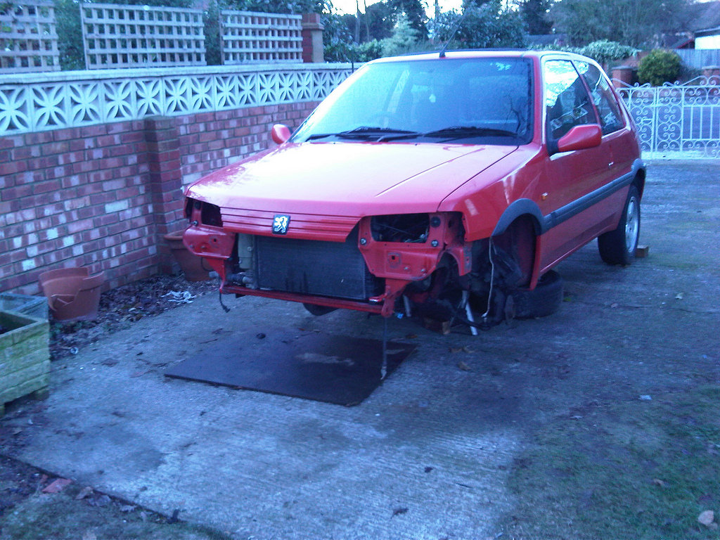

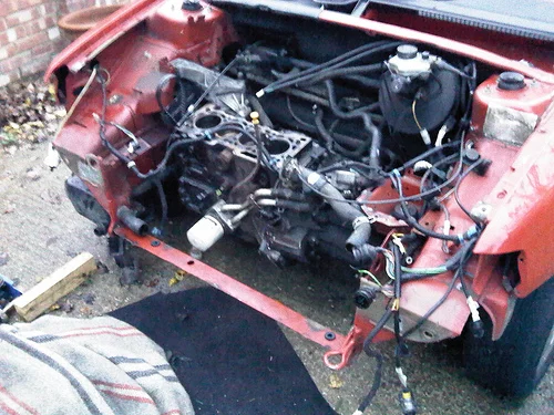

The next weekend:
Three hours later, the next weekend:

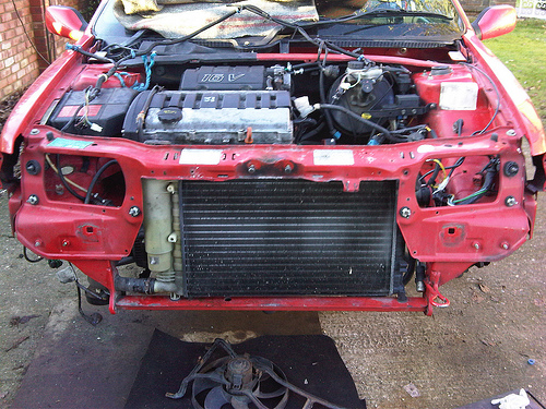

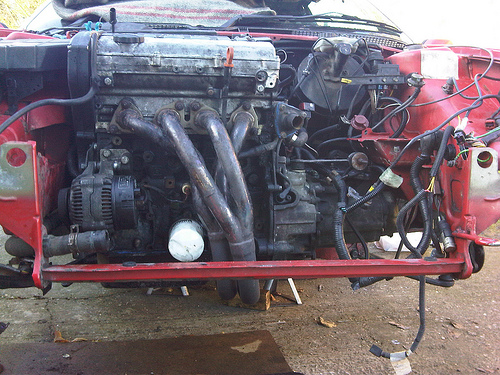

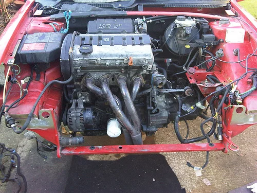

As of now, with much swearing, cuts and bruises, the car looks like this:
Engine's all but wired up. Fuel lines need connecting. Manifold needs putting on, then we should be ready to fire up (to see if the engine actually f**king works!)

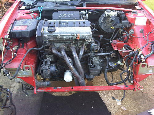

It runs! Got all the wiring finished off this morning, and connected the fuel lines. First turn of the key, and it started up! :) :)
  330i. E30 Touring.
Lol! The best feeling in the world! You always hear of people that have problems, so pretty lucky! Loud as sin, with no exhaust on!
  330i. E30 Touring.
I didn't do the cambelt because I didn't know if the engine even ran or not.. Now I do, it'll be getting done. Engine bay's starting to look a bit tidyer now. Alternator etc are all on. Picking up new ball joints, drop links, a wheel bearing etc tomorrow and going to get cracking!

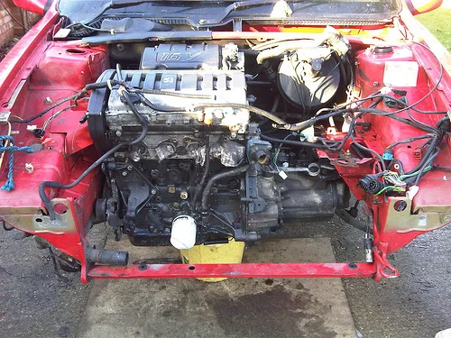

A few pictures of how it stands now:
Just need a pair of driveshafts, and a decent induction kit, and it'll be ready to properly put back together!
