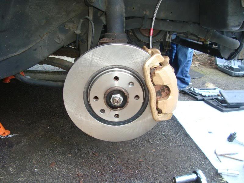

The only thing letting the car down at the minute are the brakes.
So,
266mm 206 GTi brake calipers, painted in black, just been refurbed.
Come with brand new Mintex OE spec pads, for a bargainous price.
Braided lines and discs needed (for the minute, until I find some DS2500's for decent money!).

Do the fit on ok ? When i had my 106 gti was going to do this but thought you had to skim the calipers to fit them ???

Yeah, these fit under the 14's with no worries at all. No grinding required!
Robbos-
If he's got 14" wheels, he'll need 266mm calipers and discs (from 206GTi, berlingo van, 306 XSi or similar).
If he's on 15" wheels, 306 GTi-6 calipers and discs will go. 283mm, and almost identical to 1*2 brakes! Most people (well, the clever ones) will use 1*2 pads with 306 calipers, as the pads are bigger!
106 forums have plenty of threads with all the info..
Rob
Larvely.... he's got some 16" team dynamics or maybe 15's I can't remember, lol.
Cheers for the info, I'll get him to go with the 306gti ones if they are readily avaliable??

If he goes up from GTi brakes to 306, it'll stop on a sixpence! Look in Sir_Dave's VTS thread for the difference in size! Massive!

Where did you source the gti 6 calipers etc from?

Loads of the forums have 'em, quite often. www.306gti6.com, 106OC, Sax-p. Some bargains to be had!
