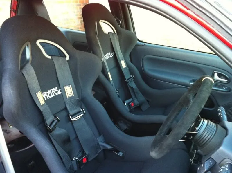

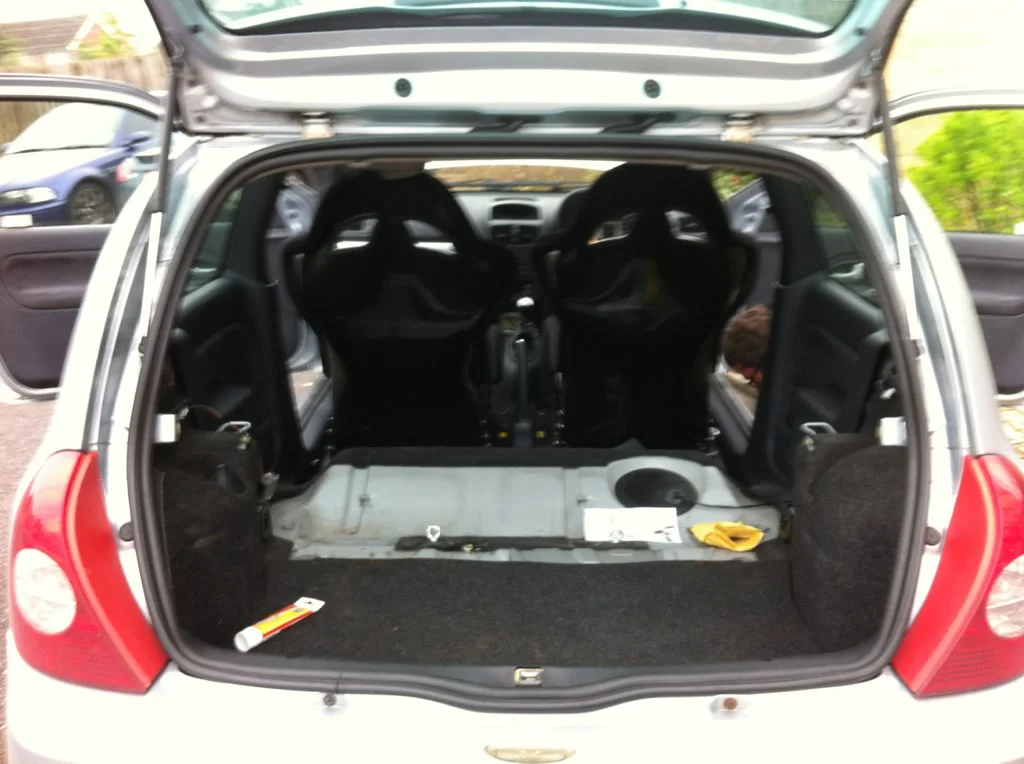

So i've had the car three weeks and already been doing my shopping, So far i've bought Ktec stealth supersport exhaust, Powerflex lower engine mount, Whiteline arb, Pro race 1.2s, Bimarco Bucket seats, RMD steering wheel, Sabelt 4 point harnesses, couple of other little bits.
Haven't got massivly far as of yet but hopefully get a bit further this weekend when i pick up the wheels, seats and steering wheel.

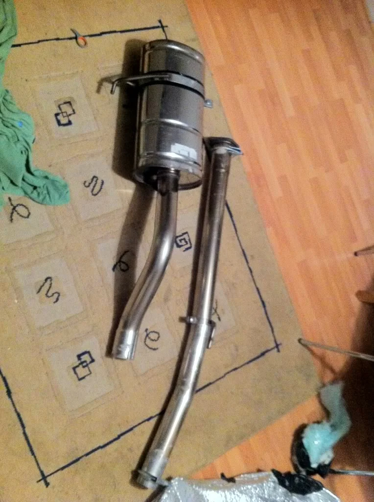

I have standard by getting the exhaust fitted, thats about as far as i have got so far, heres a few pictures.

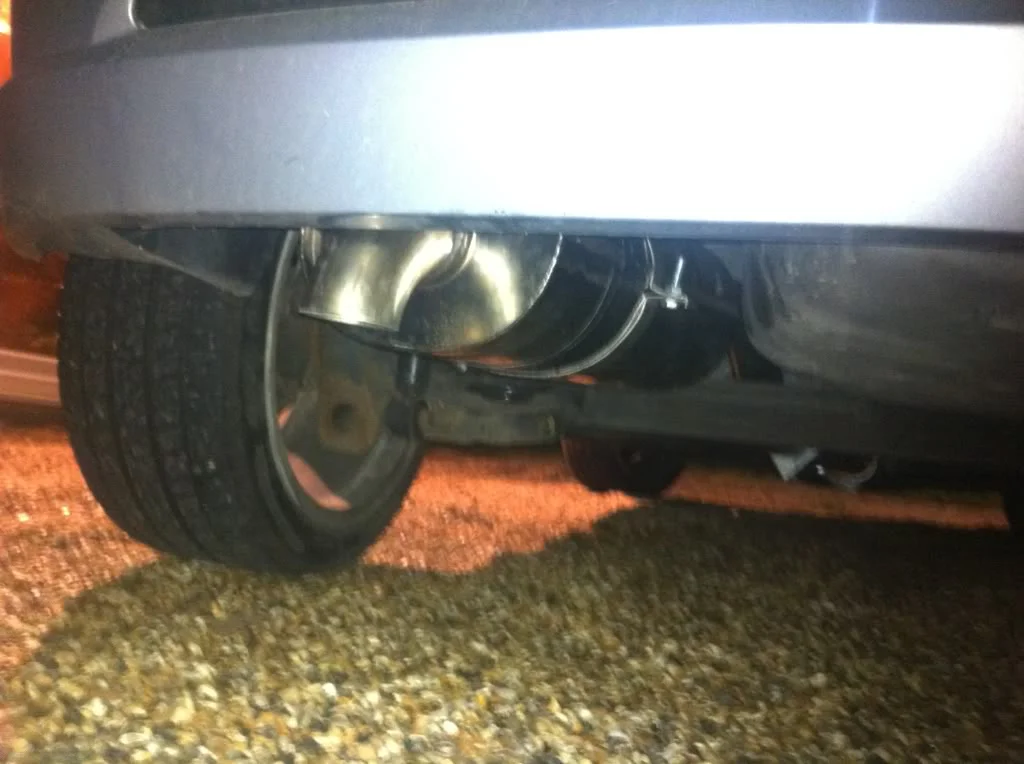

Your stealth exhaust doesn't appear to be very stealth like...

Yer I need to look at the exhaust again. Get it on better. Love the seats
Ah bugger, completely forgot to have a look at that for you!! Try wanging a bit of hose pipe in the rear exhaust mount to hold it up a bit higher ... Glad you like the seats!! I now feel like im sat on the clio, rather that in it, comfy though! Need to retrofit the cruise into your old steering wheel though.
The exhaust is fun to get just right
What you want to do is loosen off the bolt on the main hoop bracket on the back box - and loosen off the clamp between the back box and center pipe and the clamp between the center pipe and cat - then lay under the back and push the back box up as far as you can - the whole lot sort of twists around and the back box ends up right up behind the bumper
Then while you're holding it up get someone to tighten everything back up - or stick a jack under the backbox and tighten everything up yourself :)

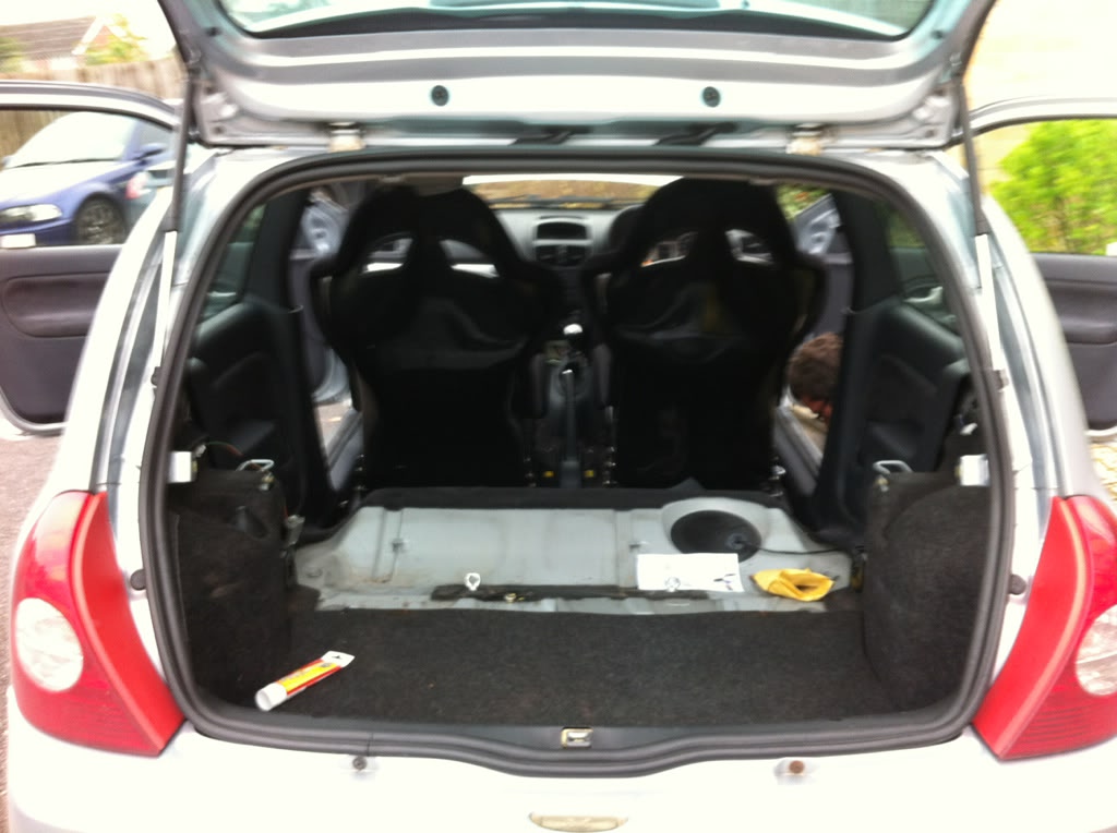

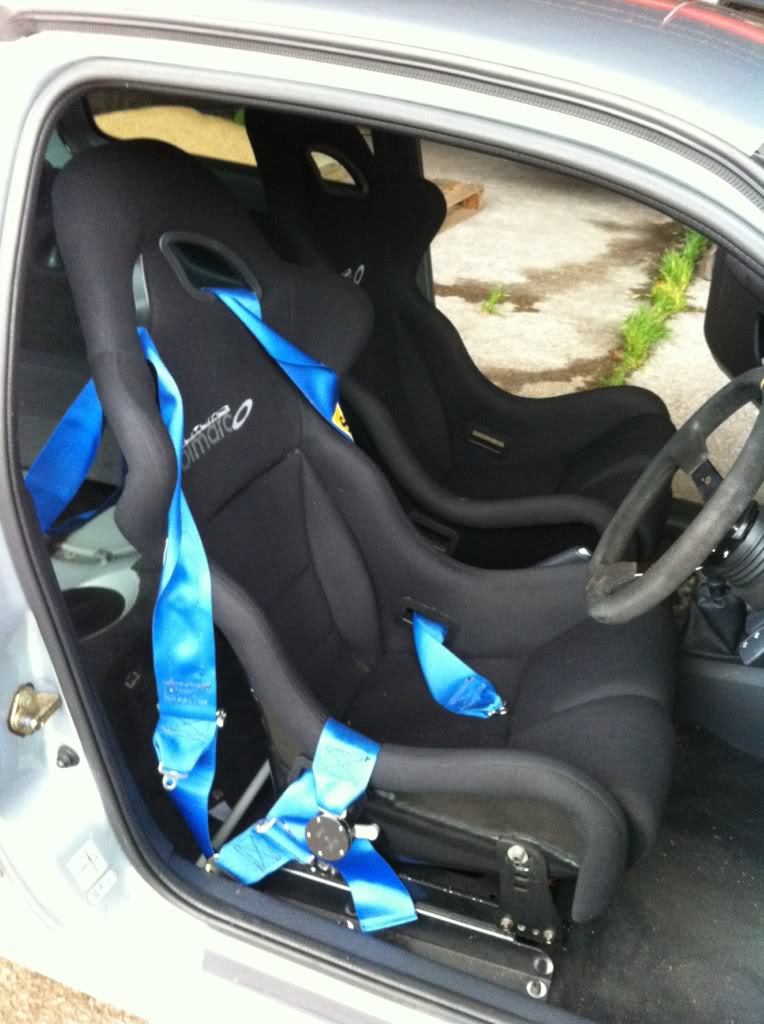

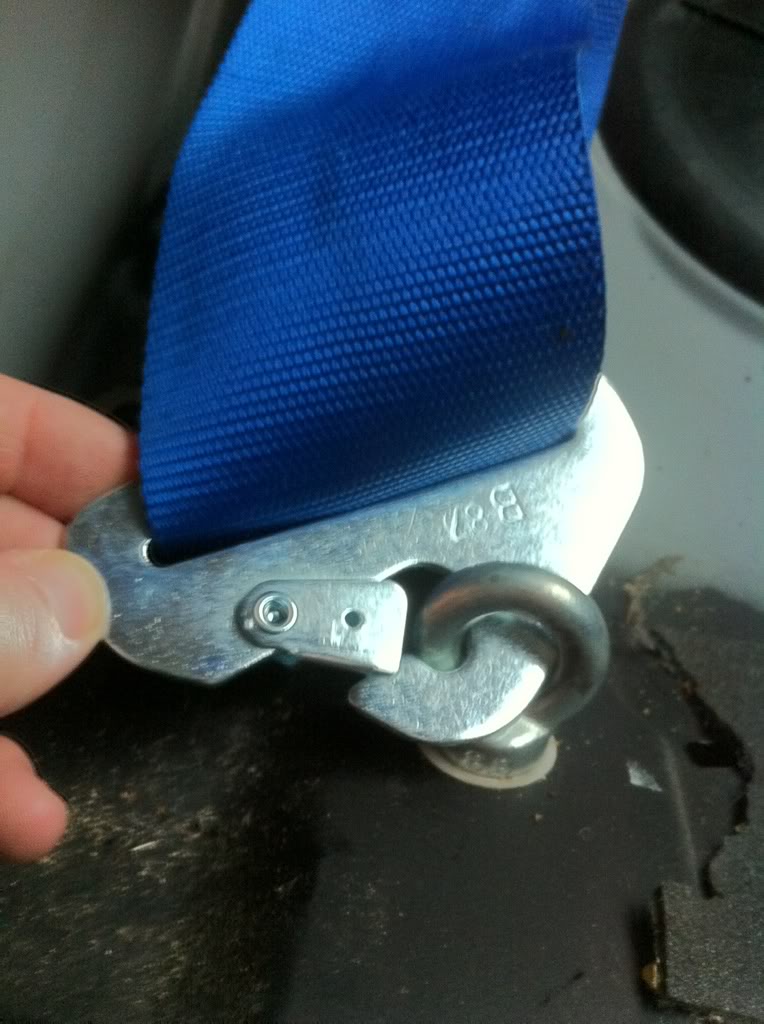

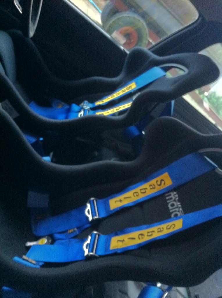

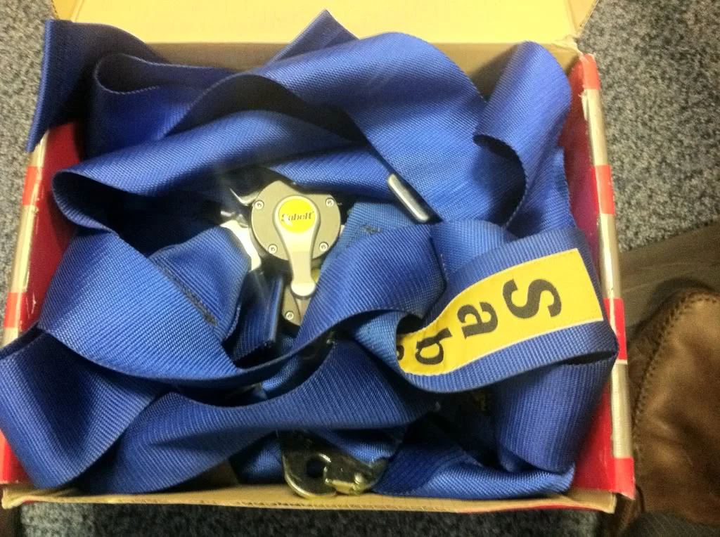

Firstly I fitted all my harnesses properly with some new clips :). Nice and tidy now and took out some unwanted plastic bits from the back!

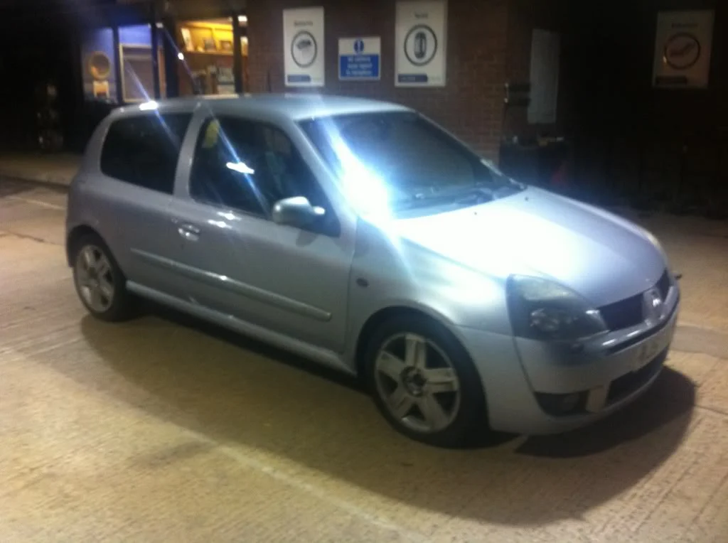

Next I fitted my new smaller number plate :) thanks to revels for the guide on CS. Heres a picture of how it stands at the moment!

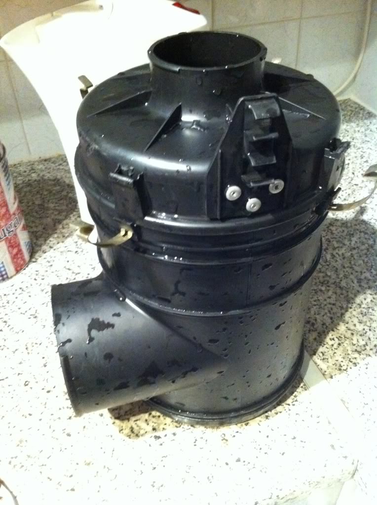

I also fitted my V6 Airbox at some point and collecting a spare dogbone mount so i can fit my lower powerflex mount.

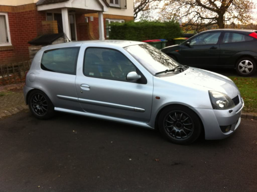

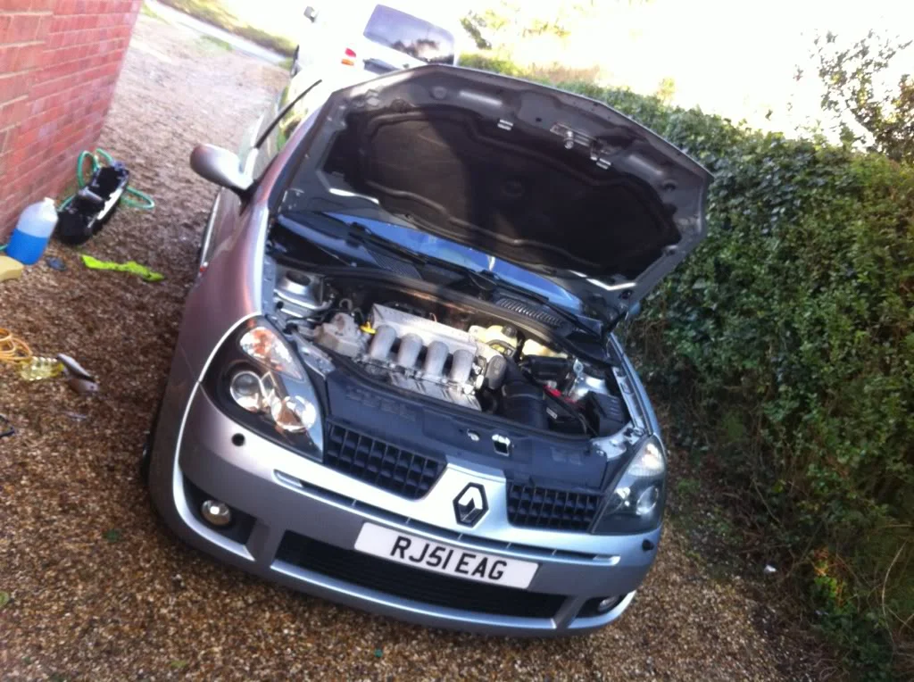

Gave it a clean last weekend. Checked the fluids took a couple of snaps and went out on a drive. Needs a proper wash/clay/polish/wax so i will try to do that over Christmas

Also think i will remove the V6 airbox i brought. I can't tell any differ so feel its wasted!

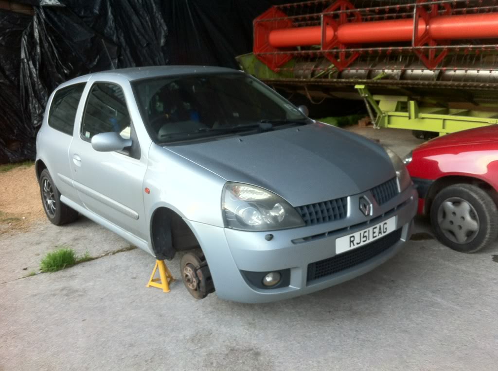

Anyways last week the rear bearings gave up :(. This called for new rear discs, bearings and pads. Next up I need to get a detail done, car need.claying but I'm moving house so not got the time for a few more weeks! Also I'm hoping to get a RS tuner map from Will when I get a chance

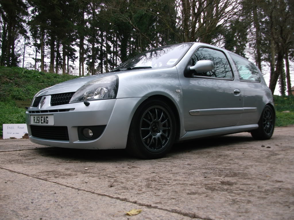

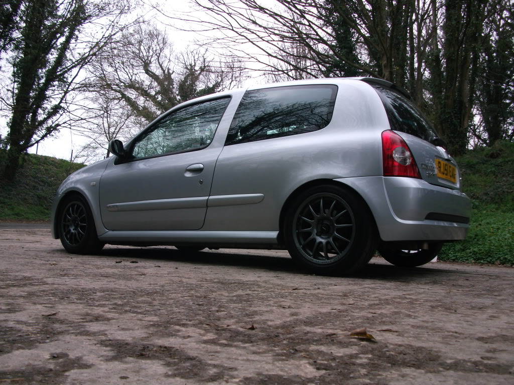

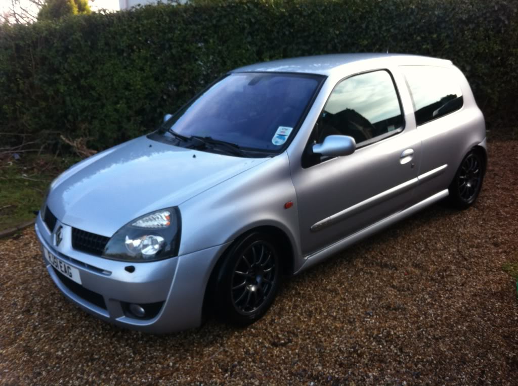

Finally gave the car a good clean over easter weekend, full wash, clay, polish and wax.
A couple of pics

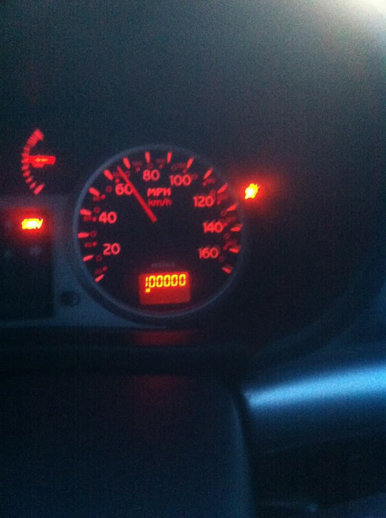

This week it passed the 100000 mile mark
So it really was time for a oil change, oredered some bits from Opie and did it myself. I'll do the air, cabin and fuel filter next
