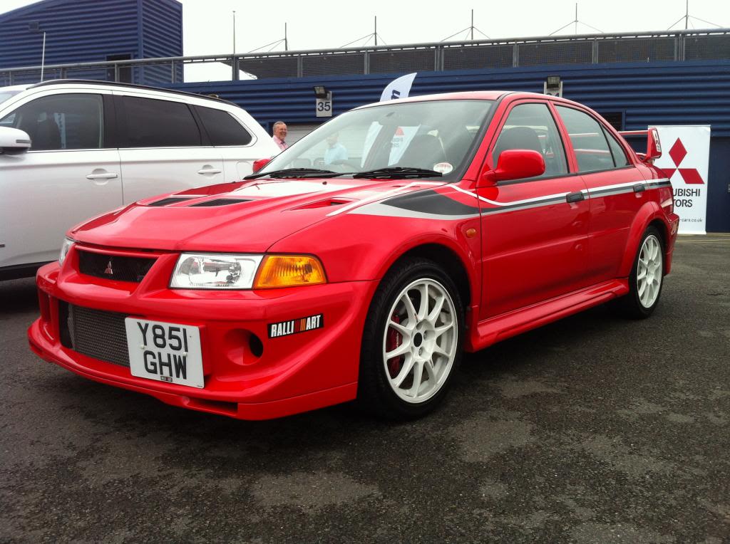

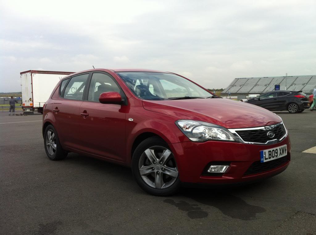

Enjoyed a track day at Rockingham the other day with the Guild of Motoring Writers. Was a great day out where I was able to not only thrash my Clio around the circuit, but also sample several manufacturer's cars including the 2013 Fiesta ST, the Kia ProCeed GT and even THE Reasonably Priced Kia C'eed from Top Gear! That was probably the single most fun I'd had on a track ever! I also had a passenger ride with a rally driver behind the wheel of the only UK Evo X FQ400 - that machine goes round corners like a bloody F3 car!
Anyway here's some pics and on board footage of my Clio from the day.
THE Reasonably Priced Kia from Top Gear, what a laugh this car was on track
And an Evo VI Tommi Mäkinen edition. It had only covered 1300 miles since new, and so felt as quick as ever!

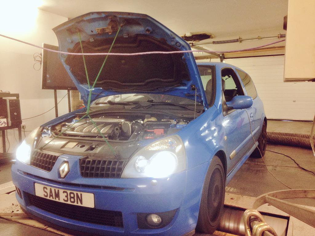

Recently I fitted a Ktec induction kit. Initially I complained that it seemed to have strangled my car's top end; 50 miles later and almost over night the car was transformed. I assume this is to do with the car's ECU adapting to the change in fuel/air mixture?
Whatever the reason, immediately I noticed throttle response had sharpened up, while torque had also noticeably grown through the mid-range.

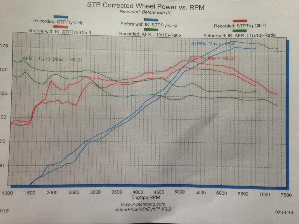

Not long after I decided to take my car to Ktec for a remap. Before the map, my car ran with 179bhp on the rolling road (standard ECU and map, Ktec induction kit and Yozzasport catback). I was pleasantly surprised considering my car had passed 113,000 miles at this point.
After 30 mins of runs, Andy (I think that was his name!) managed to squeeze and extra 7bhp out of the engine, upping the rev limit and tickover revs on the way. The result? The car not only pulls noticably harder right through the rev range, it also feels substantially more responsive. Heel-and-toeing is a joy.
