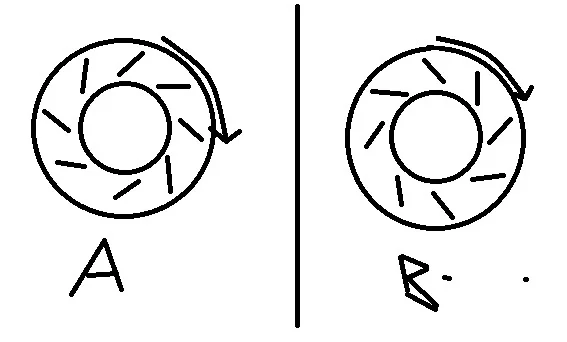

Hi mates, I just had a look at the brakes and my brother is an car fan and he showed me some documents that it is possible that my front discs are mounted on the wrong sides. The grooves are in the direction the wheel turns so it may be possible that the water can not be thorown out at speeds more than 50mph. What do you think about it?
A or B is corrent?
