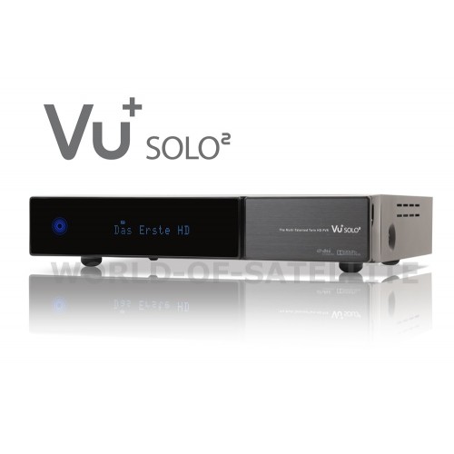

VU+ SOLO 2
VU + Solo ² Specifications:-
2 x DVB-S2 tuners
Input frequency range 950 .. 2150 MHz
Signal Level - 65 dBm ... - 25 dBm
Tuner Input Connector F-Type female
Input impedance 75 ohms
AFC + / - 3.5 MHz
QPSK and 8PSK demodulation
FEC Viterbi and Reed-Solomon
Viterbirate 1/4, 1/3, 2/5, 1/2, 3/5, 2/3, 3/4, 4/5, 5/6, 8/9
Roll-off Factor 35% Common-Interface:
Common-Interface Power Consumption max. 0.35 A/5V video decoding:
Video Compression MPEG-2 / H.264 and MPEG-1 compatible
Video Standard PAL G / 25 Hz, NTSC
4:3 / 16:9
Letterbox for 4:3 TV-Device Output Digital:
Output Level 0,5 Vss on 75 Ohm
Frequency: 32 kHz, 44.1 kHz, 48 kHz
S / PDIF optical, coaxial (AC3) audio decoder:
Audio compression MPEG-1 & MPEG-2 Layer I and II, MP3
Audio Mode Dual (main / sub), Stereo
Frequency: 32 kHz, 44.1 kHz, 48 kHz, 16 kHz, 22.05 kHz, 24 kHz
Output analog:
Output Level L / R 0,5 Vss on 600 Ohm
60 dB (1 kHz)">THD> 60 dB (1 kHz)
Crosstalk <-65 dB Video parameter:
Input Level FBAS 1 Vss + / - 0.25 dB on 75 Ohm TV Scart:
Output: FBAS, RGB, Ethernet over OSD:
1000/100/10 MBit compatible interface USB:
USB 2.0 connector (3x) LNB power and DVB-S2 Tuner:
LNB Current 400mA max. , Short-circuit proof
LNB Voltage horizontal "no load 19.5 V" 17.6 V at 400mA
LNB Voltage vertical "no load 14.5 V" 11,8 V at 400mA
LNB is switched off in the standby mode, control of the satellite position:
DiSEqC 1.0/1.1/1.2 and USALS - Rotor Control Power consumption:
<13W (in operation, with LNB)
<12W (in operation, without LNB)
<0.5 W (Deep-Standby-Mode) Input voltage:
External power supply:
Input:
110-240V AC / 50-60Hz / 1,0 A
Output:
12V = / 3,5 A

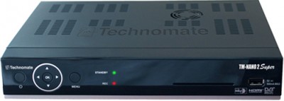

Technomate
System:
Video Decoder: MPEG-2, MPEG-4 HD, H.264, PAL, NTSC
Audio Decoder: MPEG-1/2, Dolby Digital Plus AC3 Audio
Tuner: 2x DVB-S2
High-Definition HD: 1080p, 1080i, 720p, 576p, 576i
CPU: 1300MHz Dual Core
SDRAM / Flash: 1024Mbytes / 256Mbytes
Front:
Front Display: X
Front USB: 1
Smart Card Reader:1
Common Interface (CI) Slot: X
Rear:
Video Interface: HDMI, RCA
Audio Interface: Optical S/PDIF
Ethernet Interface: 10/100/1000Mbps
Rear USB: 2x USB 2.0
RF Modulator:X
Internal SATA Support:O
Fan:Temperature & Speed Controlled
Input Voltage:12V DC
Standby Consumption:Under 1Watt
Size (WxHxD):270x55x190 (mm)
Weight:2.0 Kg
So, I am thinking I want the VU+ overall, seems to have nice images and allows some HD, but not all HD.
Unless I move to a Euro Satellite.
Anyone got any experience with the details of that?

I'd go Technomate of the two.
The VU issues on the duo is enough to put me off.
