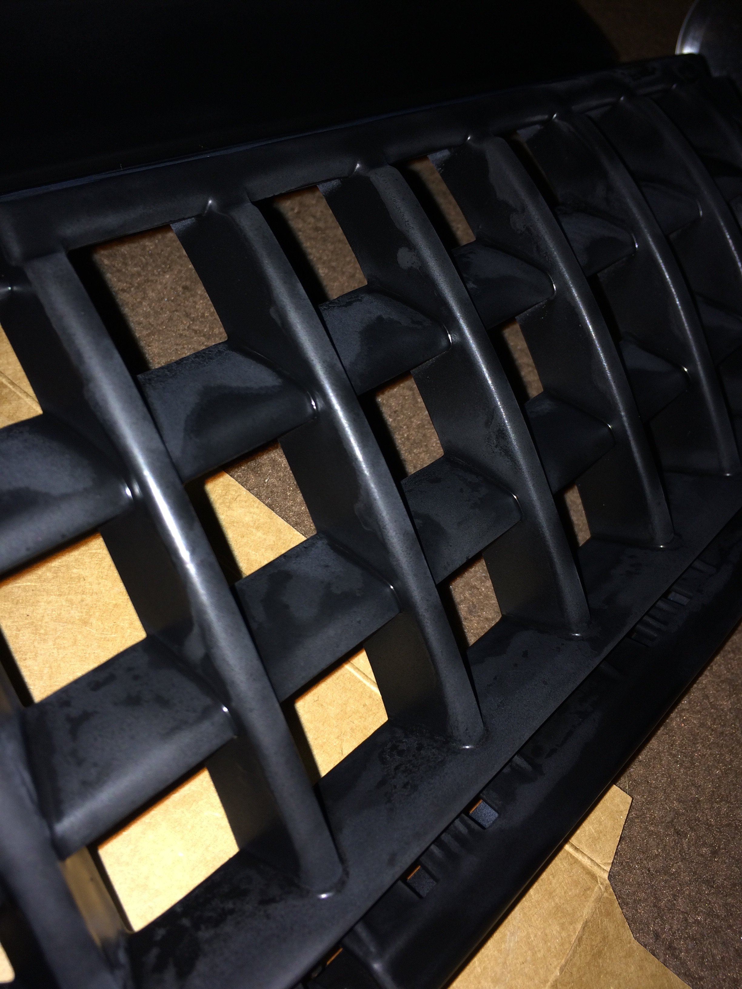

spraying my grill satin black, I've sprayed several coats of plastic primer, it is ready to sand 1200 grit and then spray satin black, how do I go about protecting the satin black?

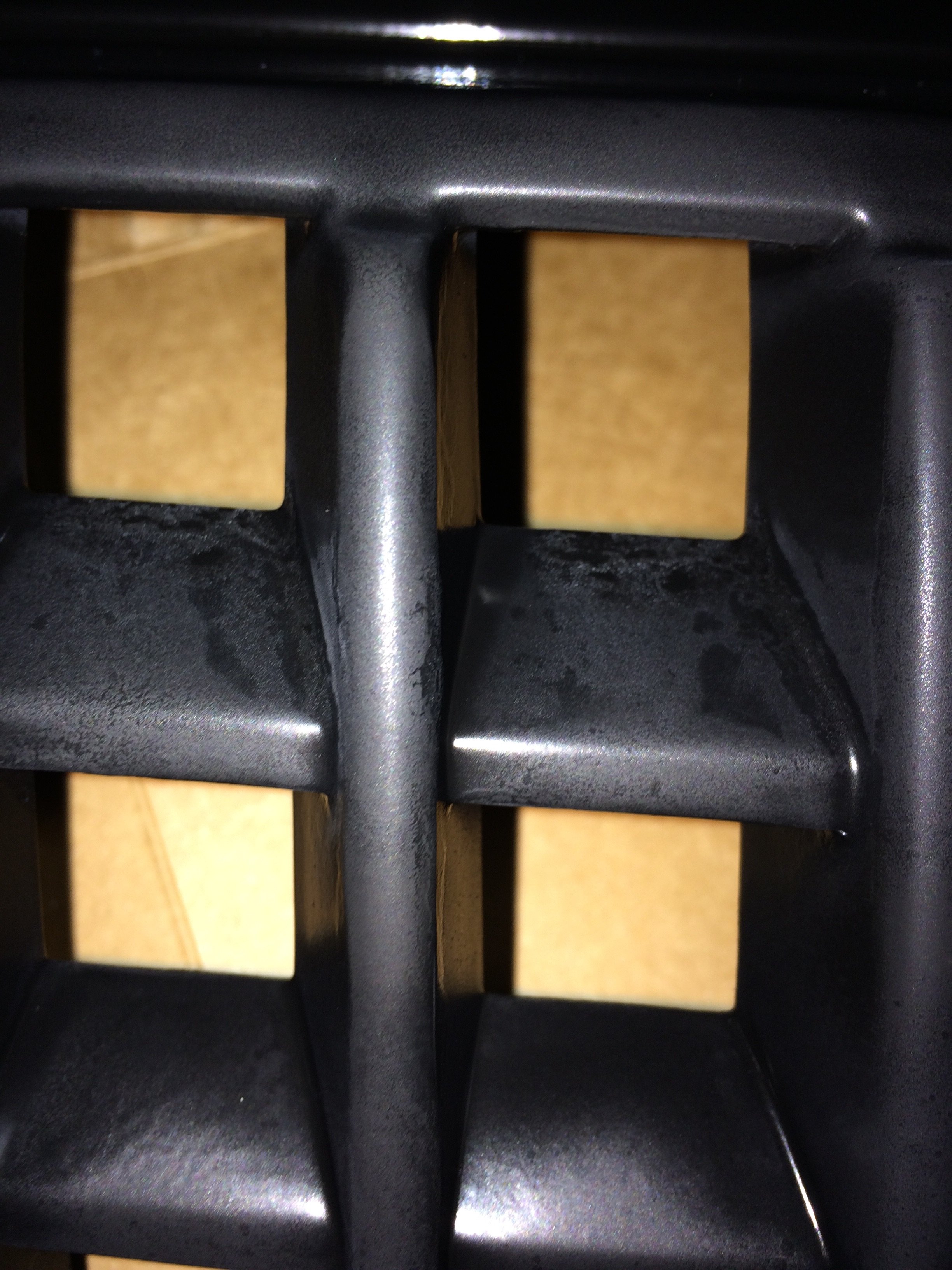

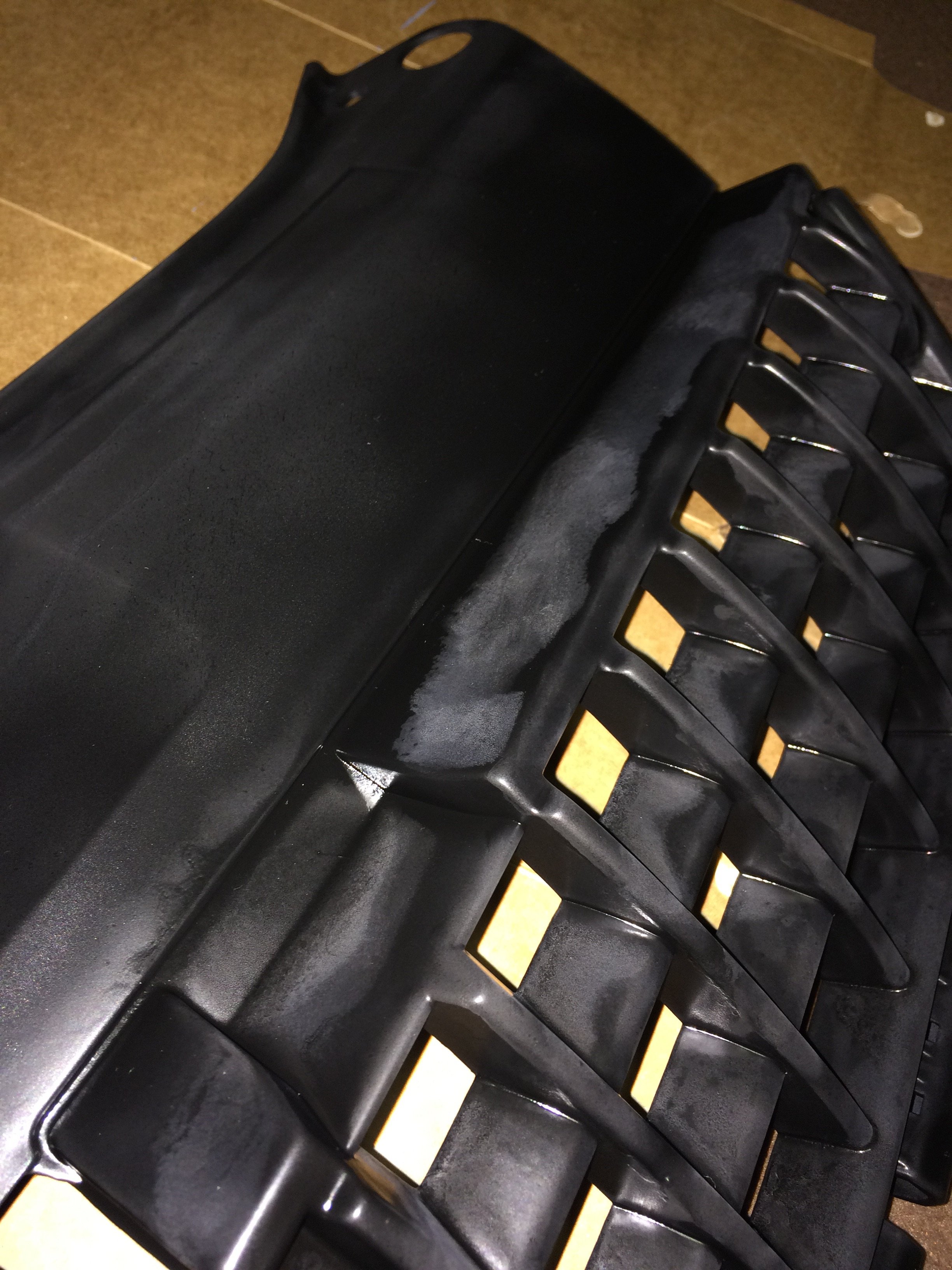

That's true didn't think of that! My satin has gone really odd though,
Any idea what's going on here? Not my luck with paint today!

I don't mean to sound rude, but wtf have you done??
I just wiped mine with alcohol (IPA) and sprayed 2 coats of satin black on it, came up like new! Lol.

You painted after it rained, too much moisture in the air.
Better off buying a new one and spraying it now, it's fucked. Unless you want to rub all the paint off.

That's to much product applied to quickly mate, it's a solvent reaction.
No need to have applied primer, just a normal plastic adhesion promoter would of worked but failing getting that then one coat of primer then wait 10-15 mins, then apply the satin. Less is more to begin with. Should wait 10 mins inbetween coats aswell.

Well listen to me as I'm a painter by trade lol.
It's not moisture mate, you can spray in your shed when it's raining and it won't do that it's rubbish.
Leaving it that long won't help mate, did you sand it down? Possibly broke through then that will cause a similar reaction.

Firstly I cleaned it, then wet sand 240 grit everywhere, then plastic primed about 3 coats as the plastic was sucking some of the paint up, I found 3 coats found good even coverage. Left 2 hours. Rubbed down 1200 grit, dryed, then sprayed 4 coats of satin black. The paint seemed to sink into the plastic quite a lot! I left 10-15 minutes between coats.
I can't afford to get a new grill, I've taken all the paint off, I shall sand it 240 grit again, what do I different this time then? to avoid the reaction?

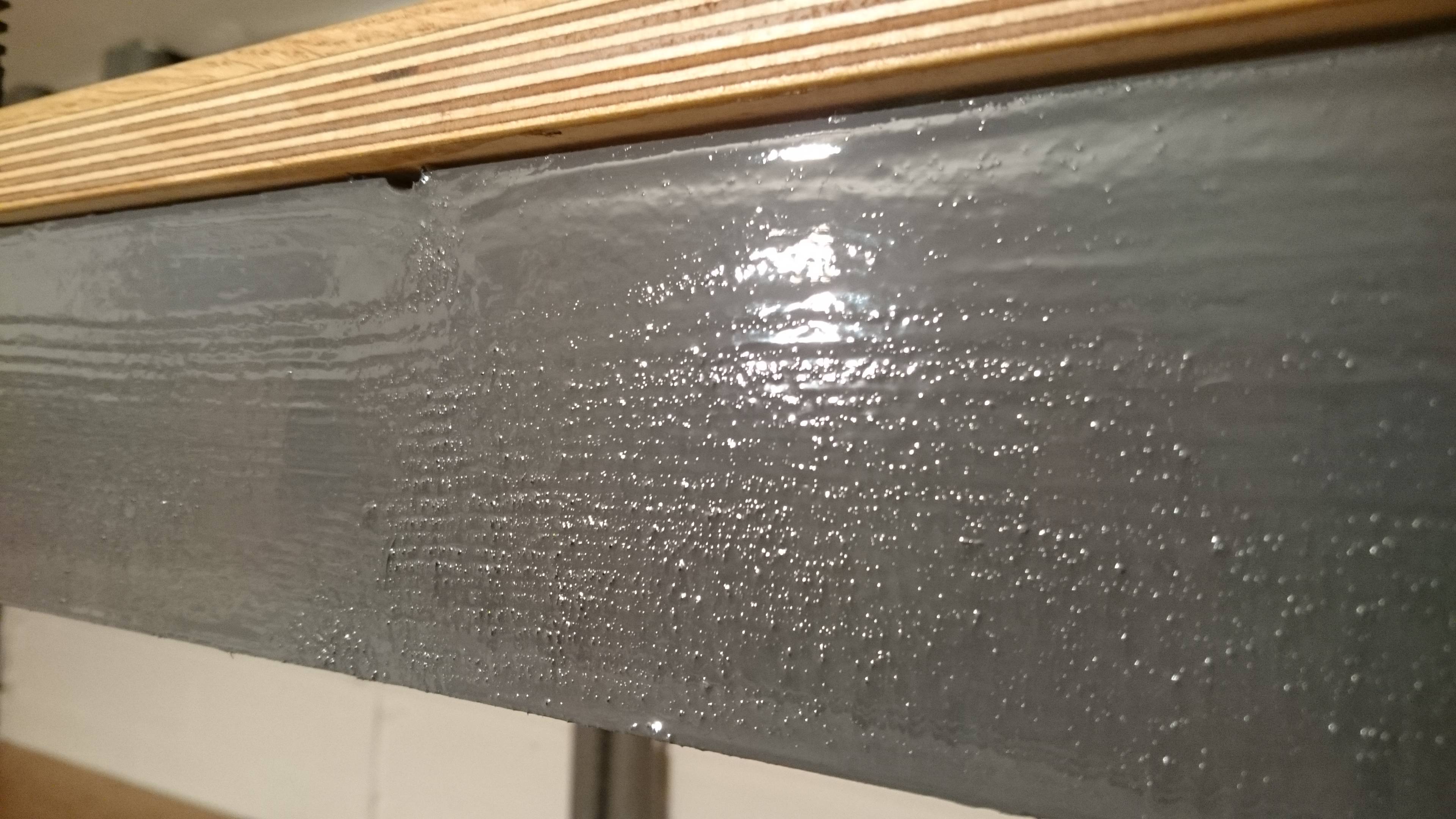

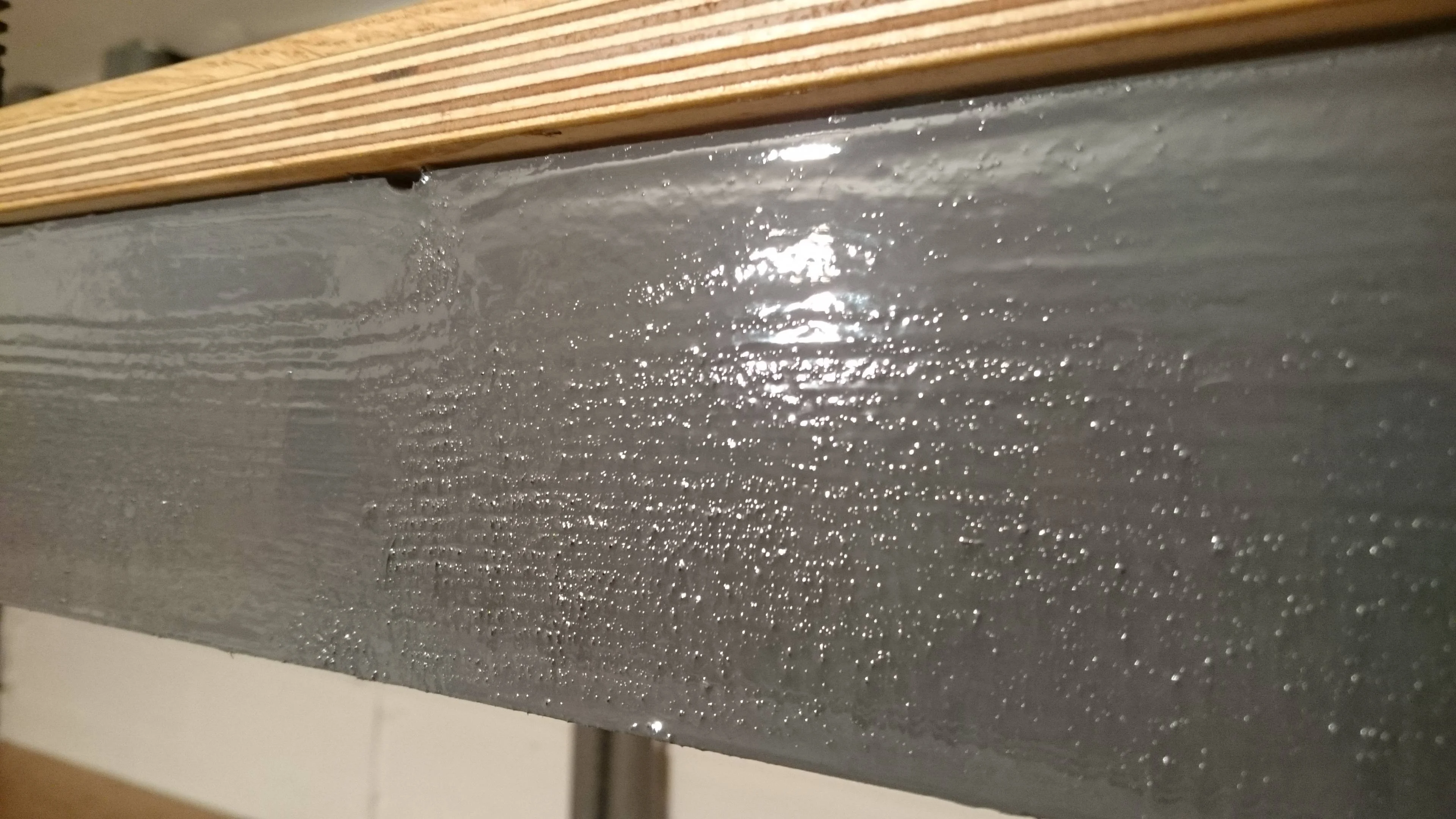

@Craigy88 - Need some advice if I may (sorry for posting on your thread Tomo)
Ive been constructing some garage shelves and painted the frame which is made of wood with grey gloss paint.
The paint has reacted and gone pimply like in the pics on most of the wood. What do i have to do to fix this. Im waiting for the gloss to harden more at the moment as the plan was to sand.

Personally I don't think the primer was dry enough either after only two hours, but being outside with heavy humidity made it even worse.

240 is way to rough mate.
Finish in anything above 500-800....
Clean it down, warm it up a tad, one coat of primer. Wait until it's dry and looks Matt all over, like 10-15 mins and then just use a direct satin finish mate, 2-3 coats is plenty. All the same thickness.
Don't go gloss you won't be happy with the result trust me, a decent finish on satin will be pukka.
No worrys, wood always does this.... Just trapped air pockets in the wood. Only way to loose them is as you say just rub it down, break the bubbles as it were, release the air trapped and go again. In my experience depending on wood I have done, mainly running boards on rolls Royce/bentleys is 3 coats once dried and rubbing each coat down seals the wood. So 1 coat, dry it, rub it, repeat. Heat them up as that draws the air out but will make more pimples appear.
You can get wood sealer but obviously you've painted yours now. On other shelves try sealer then the gloss.
No problem mate was the surface smooth before you painted it?
Tbh mate, I've always thought primer was meant to be left for 24 hours to dry before doing anything but I was told before I started spraying my grill that I shouldn't leave it 24 hours because it will harden and won't have the same adhesion compared to a 2 hour dry. In the past I've always left it 24 hours, but all these new paints there's so many different rules etc. I've never had a problem when leaving it 24 hours. I've only started having problems with paint when I haven't had a lot of time to wait and be patient for the paint to dry, I think this adds to the list of reasons! Very good point that, I think I will leave it 24 hours primed and then carry on like usual. I just rushed doing it last time.
It could be a reaction because the primer wasn't fully dry and the satin sunk back into the primer and reacted with this, when I was spraying the satin it did sink quite a lot into the plastic! Where as if it was 24 hours left to dry, the primer would be hardener to not allow the satin to 'sink' and mix with the primer.
It could also be that the primer had moisture in it after spraying and because of it not fully drying out for 24 hours, letting all the moisture evaporate then the satin has trapped in the moisture in and this is shown in the finish.
Either way I'm going to go back to my old technique of leaving 24 hours, I'd never had problems with that in the past so not sure why I changed. Just the advice I'd been given.
I appreciated both of your's advice and I've taken it on board, too a certain degree I think you're both correct. I certainly agree it's a reaction in the paint of some sort but then again i also agree I'm painting in a damp moisture heavy environment which won't help either way. I will respray this again after removing all the paint and preparing the surface for the primer. I will leave it 24 hours to dry, and I will spray in a warmer environment. I will post the results in here. Thank you both!

I've always finished in 400 grit before sanding but my brother who does a lot of painting at his work told me that was too high for primer. Only 15 minutes between primer and satin? Really?
I was tempted to go gloss because I wanted a slightly shiny finish like I thought satin had, but when it was dry I up it just looked Matt! See that grill looks really really good and does have a shiny tinge to it! I will think about it, but we will see how it goes.

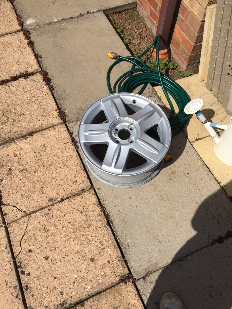

I refurbished my alloys, I left 24 hours after primer before I sprayed the black and they came out brilliant. It's in my project thread, had a few comments saying it's the best diy job they've seen. I must say they look pretty good, I think I will go back to my old technique and see how I go on with that! Oh really? Wow cheers mate
