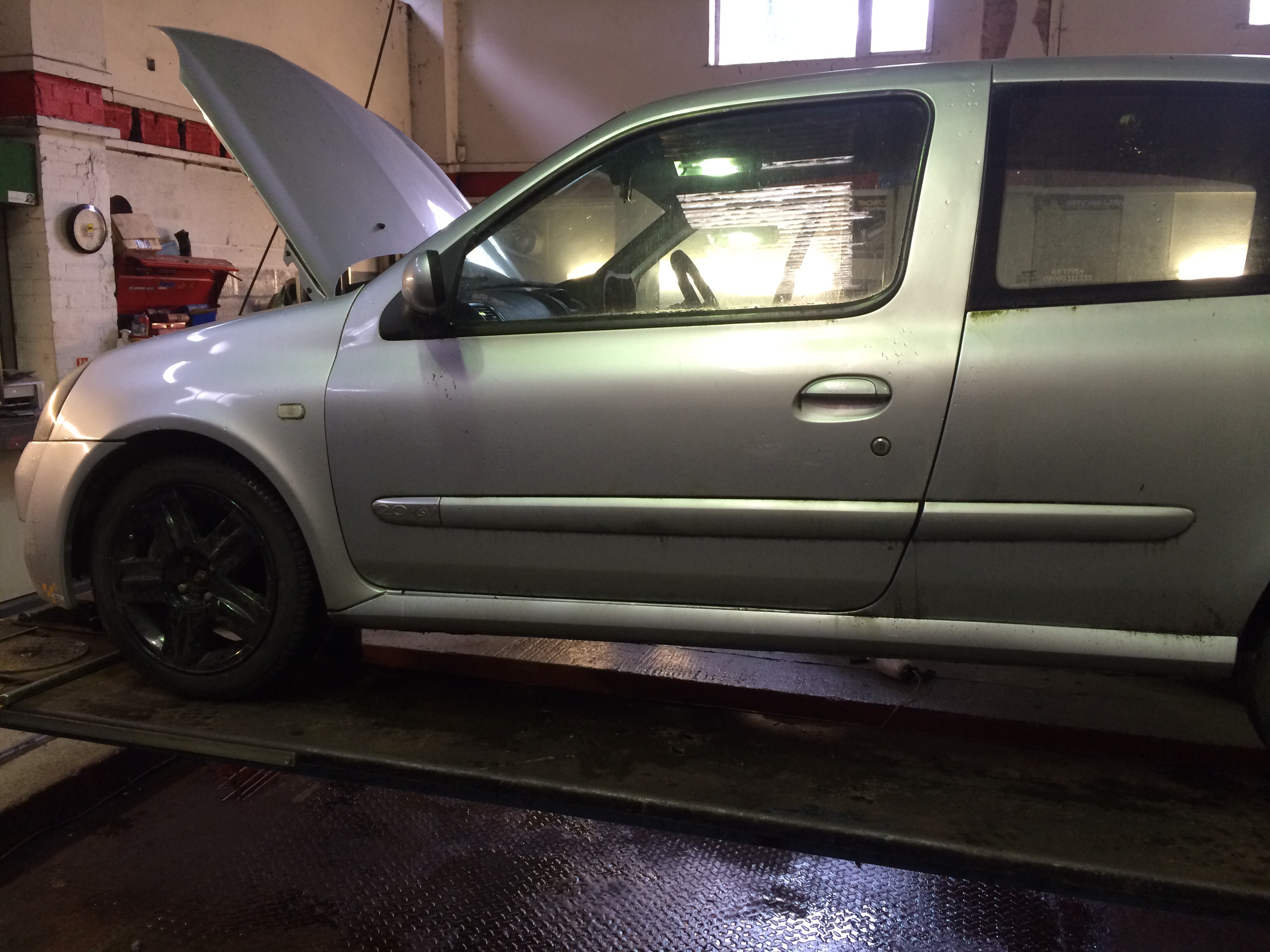

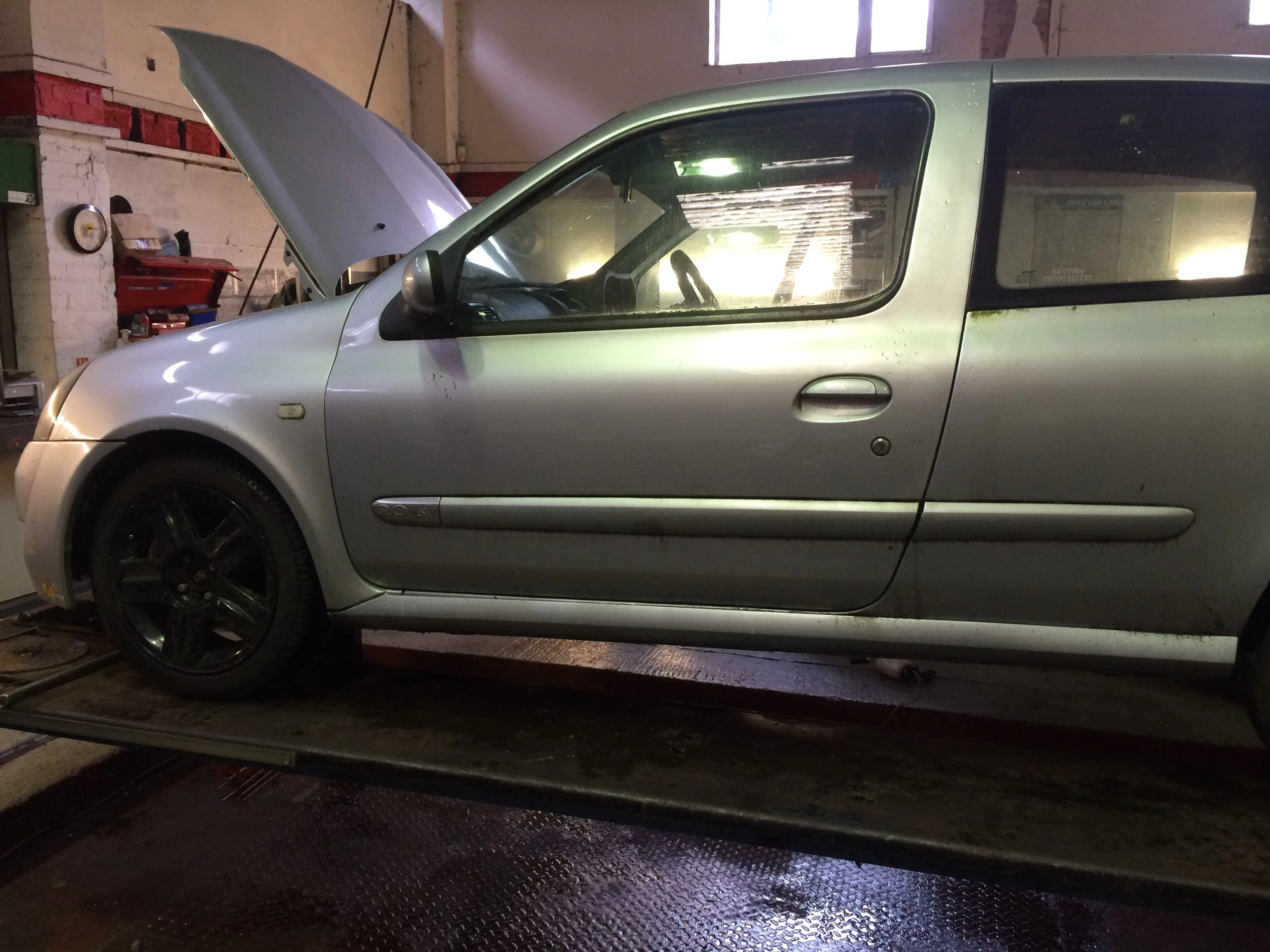

Abit of an update she's now moved to inside the unit!!!
Not as bad as I first thought a lot to do and long hours a head but will be worth it!

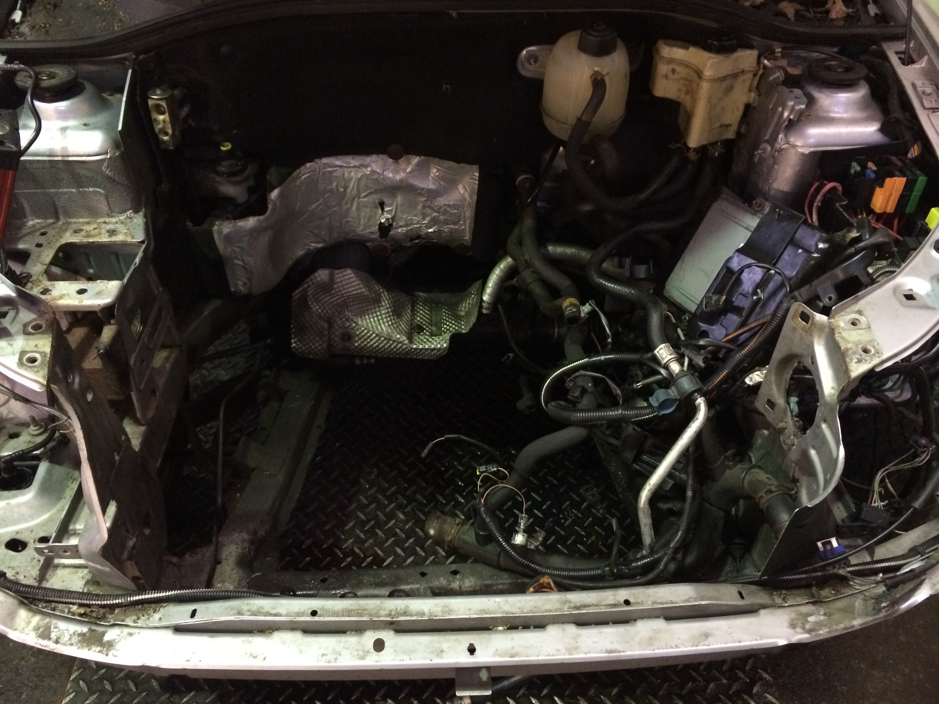

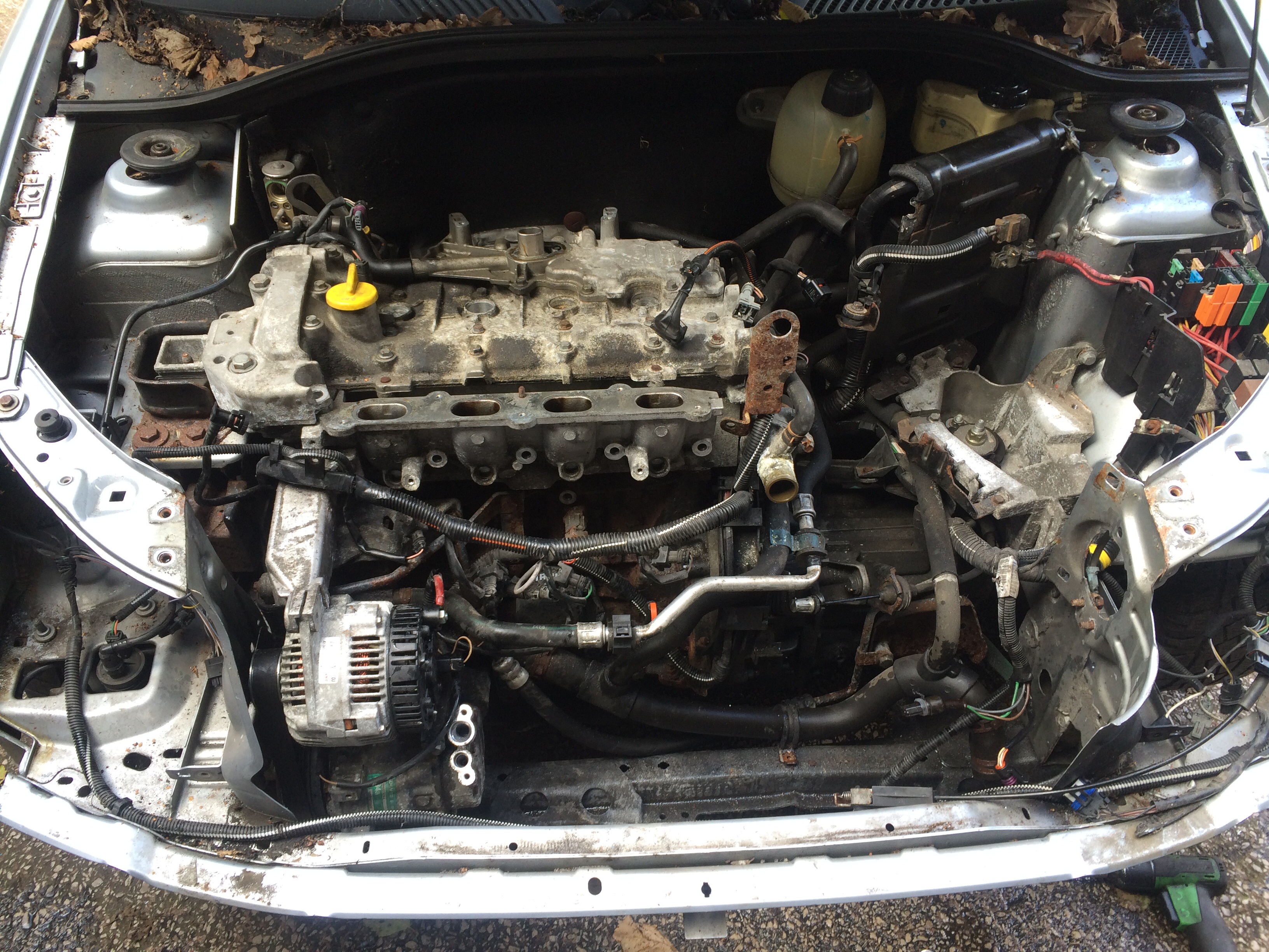

Update:

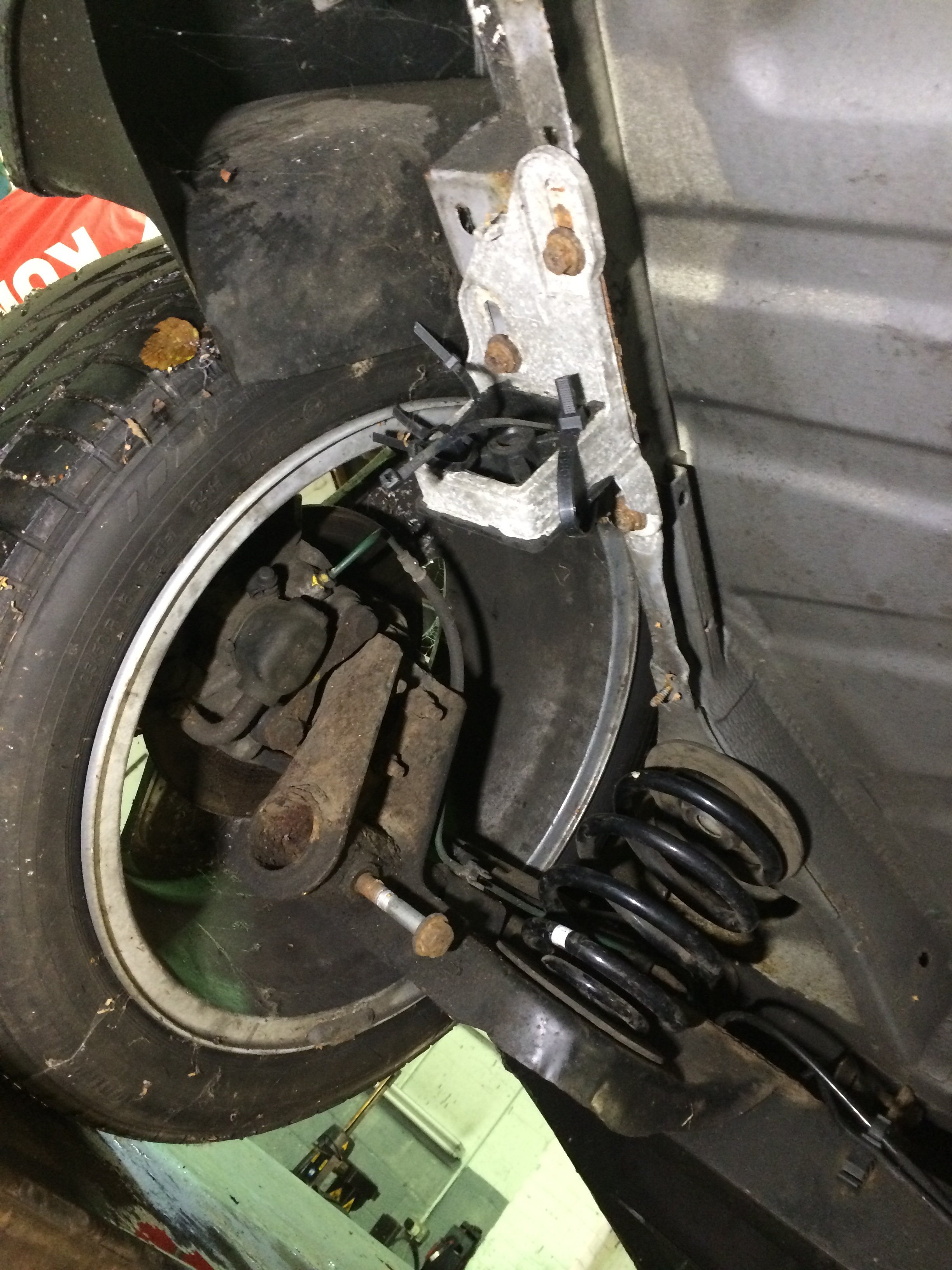

Only had an hour today to work on the car and so far it's plain sailing, who ever owned the car before decided to have there own quick release bumper..... 4 cable ties haha.
Next week my goal is to have the engine and inside all stripped out.
I'll post up spec later that I'm going for.

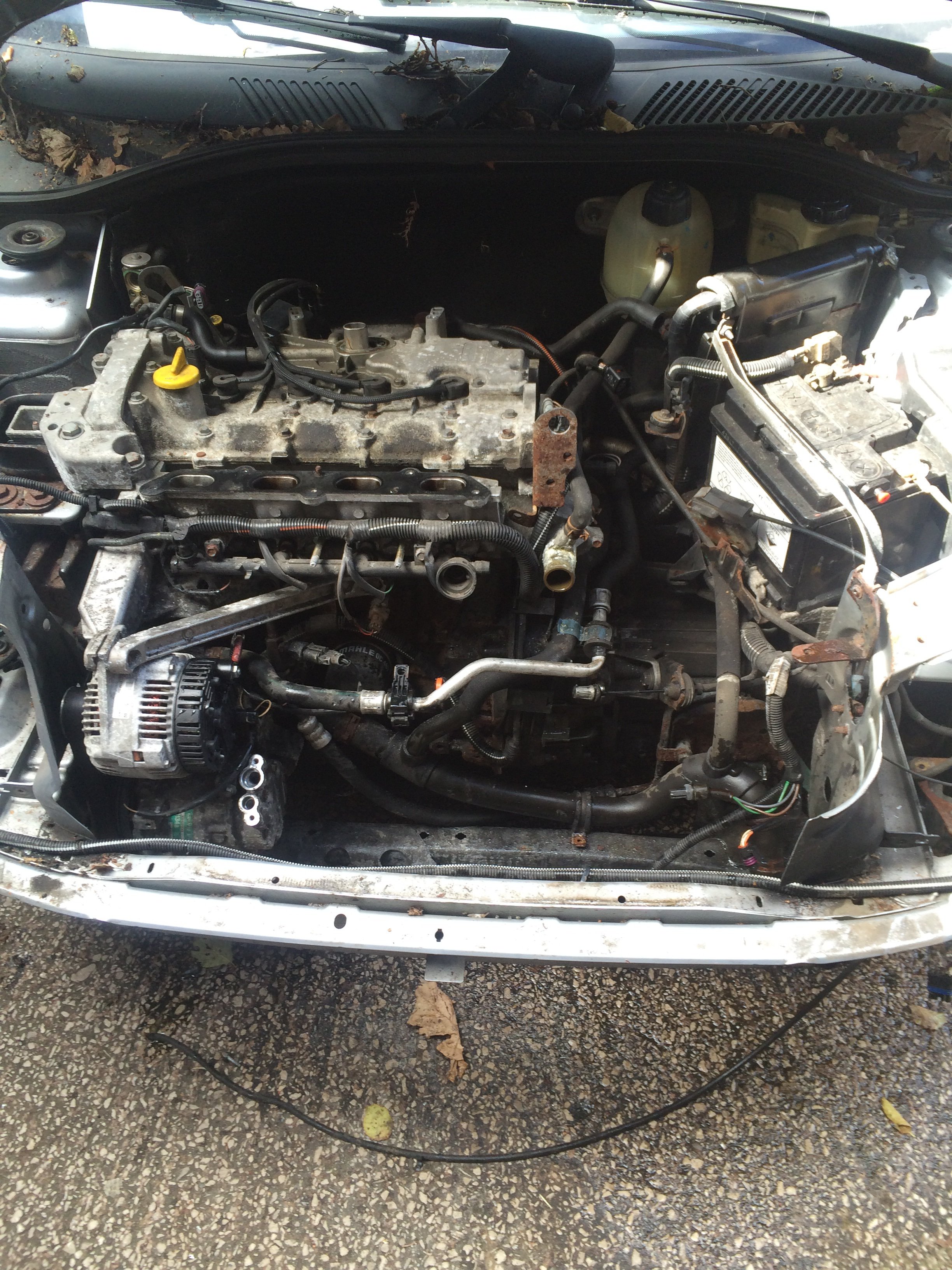

  focus RS/Clio 172

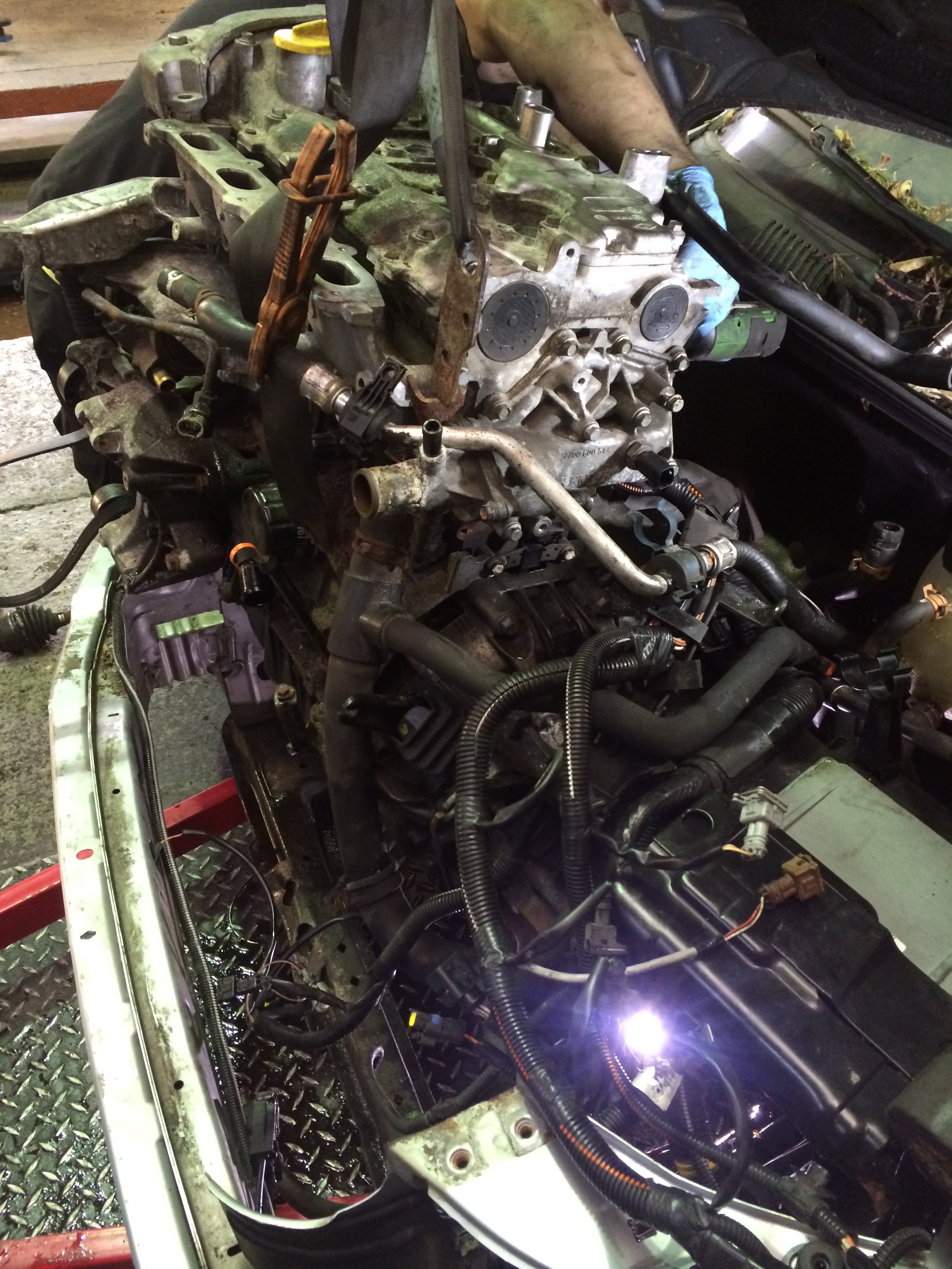

Quick update the engine and gear box has been removed today ready for it's over haul.
It'll be interesting once I strip the gearbox down to see what wear I have. It was starting to crunch into 3rd on the last few track days. Also well I'm there I need to decide on gearing for 5th gear and get my gripper diff ordered.

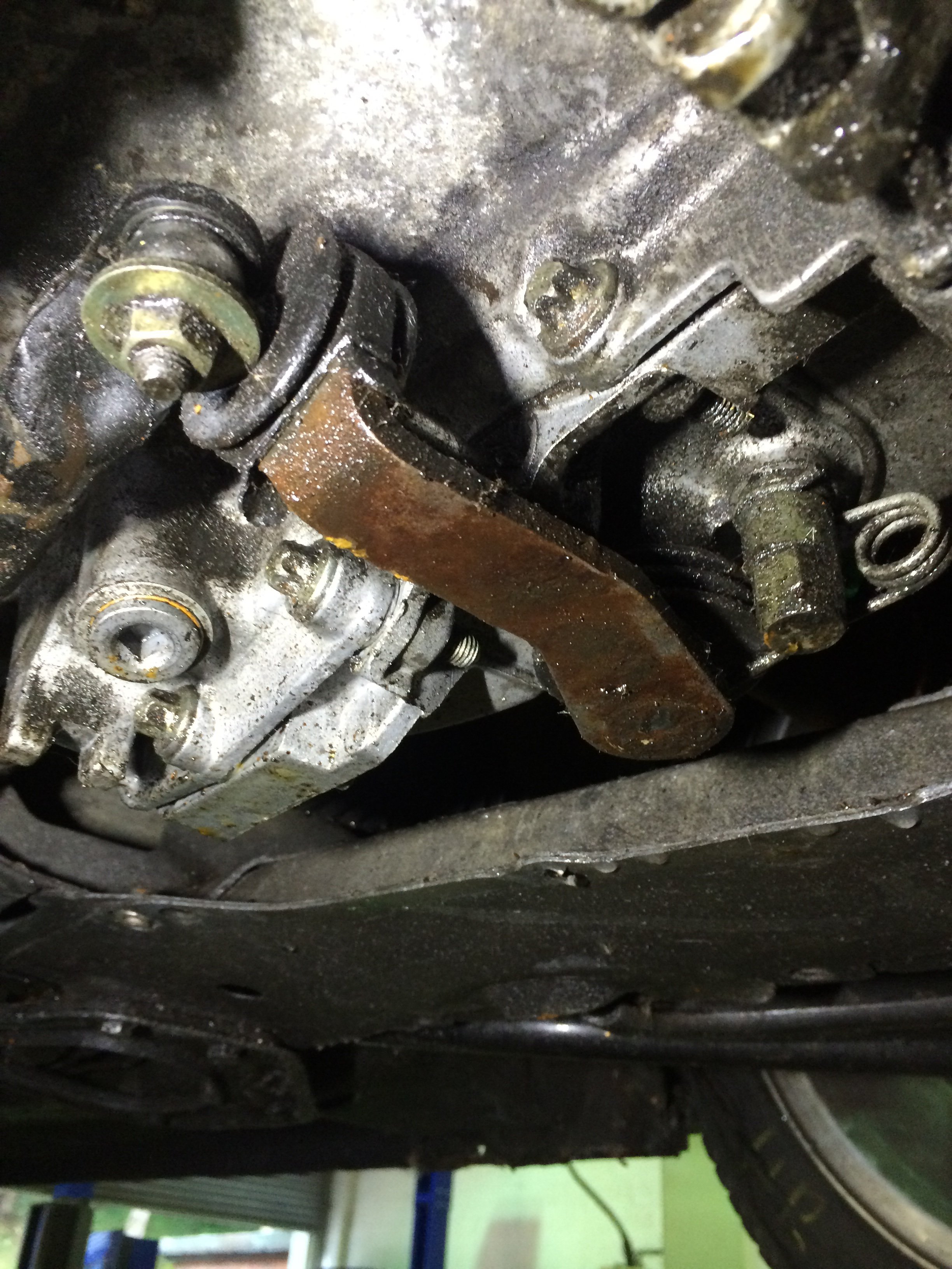

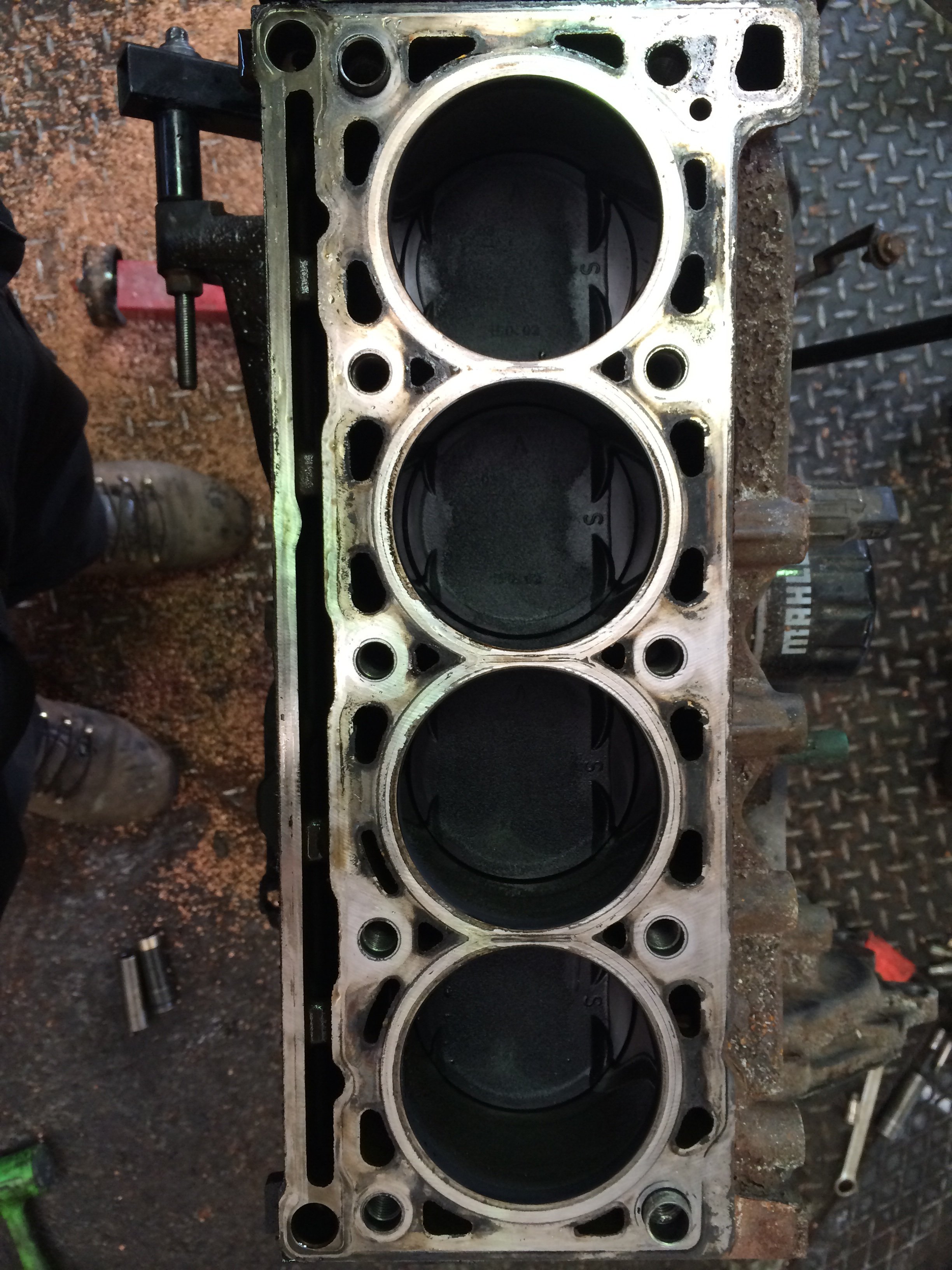

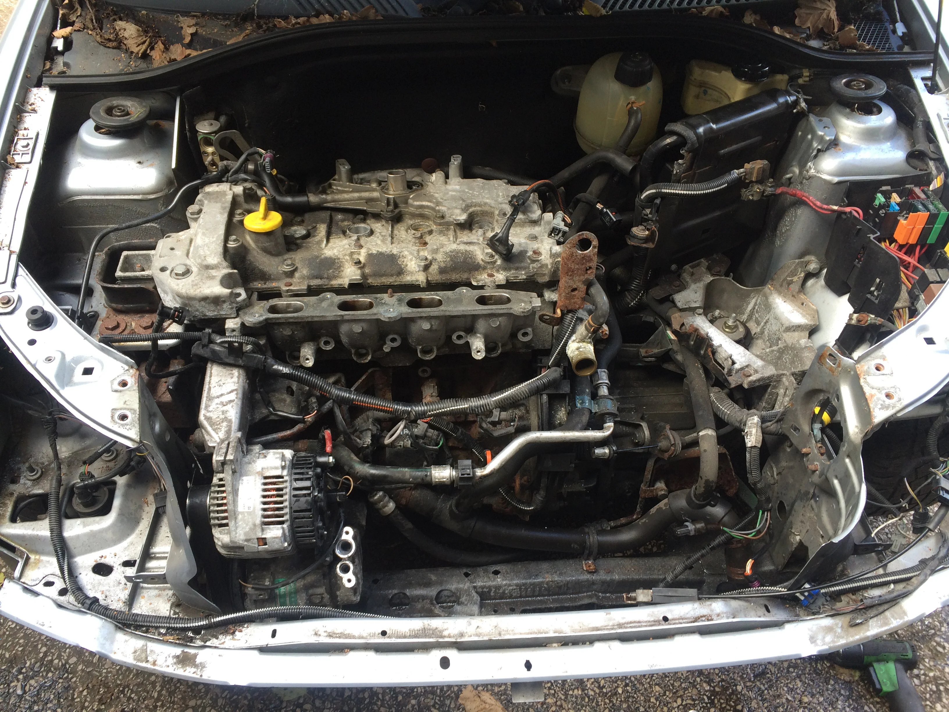

So today when I had a spare hour I managed to split engine and gear box and also strip down the top half of the engine.
One I removed the head I had a good look at the cylinder and can't get over how clean the bores are, I wiped my finger around them and not one bit of dirt or roughness!
Cleanest engine I've stripped down in a while.
Here what it looked like.
