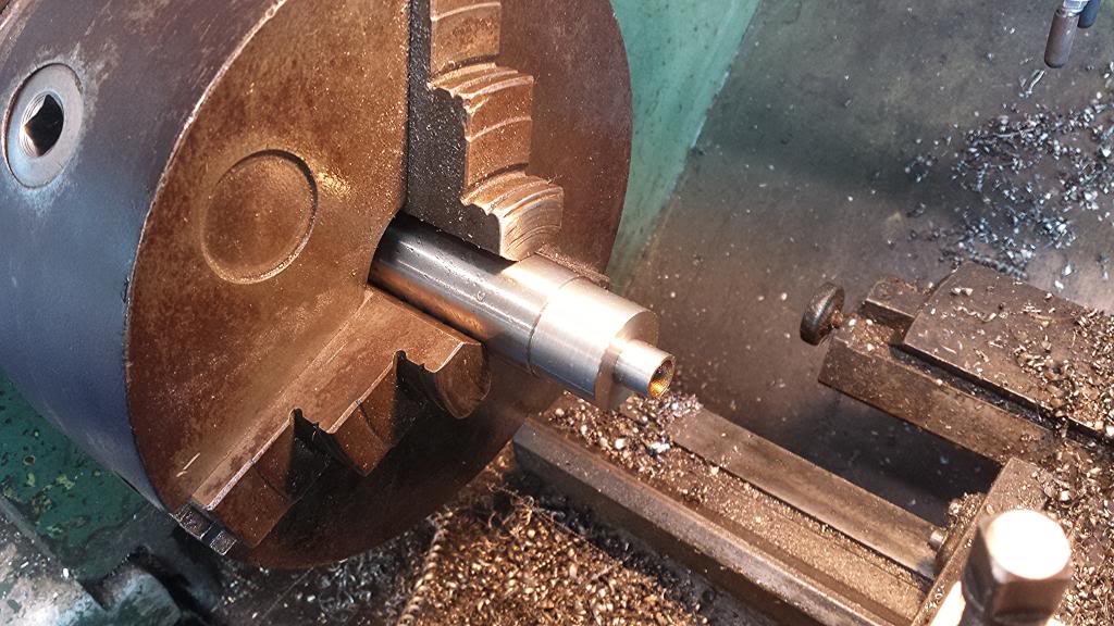

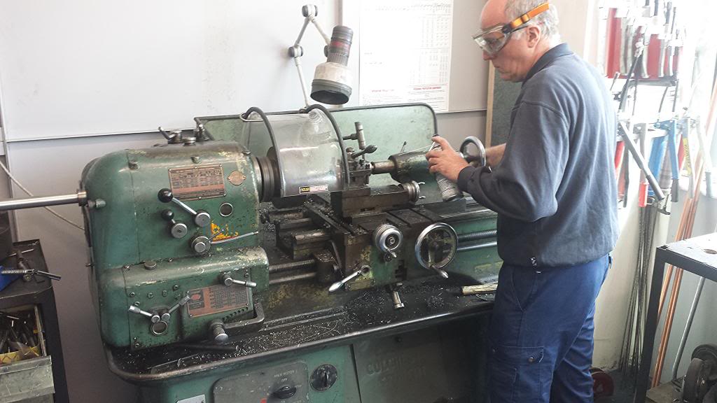

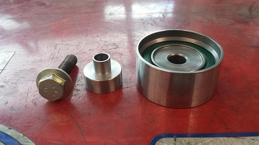

Right got the new steel pulley spacer made and fitted and the tensioner tensioned up in the correct poistion, thank fook.
Got my mate who i work with to make it for me while i did other stuff at work.
Top man he is.
Almost done.
All finished. :D
All fitted and the belt runs in the centre of the pulley.

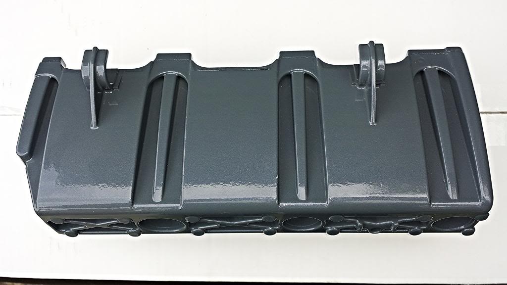

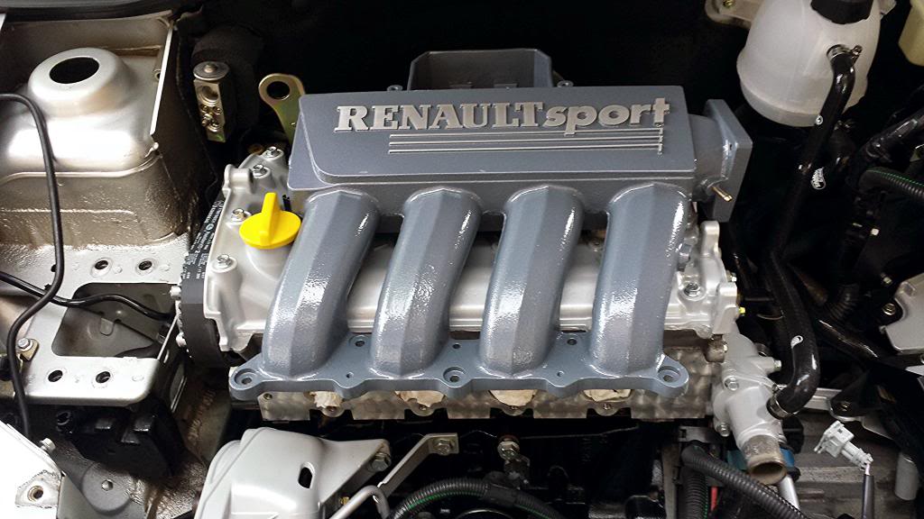

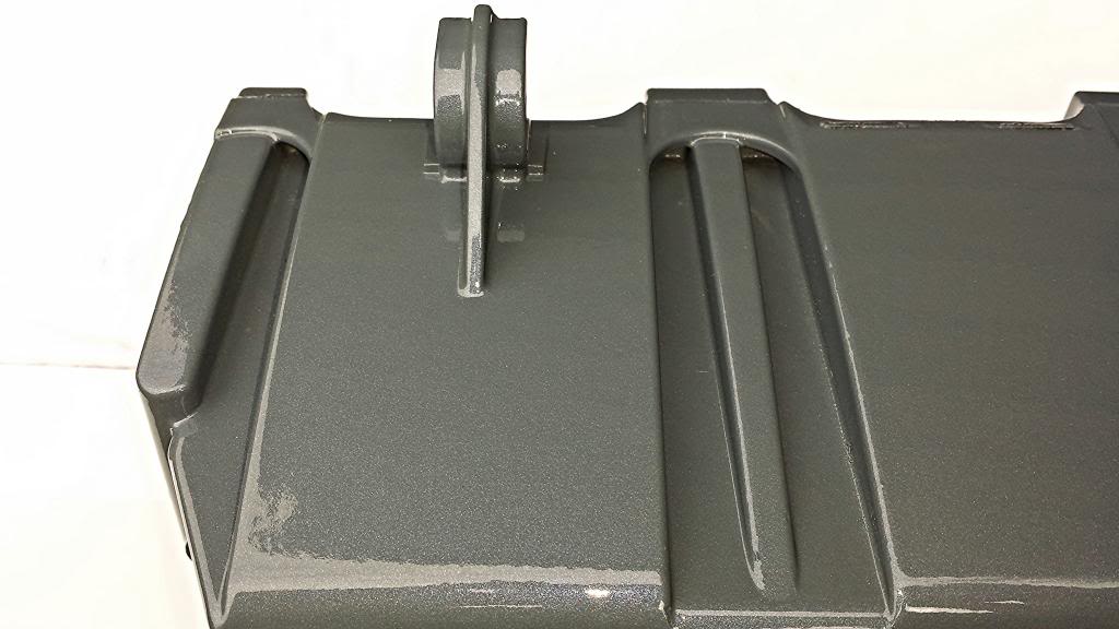

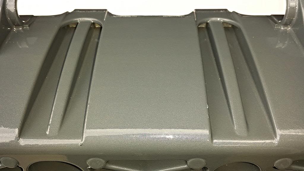

Id sent my inlets and the fuel rail protector away to HMS to be painted in Luner grey.
over the moon with his work, the finish is spot on. I ask for the letters to be polished which he has done a bloody good job of.

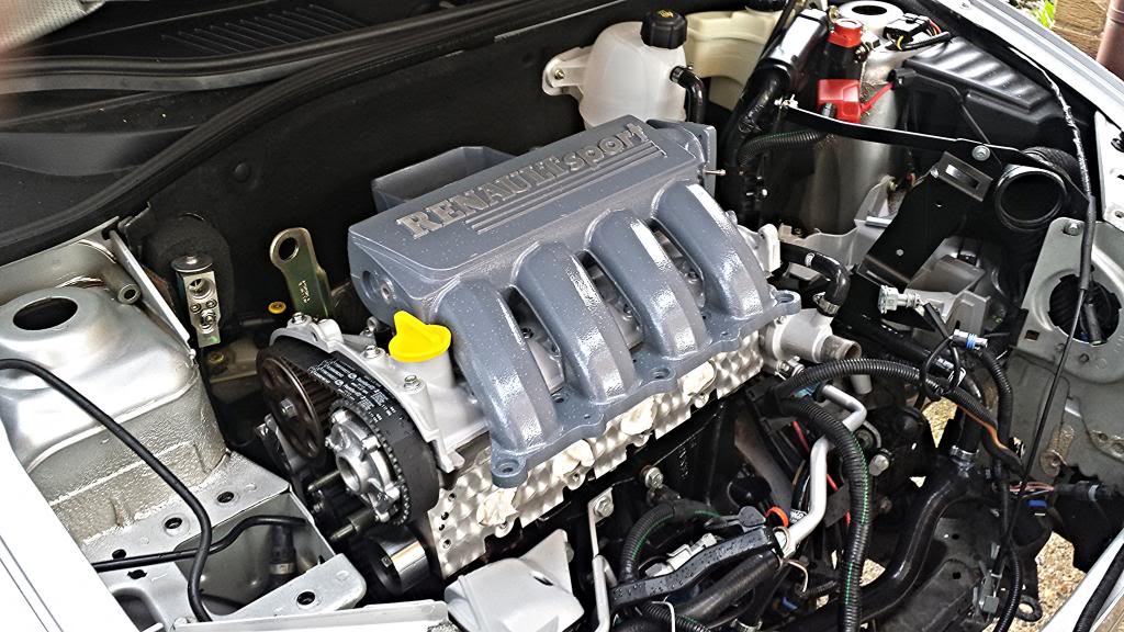

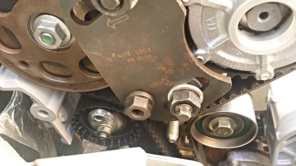

So today i got AlexW over to give me a hand in getting the cam timing spot on, after an hour of messing about its all done.
The horse shoe fits in with two fingers so im happy.

Looking good. Looks like Raz has done a good job on the inlets. Just can't believe the amount of work and attention to detail on this car.
I've also never understood the whole "goes in with no more effort than three fingers" thing is this pushing forward on it or down on it? I'm assuming its down as on mine I just had to rest my little finger on the back to slip it in (ooerrr).
Pushing it in, litrally slides in easy as. Often people mistime them and then force the horse-shoe in.
Thanks mate, yes Raz has done a great job. :approve:
You should be able to push the horse shoe stright in, if you have to push it down or up to aline it with the other slot then it means the timing is out.
It wasn't really pushing it down. It literally just needed a finger resting on it. Just had it RR'd at 166 anyway so I'm taking it that it's just play in the dephaser as you couldn't physically get it any closer.
Welshy- Not locking the belt side of the cams properly if your having to push the horse shoe in at an angle or forcefully.
( assuming this is happening after 3 hand cranks and then checking again )

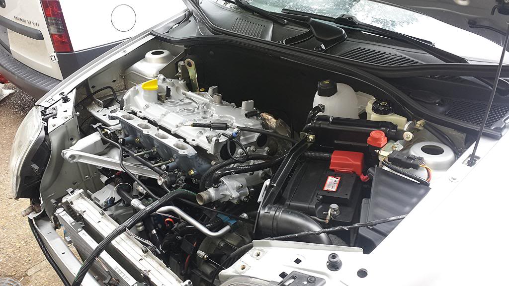

Managed to do a few little bits on the car today even though my back is still hurting, so close now to getting it running.
Also for the next 11 days im working as we have a big project going on at work so they need the day engineers in on OT, the money is nice but i could do with the time off to get the car running.
So i was going to fit the cambelt covers but after looking at the plastic one and seeing two cracks i decided to order a new one from Renault, just in case it was to break and take the cambelt out.
The aim today was to get the engine turning over on the key and to get oil pressure.

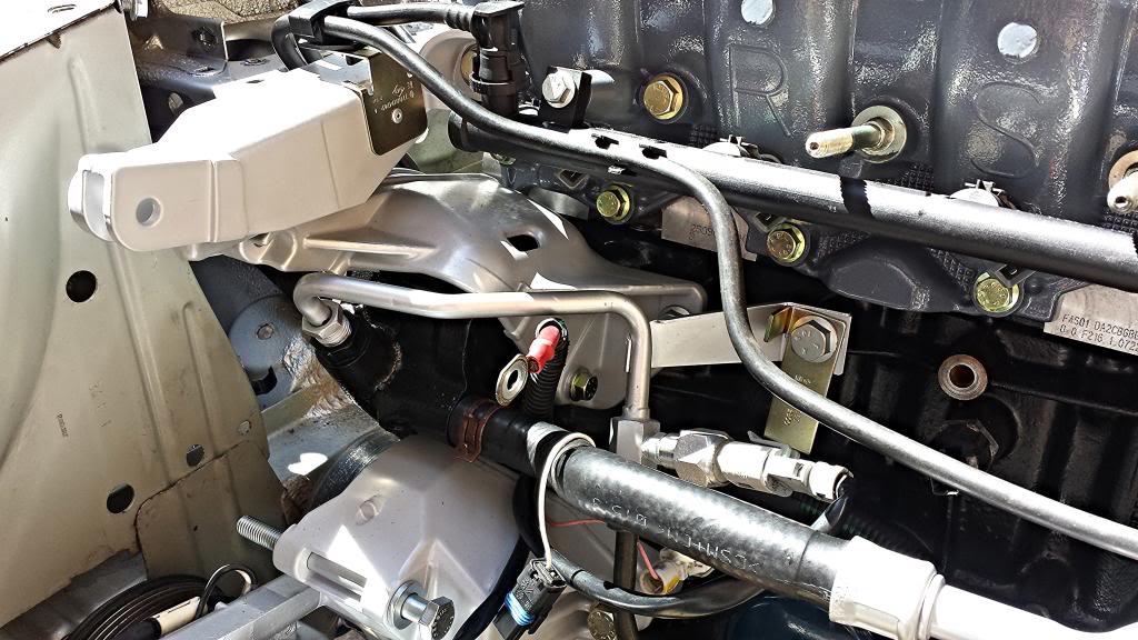

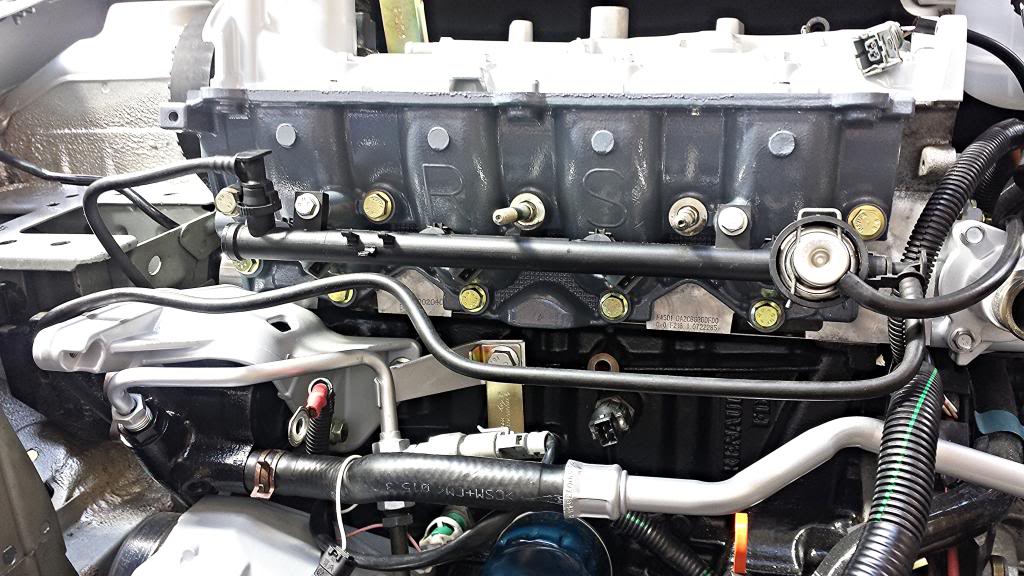

Lower inlet all fitted along with the fuel rail.
Fitted the battery after id charged it up at work, felt like id checked everything 100 times before i fitted the battery cables. :S
Cranked the engine over untill the oil light went out, nothing went bang or did it burst into flames so im happy. :D
Even put the code into the new HU and had a little play with it, very nice bit of kit but the standard Renault speakers let it down. Going to be replacing them and fitting some kind of boom box in the boot. :cool:
Cambelt cover should be with me on wendsday but its now going to be a case of trying to find some time. :(
How its looking at the end of today.

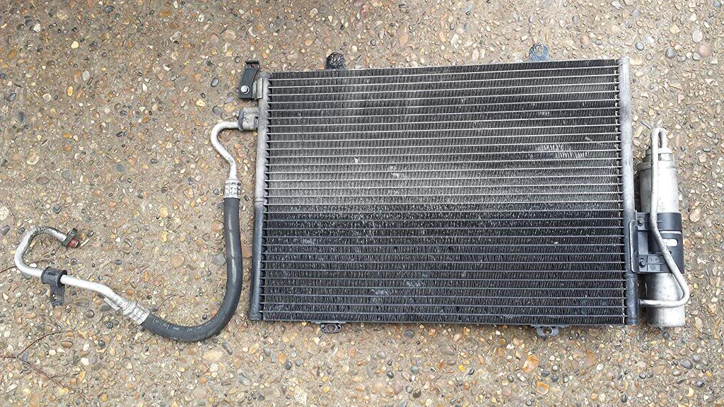

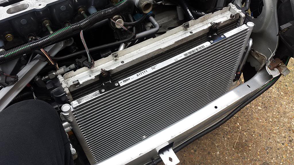

Oh i also had a problem with the AC, or so i thought. I had it re-gassed when i bought the car in 2010, after leaving the car un-used for about 6 months the AC didn't work.
Well it did but just wasn't cold.
Im going to be getting a guy out to re-gas it while the bumper etc is off so that if there is any problems/leaks then it can be sorted easily enough without needing to strip the car down again.
Ive bought all of the seals that i need from Renault and i also bought a new AC rad, just in case.
Shiny new. :cool:
You missed the laugh about that A/C rad.
Scott pulled the rads out of his van, and I said "Its lucky you can't see them when fitted, else you'd be replacing those".. Followed by Scott pulling a box out of his van, with a new A/C rad in it. I just stood stunned.
