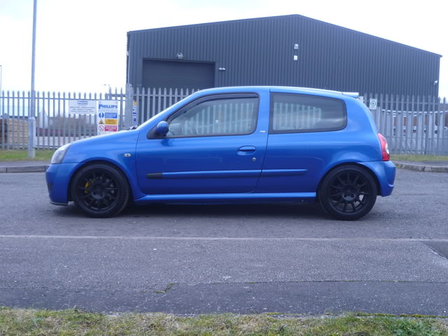

​Hi folks. Had chance to take a 172 Cup around Cadwell park earlier in the year. I had always driven Saxos before. Just wondered if anyone else in Clios have scrubbing when cornering hard. It was either the tyre scrubbing in the arch or the whole car bottoming out on the tarmac?
I had H and R coilovers set at this height on 16" Turinis with Michelins

What can be done to stop this? Harder coilovers? Any recomendations? 15" wheels? Anyone else have the same problem?

I would suggest its probably the fronts scrubbing on the bumper bracket (quite common on low sports).
Pop the front wheel off and look towards the front of the arch and you will probably see where the wheel has been catching.
If it is the bracket it can be easily solved with a hammer and pair of mole grips.
I had the same issue and its gone since I be t the brackets back.
