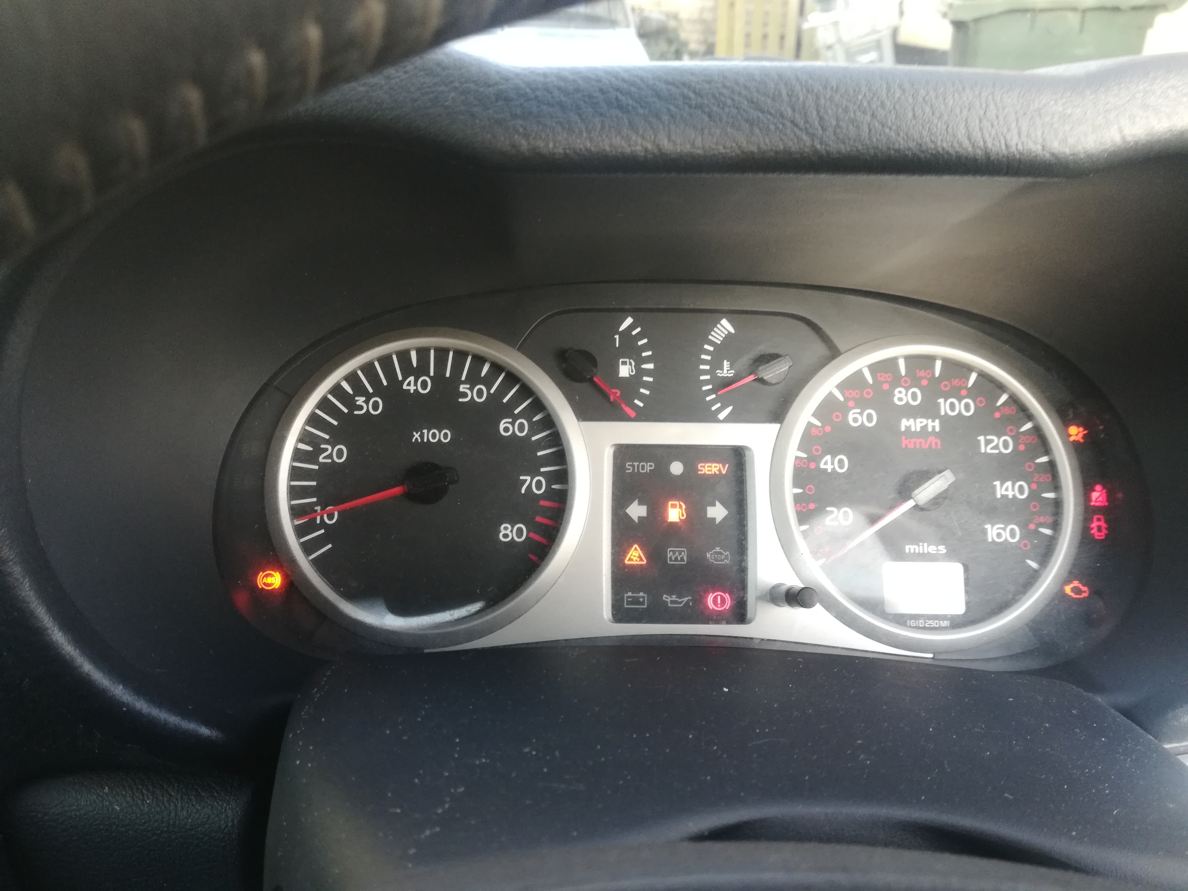

Hi chaps. I've been looking for a 182 for a few weeks now. I'm going to look at a low mileage example tomorrow. This particular one has some lights on the dashboard. But the owner assures me the car drives spot on and that the lights have only appeared after its been stood a while. Now normally this would be alarm bells to me and I would run a mile, but I know from previous French cars that electrics are not there strong point. What do you guys think? Anyone have any tips for me to look for or be aware of? The car is in immaculate condition from the photo's.

As for the one you're viewing whuch lights are on the dash? Eml? Abs? Srs? Not all are as easily extinguished come mot time.

Saw the car today it was a great example. A few tiny blemishes but nothing really. Dashboard lights was service light which is nothing. I made a fair offer but owner wouldn't budge. So I walked away and told him to let me know if he changed his mind. The search continues.

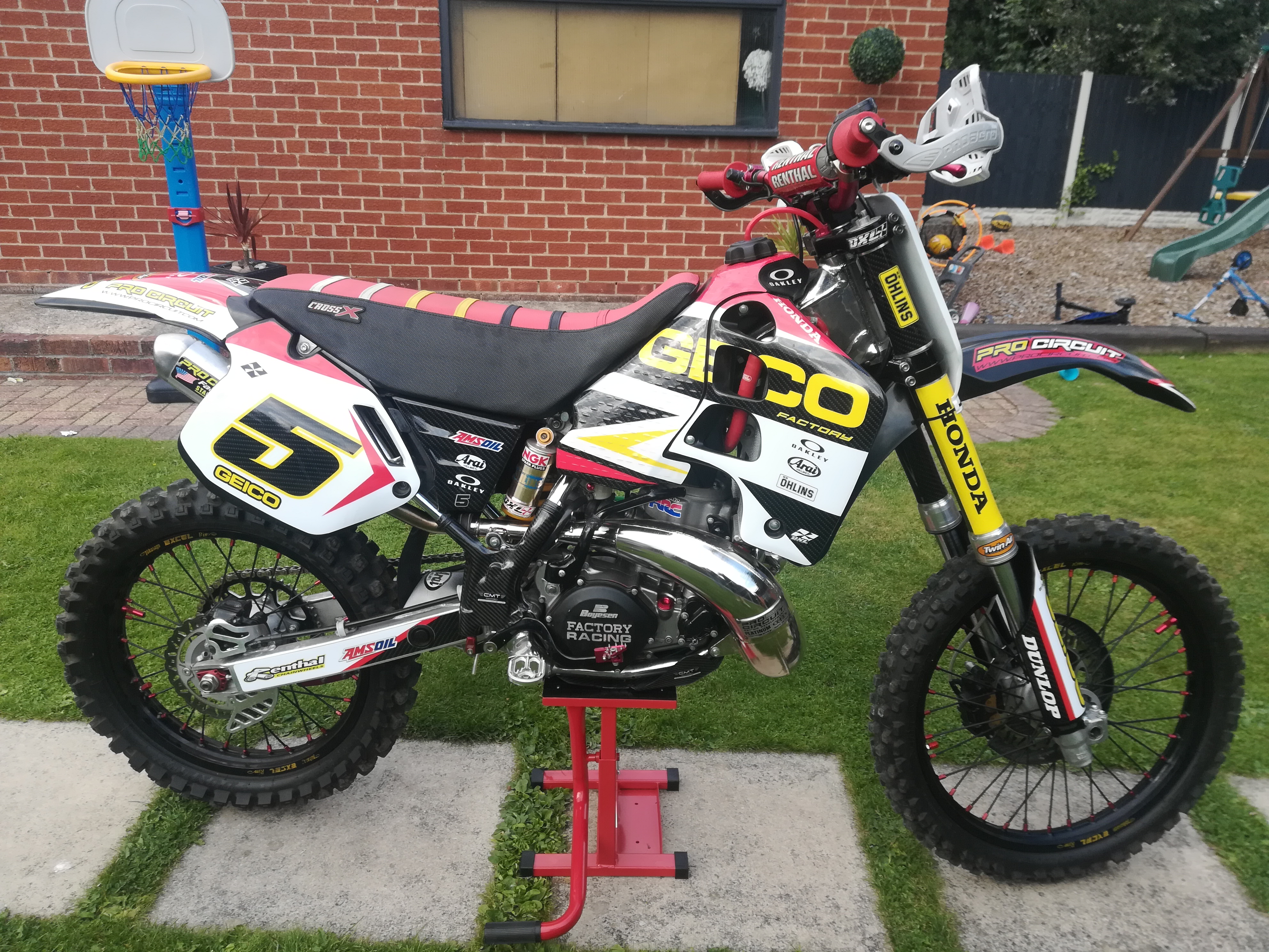

had to sell my pride and joy to fund the 182. Check out this absolute mental machine. I will miss it but it was only ever going to kill me. Honda Cr500 for those who aren't familiar with 2 wheels.

SERV light could be nothing but it could also be something....Not sure I'd buy a Clio for 6k with lights on the dash. Hopefully will be an inexpesive fix but you really need someone with CLIP to properly diagnose. Dont waste your time with a generic code reader or you will be chasing shadows.

I work just round corner from ddc so I will pop in after work today and see if they can have a look at it. I picked the car up yesterday. Not happy at all. The idle is all over place. Petrol and temp gauge not working. I think just about every single light on the dash came on. On the drive home. Temp went to the max although the car wasn't overheating. Definitely some electrical gremlins to find. I'm absolutely gutted, although the car drives spot on I can't help but feel I've been turned over. I will let you know what happens when I've had it looked at.

Well he can take it back and fix it then I guess. You paid super strong money for that car mate it needs to be right. Under the fuse/relay box in the engine bay is a big white electrical connector and is the cause of most of the electrical issues you hear of with clios. The plug need properly cleaning (all the points) with some contact cleaner or light sand paper. Then blowing out with an airline before dielectric grease applying and being refitted. I’ll bet it’s been jet washed under the bonnet then the car sat outside over winter and it’s a bloody mess. Alternatively the earth’s could be s**t, but he should’ve checked that.

Thanks for the tip I will check the connector when I finish work later.

car is booked in to dds for Monday. Here is a picture of the current lights on the dashboard. Also just discovered the heater fan doesn't work either. Had a good drive in it today. Have to say now it's got some coolant in, it drives bang on. The idle isn't great and definitely smells like it's running rich. Put optimax in but I run my bikes on it and realise there is a distingtive smell when using it but it's really strong.
