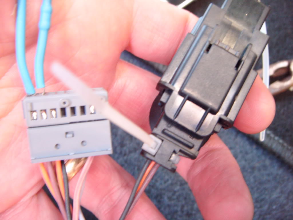

Did the same on the drivers side but doesnt seem to work. Do you need to do anything with the seat belts? I unplugged a couple of cables from them and thought this might be causing the light to stay on rather than the driver seat.
The fix with using the 3.3ohm resistor in the plug seemed to work on the passenger side but not on the drivers side. I followed Boosh's guide about where to use the resistors but there are some differences in mine.
http://www.cliosport.net/forum/showthread.php?507739-Guide-How-to-turn-off-Serv-amp-Airbag-light.

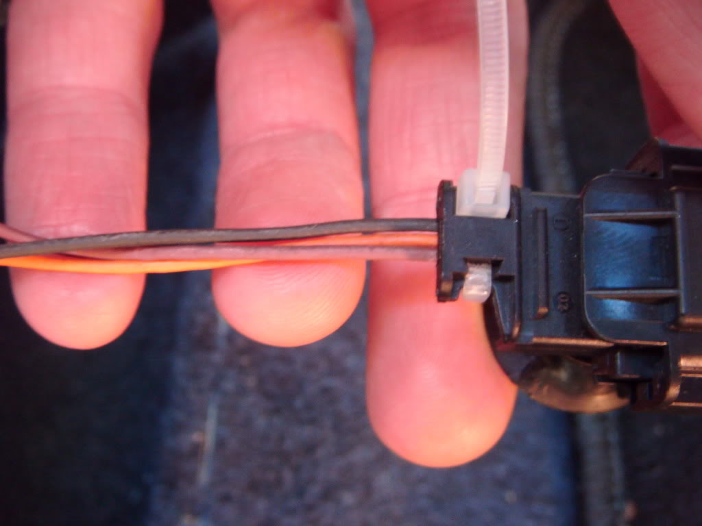

He mentions putting the resistor between the brown and the cream wire but on the black plug on mine I only have a black, an orange and a brown.

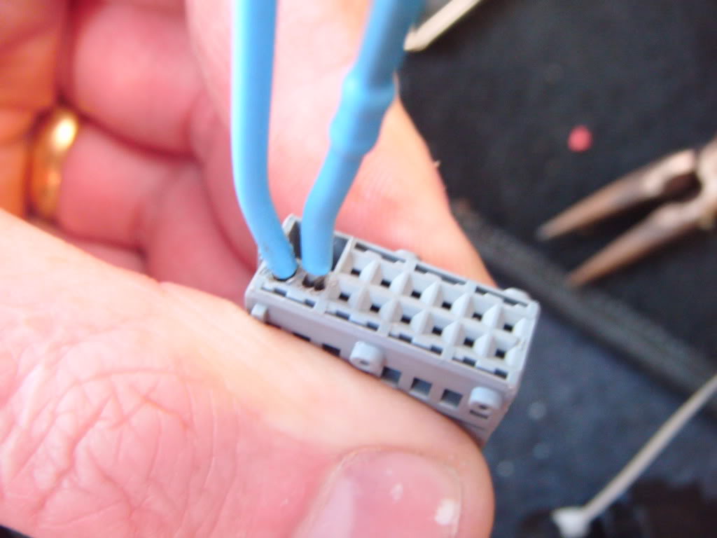

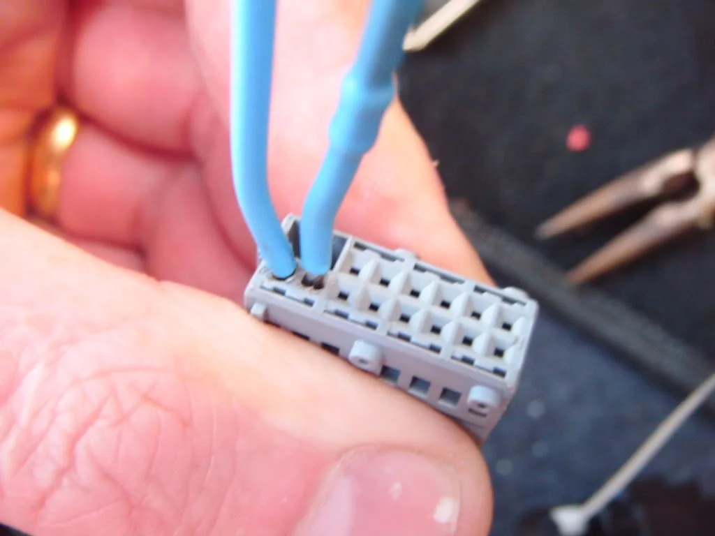

I have fitted the other resistor as shown:
Am I doing something stupid but the airbag light is still on? This worked on the passenger side.
