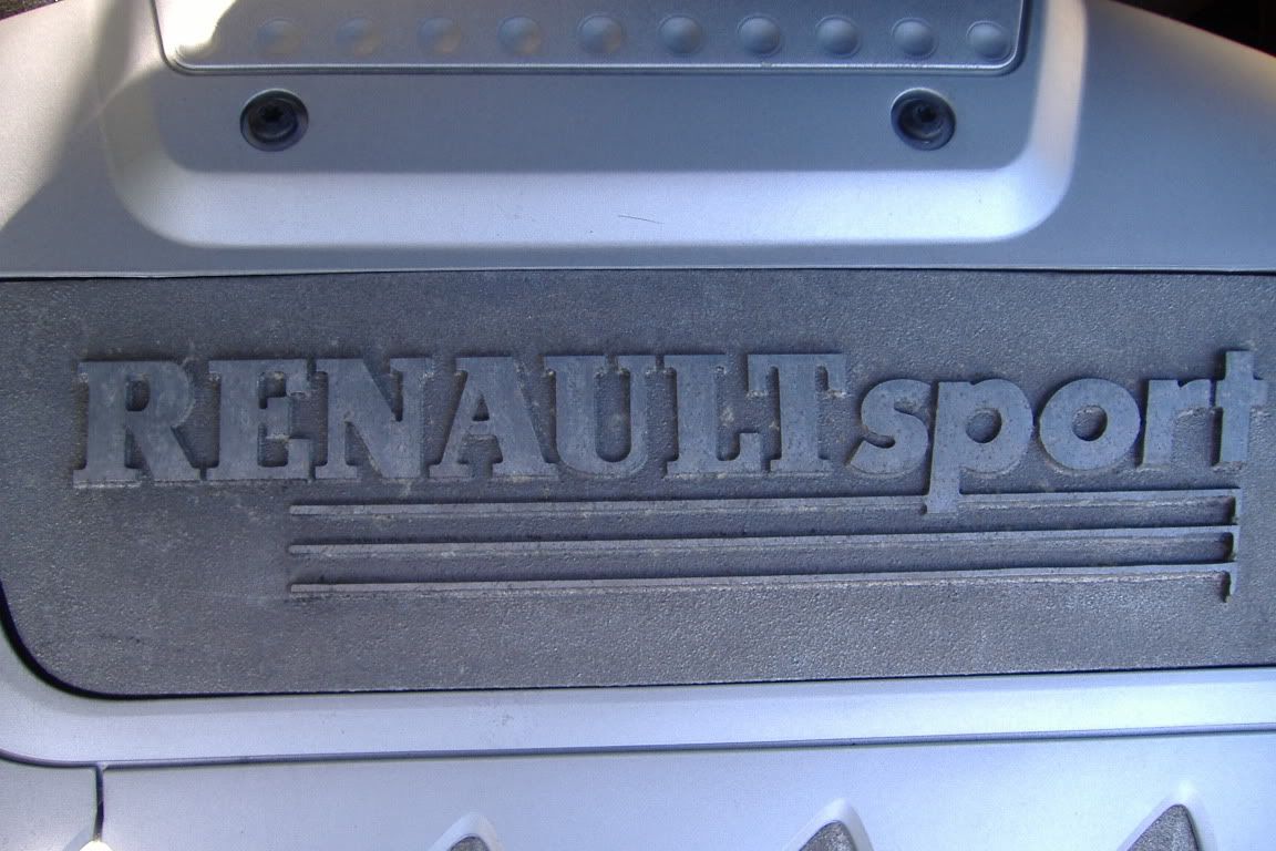

I am wanting to polish up the RS bit on the top of my 172 engine. I can get hold of hold of a dremil to aid with the work. but i would need the polishing bits for it
Just wanted to know what cutting agents are recommended to polish it up nice and shiny
Any advice on best method to do it would be much appriciatred

lots of grades of wet and dry matey!
use a bit of aluminium oxide paper to start with to get rid of the crap then work through the wet and dry grades: 120,200,400,600,800,1200,1500,2000!
then finish off with some autosol metal polish and or megs teck metal polish :D
*be careful not to press too hard with the dremel cos you dont want to create more work by making bigger and deeper scratches as the inlet plenham is very soft

wont be using the dremel to go through the grades. just use it with the buffer pad with autosol to bring it out. Will ave a go this week end see how i get on.

dont think you held back on the pressure judging by the amount of broken ends in my dremel kit ;)
I did mine last weekend, had not fingers left so it isnt finished
Looks ok though
Used a set of alumium oxide and wet and dry paper i got from halfraud - was £4.99
Ive made a start on it today. ive gone down to 800 grade so far. need to get sum 1200 and 1500 2000 to finish the job off. but saying that its still quite good down to 800 put a bit of auto glym metal polish to clean it up a bit looking good. will be awsome once ive done the finner grades.
my fingers are ok, its just an achey arm at the mo. i used a small bit od scrap wood lying around the shed as a mini sanding block. worked a treat
I know u guys said it was soft but didnt realise how soft it was makes the results come up much quicker. Bonus
Gonna try finnish it off tomorrow. try and post some pics also. of the results. got some before 1s alredy. and will get after ones up if i can

Dont need to use sandpaper. Get a linishing kit. 3 fabric wheels and 3 compounds are what i have. 80,120,240 grit. Then a grey compound with hard mop and white compound with the soft one, for the final two polishing stages, brings up to a mirror finish. All done with a drill, but I think its knackered now.

does this make much of a mess when sanding the metal? Just wondering as i might have to try polishing up the renaultSport bit on the engine but don't wanna go getting metal particles all over the place.
Its not too bad. I just used a cloth the mop it up as your going allong and an old toothbrush to brush the bits between the lettering. that seemed to work for me

Yea it does
It took me about 5 hrs to do all together. did 3 hrs on the fri afternoon and 2 on the sat. was ok tho got a bit bored at the end. but glad i did it. looks good and hardly costs you anything. only materials to do it.
