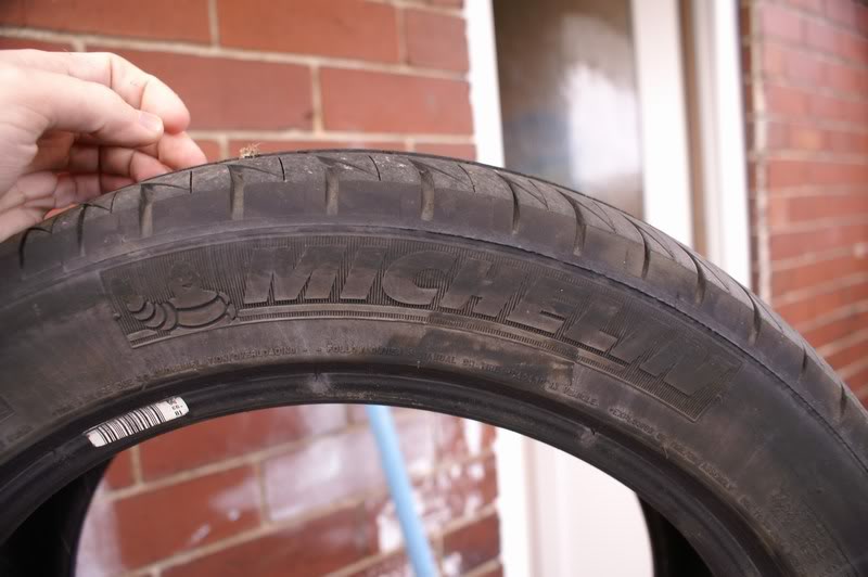

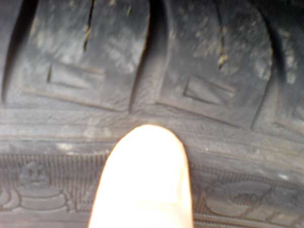

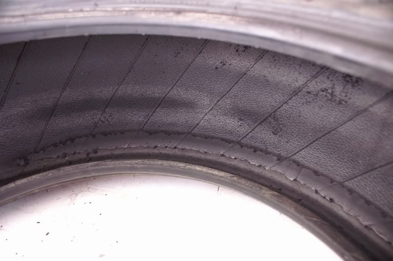

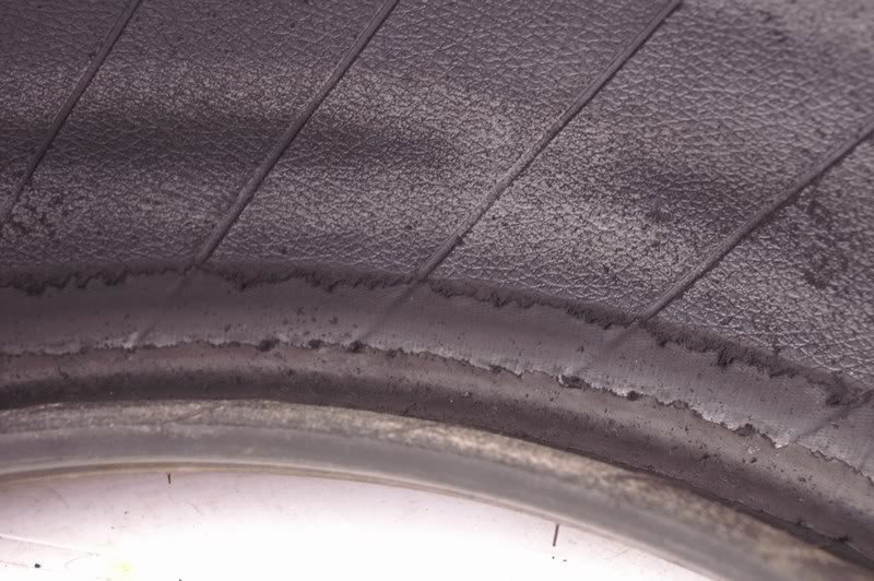

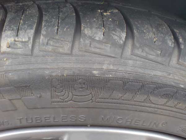

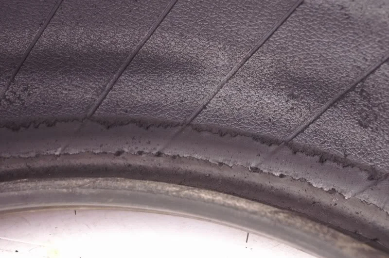

The tread is still pretty deep. They have done 60,000 miles (80% motorway). You can see on the photos attached, that little cracks are appearing on the rim of the wheels as the tyres keep going down, I have to pump them up once a week, sometimes twice.

Over time the tyres go hard and crack, to be honest i would just bin them. Dont you find the back end goes light alot with these tyres on rear and having new tyres on front all the time?

what is the dark line along the side of the tyres?
have you been driving on them whilst they wer under the correct pressure?
Yes, they both have slow punctures. I'm going to have to invest in a new set I think. The front tyres are new they are fine.
bet you the punctures will be repaired and sold on as part worn...
youve prob got a nail in them somewhere, i'd try and keep them as spares personally..emergency ones

the rubber will go hard over time, so they will become brittle and crack and one day go pop while you are driving.....

Looking at the scrub on the outside of the tyre the inside may well be in a similar condition.
