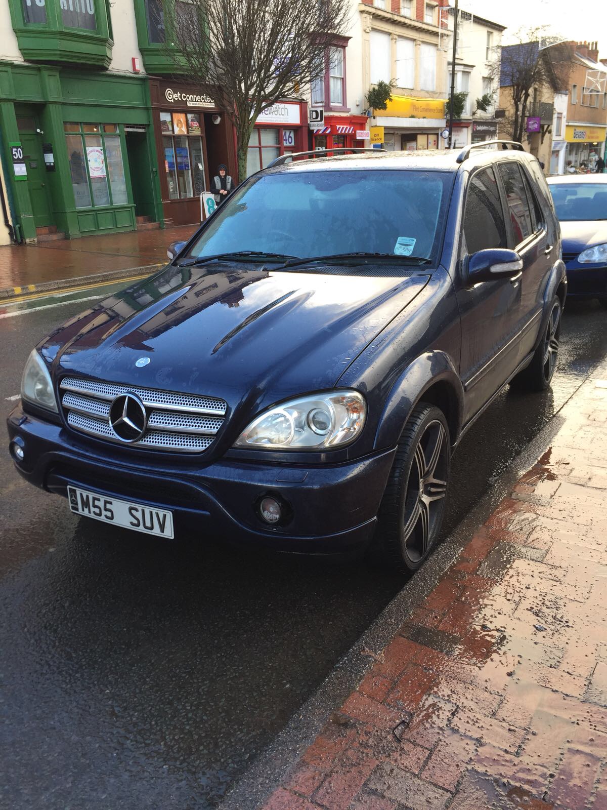

I will now have ml55 after Christmas to tow with :P

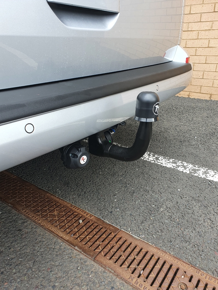

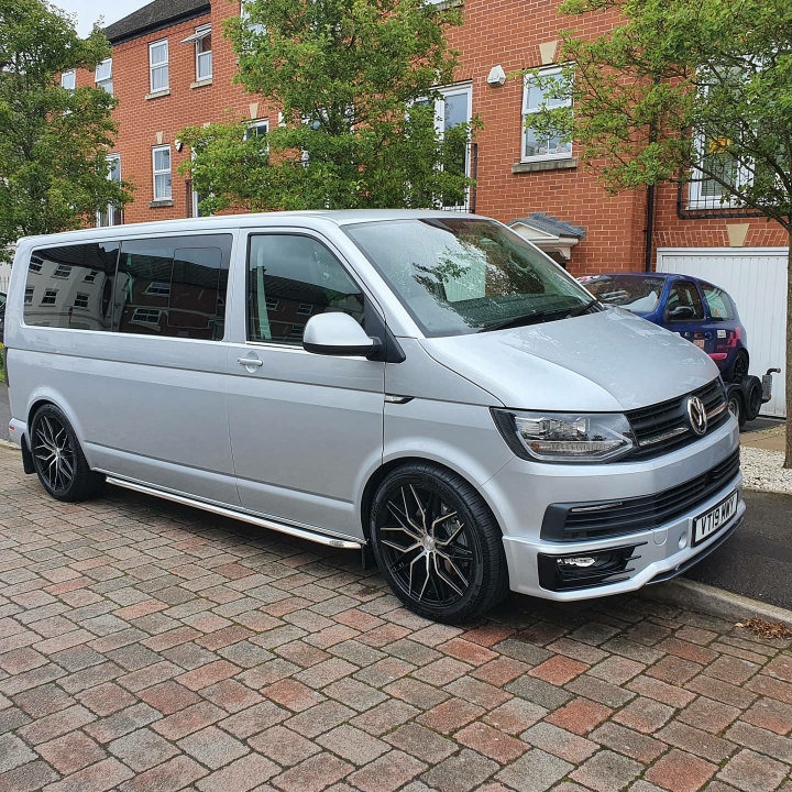

I was using my Q7 but swapping to my T6 Transporter now that I've finally, after 2 months, waiting to get a towbar fitted.
