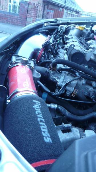

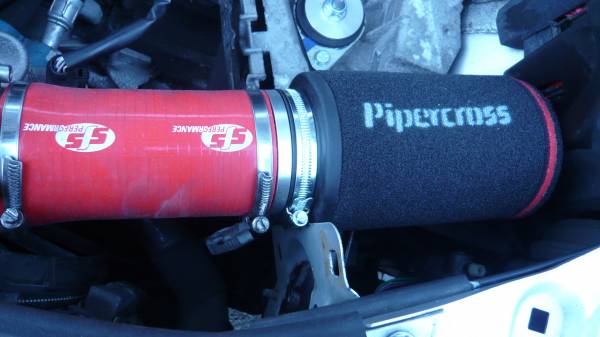

I also put a V6 air filter on and removed the original CAF and put in my own one in. Whilst I was at it, I thought I’ve lost all this weight in the back, why not put the battery in the boot as it will always have to be in the car. So me and my dad sorted that out.
I then purchased a Scorpion exhaust, fitted it myself, I’m a geek not a mechanic, and it took me 3 days lol. Yes half way through it I did wish I had just paid someone to do it ;) But got it fitted in the end and was happy with the instant better throttle response.

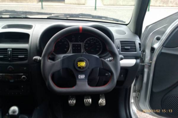

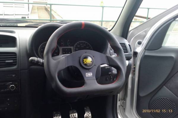

I must say I do wish I didn’t choose that style of steering wheel. Don’t get me wrong, great fun to drive with a wheel like that, but sometimes when using the car for general use, it’s a bit weird having this flat bottom when parking/tight corners. But I’m starting to live with it, and the GF likes it also.

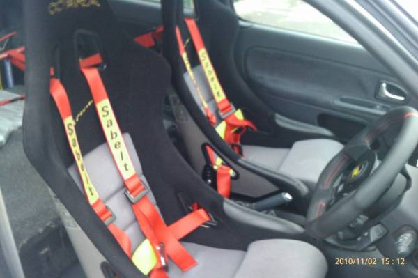

Here are some shots of the seats:

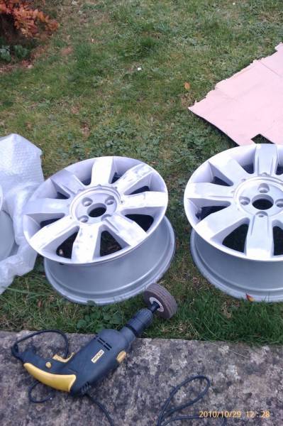

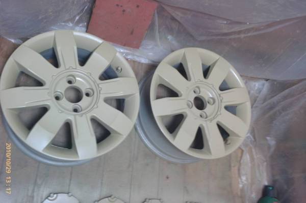

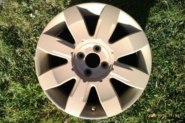

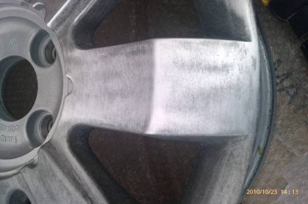

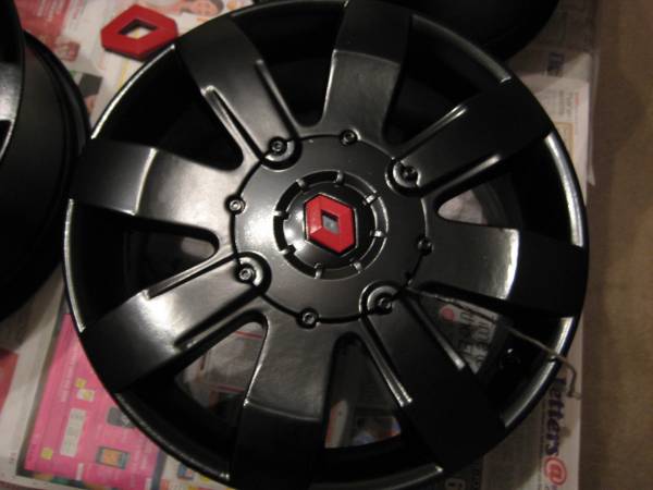

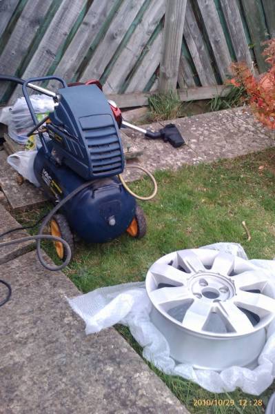

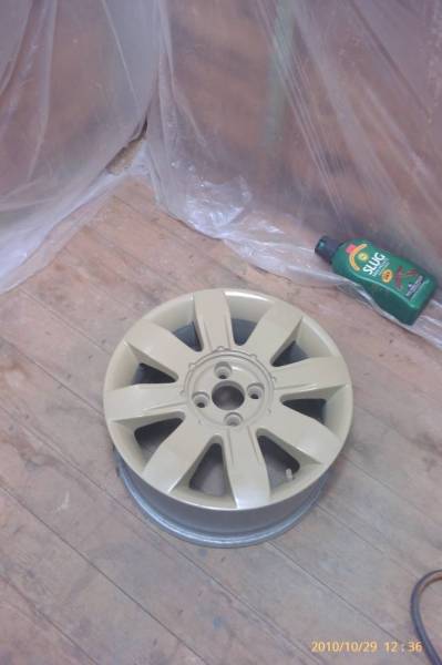

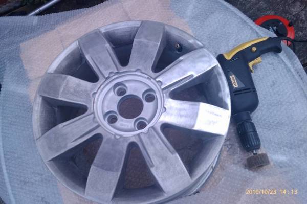

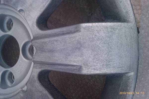

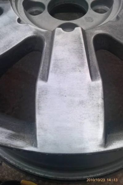

It was time to start getting the original 182 alloys sprayed. I first off spent hours and hours and days and days stripping the paint off just ONE alloy. I already thought to myself why am I doing this. In fact it was so hard to take all the paint off I nearly gave up. But Jades (gf) dad saved the day, he took all 4 alloys into work and had the paint blasted off. I remember him saying something like, the wheels have spent 4 hours in like a dishwasher. When the wheels came back I was stunned how much paint had been removed I’d say 90% off all wheels. Wish I had taken a photo now.
I still had to prep the wheels for spraying and Jades dad gave me these brush type heads to put on a drill, to remove the last bits of paint that wouldn’t come off. I did try and go down the polish route at this stage, and lacquer after. But it was just too much effort, and I went back to the original idea of spraying the wheels.
The above pic, the alloy looks scratched, but that was just the sanding, the alloy to touch was smoooooth as a babies bum!
Now even smoother!
So I was close to finishing off getting the wheels ready, and thought it was time to sort my (what will be) spray booth. Got the hoover out and started hoovering the inside of the shed. I wanted as much dust removed as possible. I then, with help from my mate Rich, put up this thin plastic sheeting. The spray booth was ready.

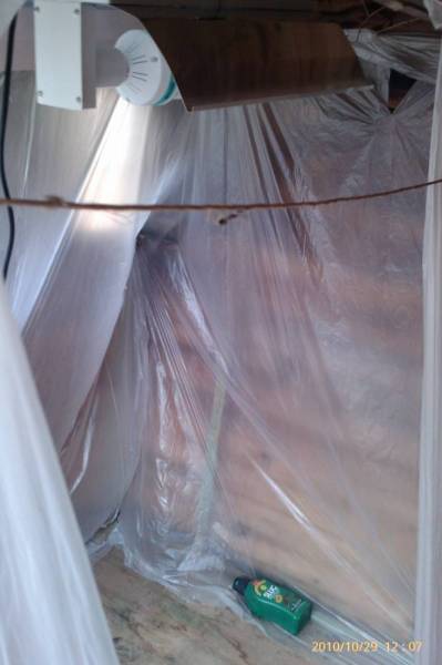

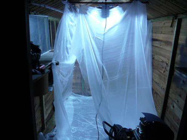

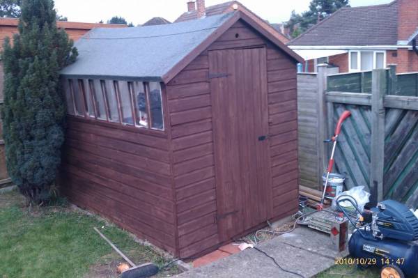

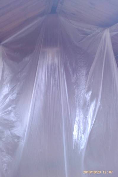

So whilst I was sanding/brushing/cleaning the wheels outside ready, Rich started with the primer on the one wheel which was ready. By the time he had done a few coats and rested the next wheel was ready.
The below pic is Rich after doing the first coat of primer, as you can see from the outside pic of the shed, there isn’t much ventilation!!!
Said he felt a little dizzy!

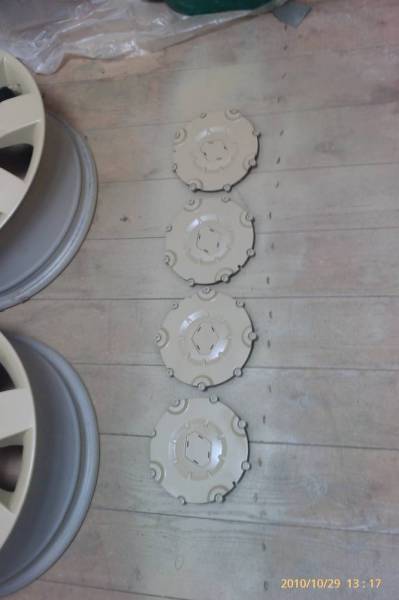

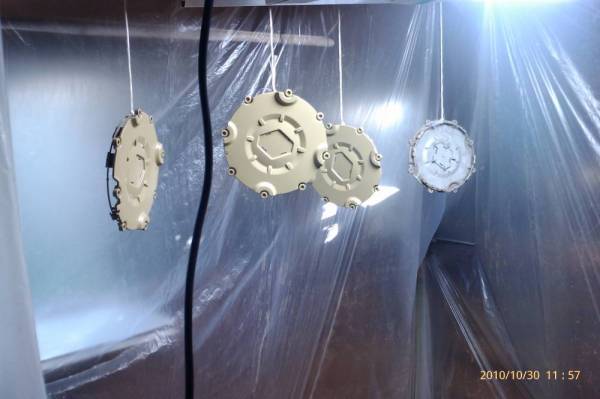

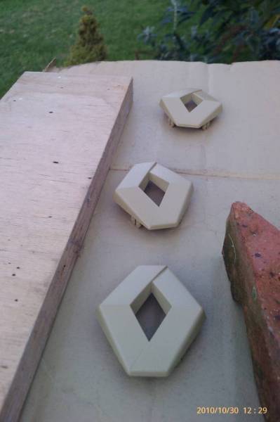

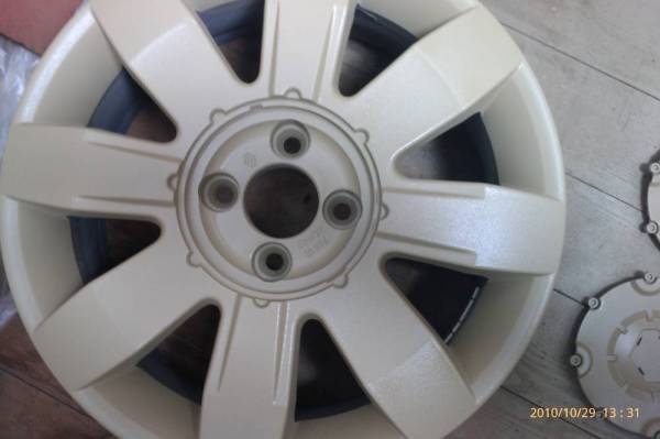

Rich finished the first coat of primer on the wheels then went to primer the wheel caps (if that’s the name for them):

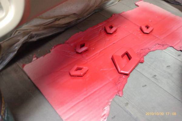

Then he did the diamonds and the front Diamond I bought off a member on CS. I was going to do these red to add subtle touches to the red theme I have going on (only inside the car atm). I then grabbed the cup spoiler who I bought off Clart on CS, and sanded down a few notches and cleaned it ready for primer.

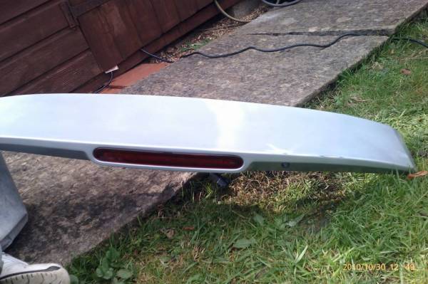

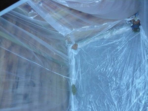

It was my turn, so I kitted up and went in the booth and sprayed primer on the spoiler.
That was it for day 1, was a good laff must say, and mucho thanks to my mate Rich, without him I’d probably be nowhere near this stage.

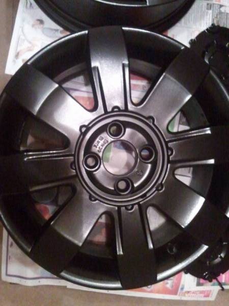

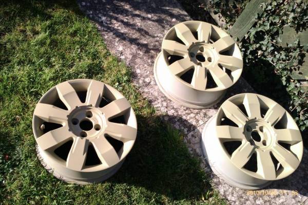

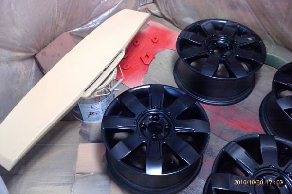

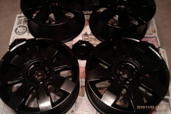

We left the primer parts for a few days to dry, and then we started spraying the wheels again. I had originally, in the paint shop where I got all my bits from, chosen this glitter silver. But first of all you have to spray black as an undercoat. So got the black tin and the thinners out, and rich mixed up the black:
Then we took it in turns spraying the black, but Rich did do most of the first few coats of black.
Once they started to dry, I was really liking the alloys in black. I tried to search on CS for a 182 with original alloys in black, on a silver car. But had no joy, so once they were dry, we took one of the wheels and put it up again the car to see what they would look like. We both thought black looked ace!
I bet you lot think ARCH GAP!

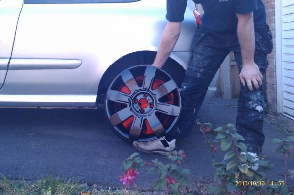

That was it for another day, left the wheels to dry. Then after 2 days in the morning before work, I gave the wheels another coat of black. As I was starting to think I may keep them black and not use the silver glitter with binder as the final finish. I was concerned the wheels might end up looking like an old tatty disco ball.
Here are some pictures of the diamonds I had sprayed red. I was very pleased with the finish, and they are just waiting to be lacquered now.
*They look a little on the pink side, but they look deep red in real life
At the moment the wheels are drying in the living room. As its getting chilly at night, I don’t think the paint is drying very well.
I was very impatient and just wanted to get them lacquered and finished, but Rich and Jade both persuaded me not to rush it, and sand down the odd bit of dust that landed on the paint and do another coat. In the end I can imagine me thanking them. I wanted them finished because of what’s happening on Friday 5th of November.

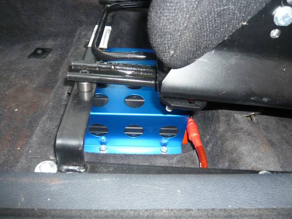

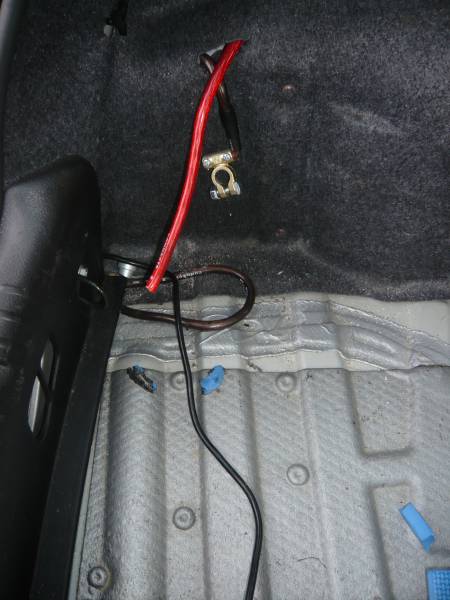

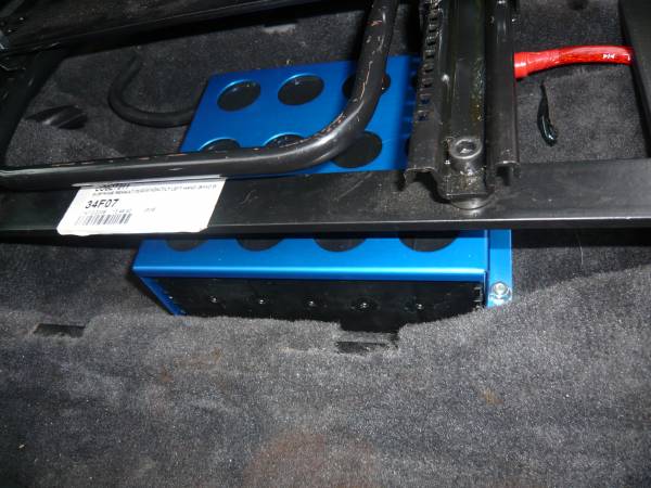

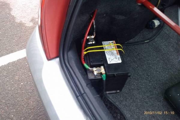

Please sort that battery out !!!
~15kg of lead will make a mighty mess of the back of your head when you crash.
Some homework for you: http://en.wikipedia.org/wiki/Inertia

Thanks for the link TheEvilGiraffe! I must say, i hadn't thought about what would happen if the ties snapped in a crash and the battery went flying! Mess is a good way of putting it!
I'll do a search on here and see how others have secured it. I imagine some kind of box which the battery can sit inside, with the cables coming in from the top, and the box bolted to the floor of the car. Either way the battery some how needs to be bolted to the car. Not with cable ties.......

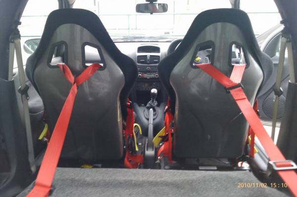

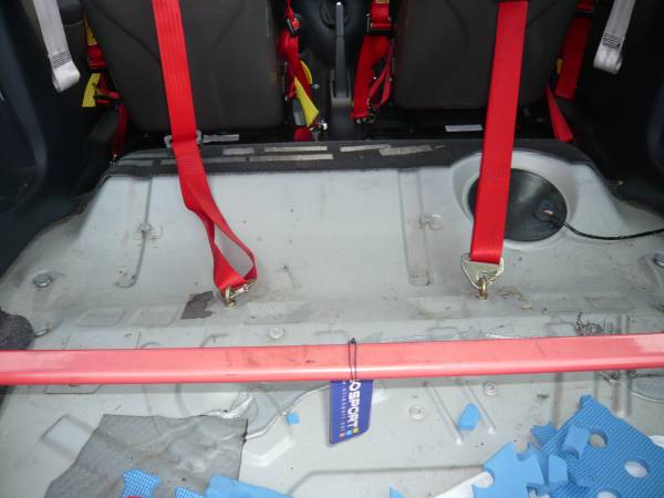

Although you have your harnesses mounted to a rear strut brace?! If you crash, one adult human creates something like 7 tonnes of force on a seatbelt. And you have secured that with a rear strut brace with two 13mm nuts??!! Madness.

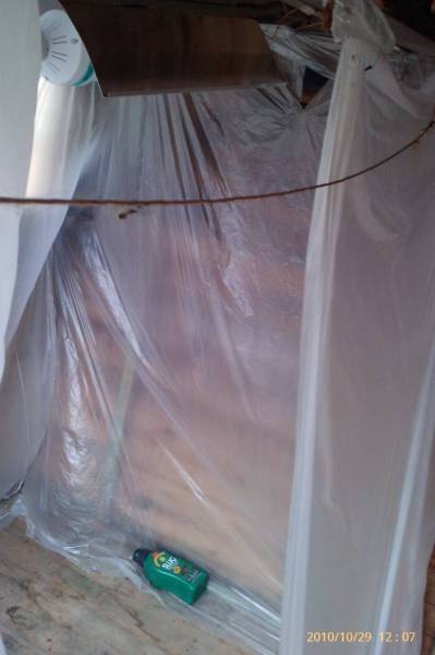

The shed looks like a scene out of Dexter !!
Damn i don't watch the show, so can only imagine!
Tom at JMS called me yesterday evening, to explain how crazy it was to put them on the strut brace, as well as the battery. The guy who MOT's my car said it was alright, better not listen to him again! But i'm really glad the car is with Tom, i haven't even had the car back yet and i'm already very impressed with his service! He also said he will sort out the harnesses so they are safe!

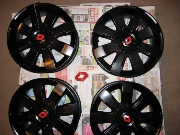

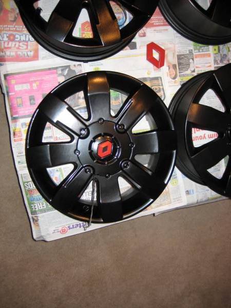

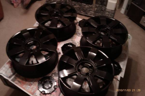

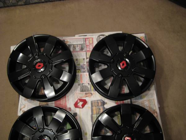

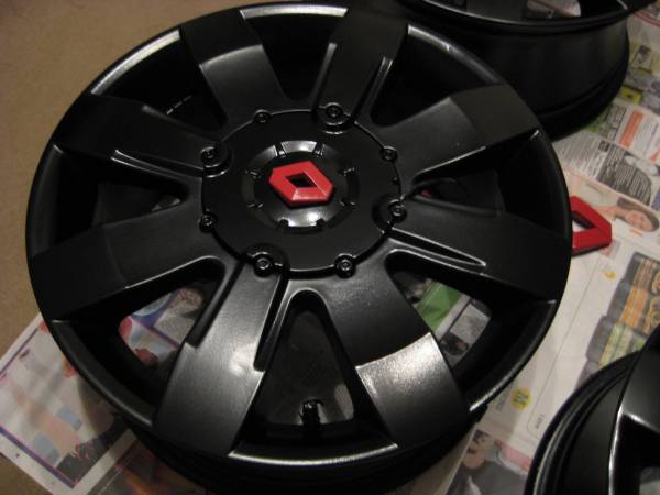

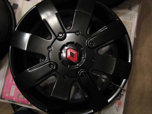

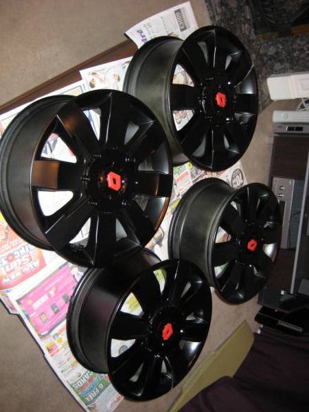

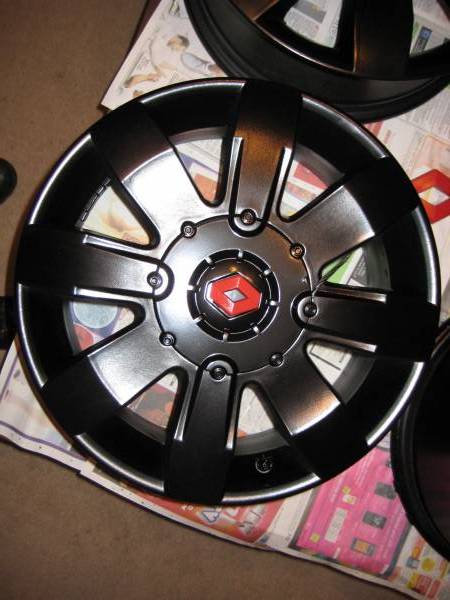

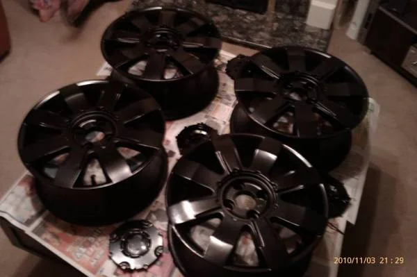

Ok, i've put the center caps on, (only rested on top not clipped in) and i also rested the red diamonds i painted.
They are drying much better now they are in the living room! One wheel needs at least 2 more coats of black. I will give the other 3 wheels 1 more coat. Then i will let them dry and start laquering.
I've taken some photos of how they stand atm;
Hopefully they will be finished by next weekend.

For harness mounting points go to msar's website and have a look, you'll find a good way of securing the harnesses safely on there mate

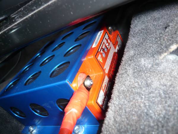

Glad that battery was mentioned in the first post. Absolutely shocked to see it held down with cable ties!
It's not been unheard of for loose batteries/chavvy subs etc... to rip through body panels or windows in a crash.

Ok, i need some more advise please.
As i should be, I’m quite concerned about the battery in the boot the way it currently is. I’ve had a search on here, ebay, merlin, google etc for a battery box or something similar. I’m not having much joy.
So I thought I have two options really.
1. Move the battery back under the bonnet until next month when I have the monies for a redtop + bracket.
2. Can someone on here think of a secure way of mounting this battery to the base of the car?
The only way that has occurred to me, is to make two brackets that go around and over the battery and both ends screwed into the car. So said battery won’t go anywhere. But I don’t think it will be strong enough in the worst case scenario of being rear ended L
One thread I was reading someone suggested a mk4 fiesta battery box. Now yes this is something I can sit the battery in, in case of acid leak etc. But no way is this plastic box secure enough in my eyes. The plastic on a few pics of this box looks thinner than my ties ;) Or am I missing something here with the fiesta box method?
Secure suggestions will be much appreciated
Cheers

Beg borrow etc And get the varley sorted IMO unless you want your head stoves in. Any other idea sounds like a half measure and still dangerous

Save up the money and get a Red top mate, much better than having the acid bomb sat on your boot

I asked Tom to sort out the Battery, by getting a Odyssey 25 battery, and get it installed under the passenger seat :)

Good work on this, well done for taking all the advice on board re the harnesses and battery and sorting it quick sticks

3. Alloys have had final coat of black paint, just need to lacquer now.

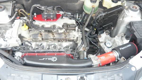

On Friday 26th I set off down to London with my mate in his mx5, as he was kind enough to give me a lift down there. Got there at 18:15 and the car wasn’t ready so we went down to the local and had some food and chilled out. Went back to JMS, the guys still had a few bits left to finish, but this was a good opportunity to ask some questions. I was really pleased with both Tom and James attitude, you could tell they cared and took pride in their work. They made sure the car was fine to drive before I went home, which was really warming, considering I knew in the back of my mind that the car won’t run as it should until it’s been mapped. Tom said the car responded very well and he seemed very pleased with it.
I left JMS cold, tired and wanting to get home, but the journey home sure woke me up. I was buzzin when I got home!! I’ve never had a de-cat fitted to a car before, the rumble when you start the engine is awesome! The new engine mounts seem tight, lots of new vibrations but for some reason I feel this has added more character to the car, it doesn’t just feel like a standard clio no more with just some seats removed in the back. I’m really pleased! Yes there is a loud drone on the motorway, and with having forgotten my stereo I just had to play with the exhaust note most the way home. The engine is over-fuelling as I used an awful amount of fuel on the way home. Or maybe that was just my right foot ;)

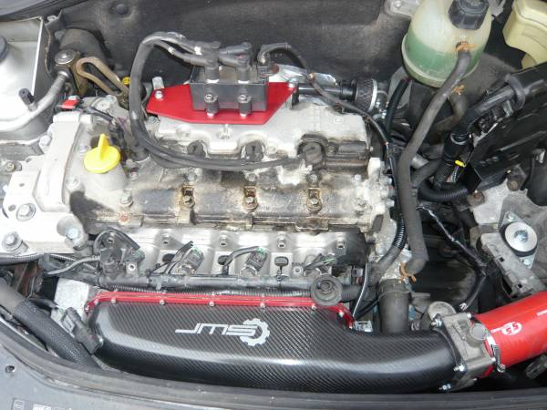

Until the car is remapped I’m down around 20bhp, and a delay in acceleration. The only way to describe it, is it’s similar to a turbo, you put your foot down, and about half a second later the car just wakes up into life and wants to go. Feels very torquey in the lower rpm range. Tom advised I don’t go over 5k rpm really, which at this time of year won’t be a problem.

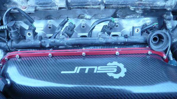

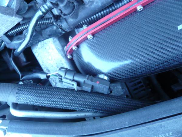

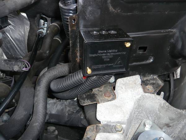

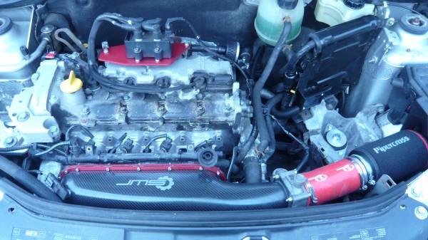

The work I had carried out at JMS is as follows:
-RS2 manifold
-De-cat
-New battery under the passenger’s seat
-Fitted my harnesses correctly

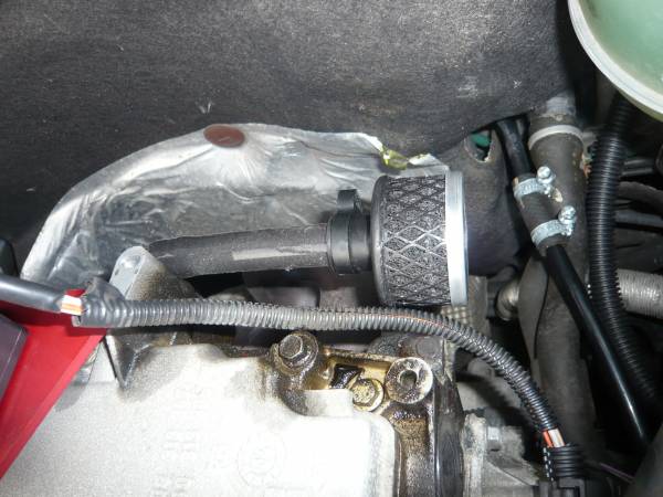

I have a lot of work to do now, I have some old oil stains on the engine, and some fresh ish ones. Tom advised I clean it with degreaser and then keep an eye on it. I may have a leak somewhere, which if I remember correctly was on the side bit of the engine. To fix it he said, it’s a cam-belt off job, so this is something I will start saving up to fix next. So apart from cleaning the engine, I have to sort the inside out also, as I have the old wires left in the boot where the old battery was. And I have to remove the standard seat belts. I also have to fix my fire extinguisher under my seat or behind my seat. I also have my Skoda splitter to fit at some point.
Below are some photo’s I have taken and the links to the high res versions:

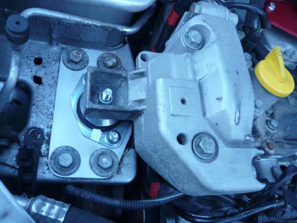

engine_bay_2

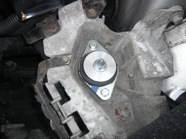

http://www.minux.co.uk/clio/project/RS2 photos/engine_mount_2.JPG
http://www.minux.co.uk/clio/project/RS2 photos/engine_top.JPG
http://www.minux.co.uk/clio/project/RS2 photos/enginemount _1.JPG
