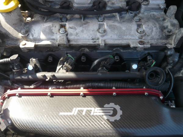

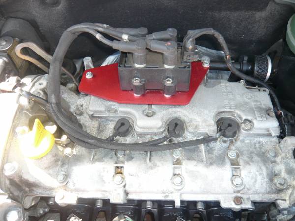

Cable tied fuel rail :(. Sure it'll be a different animal when its mapped! Look forward to the results.
  None :(
Tom said the part for the fuel rail is being anodized atm, and should have them next week. He'll come to mine to fit it he said. Hopefully he doesn't forget about me ;)

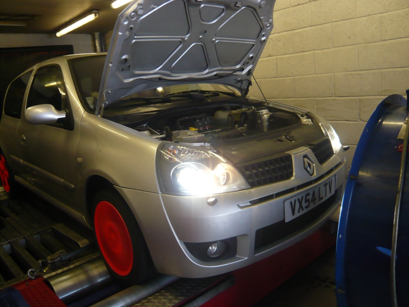

Pauls colleague washed my car off (thumbs up) and in it went. Got the car mapped, and then went home, got home in 3 hours.

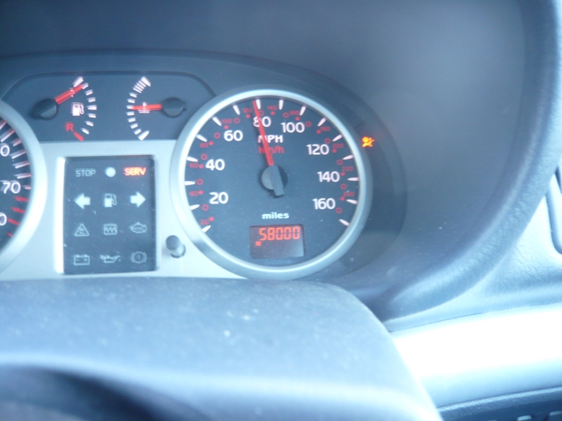

Car ticked over to 58k so thought I’d take a snap
This is not 80mph as i'm on 15" wheels = crappy mpg also :dapprove:

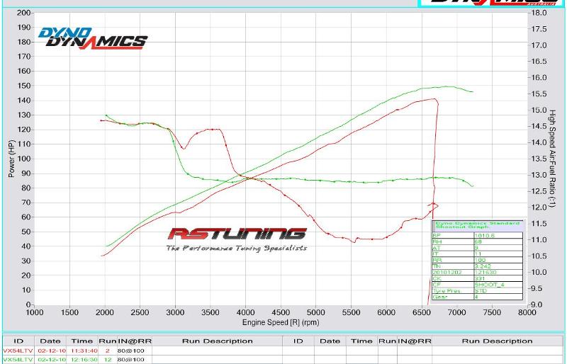

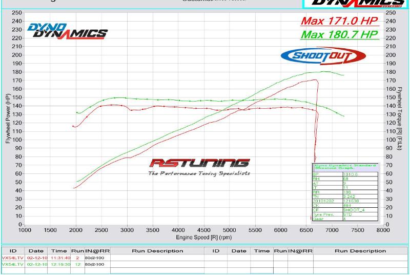

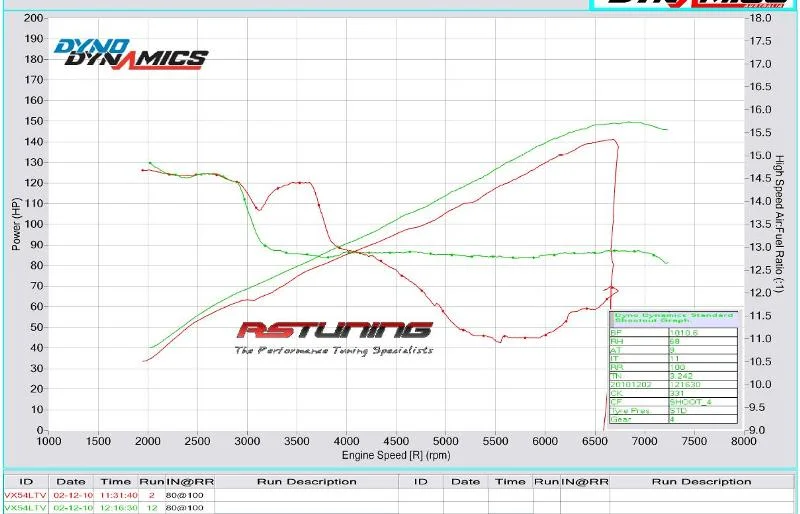

Ok the part most of you want to see, the results:
As you can see from the results my engine gives up at 6500rpm, but the torque curve Is good. For some reason or the other my car is around 10bhp down, which is obviously linked to whatever is causing the engine to give up at 6500rpm range. Sent the graphs to Tom at JMS who looked at them, then called me back. Tom advised that he was very impressed with the torque curve and is a sign of a healthy engine. Tom said he will need to have my car back, to take a look at what could be causing this issue. A few things he suggested that could be causing it:
-A small blockage somewhere, maybe in the exhaust, filter or somewhere.
-Low compression in the engine, and is this linked to the small oil leak I have?
-The fact I’m running 15” wheels make any difference, had Paul calculated this factor when mapping?
I just need to get the car back to Tom now. But tbh I don’t drive to the limiter often at all, and the low down grunt is very addictive. But I’ve paid for this mod/power so I want to get it sorted. For those interested, the best way I could describe my car now after the rs2, de-cat, uprated engine mounts fitted, is ‘RAW’ & 'exciting'. I still get the odd throttle response delay from 1st gear to 2nd, but only very minor and mainly when the engine is cold and not warmed up yet. I have also noticed since first getting the car from JMS, that the steam coming out of the exhausts, well it only really comes out of the left tail pipe. Is this another sign of a small blockage? Something isn't quite right.......
Thoughts / comments / suggestions welcome

My sat-nav warns you when you are going 80mph (for some reason). It started warning me when the needle hit 95mph! so the speedo is definatly off.

i did think cam timing but then it wouldnt stop at 6500, it would rev the whole way just with lower power wouldnt it?

If it was cam timing, i wouldn't get that torque line would i?
Good point on the route bomber, but even my friend mentioned it to me (when i told him my car didn't make the expected bhp) when Tom started the car for the first time in the garage it only came out the one pipe, he's used to seeing it come out of both pipes at this time of year same as me. I Kinda wish he mentioned it at the time, so i could of asked Tom there and then.
Wouldnt be the first car I have seen with a lovely torque curve and bad timing. I'd be getting it checked tbh.

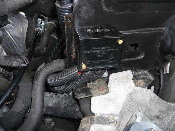

Where did you get this distribution block for the battery from?
You will have to pm/call James at JMS, he sorted that out for me, as he didn't like my electrical tape ;)

Few bits and bobs to finish up, but we'll get there. It has a slight restriction at the top end; however discussions with Paul have not heralded any specific problems so we'll need to get it back and investigate, you never know - it might be reunited with Deans car!
We'll check the timing amongst other things as standard procedure, I can't recall if James has had the belts done?
Its torque is bang on the money, it just drops away 500rpm to early;

My 182 was exactly the same, just after 6300 it seemed to just drop off and lose its power, then regain it at 6900....very strange. We thought possibly a sensor or injector issue, however I would think if it was a faulty injector it might play up earlier in the rev range

It will almost certainly be due to high demand flow rates through the engine due to the fact it is only present in the upper RPM, something small like a slightly off mounted throttle body or the likes. It's impossible to compare to a stock manifold as it does not herald the same type of airflow characteristics (peaky with low and high RPM torque dropping off).
Anyway we'll examine all of the options and go from there.

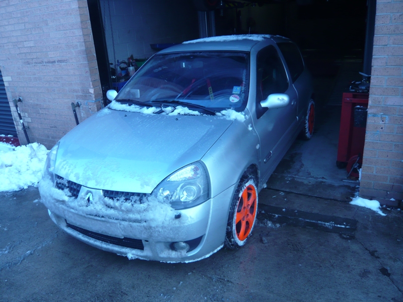

Silly little orange wheels are now off the car!

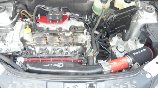

I’ve been doing some more stripage, but I’ve now come to the stage where I need a heat gun and a good nice day to tackle what’s left.

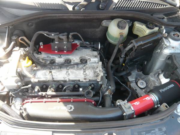

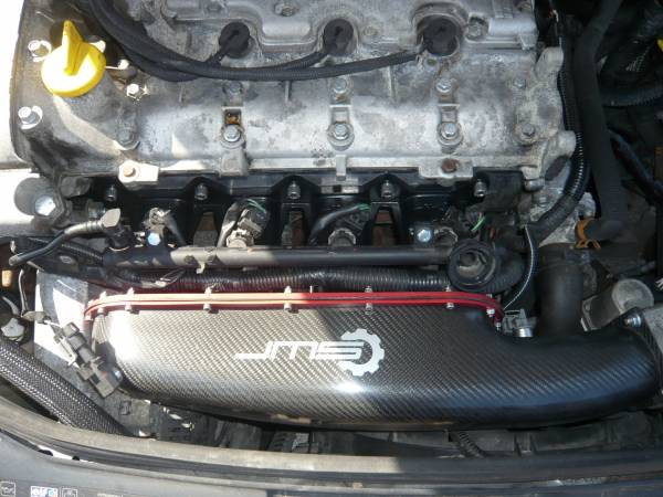

When the car was at JMS, Tom spent some time cleaning my engine bay so i can keep an eye out to see where any fresh oil on the engine comes from. Thanks Tom well chuffed with what you did there! :)
Some pics:
Before:
After:

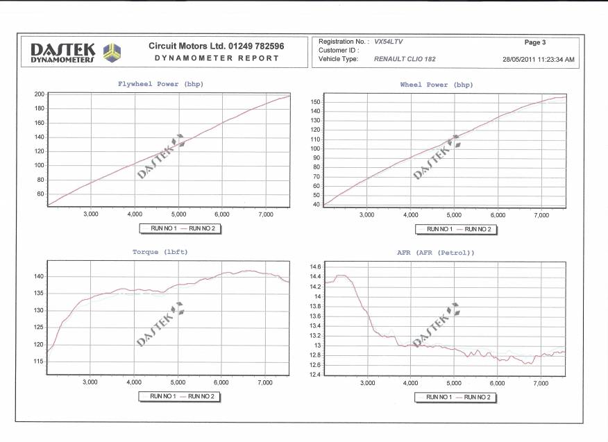

Tom at JMS advised me that I may have been loosing peek power due to the throttle body not being 100% in-line with the manifold. I think this is what he meant anyways :eek:

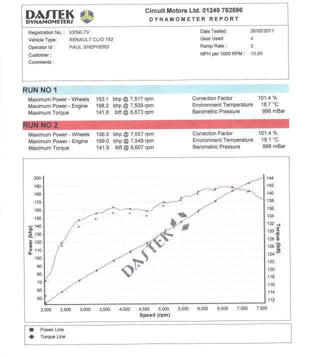

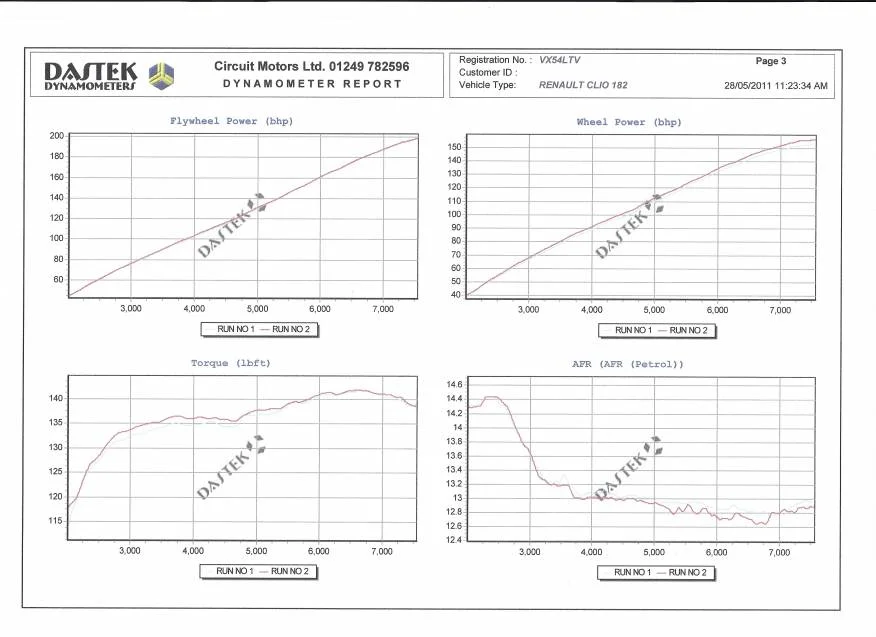

Well the engine does pull strong to over 7k rpm now, which is great. I went to a local rolling road meet yesterday and below are the results:
I know it’s not the same RR, hopefully I will get the chance to go back up to RS Tuning soon to get it back on the rollers there.
