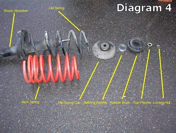

Lowered on G max springs (clio mk2 ph2 1.4 16v) ive found the susension quite rattly when going over bumps... is this commmon? or is something loose?
thanks
josh
Depends on how much you've lowered it by, how recently you fitted the springs (they'll take time to settle and locate properly) and the make of spring - some are better than others.
no its deff from the suspension. The rattling is coming mainly from the passanger side and sounds like the spring movin around. I may take it apart tomorrow. Im thinking it may be the spring in the 'cup' part just rattling away, should there be something rubber between the spring and the 'cup'?
thanks
josh
yes there should be a rubber at the bottom of the strut that the spring sits in (it has locating marks on it)
how about, NO CHANCE!
build the strut in the following order (starting at bottom)
strut
large rubber ring (located correctly)
spring
top plate
bearing (the correct way up)
rubber doughnut
brass spacer
17mm nut
job done (all bits are in pic below)

the "top spring cup" on the diagram

so u reckon it needs reseating in that top cup, i did have a slight problem with this while fitting iirc it has a cutout in the top cup where the end of the spring goes. i couldn't manage to keep it on that so i figured that providing it was in the cup it would eventually seat itself right.... Might have to take it to bits tomorrow..

the main problem i had was when threading the strut cover thing in the engine bay it kept making the shock turn and so unseat the spring.. I was also having trouble getting the bottom of the shock bolted onto the (wishbone is it?) as i couldn't force it down enough, if i have both front wheels off the ground will this be easier to do (no anti roll bar working against you) or is there something else i can do to make it easier to force down?
much appreciate your help fred!
josh
you've over tightened the engine side top mount caps then (common mistake, which causes the springs to pop out)
yes, both wheels should be in the air
how much should i torque them?, bearing in mind i don't have a torque wrench, although i may try and borrow one...
thanks
josh
tighten them up unitl you start to feel turning resistance from the shock (it'll feel slightly bouncy through the tool), thats it
