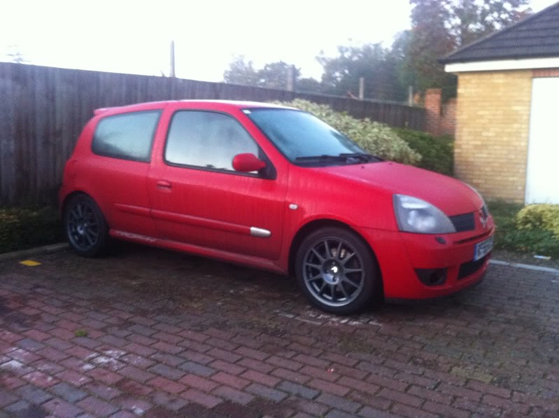

Had the shed for pretty much a year now, so took a picture of it this morning, after its 1st decent trip since Bedford (it has only moved twice since then iirc). Topped it up with oil, turned the key & she started first time, as per usual - not so bad considering the miles are almost up to 177k now ...
Is funny, everytime i think of getting rid, i drive it, realise that it actually sticks to the road like sh1t to a blanket and think i'll keep it forever. Then i dont drive it for a month & think its a waste of money sat on the drive ... still, looks rather purposeful i think :race:

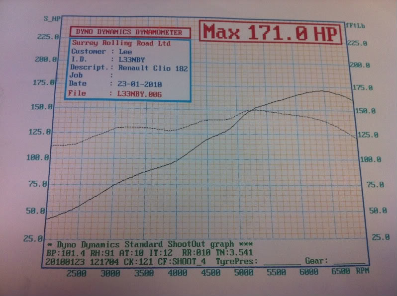

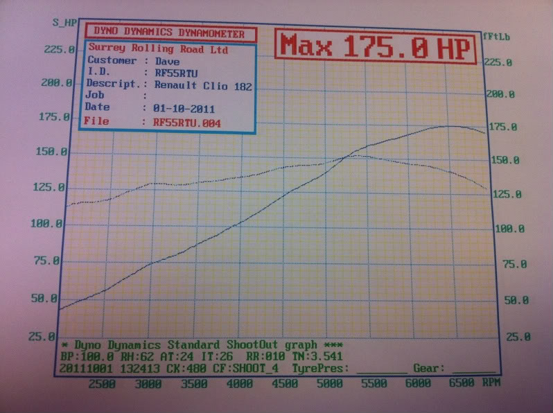

Took the pink shed to a rolling road day on Saturday at SRR. Wasnt expecting much to be honest, it did 171bhp in January 2010 (on 170k miles) when Lee owned it, but with another 8k miles & a fair few track days under its belt, i didnt expect many to be left really ....
But, in the sweltering heat of October,with just under 178k miles, & only the addition of a V6 airbox, JMS map and a good service since its last RR, it put out 175bhp (145.1 @ wheels) & 151lb torque. Considering its still on the standard inlets and isnt de-catted, i was happy with that.
Bless it.
And the previous graph, you can see where my 'work' has improved the curves from 3500 to 5250rpm (no more hole):
Next mods are likely to be the removal/selling of the buckets, cage & valver wheels/R888's in preparation for its hibernation in December, purely as the M3 will be taking priority (re: all my money) for the next 6-12 months or so :race:

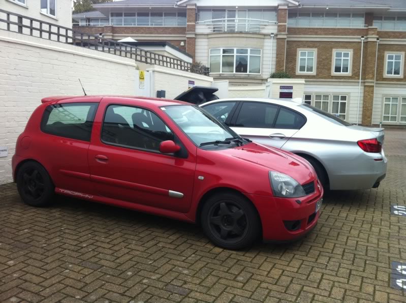

Trophy is now rolling on what can only be described as a set of 'utterly mint' sheep wheels, after Aucky wanted new ones lol. Detailers ay ;)
Is funny how different wheels affect a cars stance though, not only do they look massive, but whilst i didnt really notice the -2.8 degrees of camber on the 15" PR3's, with the 16" Turini's it looks broken lol. The wheels also weigh a ton, so it will undoubtedly drive differently.

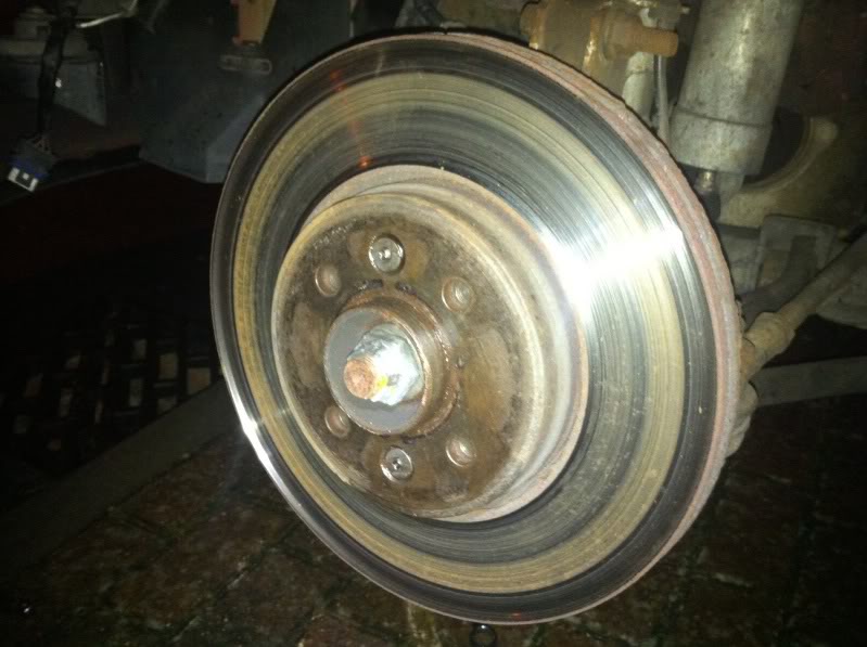

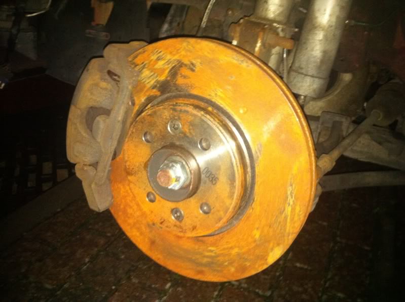

Having fitted some s3xy sheep wheels recently, i decided that the CL pads would have to come off, asap, to ensure that they didnt get f*cked by brake dust. Upon inspection, it would seem that the pads had eaten my discs in approx 3k miles lol. With a ruddy great big lip around the outside edge, meaning that new discs would have to be fitted as well as new pads ...
Luckily for me, i already had a set of new OEM Renault pads & Brembo HC discs in the shed (re: boot of the Trophy), so last night, at 8.30 at night, in the rain, i decided to do a quick swop over. As per usual, nothing ever goes to plan, with the caliper carrier bolts being torqued up by Renault (the last people to change the discs) to what can only be described as super f*cking uber tight. Cue lots of WD40, swearing & liberal use of the hammer. Please note that the latter wasnt actually used to remove anything, just whack the old discs in frustration :eek: I also gave everything a little clean with a wire brush, the dust/metal/bits of my discs created by the evil Carbon Lorraines was blooming everywhere lol ..
