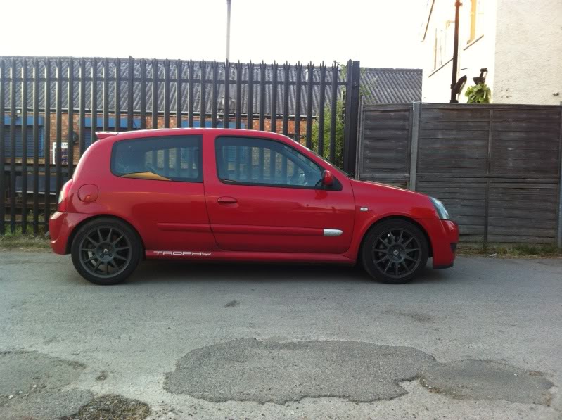

So to get everything up to date, last Friday night saw myself, Ollie & Mike go over to Panelwise, sorry FailSport posh fitting department, to quickly wang on the H&R's, fit some new ball joints and then all go our seperate ways. At 6.30 we got started and everything started going swimingly, Ollie was doing the front suspension, Mike was messing about with my engine mounts, & i was 'managing' everything and going to KFC for supplies ... :clown:
Drivers side strut & balljoint went on fine, ride height was roughly set, moved to the passenger side, ball joint wouldnt come out, bigger hammer was grabbed, swearing ensued, driveshaft got pulled out. Doh. Cue the distinct smell of cat pi55, gearbox fluid all over the floor and Ollie becoming Mr FFS. Angryness ensued as not only was their gearbox oil all over the floor, & my spare 3L was at home, 40 miles away, but after a quick call to James, he told us that the gator would probably be split as well. Oh FFS :quiet: Mike got on the case, pulled it all out, realised that the gator thingy had just slipped off & put it all back together. Winner. Ollie finished all the suspension and everyone was happy.
So we moved onto the back. Fitting the rears was also an utter ballache, with the rear H&R spring platforms being far too big for the rear beam holes (either the Germans had ballsed up, or the Trophy is a parts bin special with the wrong size holes in the rear beam-more likely), so we had to air sand a load of metal off the H&R parts, & grind off a load of metal from the beam. FFS. By 11pm we gave up, the Trophy stayed put, & Mike took me home in the Lolvo.
On the Monday, by using an even bigger hammer, Ollie, Nick & I managed to get get the rear suspension back together, Mike filled the gearbox up with oil & it was finally finished - well barring the inner tie rods & track rod ends that we still need to fit (didnt arrive in time), the Powerflex bushes that the ARB & Wishbones clearly need (although i might just buy new standard wishbones). Oh and the top mounts are buggered, so they'll need replacing/upgrading at some point as well
I also took the opportunity to drive Nick's 182 that they had fitted the Quaife and AST's to the previous week. Went around a roundabout about 20 times, & even on ditch finder tyres the difference in traction is really quite noticeable!!! :race:
Pics of it all finished are here:
http://www.cliosport.net/forum/showthread.php?643569-Trophy-on-Coilovers-Slammed-Yo
Last night i set the camber with my trusty breaker bar & iPhone spirit level app, so today its off to get the toe sorted ... and my 2118's shod with some tyres for Llandow on Thursday.
