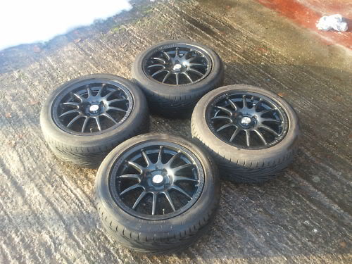

Anyone want some Imola's? Look lovely now i've given them a clean :approve:

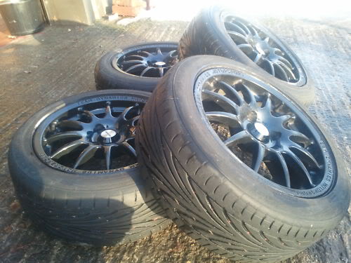

Another update, purely from a cost reduction perspective :dapprove:
Shouldnt have sold my last set really lol:
Have also sold my stereo & handsfree kit. Trophy is going to be bare.
2118's will be sale after xmas, so pm me if interested.

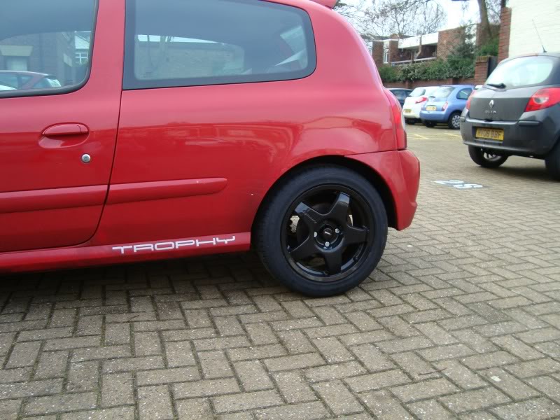

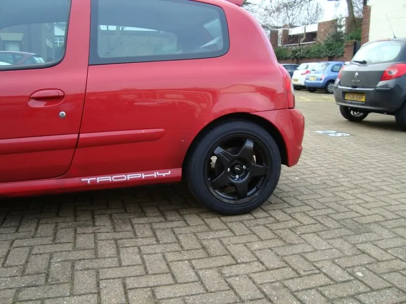

Fitted 4 of the Trophy's Christmas presents yesterday, at work, in the dark :cool:
However, after driving home 45 miles, the 'recently balanced' wheels & tyres clearly werent lol ... more vibrations than a lonely housewifes battery operated friend!! Got them redone this morning at the local Kazachstani tyre fitters - for best cash price obviously (TM Daniel Colshe).
Still, for all the haters of cheapo wheels, here it is, in all its unclean glory:
New Years Day will bring a hangover, & the fitting of my new dished beauty:
Then i really need to get the seats in, & the Sportlines/camber bolts on :D

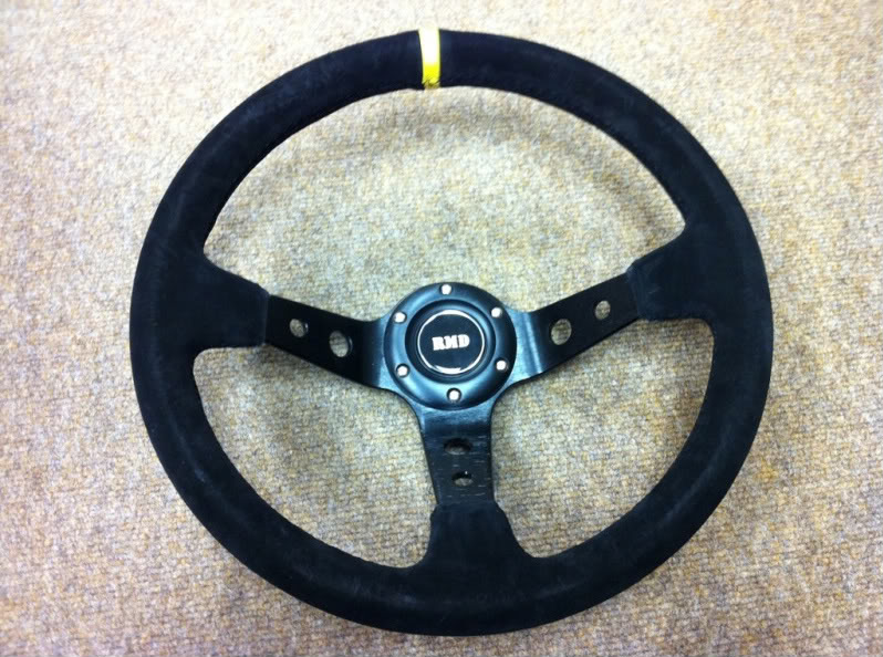

Dave I had a rmd wheel on my saxo, ideal !! Shame I wrecked it by not wearing gloves but meh, will be a huge improvement
  330i. E30 Touring.
Re: Project 172k Trophy, & its endless track abuse
I've got an OMP horn button in the shed you can have if you want?

Hate those wheels. So poorly made around the yellow strip.

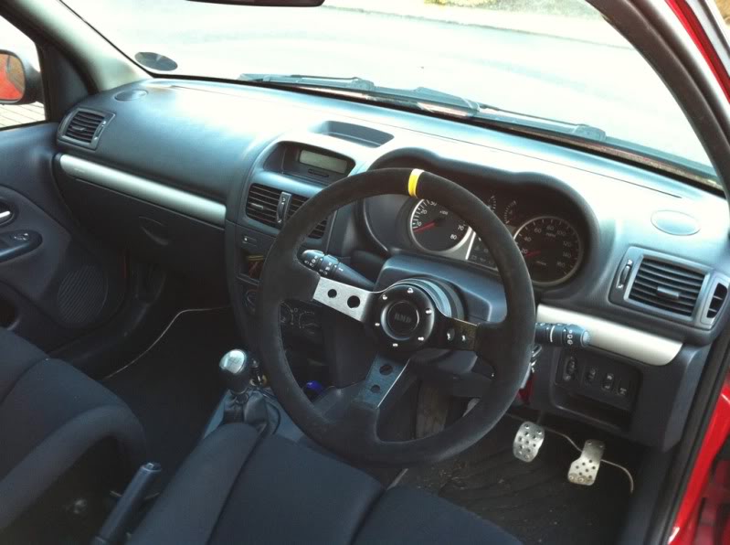

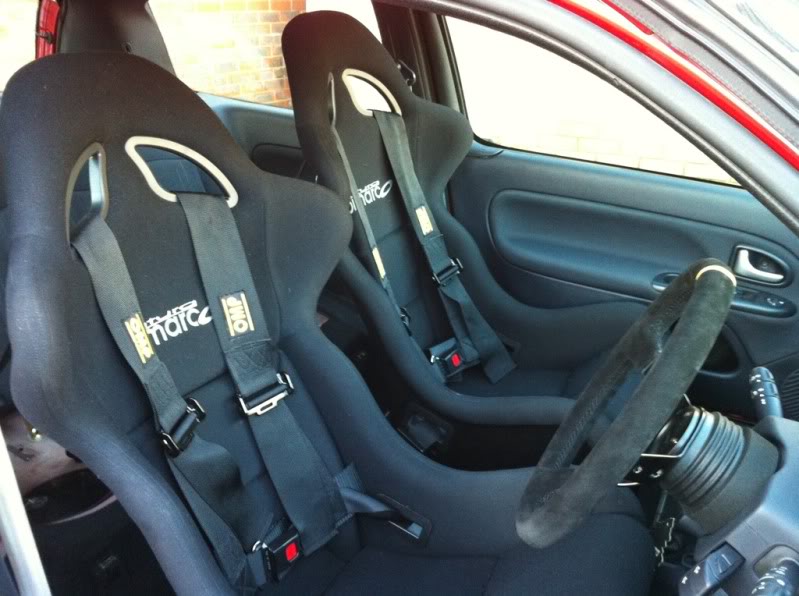

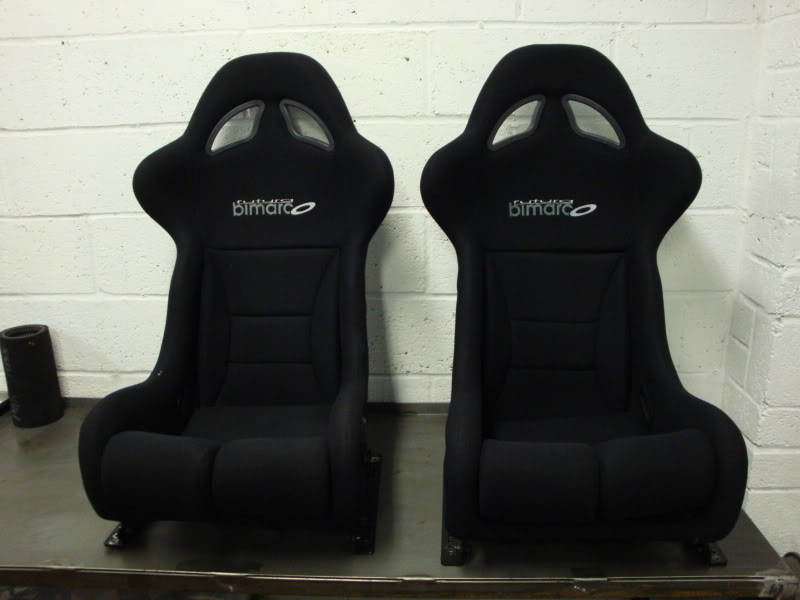

Well, Saturday brought two things, rain & fire.
The first, well that wasnt really anyones fault, but i needed to get the car up in the air to fit the Bimarco's, this involved me getting wet & dirty :dapprove: But after much swearing, adjustments and bolting/unbolting, i had two new seats. Shame that upon the initial installation i couldnt reach the pedals. Being short like Christoper FTL. After attempt 7, they seem to be comfy enough, more tweaking required though, & Sarah's moaning that her seat is too upright, despite it being on the most 'relaxed' setting ...
Once that was done, i thought i would attempt the new steering wheel, foolishly thinking that it would be easy, like the Saxo one. Nope, the airbag, horn & cruise wires were a pain, & i fitted the boss upside down so all manner of warning lights came up on the dash - amazing how fitting a steering wheel incorrectly affects the ABS & TC :S
So then, onto the test drive, where my new steering wheel highlighted the fact that my tracking is waaaaay out, with the wheel at 45 degrees when going in a straight line. FFS. Then, i decided to make sure my horn still worked, this was a bad idea.
Well almost!! Something fizzed, smoke appeared & i feared that the internet phenomenon 'V6 on Fire' might soon become a distant memory in the presence of 'Trophy on Fire'. Panic set in & i did what any competent FailSport mechanic would do, i checked my feshly opened can of Pepsi Max over my new steering wheel :eek: Not sure if it was a good idea, ie water + electrics, etc, but the car didnt catch fire, so im happy enough, wheels a bit sticky though ...
Upon speaking to Ollie, it sounds like the horn wire had sparked on the metal boss, & tried to recreate the big bang. Doh.
In addition, after continued 'wobbling', i inspected the Pro Race 1.2's i had just bought/had balanced and one of them has a bulge in it, which would explain why they still feel awful. Now normally, i wouldnt be too upset, but i sold my my perfect condition 2118's in order to save some money, now i need to go & buy another set of wheels, aaaarrrrgggggghhhhh :mad:
Anyways, here are some awful pictures, will update again once i've cleaned it, fitted the Sportlines/another set of wheels & a new splitter :D

A brilliant update.
LOL at the steering wheel, big bang attempt!

Dave I have an OMP version of that wheel you could have had for peanuts! Better quality too!
Just read all the writing, you're truly a funny guy. <3
Anyway, the reason you got fire was because (I think) you wired the horn backwards, although there are only two connection, basically one of them is an earth and is earth through a bar, but if you put them the wrong way round, the live goes through the bar, joins to the metal of the boss and sparks and fire, fun! Not.
O. That might explain it then lol. Sarah's dad (proper electronics engineer) said that i was never allowed to work on the car unsupervised again lol, im an ejit apparently :eek:
Still added a 'spark' of excitement to the day i suppose ;)

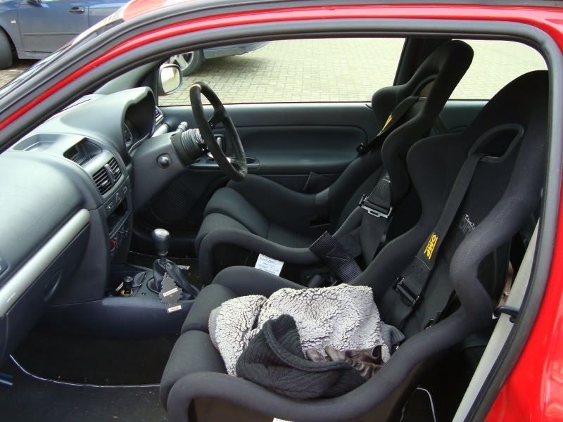

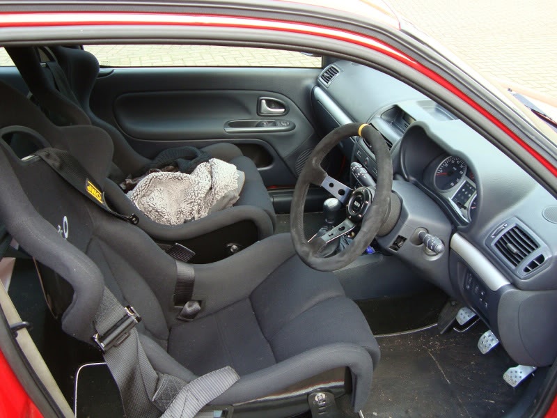

I see having your seat forward might have an effect on your leg position vs the accelerator? The seat looks totally off centre
Sir_Dave
ClioSport Trader
Nah, its just my incredibly poor cameraphone skillz :eek:
The centre of the seat cushion is exactly in line with the centre of the steering wheel, although coming from the Recaro's, i am finding it odd not physically standing on the pedals AKA like in a Transit!! Need to adjust my heel & toe technique i feel.

I love the fact that I'm a seat position yardstick.
Looks good mate!

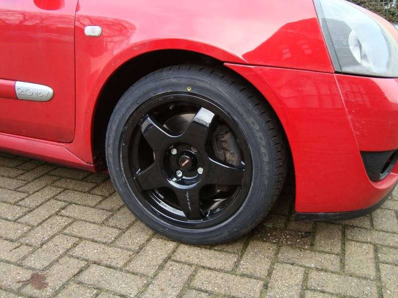

Ok, so after the bent wheel saga, my faith in 2nd hand wheels was slightly 'dented' :dapprove:
As such, and for the 1st time in probably 5 or 6 years, i bought some car stuff new, i.e. unused, not from eBay, CS or Sax-P. Whilst, i'm aware that this does somewhat go against my usual policy, the term 'buy cheap, buy twice' could never be more apparent at the moment ...
And well, Demon Tweeks did me a rather good deal ;)

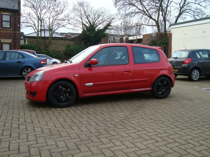

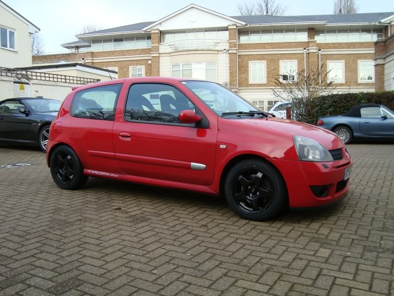

Thought i better update the project thread now the cars finished.
Havent driven in for 2 weeks as the tracking/camber is miles out, but the changes have made an awesome difference!! Roll on Donington on 13th March ...
Spec is as follows:
15" Pro Race 3's with T1R's, Brembo HC discs, Ferodo DS2500 pads, braided lines/Dot4, Eibach Sportlines, Whiteline rear ARB, Eibach camber bolts set to -1.75 degrees, BTB catback exhaust, Espace V6 airbox with ITG filter, Skoda wonky front splitter, RMD Dished steering wheel, 2 x Bimarco Futuras & OMP 3" 4 point harnesses. Rear seats are still in as i like to be able to use the boot.
Hope you like :eek:

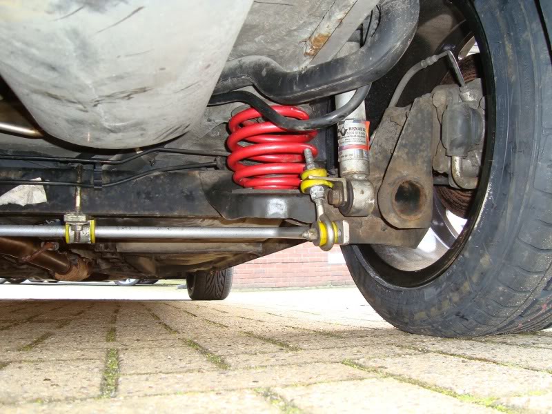

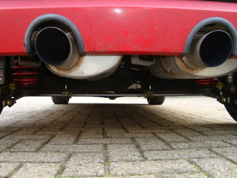

I think somebody has over tightened / incorrectly fitted their rear ARB ;)
Where it attaches to the bottom of the shock absorber... looks twisted, compressed and the bush split?!
Yes to all of the above lol.
My bar seems to be one of the ones that was built incorrectly, so the droplinks fit to the inside of the bar, not the outside - like 99% of the other ones out there - hence its kinda 'bodged' on. And yes, i over tightened it, like nigh on every other nut/bolt i touch ...
There is 'finger tight', 'f*cking tight', then 'Dave tight' iirc ;)
