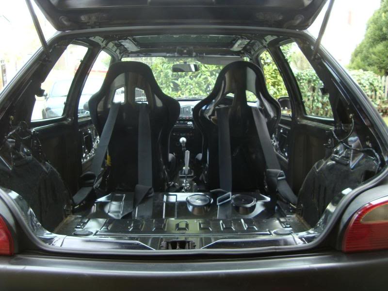

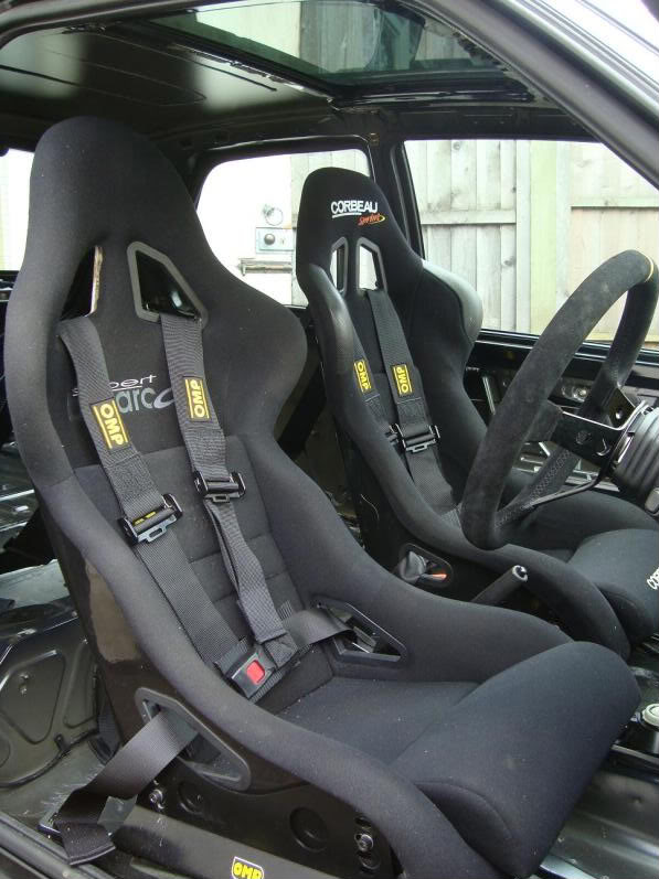

Interior wise, think this, but clio shaped:
Then de-pin the front Sachs dampers, add adjustable rear Koni's and some appropriate springs. When combined with the Whiteline ARB, that should create something very much go-cart like.

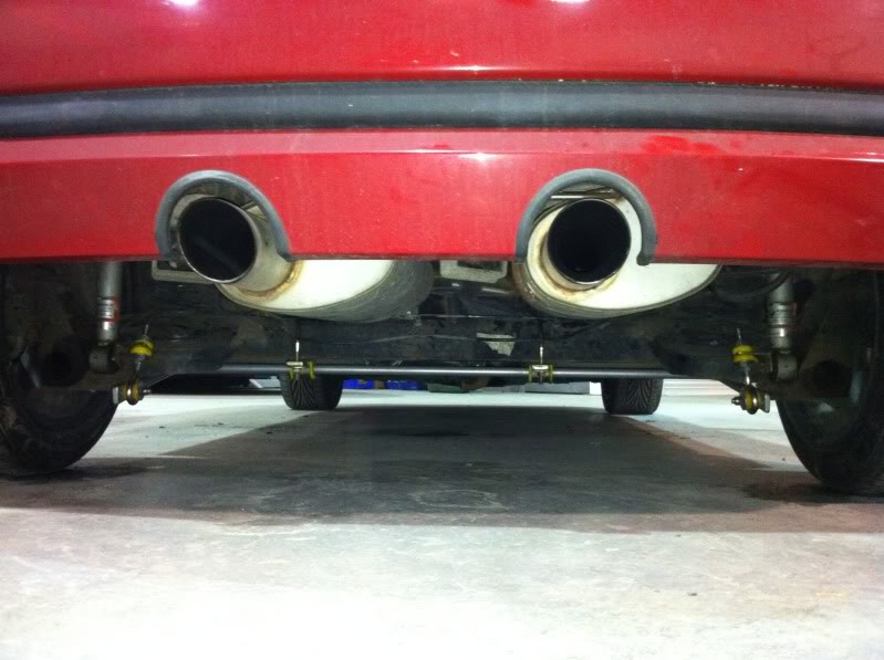

With a KFC inside us, the oil change was sorted very quickly by my able assistant & it was onto the ARB. Firstly, it looked completely different to Nick’s, & secondly it was longer. Hmmm, perhaps its not the right one we thought? Bugger it, lets bosh it on anyway, this is Failsport remember ... nearly 2 hours later, & having given up on the buzz gun, the extended breaker bar & copious amounts of WD40 had got the rear damper bottom bolts out, god only knows what Renault torqued them up to when they changed the dampers last year :rolleyes: Once they were done, we quickly offered everything up to car, & realised that yes, we were going to have to fit it completely differently to Nicks, with the droplinks on the inside of the bar instead of the outside :s weird, but there was no other way it would fit. With that finally done, I got ready to leave & took a quick pic of the new addition (for CS of course):

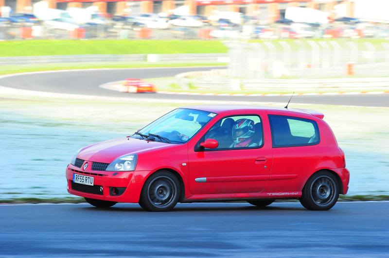

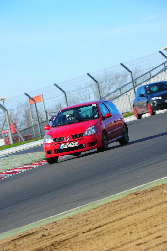

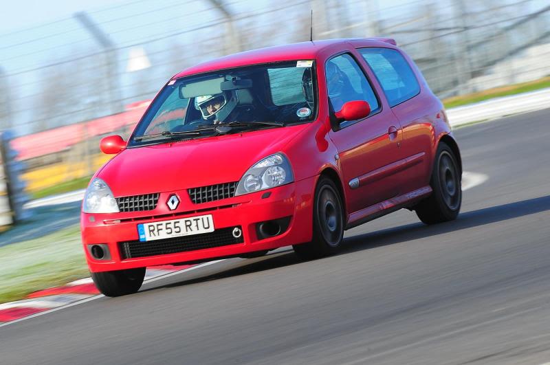

As ever, the car performed faultlessly all day, & the Whiteline ARB (Set to medium) has really transformed the car imho. Whilst i was suffering from understeer on the limit at Snetterton, this has now been replaced with a greater willingness to hold the line, combined with a improved tendency for oversteer. The car is now, & i hate to say it, very similar to the Vts on Bilsteins i had previously, which tbh i was trying to recreate!! I now have the option to steer with the steering wheel, throttle or brakes, the ARB stiffening the rear up to the point where it really is quite twitchy, lovely :D No more 3 wheeling either, so its certainly doing something back there!!
Anyway, my photos, courtesy of Focussed Events:

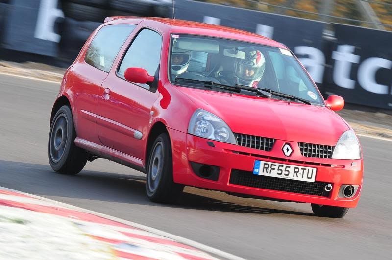

Only problem all day was that we were both sliding around on the seats quite a bit (despite harnesses), not great when you're approaching paddock with a dab of oppo ;) that was duely sorted with a cheeky bid on eBay when I got home, hello Cobra Imolas:
In addition, as you can see from the photos, the front wheels could do with a little more negative camber, not just for grip purposes, but to prolong tire life as well, so I may invest in come camber bolts of some sort. The T1R’s were also fine, yes they dont offer as much grip as R888’s, & Nick and Ollie were able to drive off into the sunset ahead of me, but I prefer fun to ultimate speed tbh, & having to fight the car around the track is where I get my pleasure ...

Ace write up mate. Lovely looking car. LOL at bodging the ARB on failsport style.
Re: Project 172k Trophy, & its endless track abuse
You should know by now, that by 'bodge', i mean it was re-engineered to ensure a more accurate fit based on the revised parameters discovered following our initial consultation, i.e. it wont fit so i got the hammer out. 5 more minutes & i would have been on the phone to Mike to get the angle grinder ...

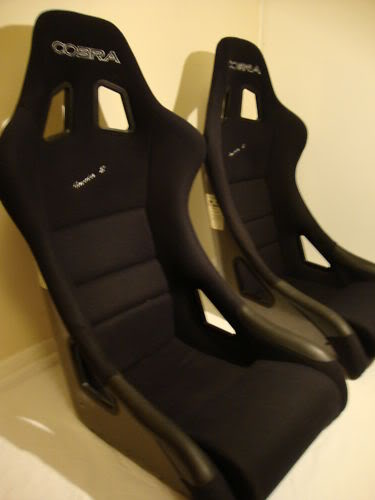

Well after some late night eBay action over the past week, i now have the following sat in the server room at work :D Hopefully it'll get warmer at some point so i can fit some of it:
2 x Cobra Imola's in black/dirt
1 x rather used OMP side mount
1 x slightly less used Cobra Side Mount
1 x new(ish) OMP Subframe
Various Grade 12.9 High Tensile bolts, nuts & washers
A 'Momo' steering wheel boss
1 x finest taiwanese 350mm suede dished steering wheel
Next stop is another OMP Subframe, some Eibach camber bolts & Sportline springs - for less tyre wear/lean/added stiffness. oo err
