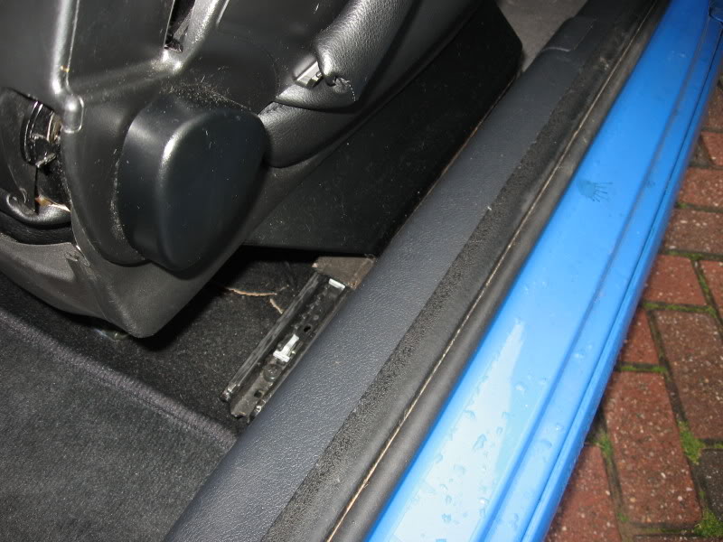

Just been on a taxi run to drop mates off in town and the sliding lever has jammed so the seat's now not clicking back in place!
Any suggestions for the morning?
This is a standard PH2 passenger sport seat btw.
Ta, Laurence.

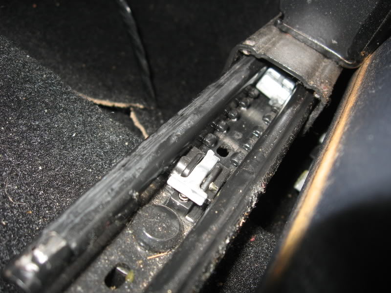

Ok, just had an investigation. After a quick search there's a little bracket in a T shape that obviously is the stopper for the seat. It's not broken it's just unattached itself but for love nor money I can't find a way to reattach it.
Borrowing pictures from Beecheys thread:
It's this exact clip but it's not broken at all, intact just like it's come away from where it's attached to but I've no way of reattaching it.
From that pic it looks like its got a pin going through it to hold it in place. Im guessing that the pin has just come out on yours then?
I have the exact same problem! The passenger recaro doesn't lock into place without several minutes of fiddling with the metal clip, I thought mine had broken tbh are you sure the metal clip isn't suppose to be attatched to the metal block hiding under the seat?
You can get it to lock if you push the t shaped clip forward to the block then pull the seat all the way back and then pull the seat upright. Sorry if this is a little confusing..
