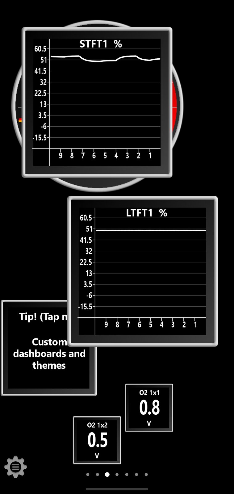

My car sometimes has a slight hesitation at around 2-3k and I've been trying to work out what may be causing it. I haven't had a chance to log any data when it's done it yet but here's an example of the fuel trims and o2 sensor values when just idling. Can anyone notice anything out of the ordinary? The pre-cat o2 sensor switches between 0.8-9 and 0.1-2 every second or so leading me to believe the o2 sensor is fine. It's a 1.2. Any help or suggestions would be great :)

The pre cat lambda switching is fine, that's what it's meant to do.
I'd look at coilpack or injectors.
Yeah I thought so, it's a bit slow switching but I suppose they get slower with age.

The slow switching could also be a possible low refresh rate of the Torque app/bluetooth dongle.

Ahh that's a good point, didn't really think of that.
