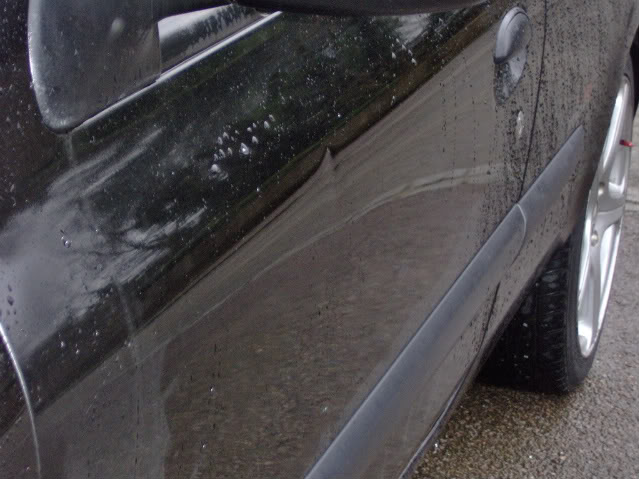

Just sent a pic of the dent some silly ho put in my car to a repair centre, they said it looks like a "proper" repair not a "smart" repair..and it needs painting.
I dont understand this as it hasn't chipped any paint off...does these seem right or are they trying to pull the wool?? and instead of £50 to repair..its £125:eek: :dapprove:

as matt trev said its slightly creased if it was about 10cms down youd prob be ok with smart repair would be ok.

thatll 98% come out, you'll see a very slight ripple if you look along the panel.
if you want it perfect youre gonna have to spray the top of your door

it looks very close to the verticle strenghtening beam in the door, if the dent is on it then a PDr guy can't get to it, i had one in my door and luckly it was 5mm to the left of the beam and it was alot bigger than than yours was it was a crease about 5 inches long when someone with a jeep had really whacked my door with theirs, now you would not even know it was there.
but thats if your guy used the invasive rod method(push it from behind the skin), if hes a hot glue then he should be able to pull it out (as its a surface repair)

It really dont look like a crease to me..just sort of pushed in.

That will push out no worries, i had 3 vertical lines in the back quarter of mine.
My mate got them out in minutes.

I had a dent / crease in my door that looks the same as in your pic , it was taken out no problem with the pdr guy i used . He also took out 2 in the roof , so anybody who says the roof cant be done , it can .
If they say they can't do it , try a different pdr guy .

hi there i work in a bodyshop a i would def say that is a pdr job try else wear
Thanks dude..It actually looks worse in the pic and after a proper look ..there is no crease..its just the way the ligh is hitting it.

I reckon you could get that fixed with Paintless Dent Removal...then if there is any paint to touch up you could probably do it yourself and make it look good.
Dent Devils or Axi Dent are good companies to try but check on Yell.com or something there should be loads to choose from, some will even try fixing it and if your not happy you don't pay...
Thanks Tommy boy! it hasnt even removed any paint..it does have a little grey paint from the car that done it..but i can get that out myself.

Also had some better news after taking my car to a garage so they could see it properly..
and they said it was a "smart" repair.:D
