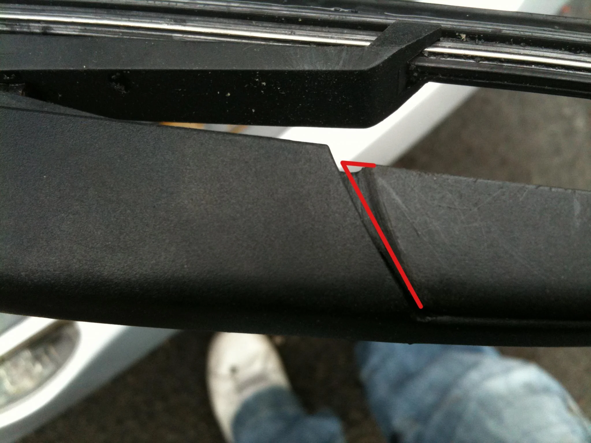

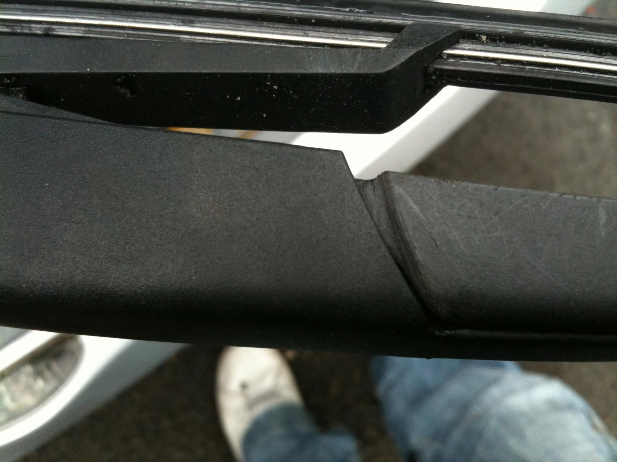

After playing around n stopping the wiper at the top i found that the wiper doesnt curve to the glass as it should and it was down to a problem with the plastic holder and a bit of plastic that sticks out too much and stops it moving to the glass... a file and a bit of sand paper and 2 mins later a working wiper! :D

second picture, where the arm meets the wiper/clip.
the wiper, where the clip is, its the outside edge curve that goes to a point, ive now sanded that point into a curve and took about 3mm off and curved it back into the orignal curve

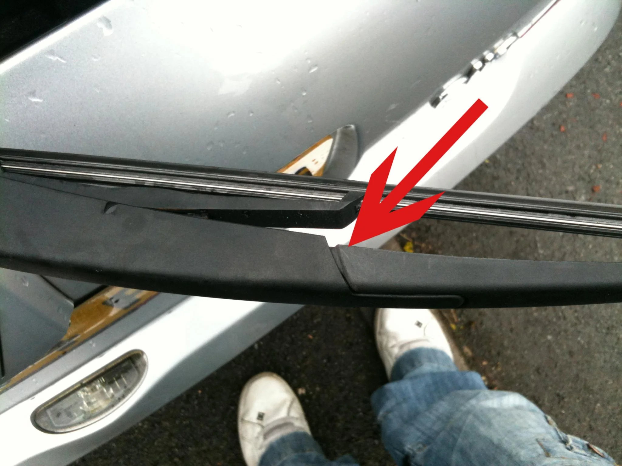

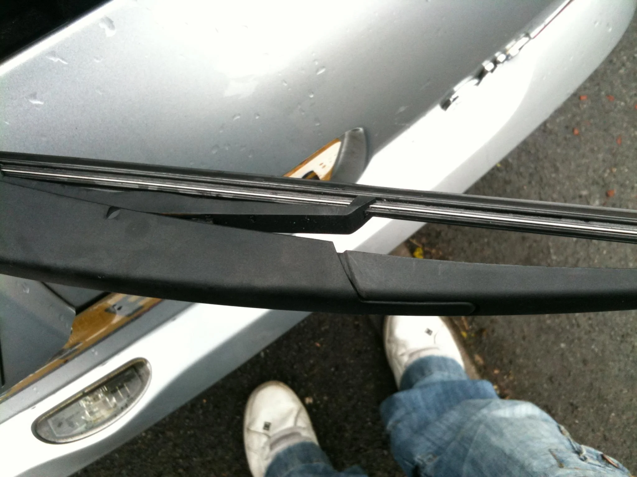

hope this helps, more pictures
the red line is where the plastic used to be, simplily just sanded that area away and the wiper wipes the whole glass...

So on the part at the end that can move freely to wipe the curve, You sanded the lip down a bit ?
yeah if you look at the attached pic's the second one has a red line where the plastic used to be n i just sanded from that line to where u see the plastic now n it freely wipes the whole curve now

Just filed a mm off mine, Looked pretty much what yours did after.. before...

It's the plastic on the wiper arm. If u look at pictures closely I'll c in red where the plastic just to be n where is it now. Hope this helps
