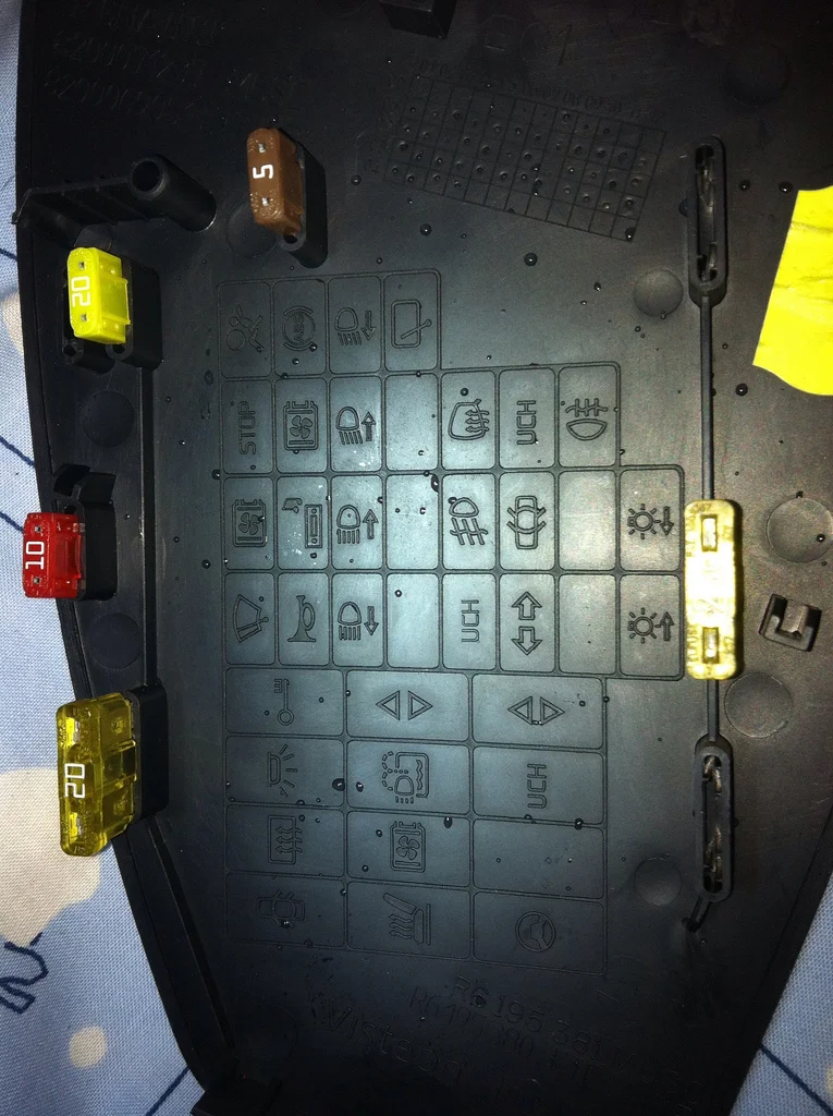

Well I've just taken my spoiler off to carbon wrap it, come to put it back on and plugged everything back in. Come to test the brake light and I noticed not only was the spoiler brake light not working but neither were either of the two rear brake lights. Sat in the drivers seat and upon closer inspection noticed that my mile'o'metre, electronic petrol gauge and engine temp gauge were all missing.
I need all these to be working ASAP as I travel over 35miles a day for work and I'm back in at 8am boxing day....and due to Christmas being here all local garages etc are closed.

Which fuse(s) am I looking at? I'm a bit of an idiot when it comes to this...

Look at your manual for the car, It will give you a fuse board layout, I don't know which one it is off the top of my head and i don't have a manual but i'm sure someone will tell you, If not just look on the Renault website, they usually have a PDF manual :)
Cheers guys, was my brake light fuse. Confusing though, why did that make my dashboard lights go off too? (they're also working again now I replaced the fuse)
