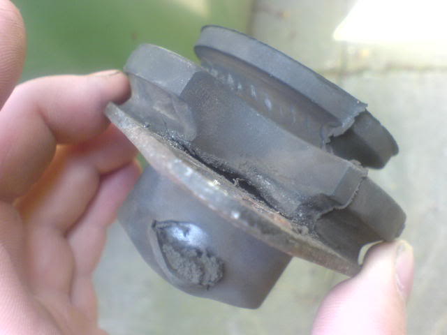

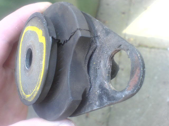

sorted my knocking under hard acceleration
  R27
all the rubber was cut and startin to come away. took a couple of hours to change easy really

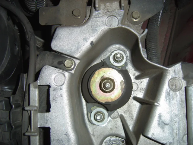

If you mean "where on the car"
The one in the photographs is directly under the battery.
You have to remove the battery and its mounting plate to get to the top bolts.
Don't be surprised when you do, if at least one of the bolts is missing.
Look at the pictures and you will see how the holes have been "ovaled" out of shape, thats as a result of the bolts not being tight.
When I replaced mine, I used "Nylok" nuts and "Locktite"

I also have the famous 'knocking'. Removed the battery today and...
the mount seems to be ok.. or no?
