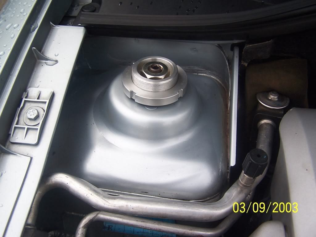

Now I had thought about increasing the size of the sleeve spacer below the topmount/above the shock but I don't think I can do that because the top of the shock rod with the adjuster is already *just* sitting clear above the topmount nut. Although not running Konis the below pic is similar to what mine currently looks like:

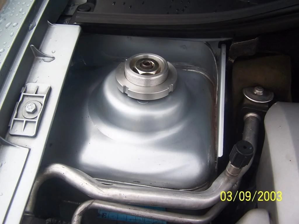

Now you can see that there is a lot of excess thread above the locking ring of the topmount. This made me think that it might be possible to actually space the topmount down by placing a spacer ring that sits on the lower half of the top mount below the strut tower - with the locking ring still providing the clamping force on top. By spacing the topmount down say 10mm I should increase the ride height by 10mm.
I know these compbrake topmounts aren't popular on here but I haven't had a issue with them at all If this would be feasible it would save me having to go to a new set of springs etc but not sure if I am missing something? Am I right in thinking the spacer could be alloy or would it need to be steel? What do people think?
