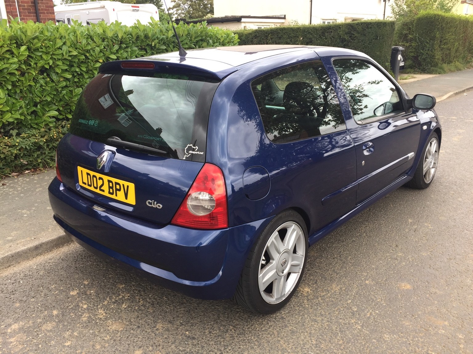

In that photo, 195/45 T1R's .. but had a bit of rubbing on the rear when pushing on so swapped to 40's and rolled the arches more and not had one problem since including some track sliding
Yeah i see mate in some of your old threads,i think i'll go back to 195 in the summer.I think sits the cup turinis better than 205.
MrBlonde
Yeah I think so too bud but I do remember 205's feeling good when had some PS3's on another Clio
The 195/40's look like elastic bands compared!
I think just goes down to what tyres you put on,as some look & fit the rim different.Like i have 205 rainsports on the rear and to me they look to balloon like & i have 195 on the front which look a tiny bit stretched.Going Yoko's or Conti or Goodyear in 195 next tho i think next!..

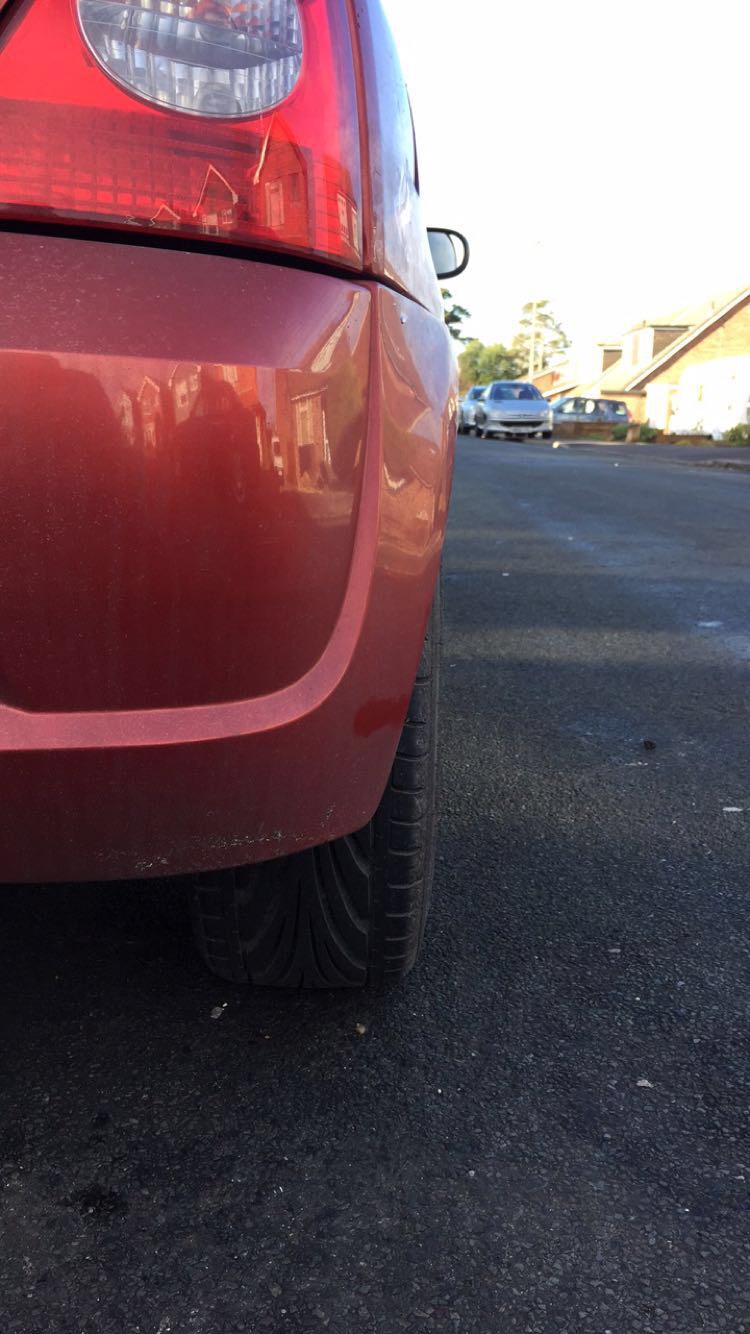

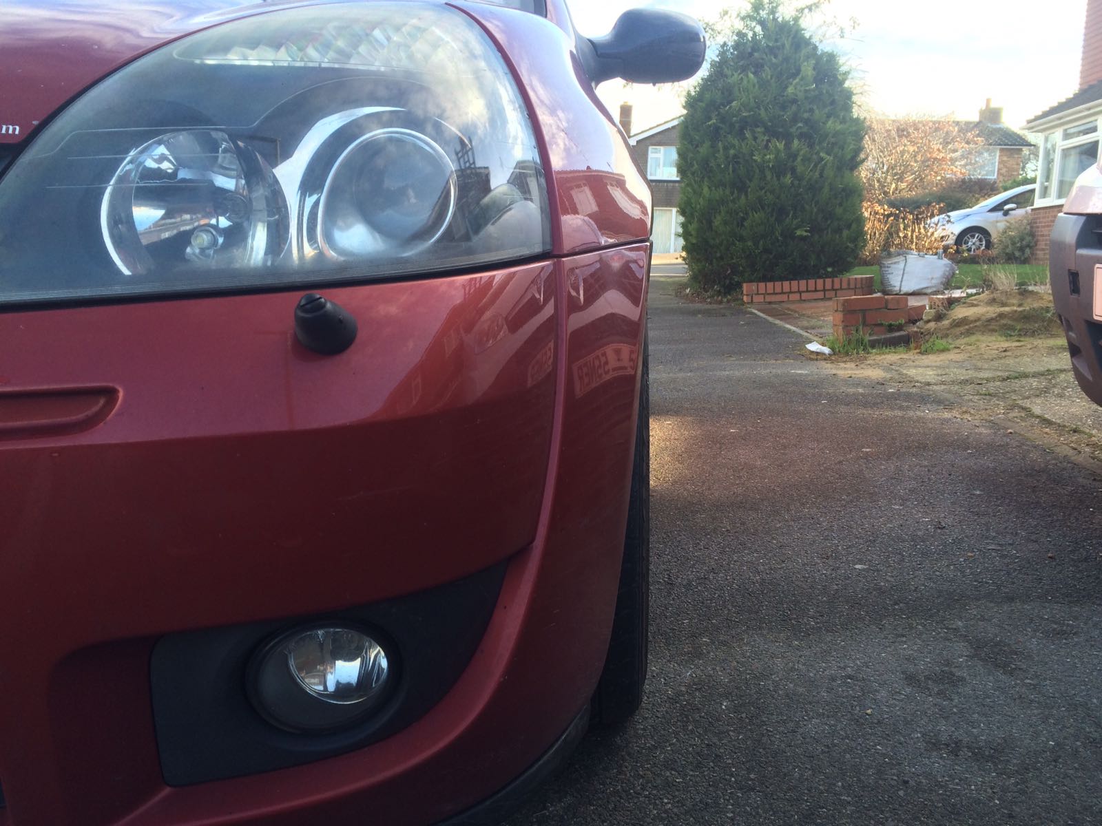

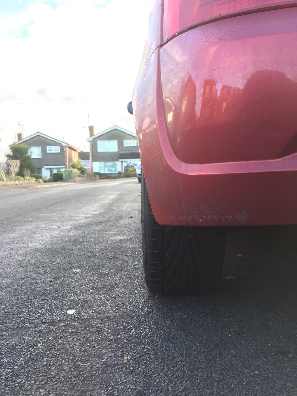

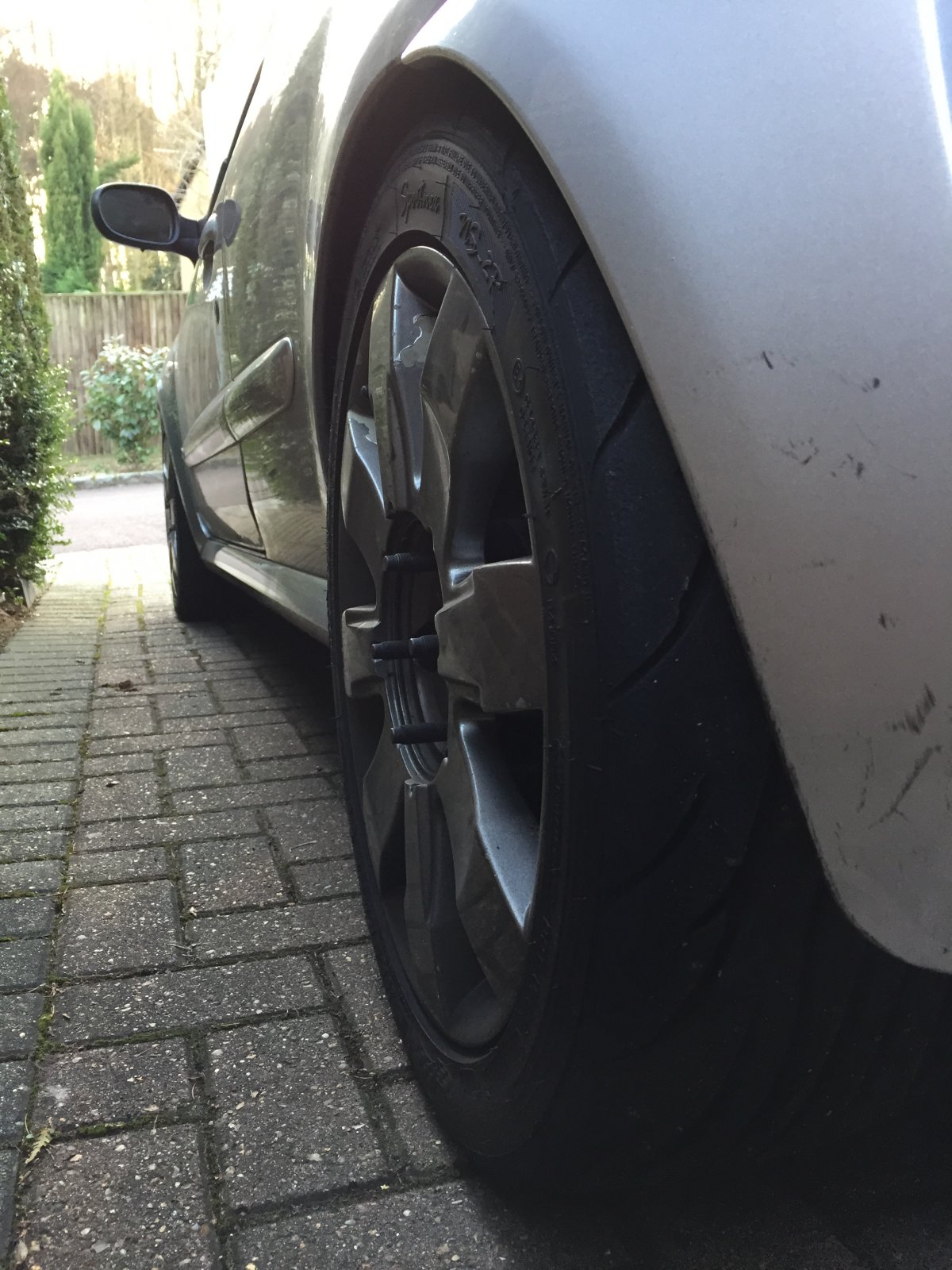

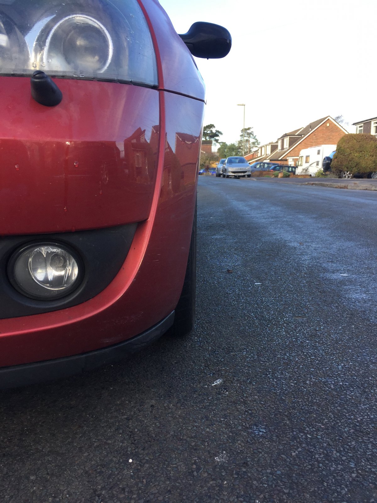

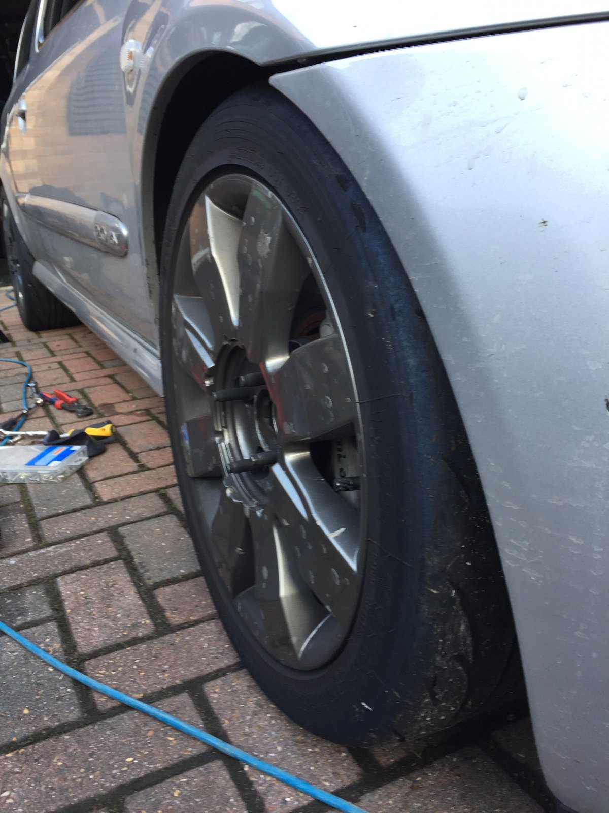

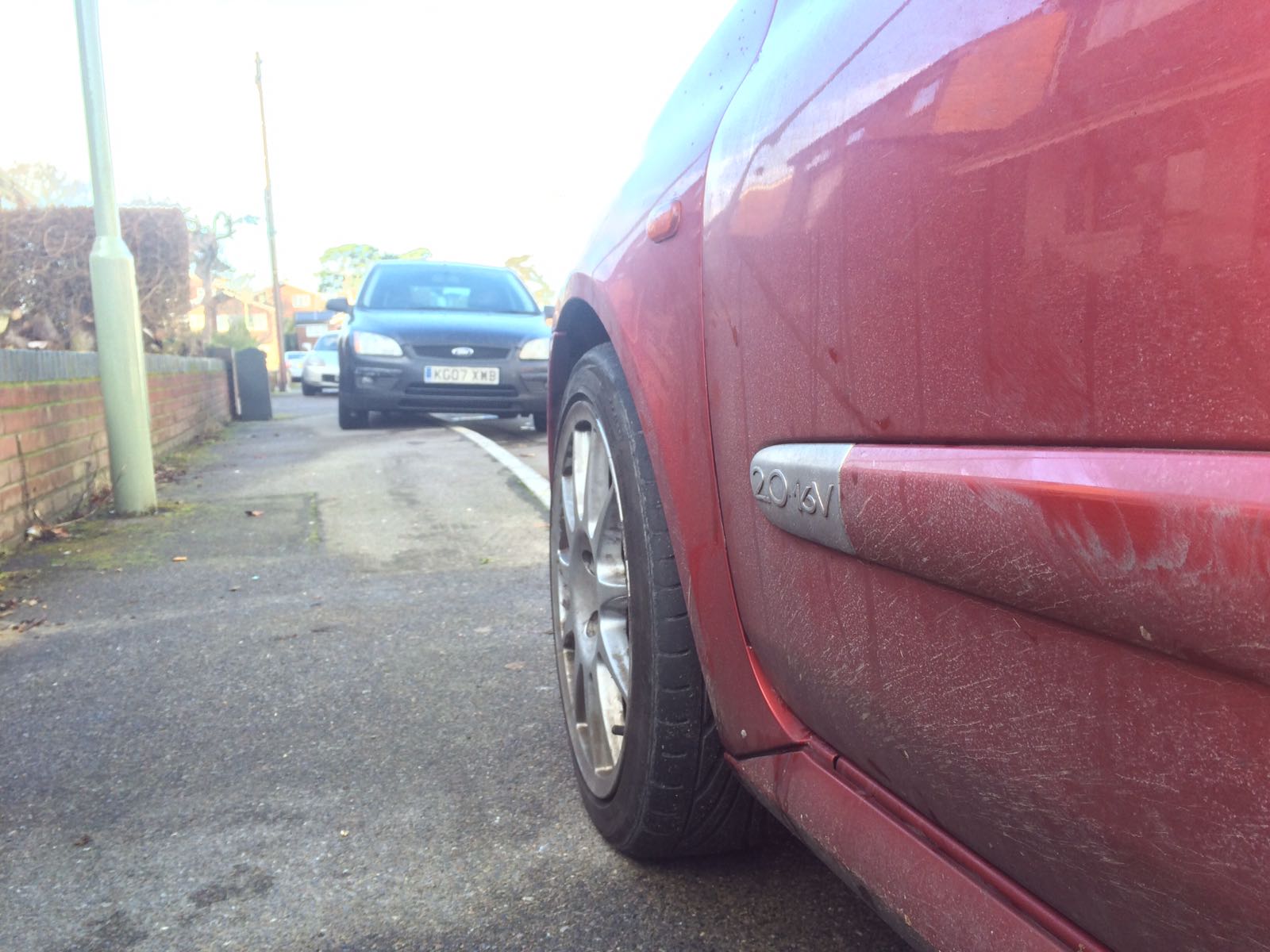

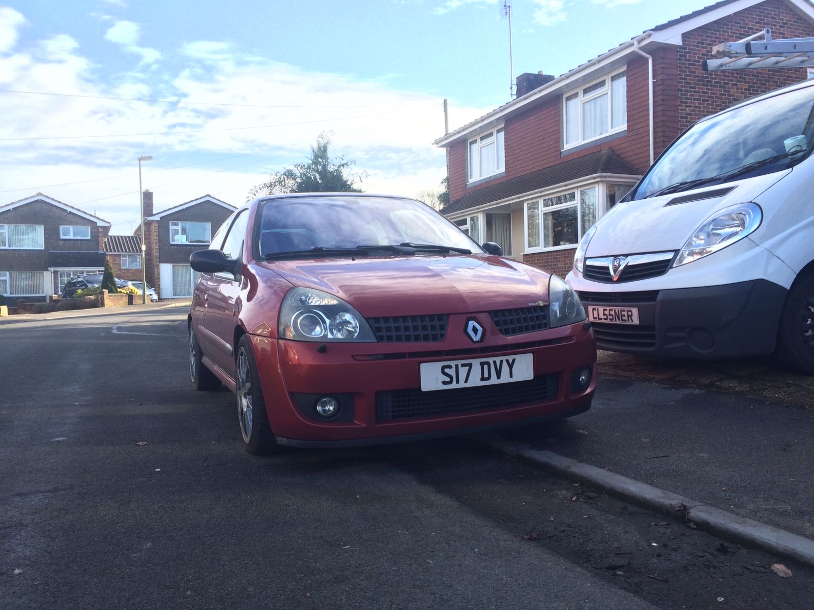

Just fitted the spacers.. what do you think? Love the rears, fronts look a little too wide and stick out I think.
Before..
After..

Looks smart that, but I see what you mean about the fronts....... back looks perfect though!
Did you go 15mm front and 10mm rear like you mentioned before?
I always find that spacers are hard to picture what they look like to the natural eye.
Exactly what I found when trying to take photos of mine!! 🙈

16mm fronts, 10mm rear.
Rears were strange, didnt seem like there was much hub sticking out for the wheel to sit on, made it a right pain to put the wheels back on!

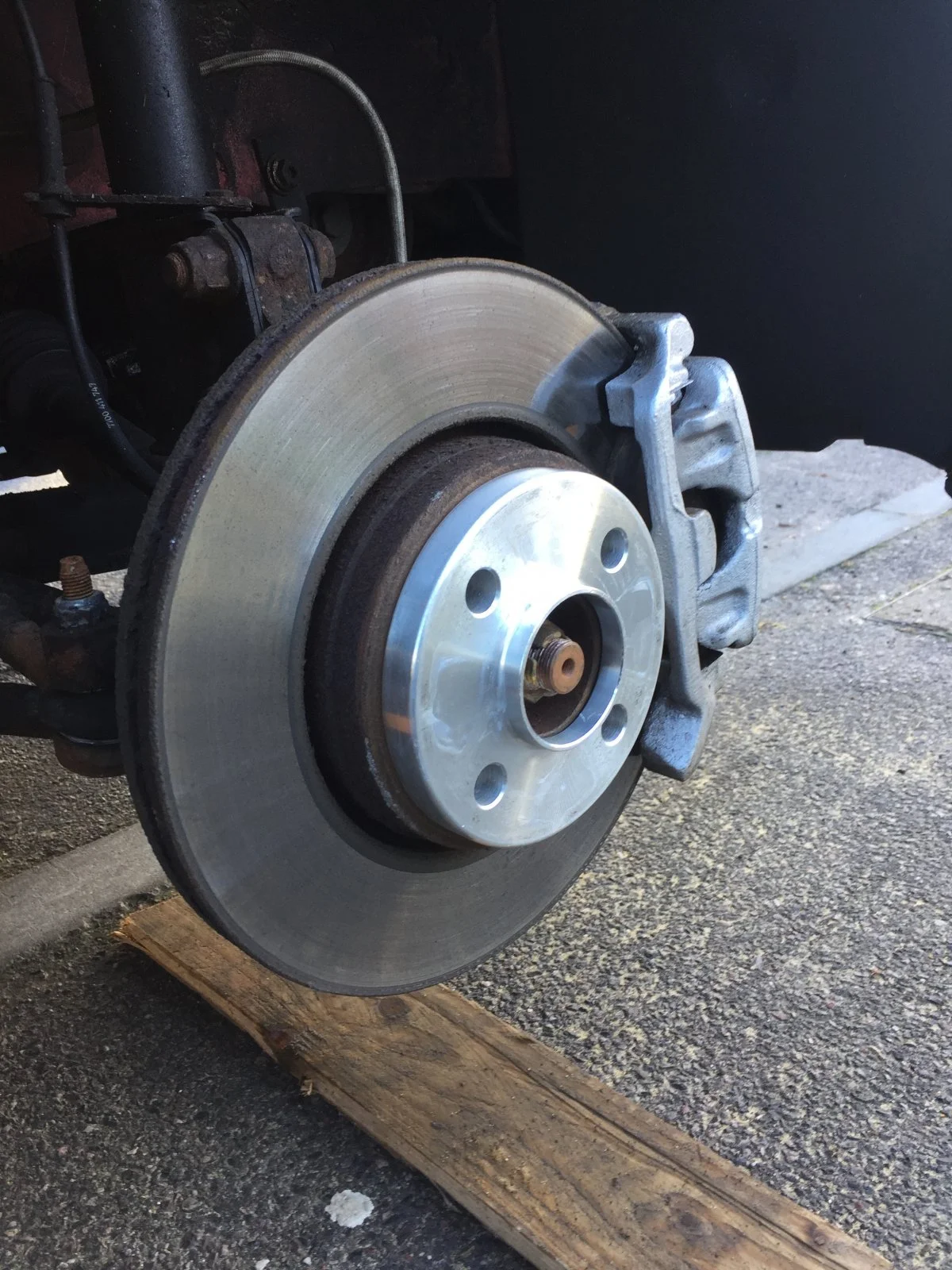

Rears were hard because there isnt that much hub poking out to start with, so with the 10mm spacer on, there was at most 5mm left sticking out. So it was hard to get the wheel on, without the spacer moving and losing the holes for the bolts to go in, whilst putting the bolts in with just 2 hands! Normally without spacers id put the wheel on and there would be enough hub for it to just sit on!
  182, SQ7, Trafic

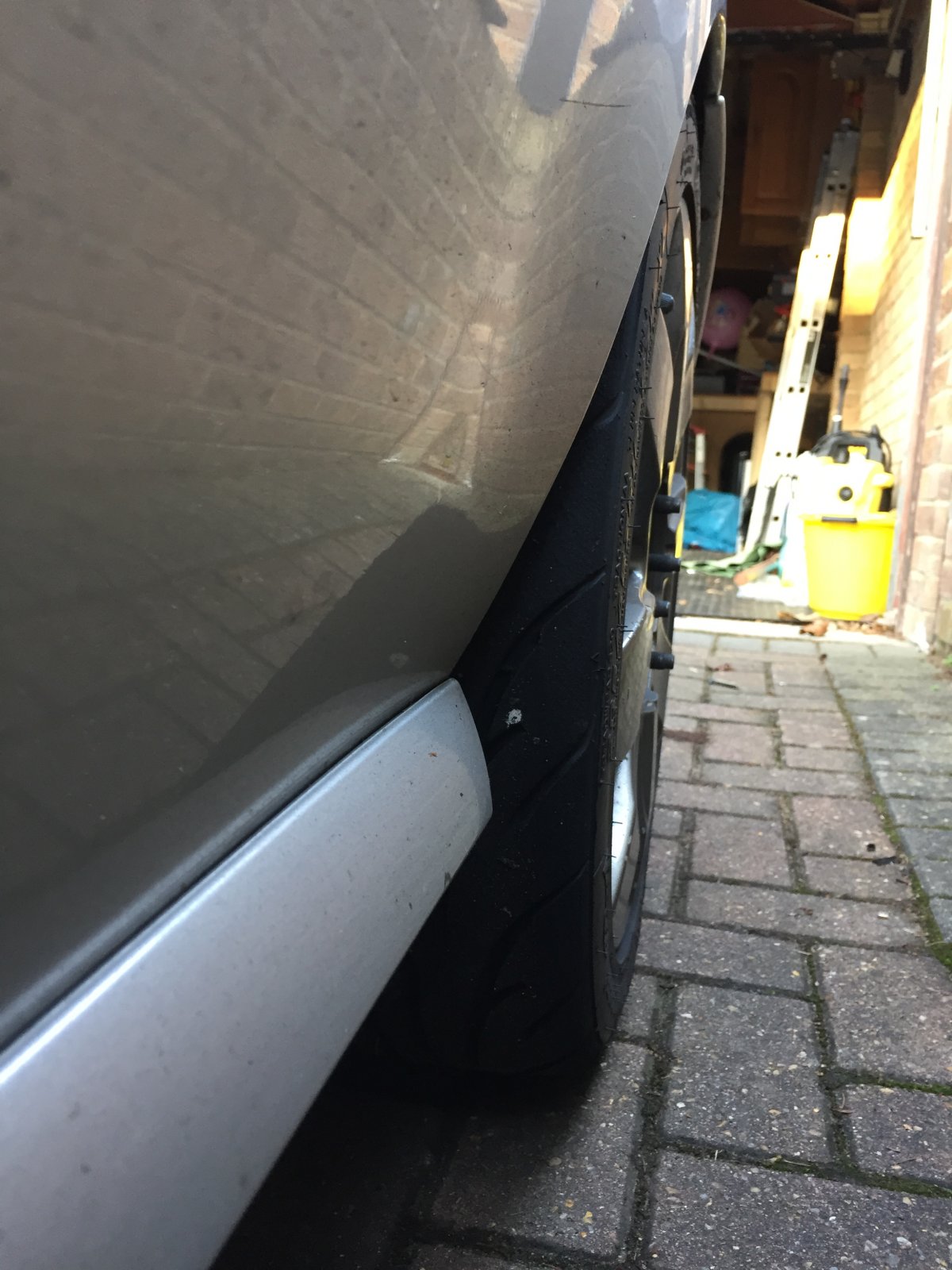

With the standard wheels you would of got 16mm on rear with no rubbing. I had 25mm fronts then 10mm hub spacers with 5mm wheel spacers on rear and was spot on. Changed to Oz F1s and had to take the 5mm off and it still rubs

I know what you mean about the fronts being quite pushed out. I think if you push the back ones out a tiny bit more the fronts would look more in proportion, if that makes sense.

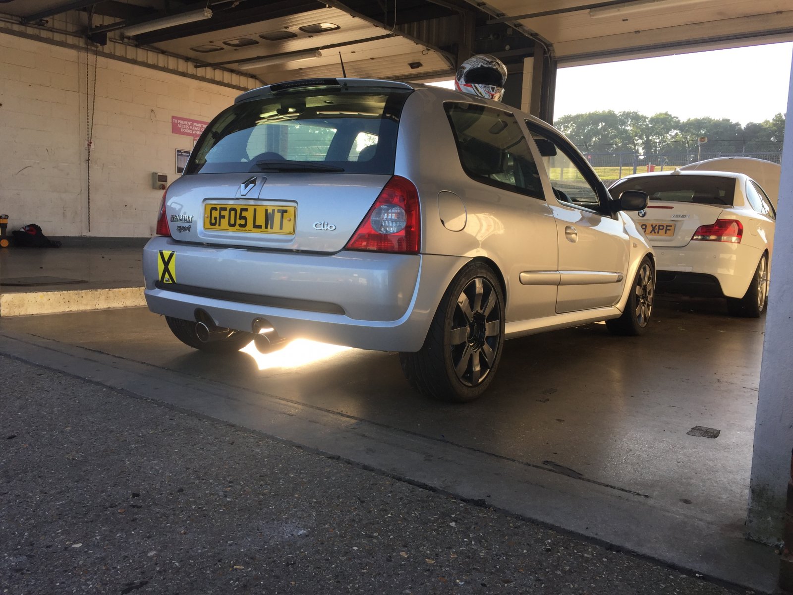

I run 25mm hubcentric spacers all-round on my 182. To be honest I would rather run none at all but had to put front ones on at the time because I couldn't get the wheels over the 300mm discs & brembo callipers. I hope to loose them with some adjustment to the brake brackets and callipers coming up. I do think the car looks good with this compared to standard. If you hit a big bump on the road the backs scrub a bit but not on track.
As everyone says I don't think it helps handling. This is a video of the last track day I did. At 2m 27s you can see how the car moves on turn in which I think is related.
Some photos....

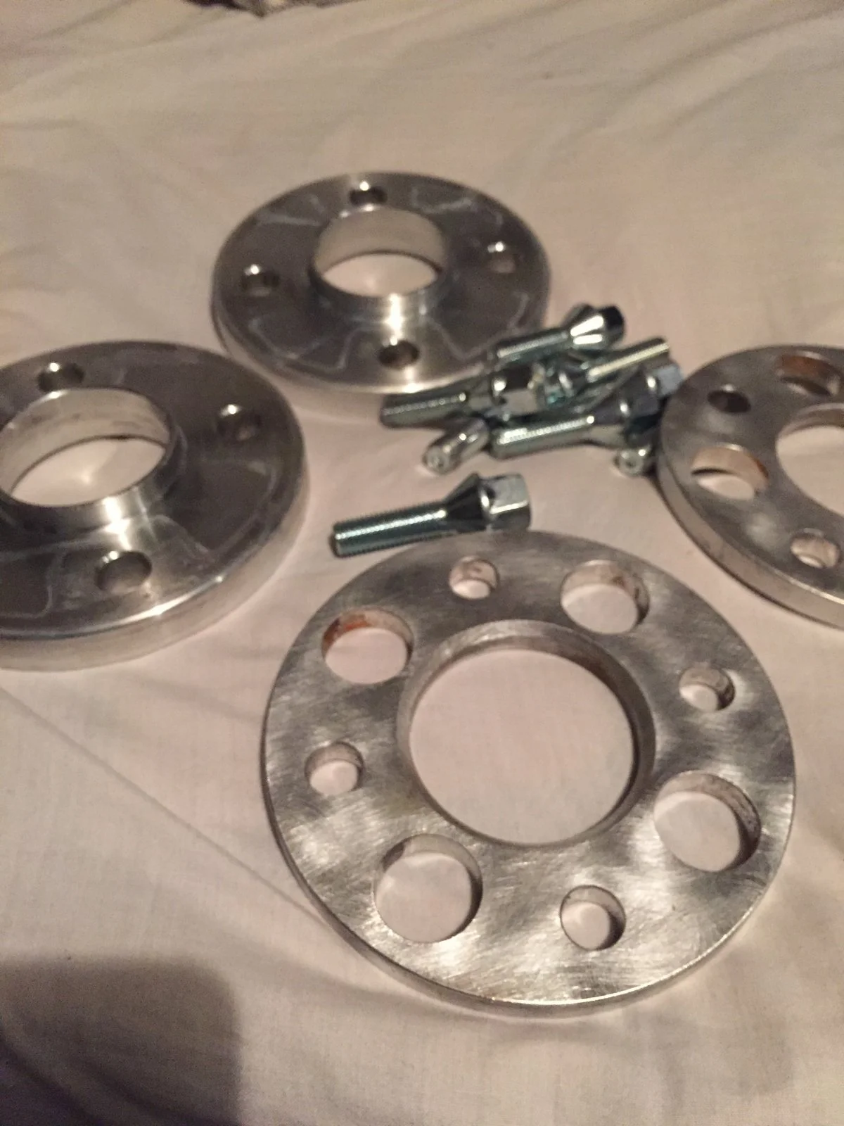

The search for PH2 wheels is proving a bit fruitless unless I'm willing to pay through the nose so, spacers!
Looking at fitting 10mm to the rear and 15mm to the fronts, will only go with hub centric.
Anyone with any experience of them fitted to a PH1 V6?
Ta.

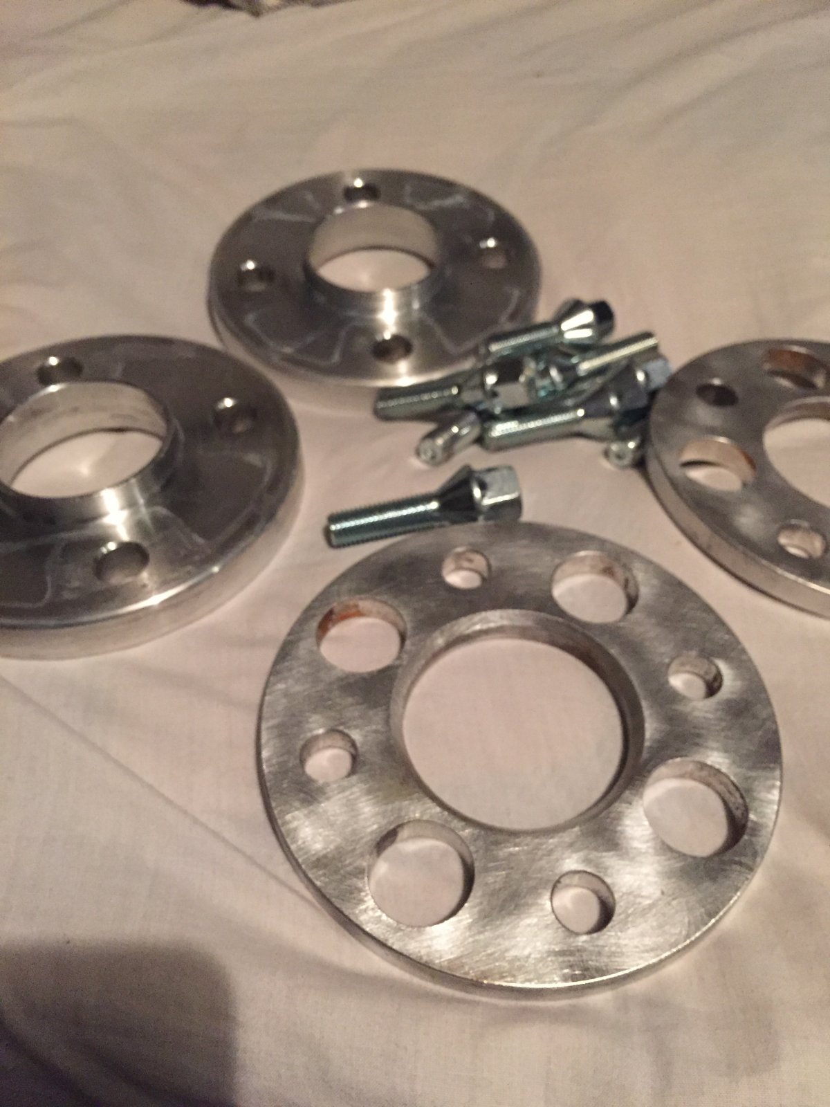

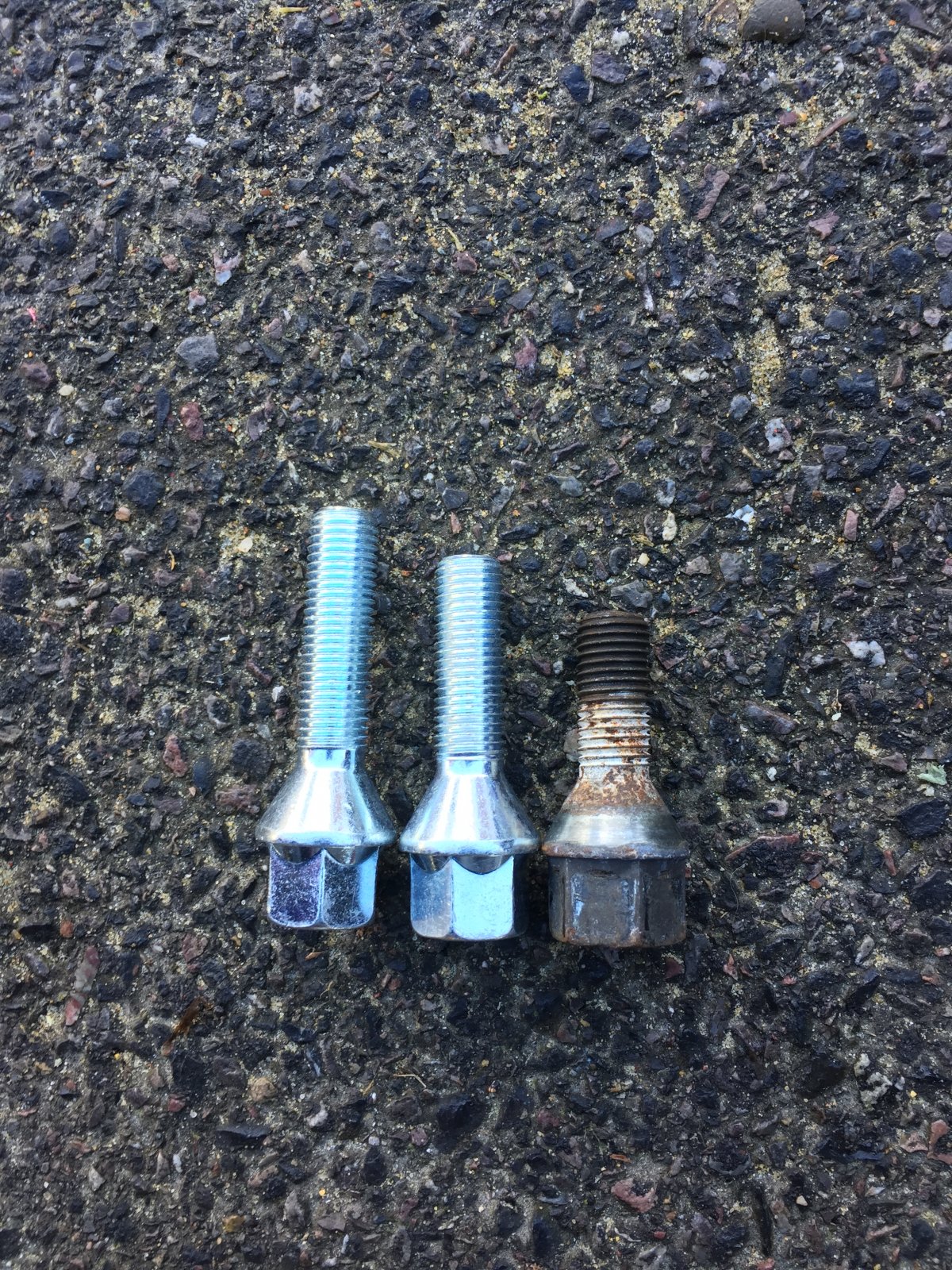

Do I need longer than standard (26mm) bolts to fit 5mm spacers?
And why isn't this thread stickied?
You doing 5mm front and back? I'm changing mine when I'm home for 5mm back and either 5mm or 10mm fronts. Found some 5mm hub Axel Spacers on eBay for the back as well.
I always thought 5mm was the limit for the standard bolts so yes would be absolutely fine. BUT....... for extra peace of mind, I bought slightly longer bolts for mine anyway (30mm) to go with my 5mm PMS spacers all round as they were so inexpensive, didn't want to take the risk :up:

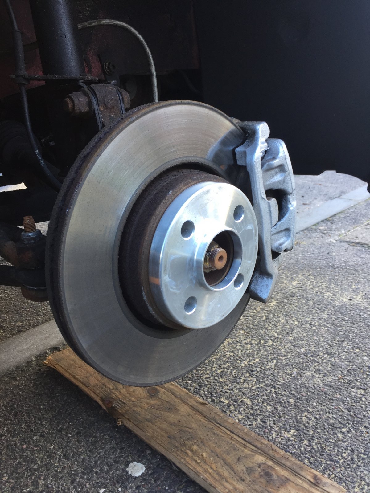

I'm leaving the 10mm on the back for now. The knackered 15's I've had in the lathe and turned them down to 6mm. Worth a test to see what it looks like.
