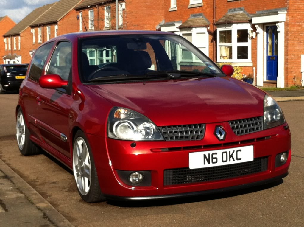

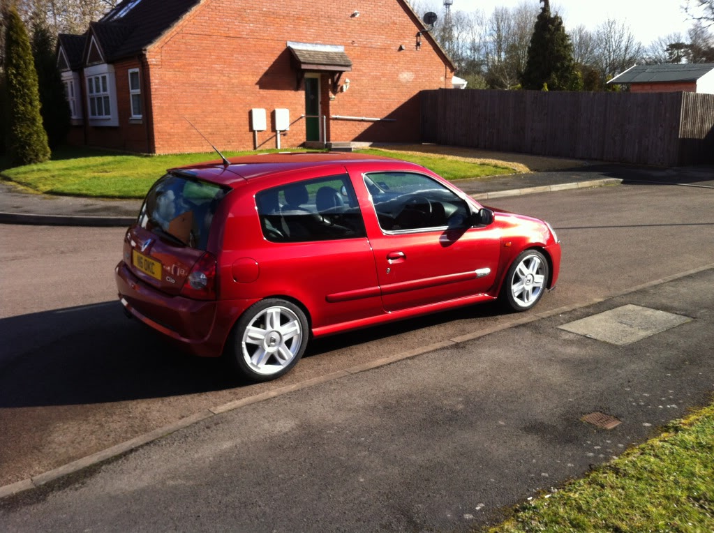

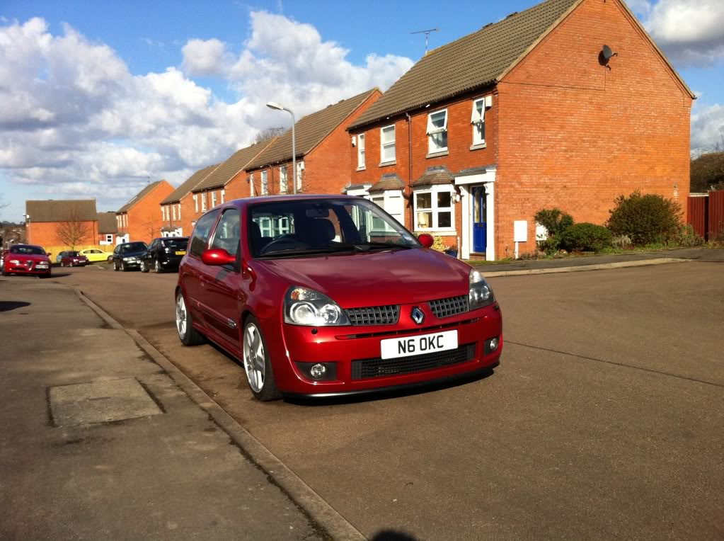

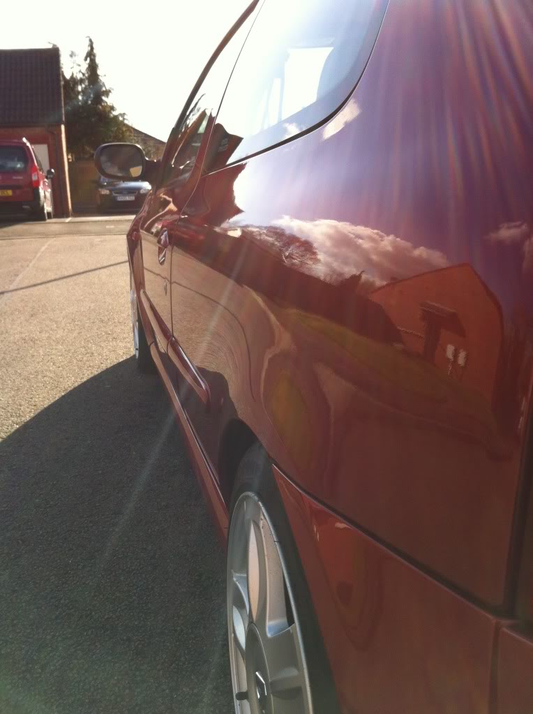

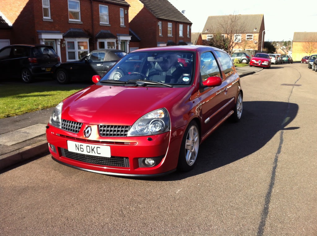

Depends how 'hard' you're going to drive it. I have Eibach 15mm spacers all round on mine, and use it as mainly a road car, with occasional track work. It can very slightly rub on tight corners on track, but never rubs on road unless you have a seriously heavy right foot around mini roundabouts. I wouldn't go with 20mm at the front, because i'd worry about it catching significantly on track. If you aren't going to track it, it should be fine. Mine is lowered on Bilsteins. As said though, Chippen ran 20mm on the front of his and didn't seem to have major problems. Here are some piccies of mine it if it helps you;
