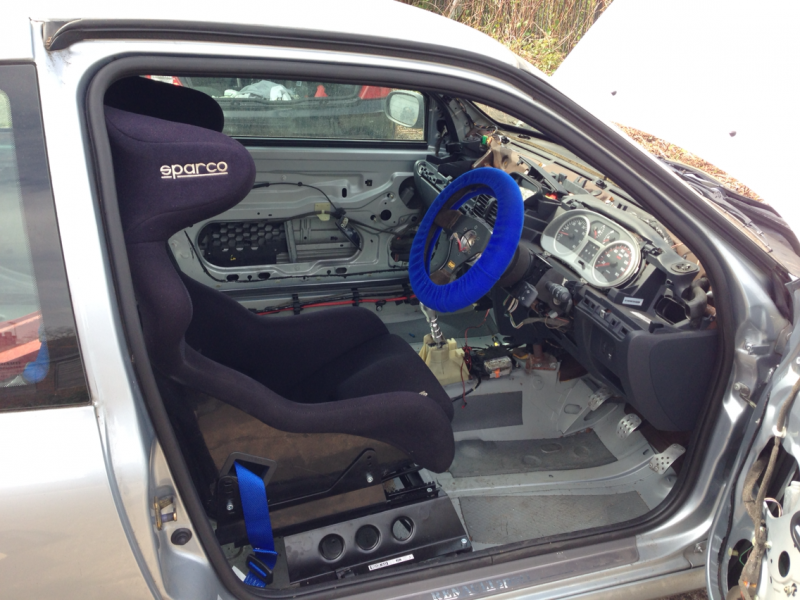

Mounted my raceseat today.....:mad:
Do not use a clio specific sparco frame.....it makes the seat as high as the standard seat!
Anybody know of a good alternative?

Yep, other than custom, OMP seems to be lower. I have OMP in mine, I'm 6ft 4 and I have no problems with the seating position :)

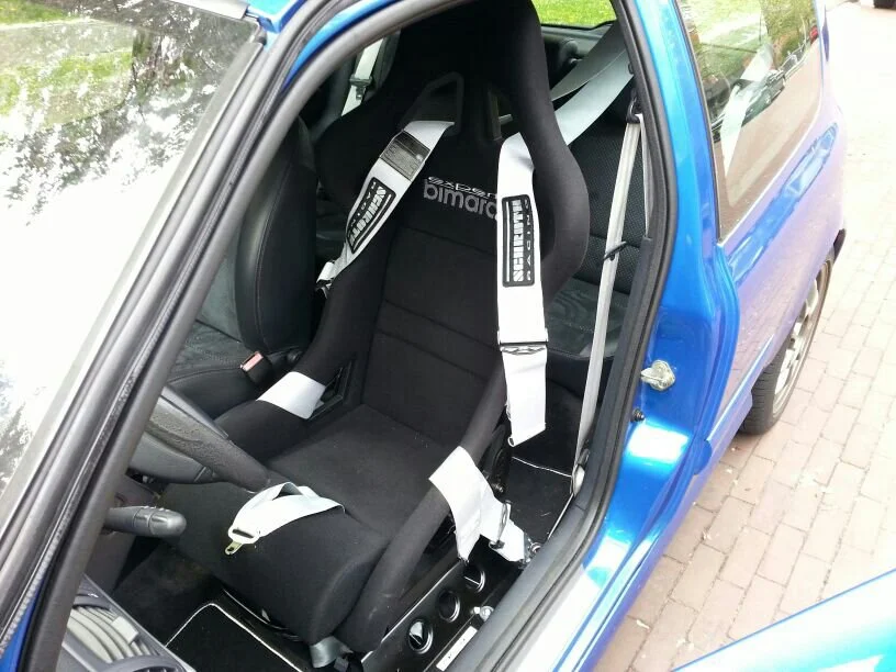

Where are the harnesses mounted, look a bit suspect to me from the photo.
Will look for OMP then.
Harnesses are mounted to the top seatbelt mount ar the rear and to schroth thingies at the sides.(one on the front seatbelt mount, one on the bolt that mounts the seat to the floor)
Bad idea?
anybody else know/think what I did wrong?
the shoulder belts run slightly up, but within Schroth tolerances (20deg)
the lap belts are mounted to the oem belt mounting point with Scroth clip on eyes
the crotch belt is mounted to the floor with the plates that come with the package.
