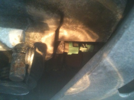

D daveyboy Jul 30, 2011 #1 Is this the speed sensor found just above passenger side wishbone on gearbox? Thanks
R Russ_16v Car 53 Clio's & counting Jul 30, 2011 #3 yours takes speedo reading off trigger wheel on driveshaft
D daveyboy Jul 30, 2011 #4 Russ_16v said: yours takes speedo reading off trigger wheel on driveshaft Click to expand... Can you explain this plz. Do you mean the sensor at the top?? Just below air box??

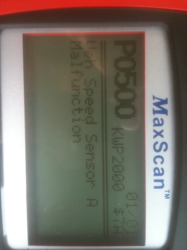

D daveyboy Jul 30, 2011 #5 The pic below is the reason im looking for a speed sensor. Fault code reader P0500 Veh Speed Sensor 'A' fault

mr.pink87 Car 172/1.2/E30 Jul 30, 2011 #7 daveyboy said: Can you explain this plz. Do you mean the sensor at the top?? Just below air box?? Click to expand... Speed signal is coming from the ABS.
