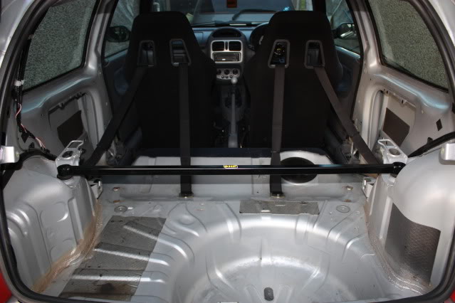

i will be spraying all this sorry
Not too sure on this but im sure some one could correct me.
All the silver square panels of tar would need to be stripped out and prep it like you would with any normal panel, test on a small area like the inner of the spare wheel well and see how it goes.
Or pay a body shop to spray it all in one go as with rattle cans it will be hard to do.
tar will be removed first anyway mate
and you say prep it like i would any other panel ... but i dont know how to, iv never sprayed before lol :o
