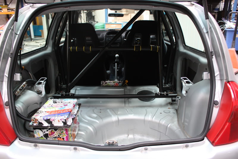

hi guys im currently looking at getting the interior of the clio sprayed satin black, im getting quotes of around £300 but a couple of them have suggested doing it my self.
I think its something i could do and wouldnt mind giving it a go tbh.
I have access to a unit and an air compressor, so all i would need to buy is some abrasives, degreaser/panel wipes, paint and a spray gun (which im guessing will all come in at less than £300)
can anybody recommend my a good spray gun.... gravity or not?
plus were can i buy paint from ? i cant find anywhere that sells satin black, other than in an aerosol
thanks adam
