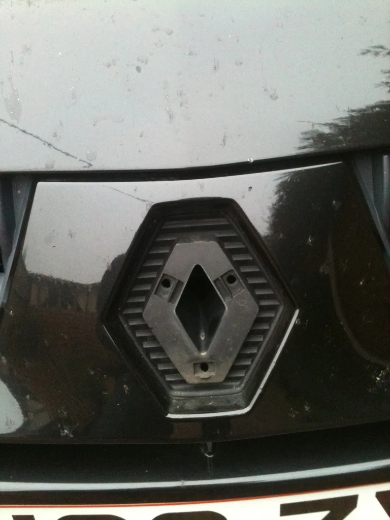

I have done on spray work on mine, but only sand a little. Just a quick one, how do the diamonds come off?
  WRX
The front can be pulled/prised off photo shows plug positions. I covered a small screwdriver with a rag and carefully prised it off.
The back needs to be accessed from inside the boot and whole boot release section undone. I think it's 3 screws but haven't done it yet. Search on here for more info.
  Megane GT
Thank you! Will give it a go next week some time :)
