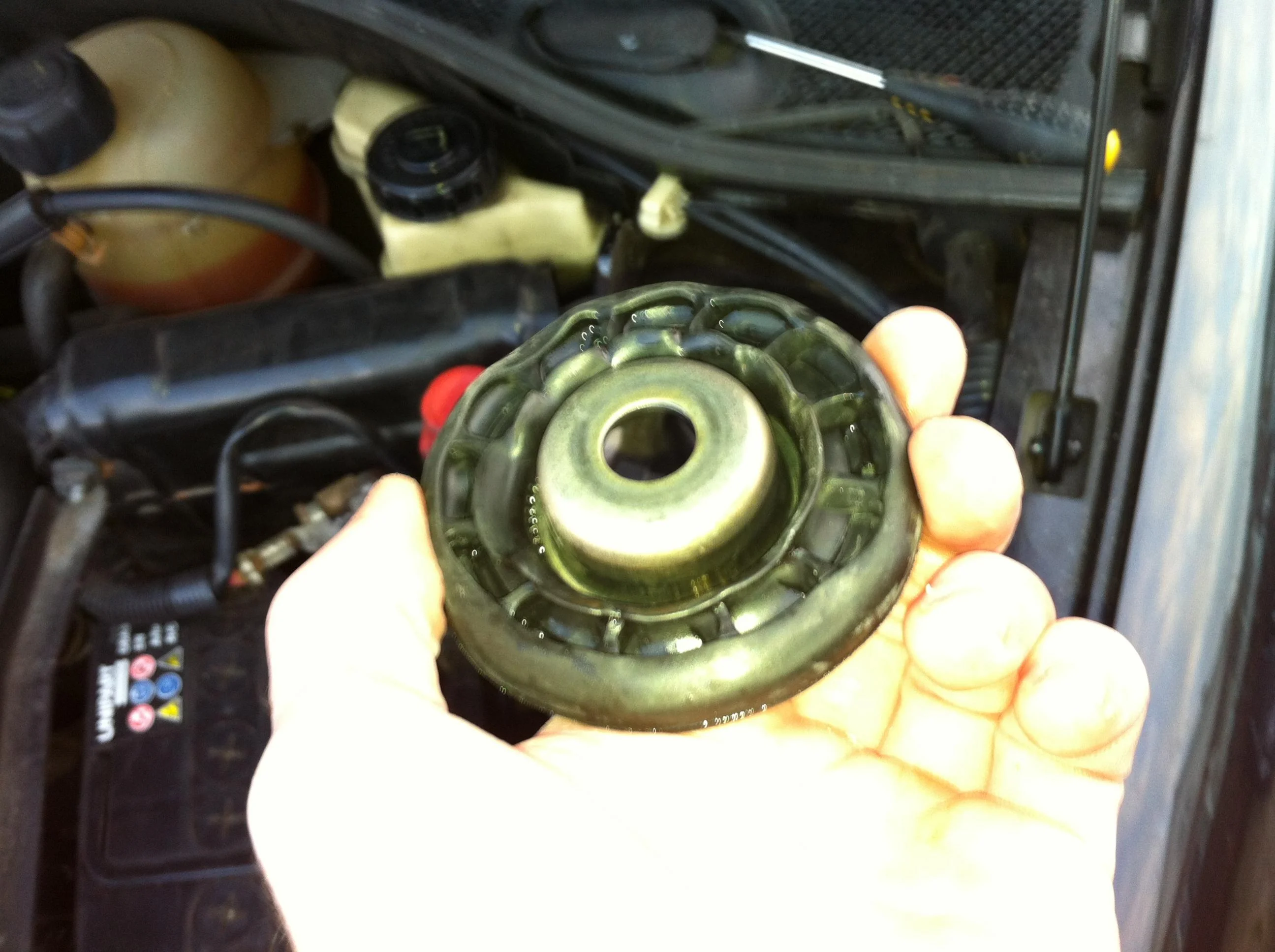

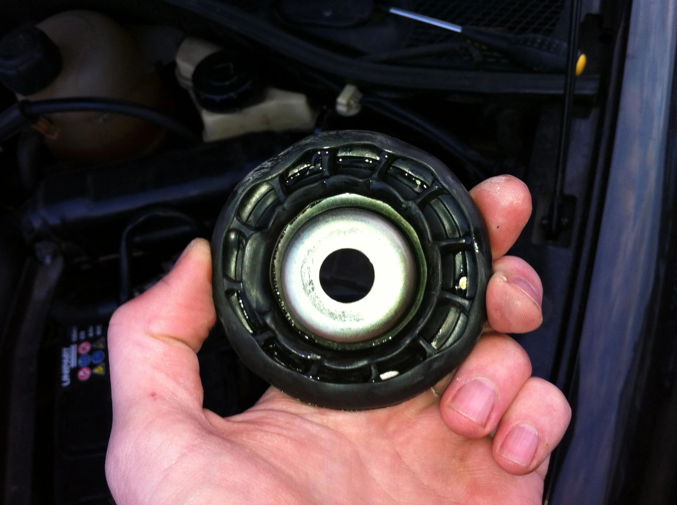

It's definitely suspension related, yes they're Eibach Pro's. Took the top bit of the top mount off and...
I'm no expert but I don't think they should look like that after 1000 miles. After refitting them I haven't been able to repeat the noise, however I haven't replaced anything so we shall see...
easy peasy
you have the new model top mounts, and you haven't bought the moddified spacer (it doesn't come with the new moddified top mounts - stupid renault)
those top caps are too tight against the body as a result
bingo bango
I do have the additional washer/nut type thing though mate (if you mean the one you buy from Renault). The driver's side is fine also.
Mine did exactly the same and it was top mounts. The bearing had completely collapsed! Noticed a screeching noise when driving and turning at the same time too.
