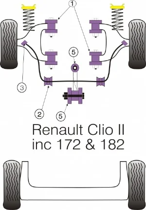

Got in touch with K-Tec about asking if it could be bush related like tarmacmuncher mentioned. Going by this diagram would it be the 1's?
Also, what about the rear?

Lucas, this has already been said... see the image I posted. What would I need to order for the rears though? It's happening all the time from the rears, whereas from the front it's only every now and then.
